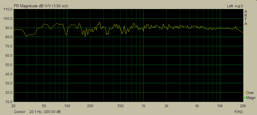

What I meant by flat is speakers measured at design axis, outdoor, non-gating. 1m from the speakers, 2m from the ground plane.
Incidentally if I pink-noise it indoor 1m from design axis it looks like attached. This is the most realistic sounding even when I know the limitations of those dipoles in the tweeter region.

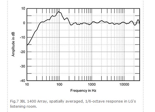

Here is a speaker that measures very flat in room asside from the bass bump primarilly from the measurement technique.
The "Spatially Averaged" label at the bottom of the chart may be a very good clue. How many of us do that? How many even know how?

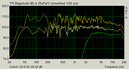

Just to illustrate the above, this is the ungated in-room-response of a 3-way dipole from 200 cm (yellow), 55 cm (white) and 14 cm (green, HT only) distance:A lot of the papers that I read make a good case that the early sound should be flat and the steady state response should roll downwards with rising frequency.
It is easy to see how the high frequencies get attenuated when the room influence becomes dominant.
Rudolf
Yep, that shows it very well.
And the farther away you get from the speaker or the more the room absorption rolls off at HF the more the top curve will sag. (Anybody ever see the Cinema X curve?)
