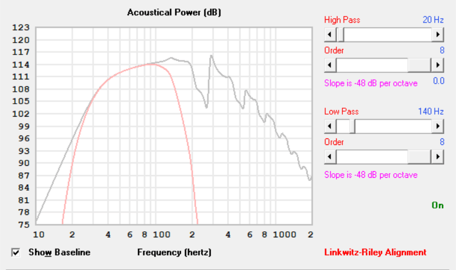

Maybe you’re simulating extremely small qw pipes and very overdamped frequency responses don’t really show much detail except the higher ‘Le’ and moving mass of the strange ‘ds18’ driver creating the high frequency roll off shape ?

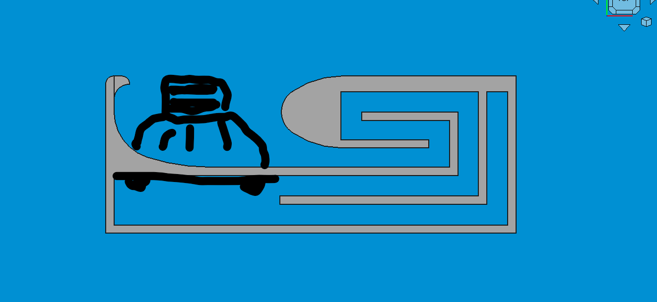

Did you notice that the 3 part TL segments can be laid down as one pipe and would look like the surfboard you once asked to model?Maybe you’re simulating extremely small qw pipes and very overdamped frequency responses don’t really show much detail

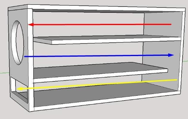

'Piece o' cake' 😉 Calculate a max flat alignment (cm^3), then find its square area (cm^2) = pipe area (i.d.), now make it as long as the desired tuning is required.How do we bring a driver with a 16L Vas and a TL together? Curious to hear what a 12" driver sounds like when bolted onto a TL meant for 6" drivers
The way I did it before T/S was to convert factory box designs to whatever size vent area was required to make the driver fit and long enough to 'hit' the desired tuning (historically Fs).

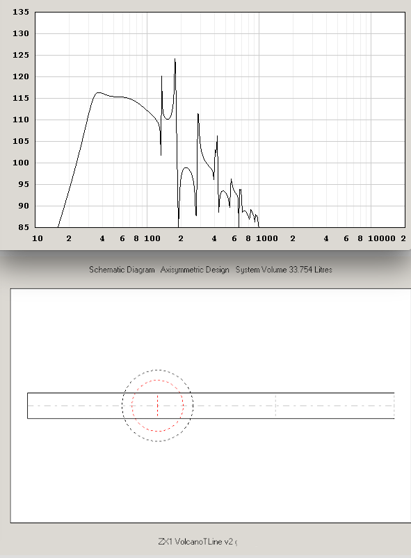

The diagram could be modeled as a TH.
The diagram and Hornresp inputs are very different.
The ZX1 VolcanoTLine v2 is useless, whatever you call it 😢Models as a line, but I still see a tapered driver operating chamber and a straight port with an exit flare. What is it?
That is not the correct system model, Drawn is a 1/3rd offset but your model shows 2/3. Even the TH 1 model works iwhen you add the exit flare as mouth too
The Schematic Diagram I posted in #76 is from the "ZX1 VolcanoTLine v2" Hornresp inputs you posted in #75.That is not the correct system model, Drawn is a 1/3rd offset but your model shows 2/3.

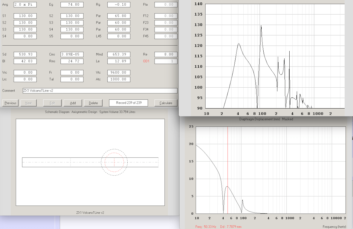

Art has the driver at 120 cm instead of 60 cm by using ‘OD1’ instead of ‘OD’. (Easy mistake to make in horn response weve all likely done). You’re not really drawing either scenario, legitamitely, so it doesn’t matter ..(??)
its putting a big cancelation notch at ~72 hz (120cm) as a result. (Instead of removing a 60 cm/144hz resonance and cancelation notch thereafter (tapped pipe)
Nevertheless, Why would you put a 12” sub in a 130 cm2 tube that long and twisty? Vent speed and noise and ??? No bass.
Oops, my mistake.Art has the driver at 120 cm instead of 60 cm by using ‘OD1’ instead of ‘OD’. (Easy mistake to make in horn response weve all likely done). You’re not really drawing either scenario, legitamitely, so it doesn’t matter ..(??)
Response looks better as OD instead of OD1, but it's schematic looks even less like the scoopy diagram in #75 which has the driver located by the horn exit.
