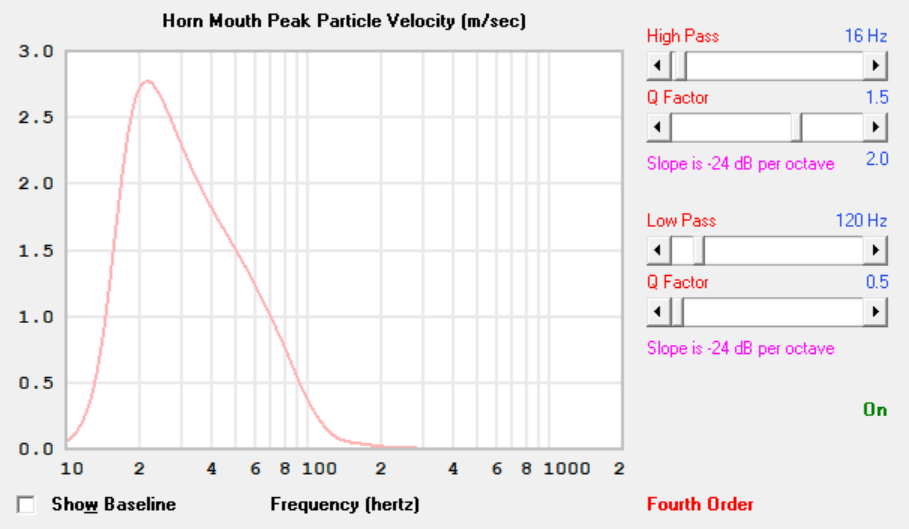

To see what happens, man! Is this not reason enough?Nevertheless, Why would you put a 12” sub in a 130 cm2 tube that long and twisty? Vent speed and noise and ??? No bass.
It's less twisted than the one @BP1Fanatic drew up for the ZXI

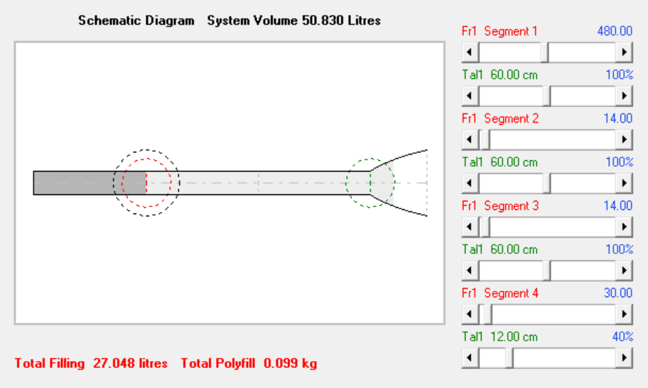

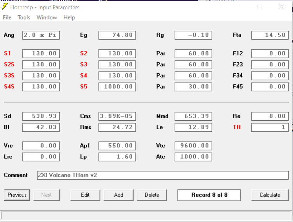

The input screen shows only 3 segments and one TC in end to end connected setup. Look at the labels in his input screen, they are not red. That cannot be tuned the way the stepped connection in my input screen can. My FreeCAD template allows this and can be adjusted in the already built box. Arts end to end connection doesn't allow this type of using after the fact of gluing
The second and massive flaw is that you guys assumed a horn exit from the lateral cross-section sans side panels drawing. There are no sides at the driver mount location in the input parameters. The input and the drawing show a port very close to the driver, but the driver is not in a horn as such
To see a tapped model, you must add a tapered segment to S4S-S5. This covers the sides of that horny looking scoop or scoopy looking horn and select the TH 1 model (not TH1) for the response below (with dampening)
Hornresp falters here, the pipe Sd is 130 constant and segment 2 and 3 are connected together making a 1.2m pipe. Now adjust the lengths in Loudspeaker Wizard while having the response graph up. Hr keeps the 1.2m length while adjusting and shows a change in response even though it's still a constant 130 over 1.3m and don't say because of the bends as there is no input parameter for fold. HR does assume a pipe
Adjusting L12 shifts the first tap point, causing the response to change, even though L12 + L23 remains constant.Now adjust the lengths in Loudspeaker Wizard while having the response graph up. Hr keeps the 1.2m length while adjusting and shows a change in response even though it's still a constant 130 over 1.3m
Makes sense nowAdjusting L12 shifts the first tap point, causing the response to change, even though L12 + L23 remains constant.

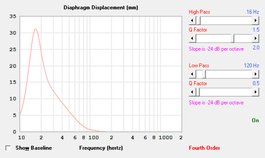

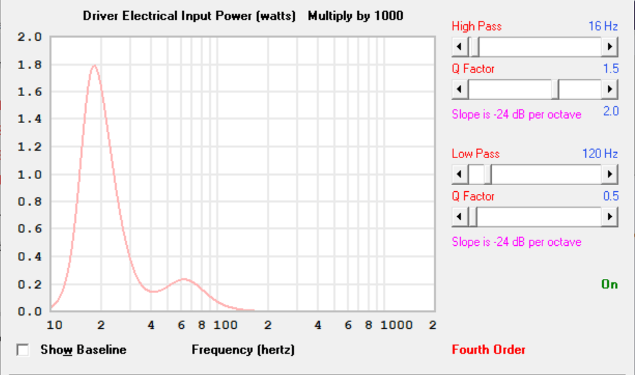

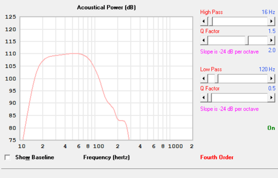

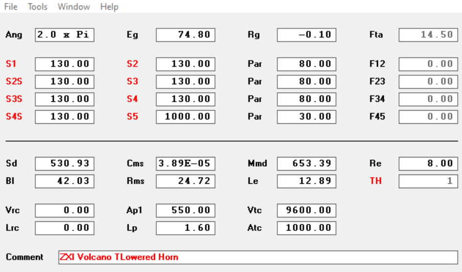

I have been able to further reduce the external volume without losing the response. Well maybe I cant tell the difference between the results due to how graphs are compressed in a tiny window
From what I can see, 1/3 offset places the driver on segment 2 entry. So I dropped the TC to inlay the driver on segment 2 side wall at the start. Doing this lifts the Fb by 5Hz but the imp nipples were level even though this was 6Hz above Fs. Adding 50mm to each segment drops Fb back to 32Hz buy with a net saving of 310mm dropped from the cab height
I am now inclined to reduce panel thickness to 12 or even 9mm. The 9mm would be 8mm marine ply with biax skins in a sandwich to remove any tendency to flex with dowels as braces. But the test box will still be MDF with the same dowels

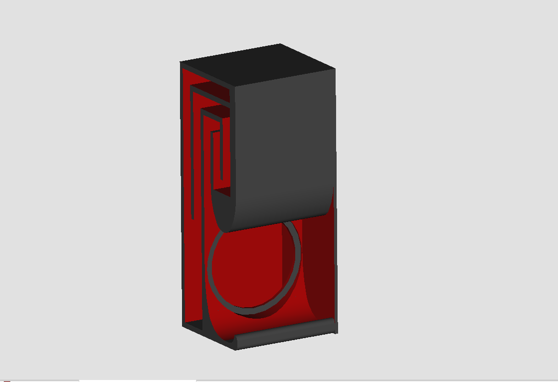

Am happy now with the overall look of the expected box from this template thing. This is the scoobydoo look that I imagined
Wanted to see how low can I tune this template with the ZXI 12". All that needs to be done is just scale the cab taller thus increasing pipe length and a lil bit of filter to graph this so, No idea how it would sound
If the test boxes sound good. I could then really live with a pair of these in the front corners of the room with the tube driven racers fitted into false compartments in the front panel. Making it appear as though they are loading the cab and making all the bass!!
