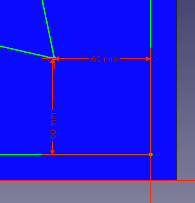

When it comes to port flares, can this be modelled using HR? I have set the flare rate just for illustration purpose. In HR a segment can be set as conical, parabolic and such. Which one is most suitable for the slot port segment? Is it still conical if the port is rectangular and flare rate is like an angled board with a lip radius?
I would like to learn how to correctly enter the data for a box like this to build a Hornresp model. I think I can do the two parts of the port ok and assume the radius will be ignored by the port frequencies and just there for looks and flow. Interested in learning to correctly model such angled flare on just the exit section and both sections
Is the driver volume done as a segment too? Really struggling to understand the workflow in this situation
The illustration is similar to what I want to model acoustically. I would build such a cab with plywood outers and use CNC'ed MDF for the ports and fillets
Can Hornresp model this better, or is this best done as a BR in WinISD and somehow using the port flare function?
This will be edge treatment under assumption that these radii are invisible to the bass frequencies and for structural and aesthetic reasons

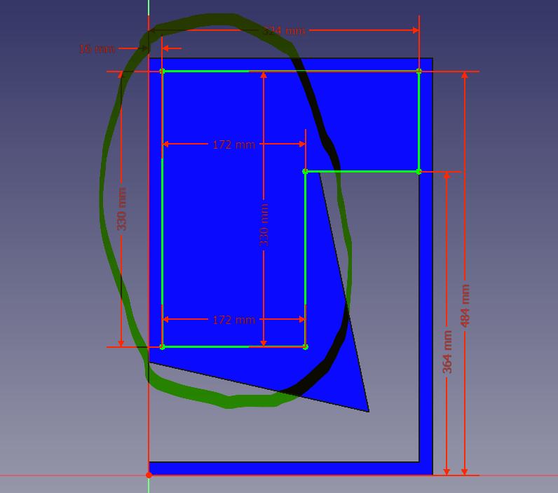

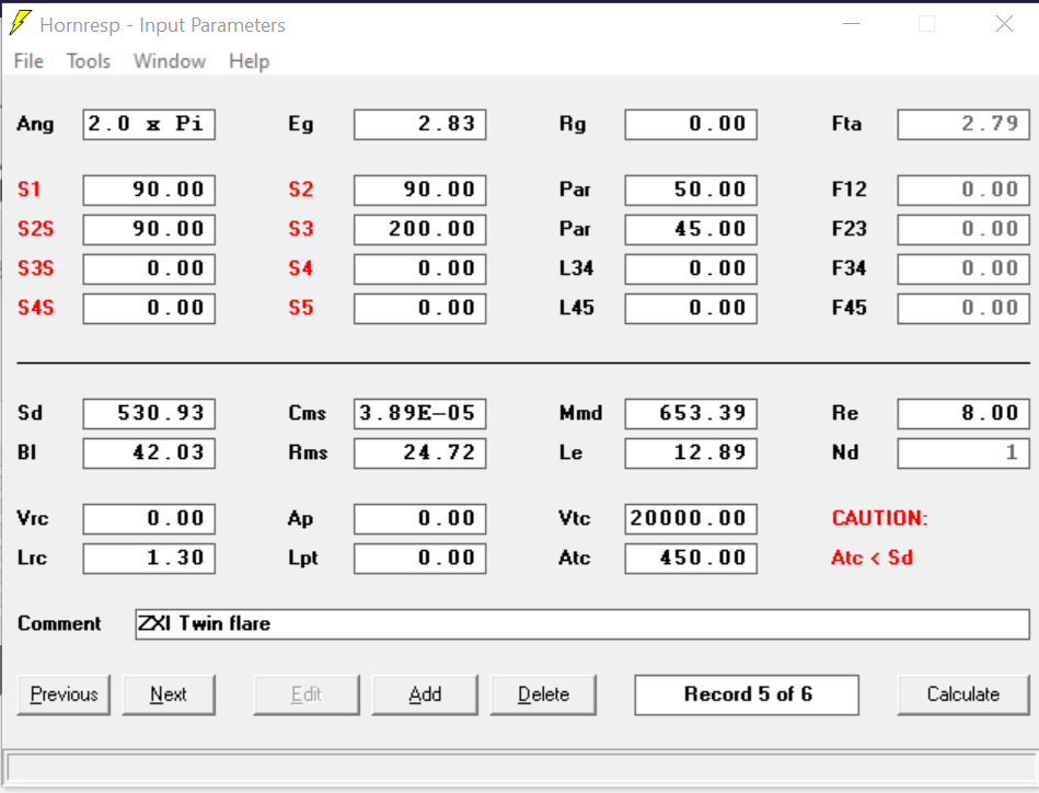

This is my 10" sub box now with a 43Hz port and 20L driver volume. I want to try to angle the boards first to see if Fb can be dropped to 33Hz. And then try to curve that all the way to the bend to see those results too. If I tune that to 33Hz as is, the port becomes too long to fit the box
Learning how to input data into HR for a segmented and tapered reflex port will also help me reduce that driver volume to a suitable compression chamber and fold a back loaded horn from that chamber to model an actual scoop for my 12" sub after completing this 10" one
I watched the very well done tutorial vids on @LORDSANSUI's site, and I am guessing I would need to create a system model in HR as shown in the HR related vid. Just totally lost with finding the workflow to enter the data to create this system model of a driver chamber and tapered port segments
I really cant make any headway on how to start entering this model. Is it just using the first segment for driver volume and second segment for port section 1 and third segment for port section 2 to make a weird looking TL? Totally lost on how to start

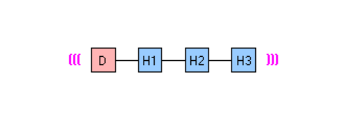

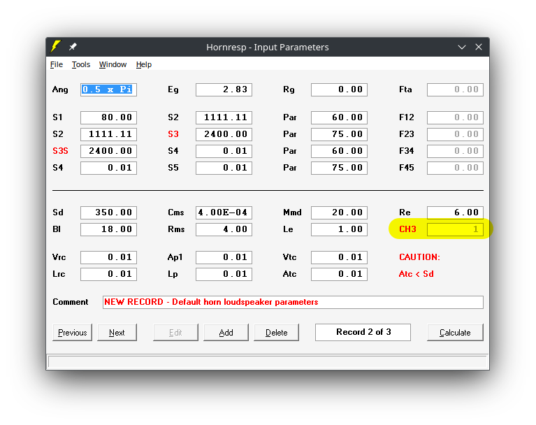

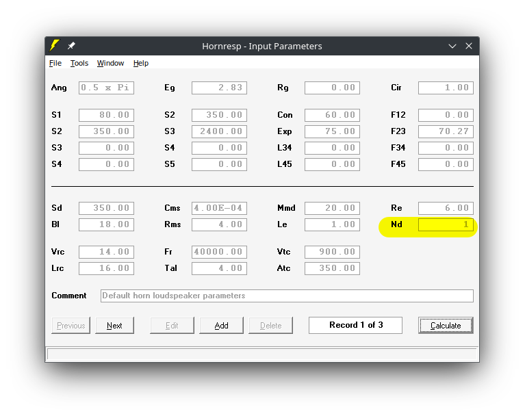

Start from the begining, so try to set hornresp to use CH3. There are two ways of doing it, the easiest one is is by double clicking over the model until you find CH3.
The 2nd step is about the inputs, in the link I shared there is a PDF file where you can find some some sketches, system models, etc, in the website there are more, so, try to match the name of the box (segment) in the system model with the name indicated over the Loudspeaker sketch. Each geometry of the loudspeaker will be represented by a different box in the system model. It's like LEGO, you need to connected pieces.
In your case, you may not need the H1 and H2 segments so you can set them to 0.
In the manifold box I set the H3 segment to 0, check that hornresp input data.

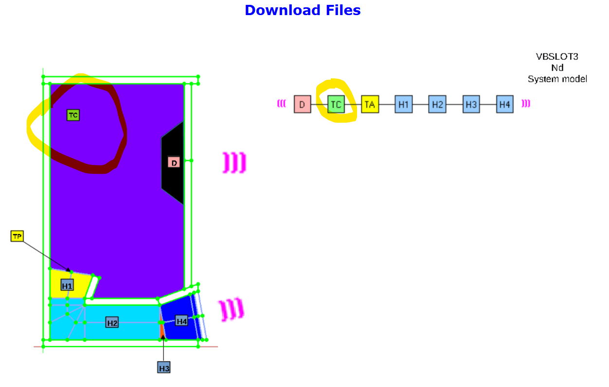

I’m gazing upon a sheer cliff with how I am finding this learning curve. Not really getting anywhere by studying the examples, as even more confused now with the driver volume being called all sorts of things in the system models
Take the VBSLOT3. This is a driver volume and flared ports, much like what I am trying to model
The driver volume is called TC in the drawing and system model, but I somehow I can't find how to create/set/edit such a driver volume so that HR can show me my 20L as the green TC system model component. Does TC mean throat chamber? So a driver volume is called the throat chamber? Then what is the TA in the system model and TP in the drawing in yellow? Why are they labelled differently like this? The only thing that I can understand is the H!-H4 being pipe segments
What is the purpose of TC, TA and TP in the system model? But then any understanding gets blown out of the water when I look at VBSLOT2
Here, the driver volume is called RC? Why is this not done with the same system model component for the driver volume? Why not TC again?

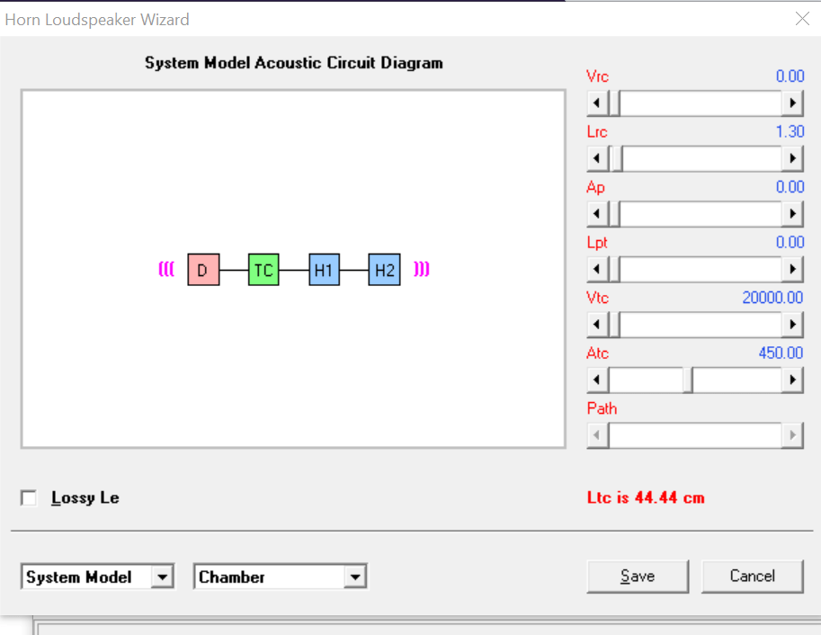

I have worked out how to set this string using the first segment for driver volume and the next two segments as the two parts of the port
But totally lost on how to add the green TC and yellow TA/TP components instead of the H1 above in the same way as in the VBSLOT3 model
I can see how this makes me look a bit slow, but yeah, really struggling to make head's and tails of this

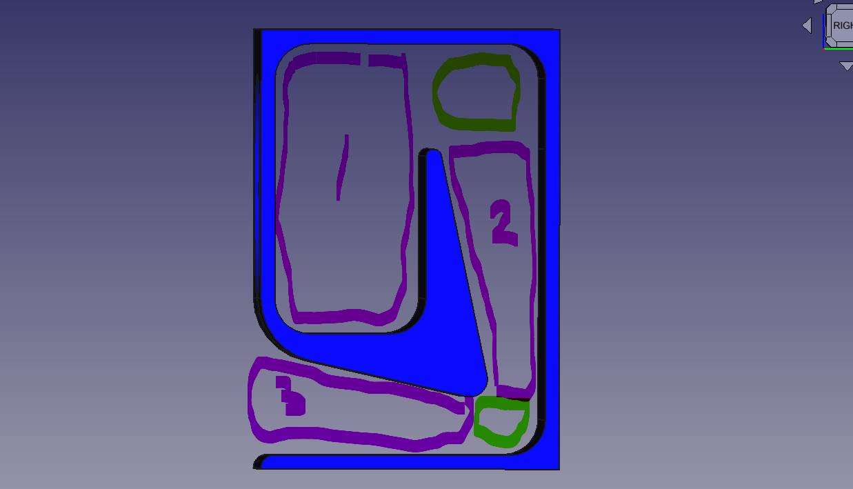

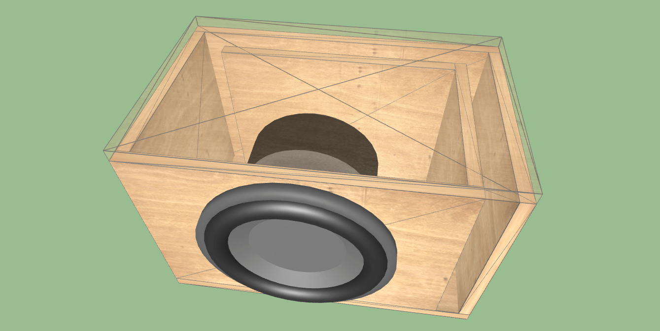

How does Hornresp see this cab? Is the breakdown in the pic valid?
1 - this column of air is the driver volume? 172mm x 340mm base and 330mm height
2- this tapered column is the first port segment? 120mm x 340mm fat end opening and 60mm x 340mm thin end. How does Hornresp see its length? Is that the full height, including the top and bottom green blocks?
3 - this tapered column is the second port segment? 120mm x 340mm on the exit and 60mm x 340mm at the elbow
Those two green blocks at the intersections. How does Hornresp deal with those?
Is it valid to set this as a 3 segment TL like so? I have set port lengths at full length of the longer wall and set the driver volume as parabolic and ports as conical. Please bear in mind that this is just for illustration and learning so I may correctly go on to adjust things until I get close to the desired response

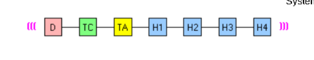

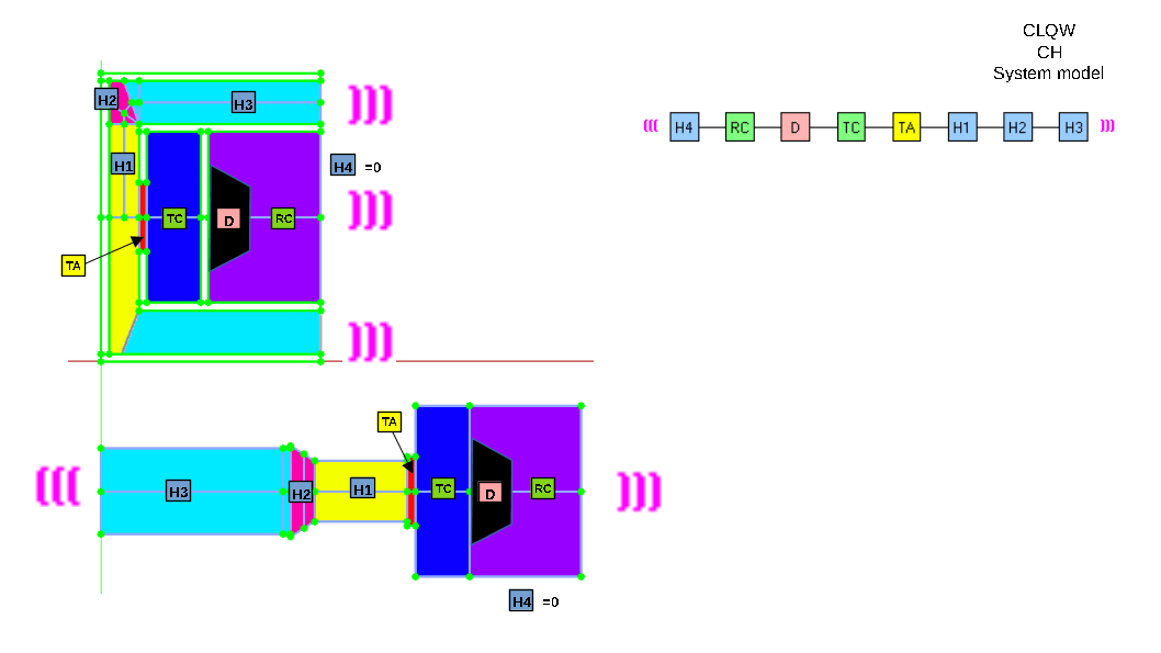

The trick part is that we use the system model ND, but it's inverted
As I mention, this model is inverted, so TC (Thorat Chamber) in general, is the volume of the chamber in front of the driver while RC (Rear chamber) if the volume of the chamber in the back of the driver.
Attention that the volume refer to the chamber, not to the driver.
Take the attached image as an example.
TC = The volume of blue space
RC = Volume of the purple space
If you want to improve further the precision you can also consider:
TC = The volume of blue space + volume of the air inside driver's cone
RC = Volume of the purple space - volume of the driver
The segments are the volumes of the spaces between the chambers and the air outside the loudspeakers. The geometry is very important for them, so for
the segments you need to specify how the volumes changes according to the length. For a while, assume that they are Parabolic flare, so set them to be PAR. You will understand in the future.
H1 is the first segment, for ND model it connects TC to H2,
H2 segment connects H2 to H3
H3 segment connects H2 to H4
H4 segment connects H3 to the output
The system model with the lines will indicate how those boxes are connected and arranged. What are the paths where the air can move.
For Nd model you have up to 4 segments to use, but if you model is simply, you can use only one, is up to the user to define the amount of segments to use.
For your model, you need at leas 2 segments in order to consider those areas variations due to negative and positive flare you want to implement in the vent.
Each segment to be specified requires 4 inputs:
1) Area of the throat (entrance)
2) Area of the mouth (exit)
3) Lenght
4) Flare (assume PAR)
Note: Your green areas needs to be incorporated in the segments.

I think this is the only part that I sort of understand how and where to enter and edit. For my model, I can't seem to work out which menu/feature to use to create the RC, and TA if needed
Am I understanding correctly that if I reverse the driver so that the magnet is in free air, the drivers working volume would be TC instead of RC?
Many thanks again for trying to help me learn

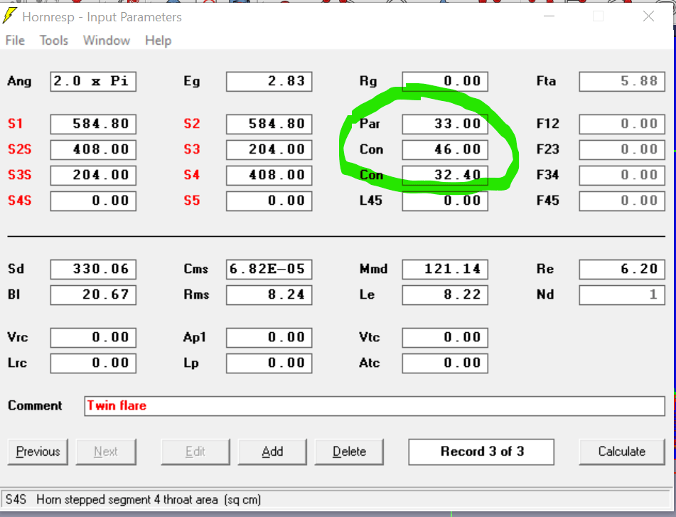

Is this about right? Does my model need a TA too? I am guessing that it does not
I hope this is done correctly. I changed the segment area and length until I had 34Hz Fb. It seems that increasing flare to my original board angles gives a higher Fb around 60hz
If I have learned to do the two part port with angled boards correctly, I would like to try using non-tapered segments but with a radius at the entry and exit. I think HR allows for this, but I can't seem to locate where and how to set this

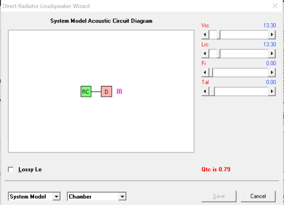

A bass reflex cabinet does not have a throat in front of the driver, so does not need a throat adapter (TA).
In alphabetical order (as of https://www.diyaudio.com/community/threads/hornresp.119854/page-542#post-6234405):
AC = Absorber Chamber (light blue)
AP = Absorber Chamber Port (yellow)
D = Driver (light red)
H1 to H4 = Horn Segments 1 to 4 (light blue)
PR = Passive Radiator (light brown)
PT = Offset Port Tube (yellow)
RC = Rear Chamber (light green)
RP = Rear Chamber Port (yellow)
S = Stub (yellow)
TA = Throat Adaptor (yellow)
TC = Throat Chamber (light green)
TP = Throat Chamber Port (yellow)

To model my speaker, I found that @LORDSANSUI's advice to use the Nd model in a similar manner to the VBSLOT3 design allowed me to create the two port segments. Since this uses inverted driver, the driver volume is now coded as TC So how anal is HR about such coding? The question is unanswered if such a model needs that interface

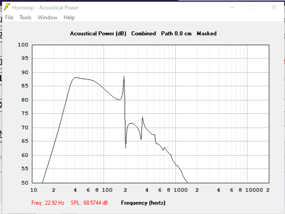

This is what I have observed while trying to model with these high power, high excursion and low Vas DS18 drivers. Since these are being used for 'subwoofers' to work in the sub 100Hz band. The driver volume and port just cant help but fall in that zone aspect wise where it becomes a linked set of segments rather than a main volume exciting a smaller port volume as in old school style BR. Folding cant be avoided either if keeping decent cross sections
This is why I have turned to HR, to see if those large port segments can be manipulated to an advantage. I do think this is a necessary direction to explore with these drivers if vented systems are to be moddelled effectivaly
Now I have no idea if I am modeling in HR correctly now. Will wait for confirmation on this to proceed with confidence

Yes they can
Angling the boards to twin opposed flares models degenerated response over parallel sided running the cross-section at the elbow full length so a fail
Running an angled board at the exit with a shorter of the two segments is effective if the longer segment is parallel and same as the x-area of the elbow, if that longer segment length is increased
Running both segments with parallel sides and same x-area as the elbow is the most effective and resembles the WinISD model for BR. I am guessing that the potential to sound like a poor aspect BR is there if it can 'tuba'
Running a longer and larger tapered port where the entry is 80cm2 and exit is 500cm2 and as well increasing the Vtc/Vb to 30L is also very effective and on the larger 50L side
Getting rid of the driver volume as such and just modelling a narrowing taper TL is very effective with the flattest response that also reaches the lowest
Turning that TL into a widening taper is also very effective, if the TL length is increased
