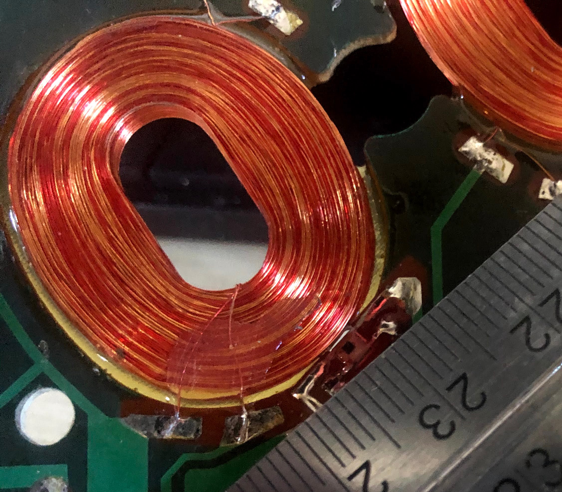

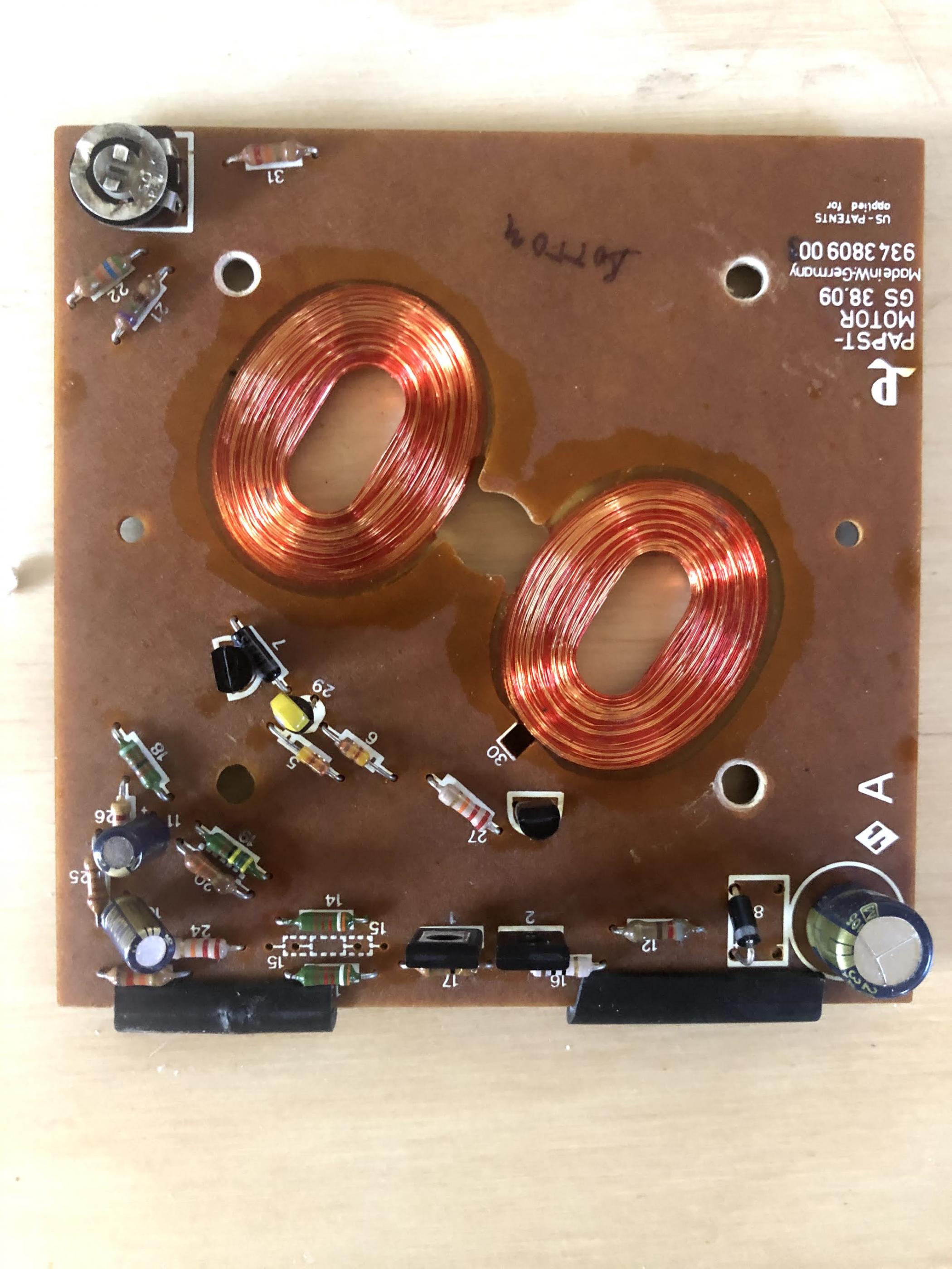

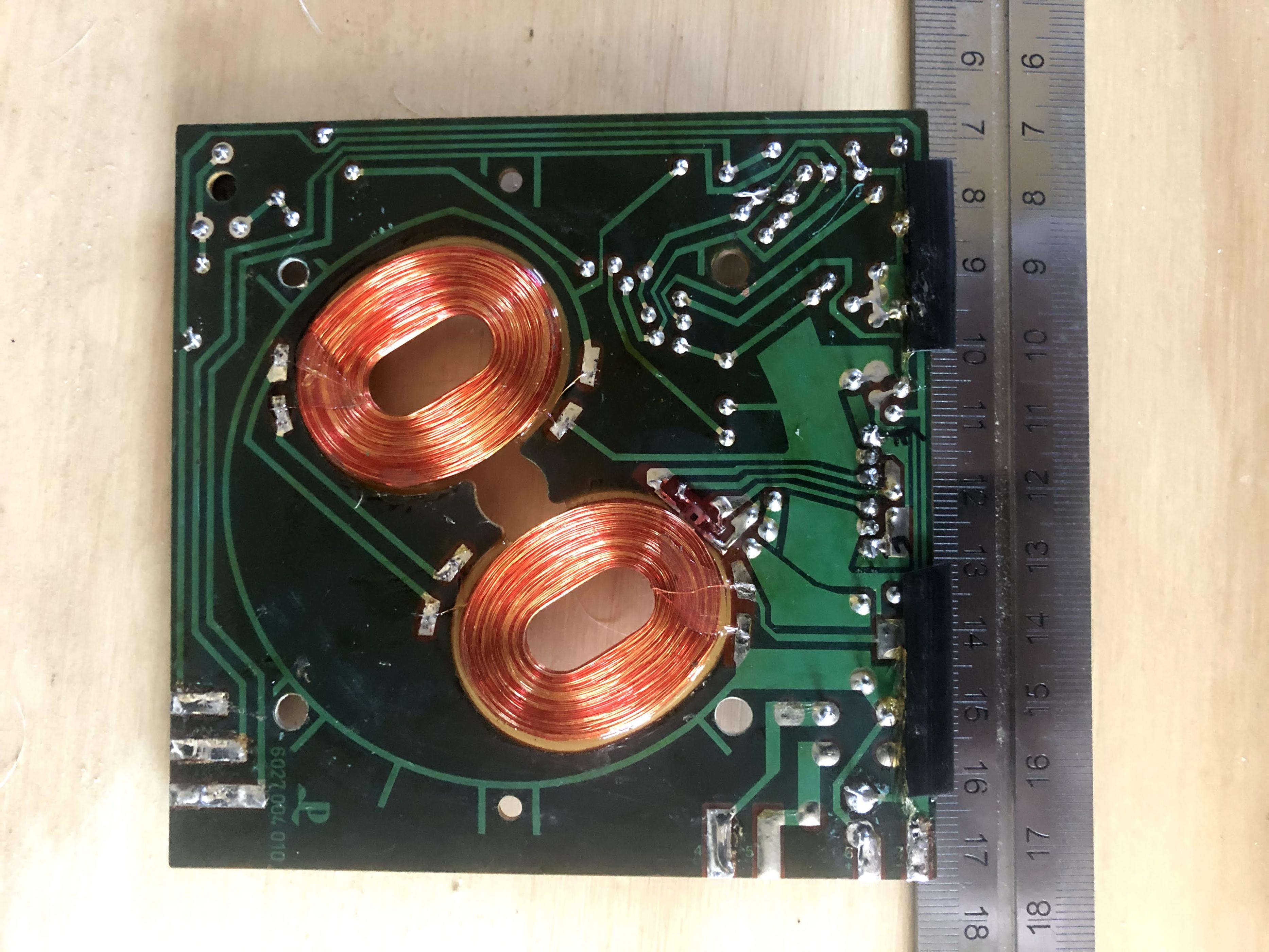

Attached are photos of either side of the circuit board that contains the motor windings and the hall sensor, and a close up of the hall sensor with a ruler for scale. Also attached is the data sheet for the hall sensor.
As far as how the tech diagnosed the issue, if I'm remembering correctly he said he wasn't getting a signal at the transistor(s) that the hall sensor feeds.

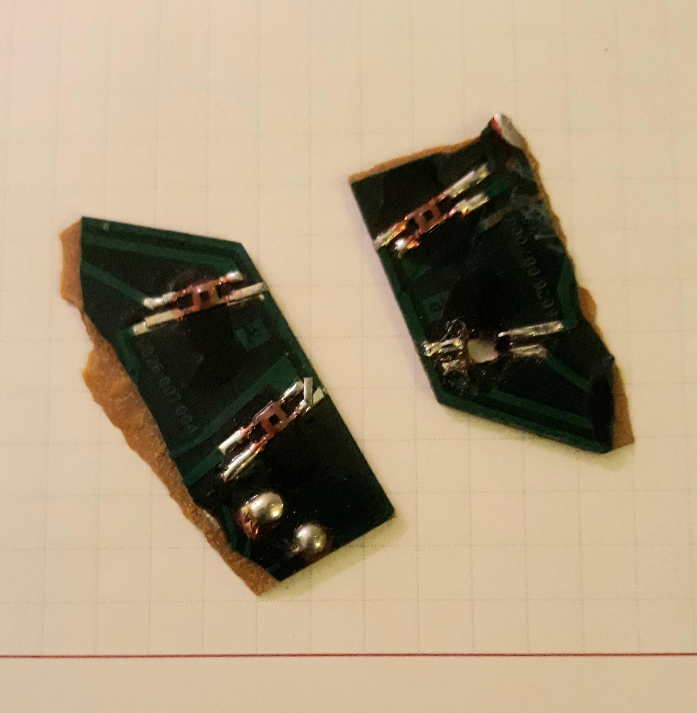

Hi All - I recently bought a Harman Karon ST-8. It worked for a little while, long enough for me to start to really like it, and then the motor - a Papst GS 38.09 - conked out. I asked a tech look at it, and he diagnosed it with a bad hall effect sensor, a photo of which is attached.
Apparently, dual output hall effect sensors with leads (as opposed to SMT) can not be found. Also, replacement motors also can't be found - I have an eBay search saved just in case one pops up, but so far, nothin'.
So, I'm wondering if anyone has any ideas on how to make the current motor go, or barring that, any ideas on how to replace the motor all together? I don't mind it being a little kludgey.
Thanks!

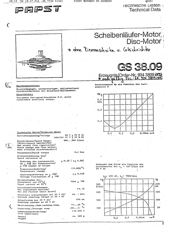

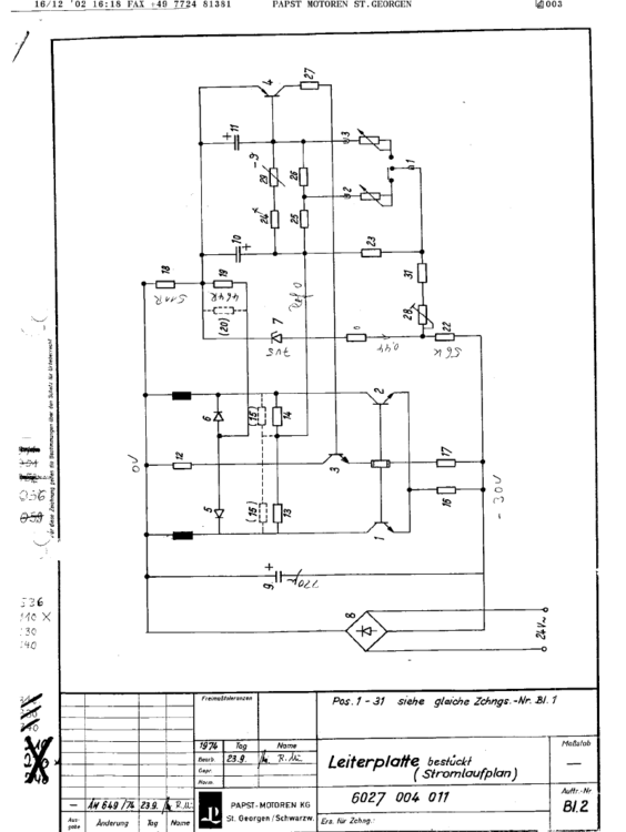

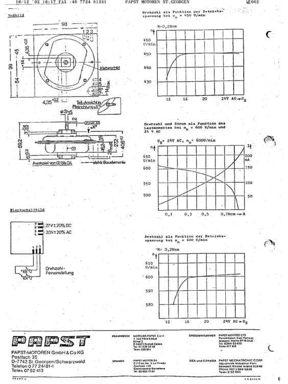

here are the low resolution data sheets so as the circuit diagram
circuit3.thumb.png.44a5dd22f648bfe6e4c28ca241371fc3 (1).png52.7 KB · Views: 421
dimensions2.thumb.png.2930750cb28e4d1ddddfa40d5ee9f470.png85.7 KB · Views: 430

maybe the mentioned hall elements undercheck out this thread:
Dual EDS 1000-2 defekt - hall ersatz? - DUAL << Plattenspieler und Plattenwechsler >> DUAL - Dual-Board.de
there is reported step by step (and good pictures), how the SBV566 is to replace by a currently available replacement.
I think, it doesn't matter, that the motor is another model - the used hall generator is the same - at least according this thread.
Hall Element
are also suitable
Papst GS 38.09 - own created Schematic
as supplement my own schematic with values for voltages while rotating (for better understanding the theory of operation and more success by troubleshooting).here are the low resolution data sheets so as the circuit diagram

Hi all, I am currently working on a Papst GS 38.09 motor from an early Oracle Delphi turntable and have a couple of questions that I hope someone with more knowledge in electronics than I, can answer.
The circuit diagram for the motor electronics (see post #29) shows tantalum cap 10 with what seems to be the wrong polarity, this is also how it is installed on the pcb. What effect will this have on the performance of the motor?
Also, there is a component (29) on the pcb that I understand is a 40k thermistor. Does this device have a roll to play in the speed stability of the motor and, if so, would it be worth replacing it with a more current, accurate and stable thermistor?
