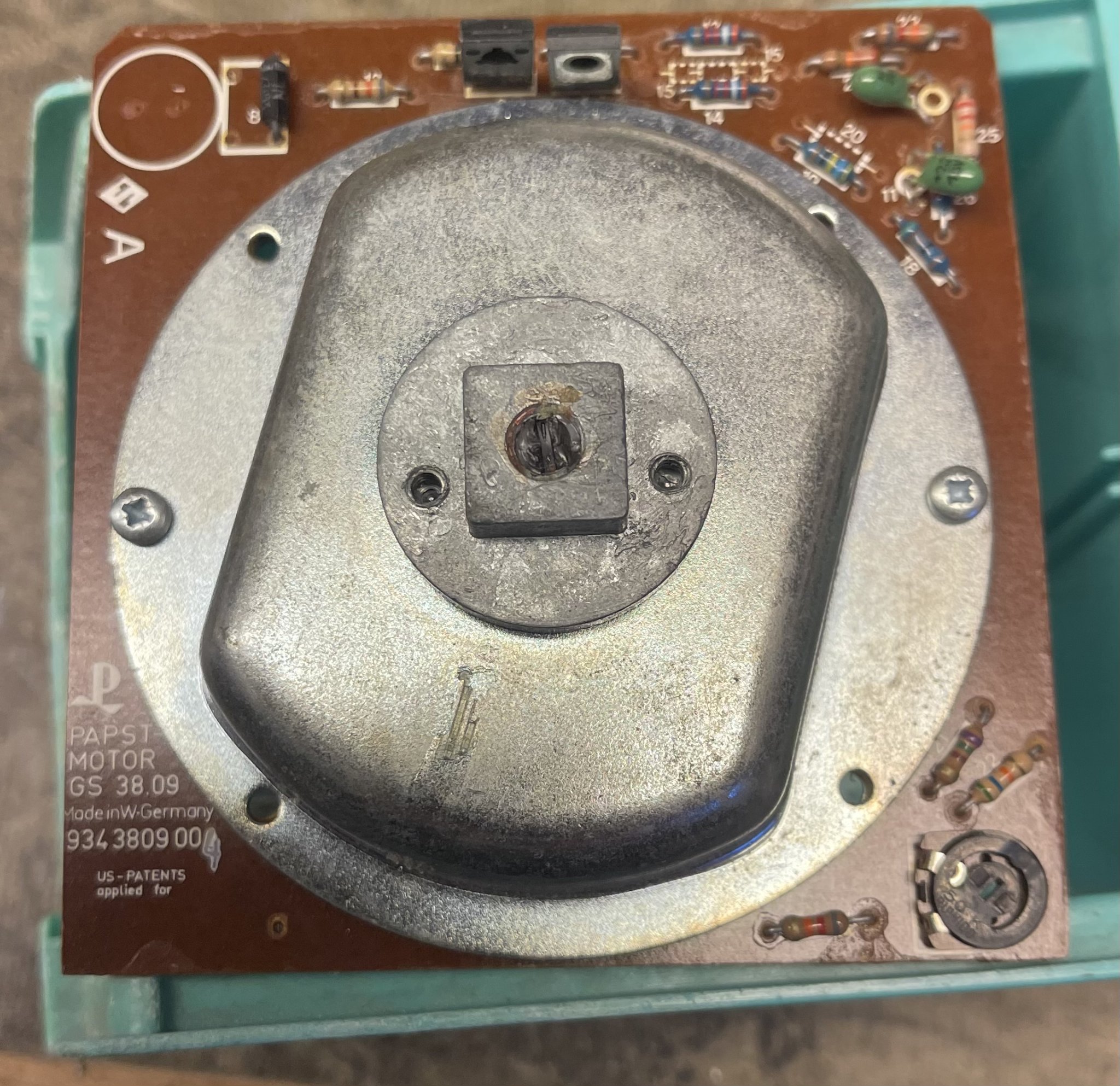

Fixing or replacing a Papst GS 38.09 in a HK ST-8?
This post is to update where I am at with the speed stability of my Oracle Delphi. While I am not clear about the role of the thermistor in the motor control circuit I don't think it's contributing to the problem. As previously noted, I have replaced most of the active components in the circuit and the passive components all seem to check out okay. I am also comfortable that the power supply is not a factor - I can vary the voltage on the bench power supply from 20 - 40Vdc without affecting motor speed. Even the very basic original Oracle wall-wart supply works fine.
My latest efforts have focused on the main bearing. I have carefully cleaned the bearing bushings and spent some time polishing the spindle to a mirror finish. I have also experimented with higher viscosity oils and am currently using Sonic Super Oil, an ISO48 grade synthetic oil sold for in-line skate bearings. The end result is that the platter speed is now significantly more consistent at +/-0.2% and wow has reduced from +/-0.08% to +/-0.04%. While I am pretty happy with these numbers I anticipate better results with higher viscosity oil and have some ISO22 synthetic oil on order.

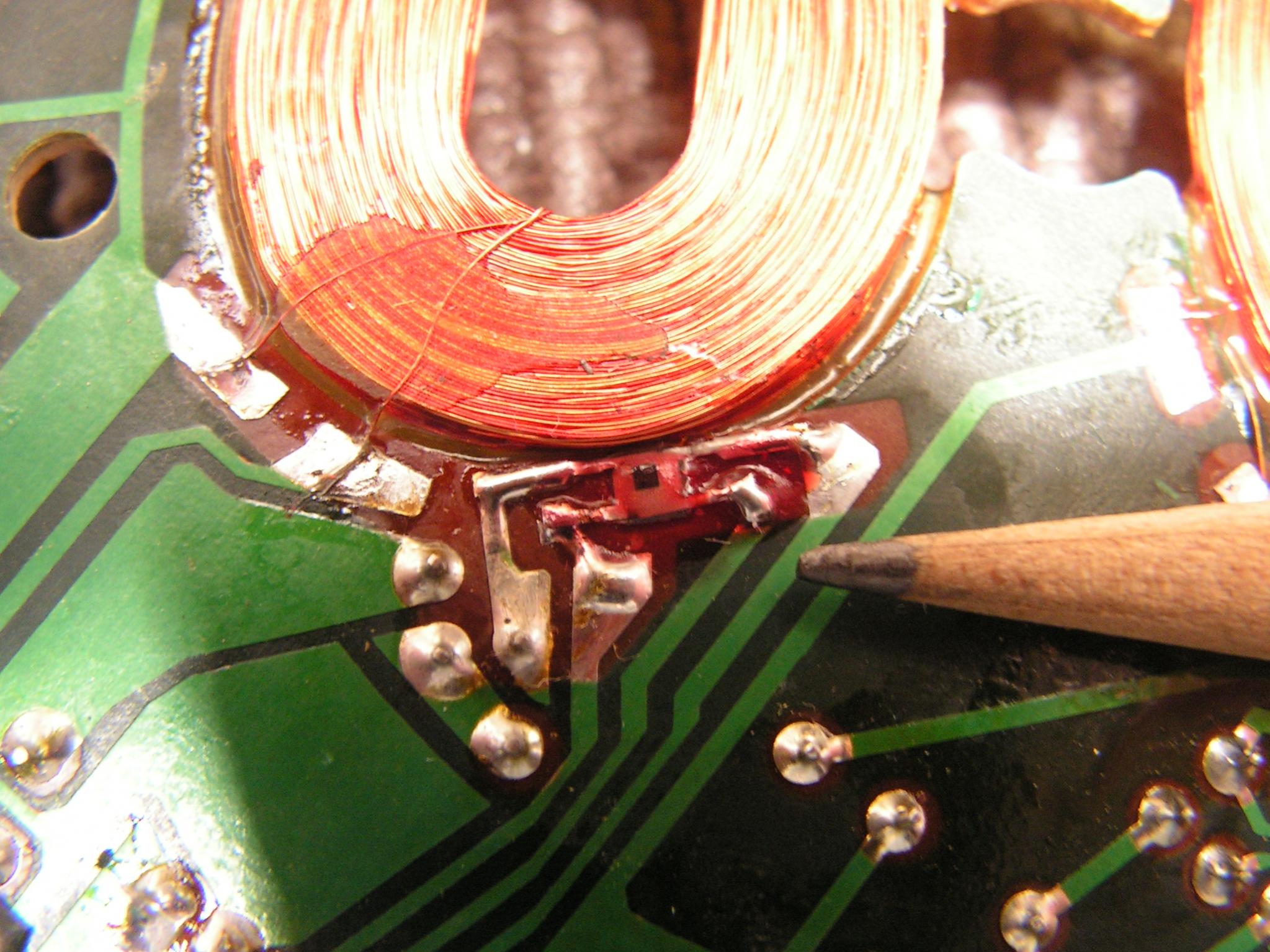

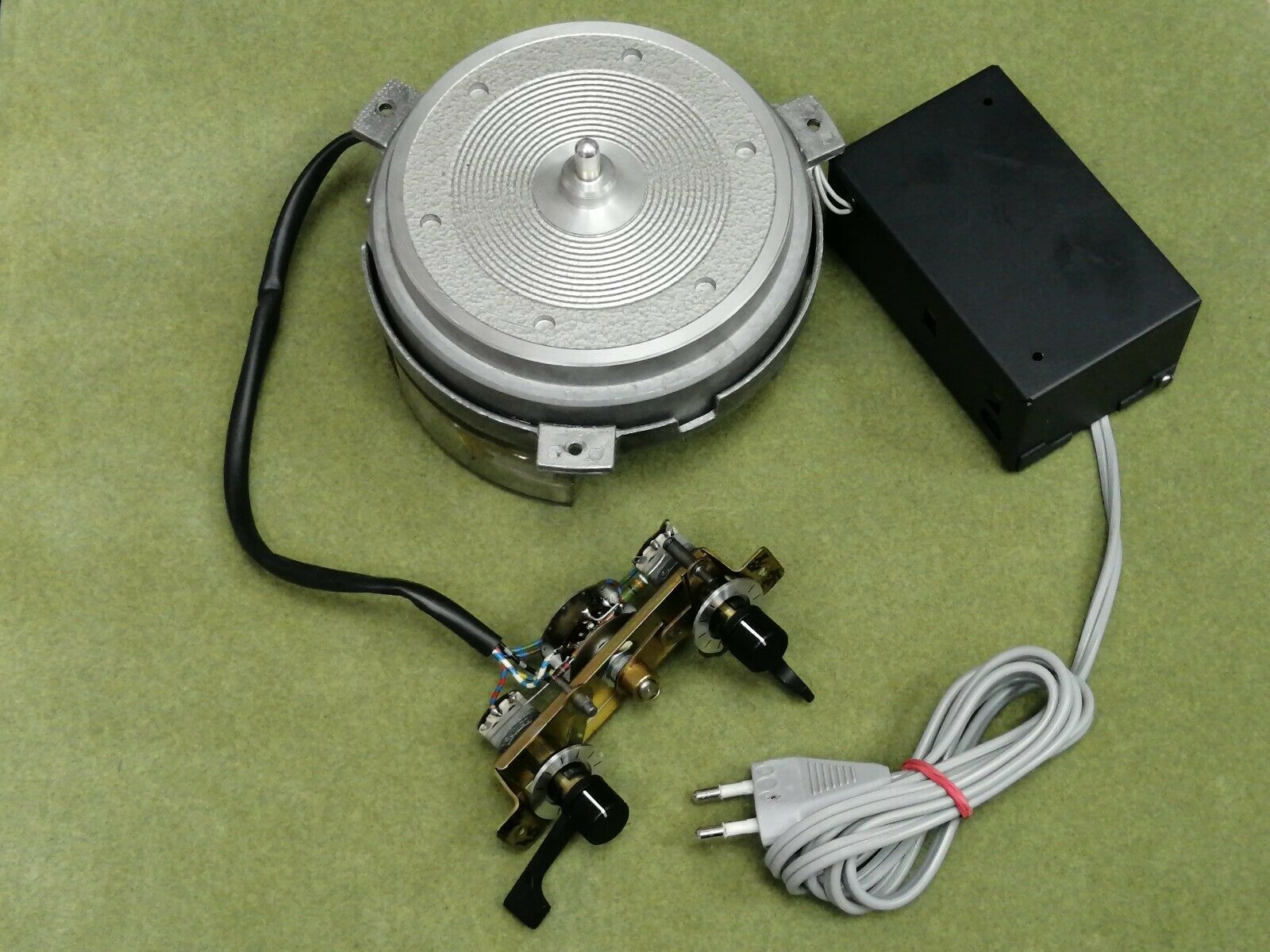

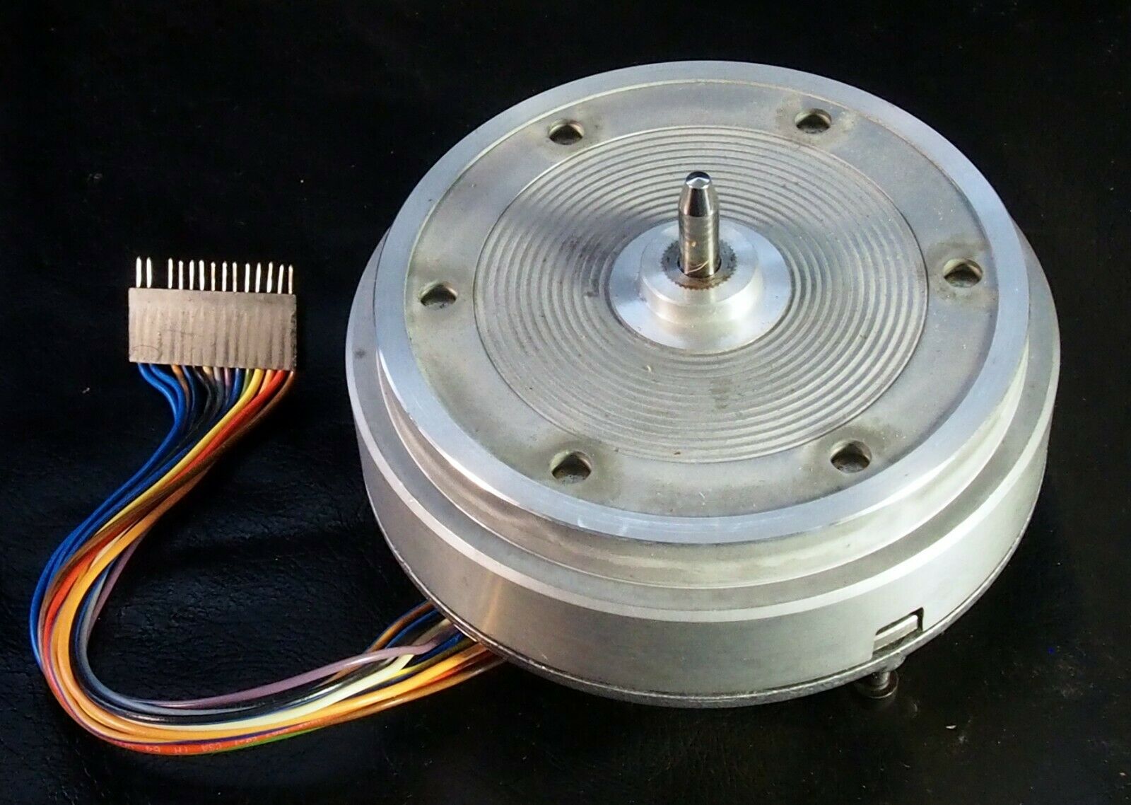

Yes, Tief writes "wrong polarity" in his lovely schematic, but
who is he to decide ? Papst sold thousands of motors like this.
The whole construction is "unusual". If in doubt I will apply
supply voltage and check it.

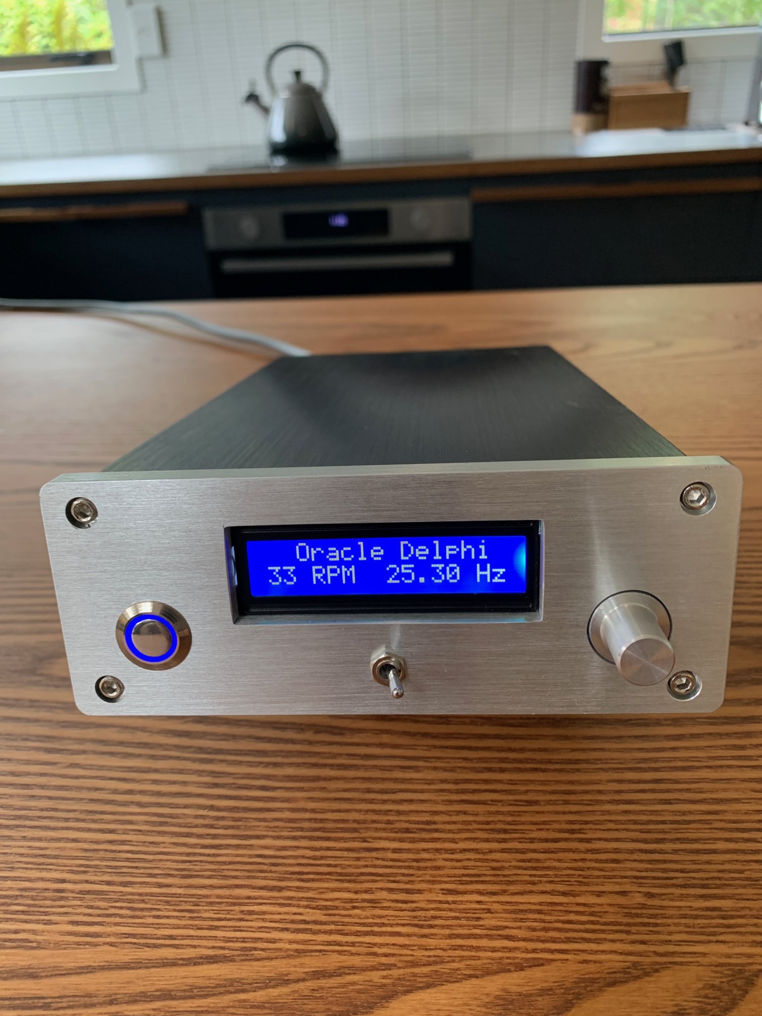

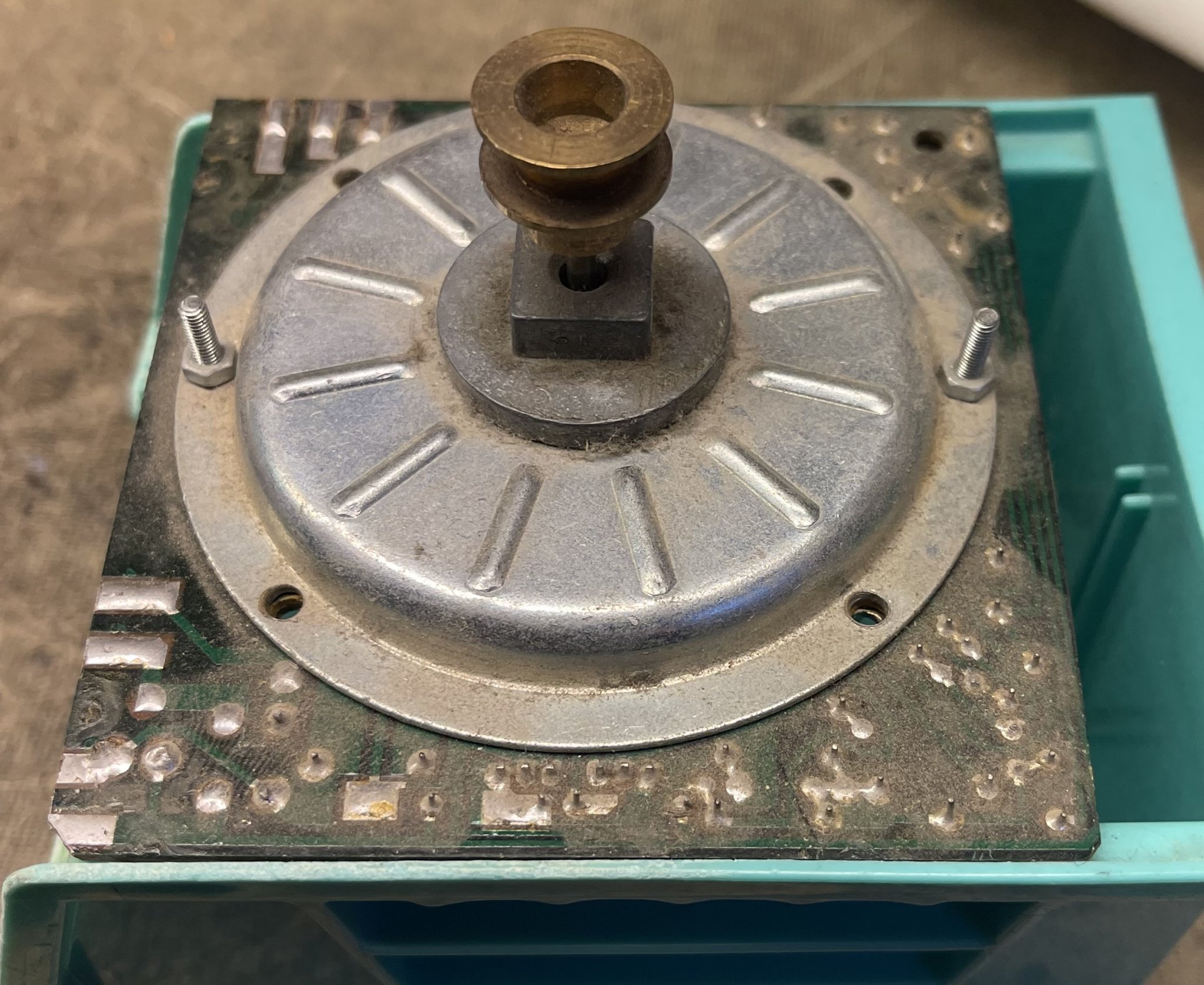

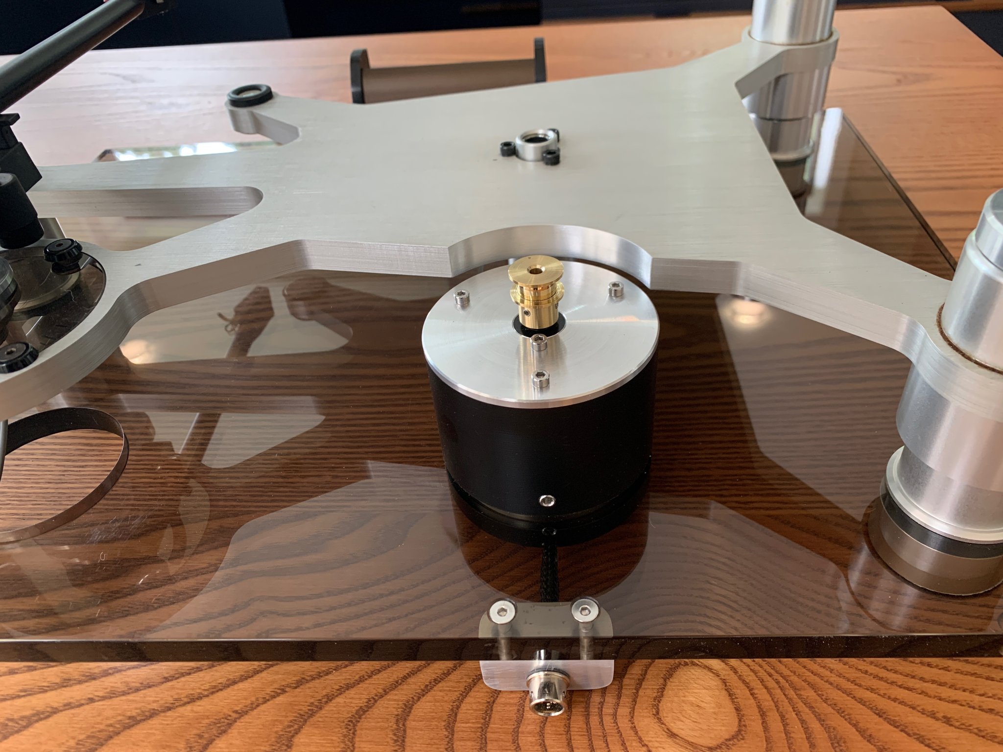

An update on where things are at with this turntable and motor:
- Motor : I finally gave up on the old Papst motor, there was nothing I could do to get it run at a consistent speed. Every time it was turned on it ran at a slightly different speed.
I replaced it with a 3 phase BLDC motor driven by a sine wave generator and 3 phase class D amp.
(www.diyaudio.com/community/threads/diy-4-phase-sinewave-generator-for-turntable-motor-drive.298018/ and www.diyaudio.com/community/threads/3-phase-class-d-amp-for-diy-bldc-motor-drive.307918/
The result is a very quiet, virtually vibration free and accurate solution. I am very happy with the end result.
- Turntable : After spending some time attempting to get the best out of the platter shaft and bearings I decided to replace the bearing bushes. It turns out they are fairly standard composite PTFE split bearing bushes. With some care it was possible to press the old bushes out and replace them. When I say "some care" it did involve fabricating specific mandrels for the task!
The advice with these type of bearings is that after a run-in period some of the PTFE will transfer to the shaft and performance will be optimized.
To measure relative friction levels I did some very basic tests which involved rotating the platter to 20 rpm then counting the number of revolutions before it stopped. With the original bushes lubricated with ISO 100 synthetic oil the platter would stop after 6 or 7 rev's. With the new bushes and no lubricant I was getting 4 - 5 rev's. Lubricating the bearing with 2.5ml of ISO 100 oil improved this to 20 - 21 rev's.
The other area I was concerned about was the condition of the captive ball in the shaft and the ceramic thrust plate in the bottom of the bearing - both were showing signs of wear. Despite my best efforts involving all sorts of solvents and the application of heat, I wasn't able to remove the ball. However, by gentle tapping the side of the ball with a light hammer and a brass punch I was able to rotate the ball in the socket moving the worn area to one side. I also replaced the thrust plate with an acetal disc the same dimensions as the original plate. I would have preferred Delrin but didn't have any to hand and thought, in this application, the difference would be minimal. After this the 20rpm to zero performance improved to 23 revolutions. I am now reasonably happy that I'm getting as much out of this bearing as reasonably practicable.
