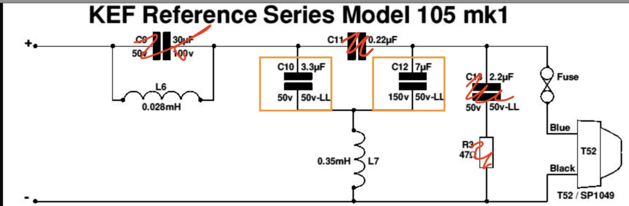

I am temped to replace some of the non-original caps in the xo filter to tame the highs…
fact is… those caps now in place seem not to follow the schematic as published in this post (next to that, I am pretty sure kef would match cap values per unit so … veer from their own ‘official’ values for each specific case).
is there an alternative schematic of the xo filter or can anybody confirm that one, at least..?

the schematic of the Ref 105.1 crossover in post #1 of this thread is correct.

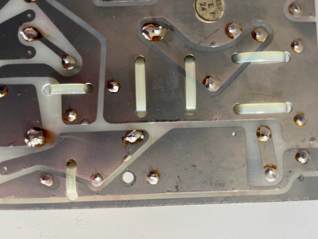

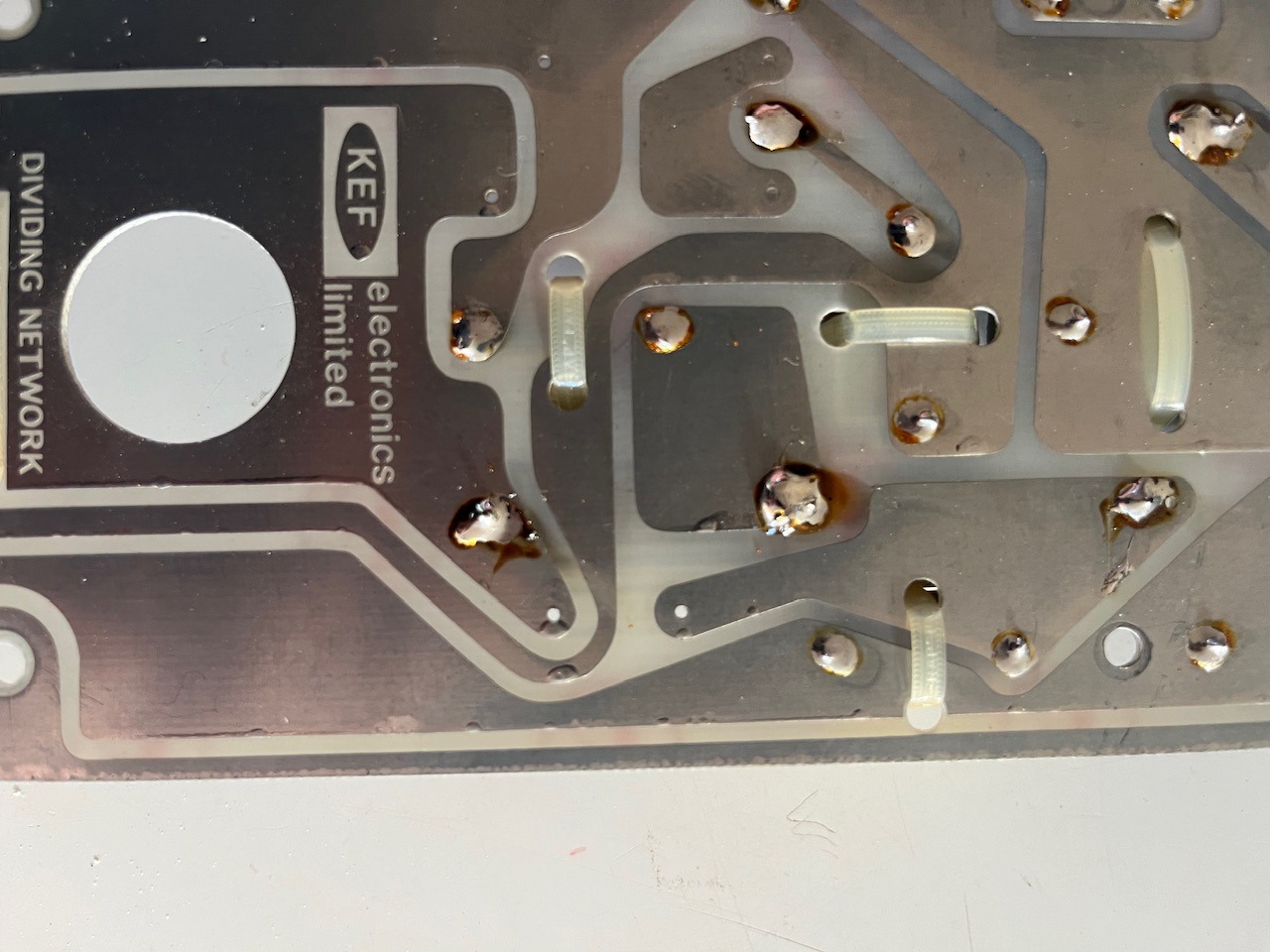

your suggestions sounds logic and good yet … on the original boards of my units many parts were simply not there
straight out of the factory (see image).
that'd make for very different values in the caps, I'd think..?
this is how the xo for the tweeter came (crossed red parts have never been there):
yes, although that'll take some fiddling because the board is attached behind the twisting support of the head.
yet… I'd expect the values of the parallel caps to definitely be different..? considering they do not follow any cap on the input line..?

C11 doesn't have a large effect. C13 and R3 do pull the treble down a little, since you mention there being too much. The notch with C9 appears a little dramatic, but I'm only looking from a distance.
On the other hand a few ohms just before the tweeter gives you another route to lowering the treble.

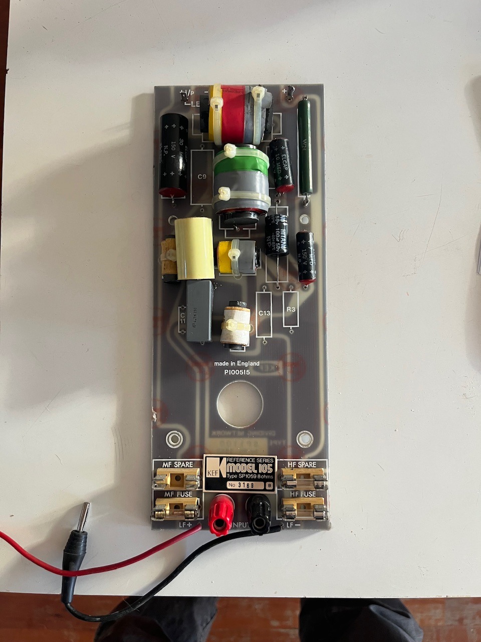

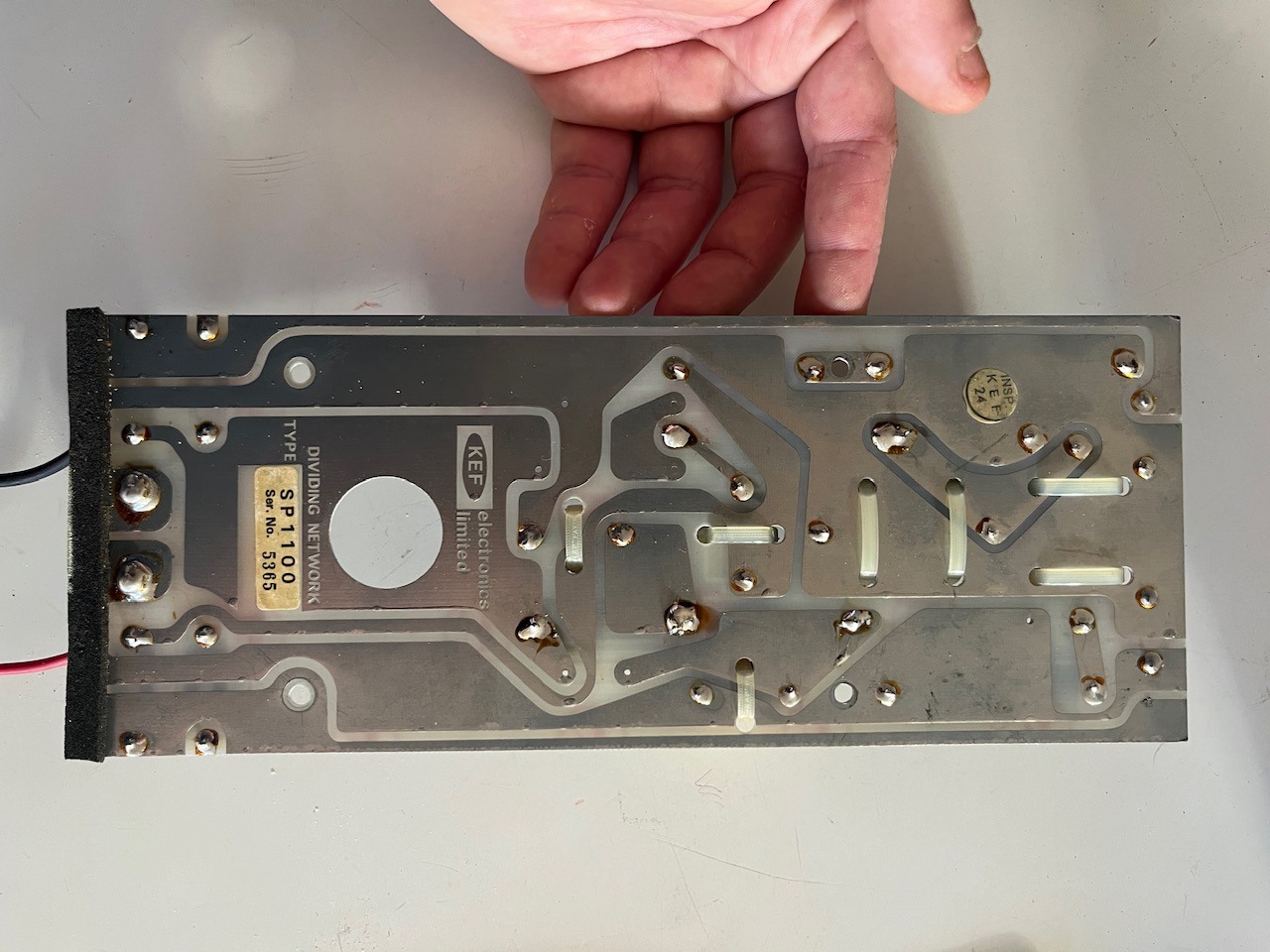

here you go.
as you can see the back of the plate shows virgin holes.
the non-spec caps are the grey and the yellow one, of course

thanks. interesting. so the mid section is untouched apart from C7 where for some reason a lower-quality cap was used. This Hitano cap is not original. It also has the wrong specification it should be 100V. this can be changed with a Mundorf raw bipolar.
Is cap C6, the black 10MFD Elcap on the right side of the photo, fully attached, or is the lower lead to the PCP broken? I can't see it clearly on the photo.

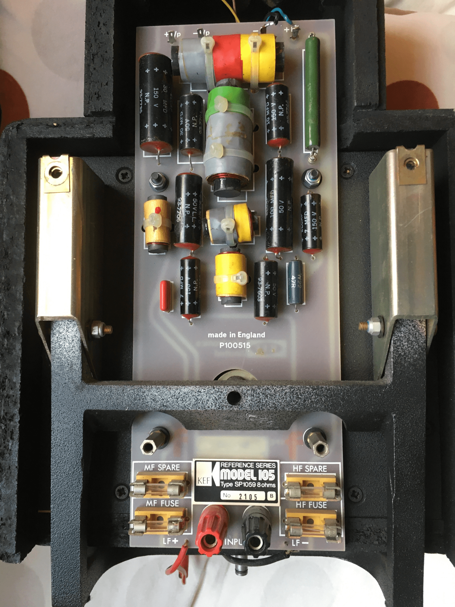

This is how mine looked before recap:
C10 is a low loss ("plain") type, C12 is not, it is "raw"/ "rough" bipolar electrolytic.
On my crossover C7 is also only 50V, factory built. Confusing stuff. I am sure they hand-picked what gave the flattest response.

The other capacitor is possibly also 4.7uF. I am very curious to know the value. Couldn’t you quickly unsolder it on one side and look? The very simple tweeter circuit in old KEF speakers was two 5uF capacitors, and between them an inductor of 0.25mH to ground. As the inductor (here 0.35mH) has not been changed, if both caps are 4.7, the inductor is of a drastically wrong value. But we need to know the value of the yellow capacitor in order to understand this 🙂
