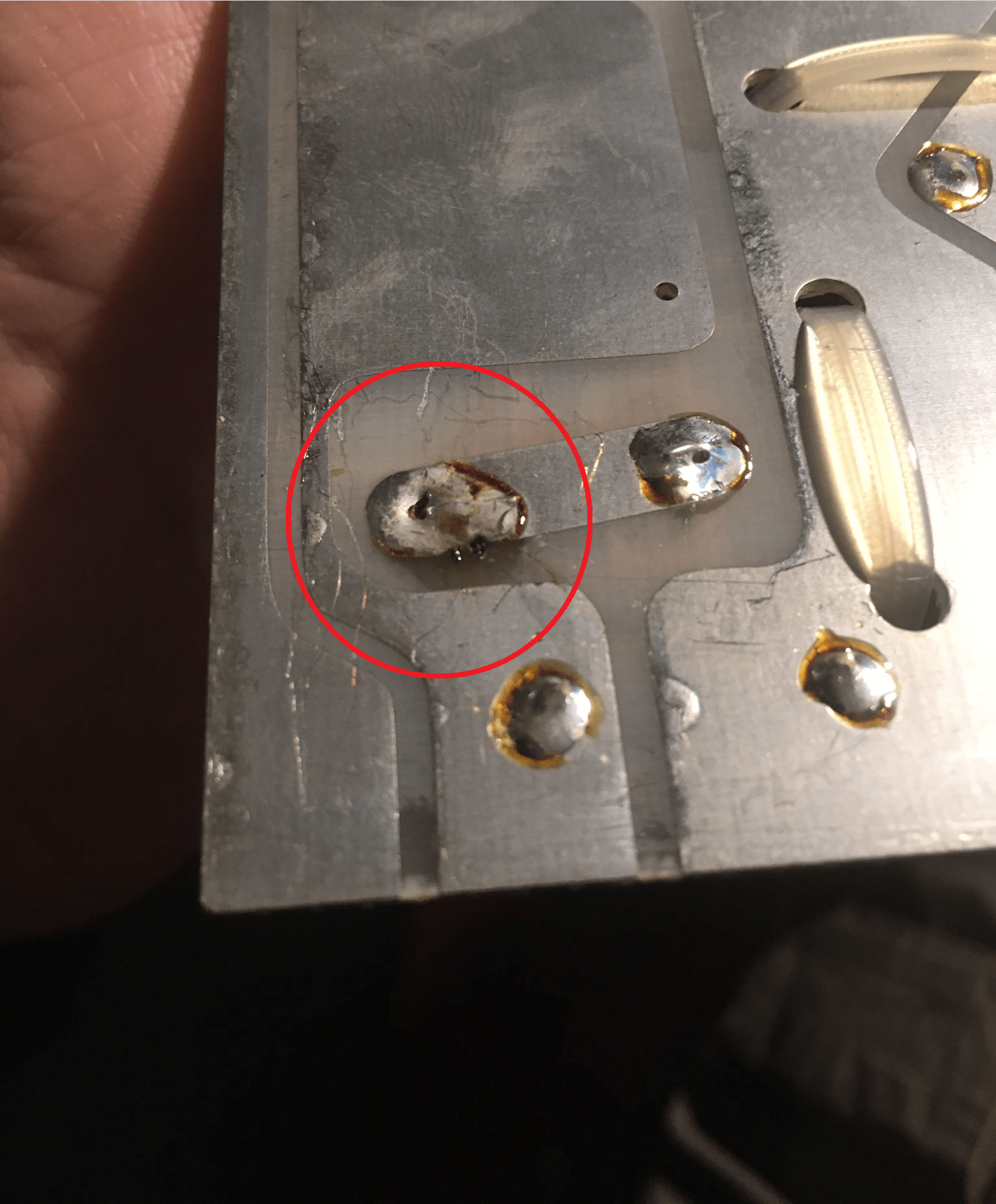

Hi, I have a set of used Kef 105 (first version) and they've been sounding a bit flat. I did a sweep of frequencies and it turns out that the mid range driver in one of the units isn't sounding at all.
I opened it up and skipped out the cross over and played some mid frequency tones and it works. Great! I've not blown any more drivers and don't have to start searching for a matched pair.
I checked the crossover and it has clearly been recapped and more over modified. (I was told it was recapped when I bought it, got receipts too). It was done by a very well known company. Not sure if I should name them or not.
First thing I did was disconnect the tweeter and subwoofer and play a tone through the crossover and lightly tap on the caps. When tapping on one of them the mid range driver started sounding.
Removed the crossover to find that the one of the legs of the cap wasn't solder to the board at all, it was a completely dry joint. I resoldered that and reassembled.
The driver is now sounding, but is way quieter than the other. I am a bit of a loss as what to do. Because the crossover has been modified I am not really sure whether I should go around testing all of the caps and just replace the ones that are out of spec - I mean the speaker is working, right? Or whether I should return the crossover to the original design.

This is a picture of the cross in its current state, also a picture of the dry solder joint before I resoldered.
Any advice as to how to proceed is welcome, my gut says cut my losses and restore them to original.

If it's way quieter than the other mid, you'll have to check those two drivers against each other for sound output at some reasonable input level. If they match there, then go after the crossover components. Or maybe it's easier to just measure all the caps, if you have the tester that can do so.
Interesting how they pulled the Zobel off the tweeter. Being a KEF crossover, some components are there just to help present an overall "resistive" load to the amplifier. Burner components; but you can hear them because the amplifier "feels" them in the speaker load. Gets expensive to replace with better than stock quality.
Good point, I'll do that - issue is that the 105 is a bit of pain to work on. Lots of screws and panels.If it's way quieter than the other mid, you'll have to check those two drivers against each other for sound output at some reasonable input level
I don't have one, but I've been meaning to get one. Don't the caps need removing from the board to test them?Or maybe it's easier to just measure all the caps, if you have the tester that can do so

Sometimes they can be done in circuit - depending on their connection. If not, it's just one leg.Don't the caps need removing from the board to test them?
Yeah, C13 with R3. What that does is make the tweeter look more stable in impedance to the upstream crossover component network. Someone must've listened to it and decided it sounded more "airy" or something without these parts. I'd replace them, give the original design a chance; see how you hear it.

Okay I just checked and it seems the driver is totally fine. Whilst it's open I'll see if I can find any glaring differences in resistances between the two crossovers.
Otherwise I'll just go for that falcon cap set.
