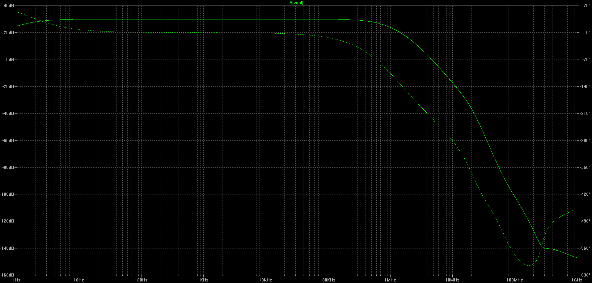

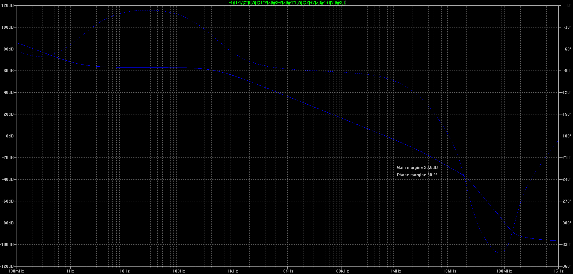

In the given scheme, the right end of the C1 capacitor is attached to the VAS output node, so C1 sees the full output voltage and also bypasses Q2 at HF...according to an article by Samuel Groner C1 is a feedforward/compensation capacitor. The C15 is only there to balance the capacitive load seen by the drains of the input J-fets.
The reason I tried different compensation was that I was not happy with the simulated results for gain/phase margins...and that I was inclined to try new/unconventional solutions, which of course may not necessarily be good thing.😀
After sobering up (thanks Rick!), I went back to the previous simple solution with only one compensation capacitor, but with a high current in the differential tail (11mA total, 2 x 5.1mA for J-fetes + rest for biasing Q10/Q11cascade). It is worth noting that the lower end of the R35 is attached to the tail of the differential, thereby converting the cascade from fixed to floating allowing constant Vds over the input J-fetes.
It would also be a smart move to replace the R7 with a Vgs multiplier constructed around the lateral M-fet 2SK213-216 screwed on heatsink along with the output M-fets so we can easily bias the output stage and have a (more or less) constant output stage bias from completely cold to fully warmup amplifier.

Yup. looks like I've got some study'in' to do -- thanks for the Samuel Groner reference, aparatusonitus. He writes well -- may take me a day or two to digest those 55 pages! And -- exactly what we're working on, is exactly what he described on page 39. Good stuff. Thanks again!

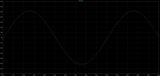

I have questions for you, if you please:
1. I have BC546B instead of BC547B, can they be used ?
2. no trimpot this time ? That would be fantastic. Please confirm.🙂
3. just 2 MOSFETs ? Simulation shows 110 W output @1kHz RMS, great ! Why original uses 4 devices ? Seems that 2 MOSFETs are OK, 21 W power dissipation each. 😕
4. could you specify power dissipation for R6, R7, R8 and R21 ?
5. what kind of caps should be use for C16, C17, C18 and C19 please ?
6. I have C2 and C14 220uF non polarized. Would they work ?
7. I have no room for R29 and R38. If they are mandatory I will try to place them but I would have to drill the PCB. Please specify type and PD please.

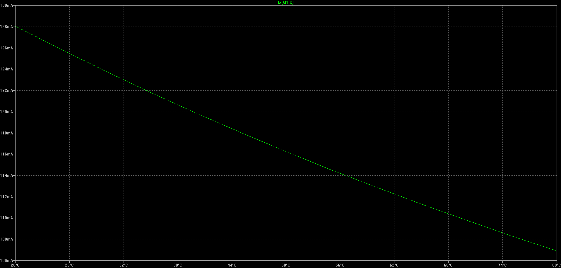

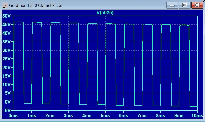

8. I am bad with LTSpice, just basic things. Why the output swings from almost 0V to 45V if I inject square wave @ 1kHz +750mV / -750mV p-p ?
9. which is the value of the quiescent bias current for the MOSFETs ?
Please see attached pictures. I am happy to learn.

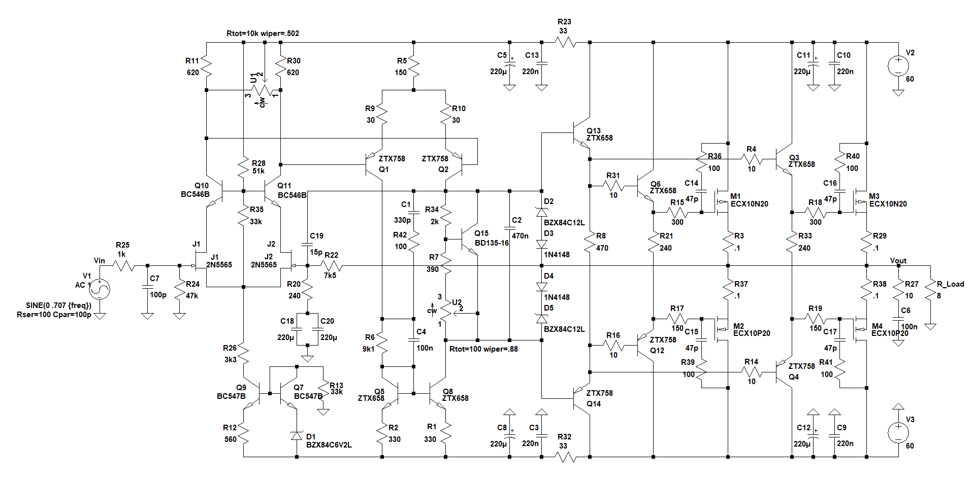

1. Yes
2. Since worst case Vos is 10mV for 2N5565 x gain {10 mV x (1 + 7500/240)} = +/- 32,25mV max. ...I could live with that, but I'll see if trimmer can be put to null output DC offset.
3. Latest .asc file shows 2 pairs of m-fets per channel, dissipation is ~6W per each m-fet in when idling.
4. Just run DC op pnt in LTspice and hover you mouse pointer over component you want to check
5. Polystyrene/styroflex, silvered mica or MLCC/NP0 ceramic
6. They are so called feedback capacitor, ensures unity gain at DC. Also a low frequency pole (highpass roll-off) at fc = 1/{2 x Pi x R20 x (C2 + C14)/(C2 x C14)}. With C2 and C14 in schematic output DC offset is essentially 0V, with out +6,33mV. This will not be the case with real amplifier, see number 2.
7. R3/R37/R29/R38 are not needed if output m-fets are very closely match, beetwin same sex as well as opposite sex (N-ch to N-ch, P-ch to P-ch as well as N-ch to P-ch). It is very likely they are already match in your amp, so don't mix them. If that is not the case, use any 0.1-0.33R/5W resistor you can squeeze in.

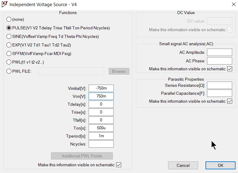

8. 'Cos LTspice will do anything to please you master obiwankenobi😉...use this PULSE(-.032 .032 0 {t_edge} {t_edge} {1/2/{freq}-t_edge} {1/{freq}}) instead for signal source V1. You will see square wave @ 20kHz +1V/-1V p-p. You can change freq. from 20kHz to anything with .param Freq=20k in upper right corner e.g. .param Freq=1k
9. With the R7 = 660 Ohm, quiescent current is ~100mA. You are advice to change R7 slighty to bias output m-fets to zero-tempco = 125mA, see transfer characteristic image Vgs vs Id in referent Exicon datasheet.

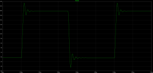

Thank you aparatusonitus, just to avoid spoiling your efforts, here are some points to remark before you bring new ideas and calculations.
If you are making the effort of considering offset null adjustment, please consider that the actual PCB's drawing has the trimpot connected to Q10 and Q11 collectors instead of J1 and J2 sources. The original amp designer copied the same system that Goldmund used in Mimesis 3 and 9. But if you placed the trimpot over J1 and J2 you may probably have a good reason. Placing the trimpot south instead of north is almost imposible because the board has a ground plane in that area and no enough room. It should then be fixed somewhere else or cut traces and run cables of no less than 1.5" or 5 cm. I don't know how harmful could this cabling be...you tell me please.😉

Considering this last schematic version, do you think that I can buy the new part values from Mouser now ?
Thank you so much aparatusonitus, hope your parents be OK soon !

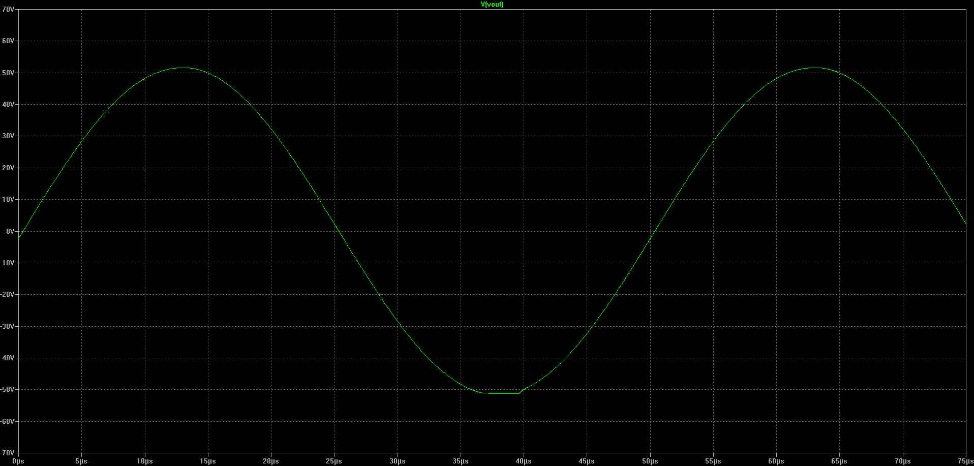

8. 'Cos LTspice will do anything to please you master obiwankenobi...use this PULSE(-.032 .032 0 {t_edge} {t_edge} {1/2/{freq}-t_edge} {1/{freq}}) instead for signal source V1. You will see square wave @ 20kHz +1V/-1V p-p. You can change freq. from 20kHz to anything with .param Freq=20k in upper right corner e.g. .param
Freq=1k
I'll try this, but please, some other time, explain me how come it does not work with a single square wave generated as a pulse. I am very curious about this.🙄
Finally...

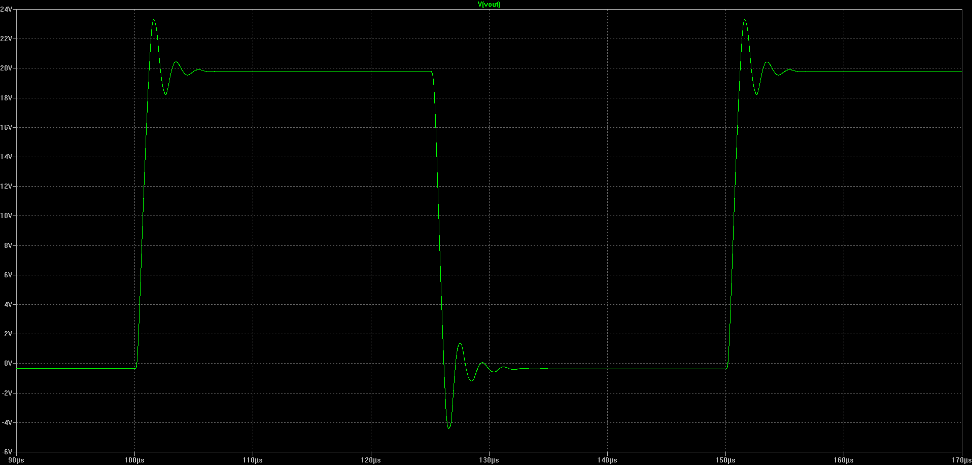

Maybe you will find the attached models interesting. They worked for me. However, you will have to chose for the best from the different files.
Not yet...I would like to see some more opinions/options from others.

Well, I think I've reached the limit in the context of the default boundaries...I can't do better than the attached schematic, so here I draw the line. Now, I leave the development of the schematic with possibly better, more elegant solutions to others.🙂

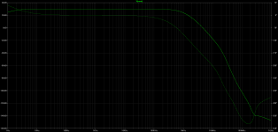

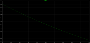

Changes from the previous schematic:
- added trimmer U1 for output DC offset control, if wiper goes open, output stage bias will increase ~13%
-added Vbe multiplier built around Q15 and associated components (trimmer U2, R34, R7, C2), if wiper goes open, output stage bias will be few mA. With a given spice model of bjt's, m-fets, and resistors values around Q15, amp is slightly temperature overcompensated. The correct values will need to be determined experimentally on real McCoy.
- Zobel network (C1 + R42) added to Q1/Q2 collectors, network is part of compensation as well as serve as frequency/phase curve smoothing. Not in the most favorable location (on the left is a relatively low impedance output from the current mirror while on the right is a high impedance output from VAS. It would be preferable to put it on the collectors Q10/Q11 (or the bases Q1/Q2), where the impedances at both ends are in balance, but in the simulator this did not turn out to be a good solution...the stability as well as the response to the capacitive load of the output seemed worse.
- Zobel added over all M-fetes...you know...belt and suspenders approach.
Well, that's all from me...(for now)😉
