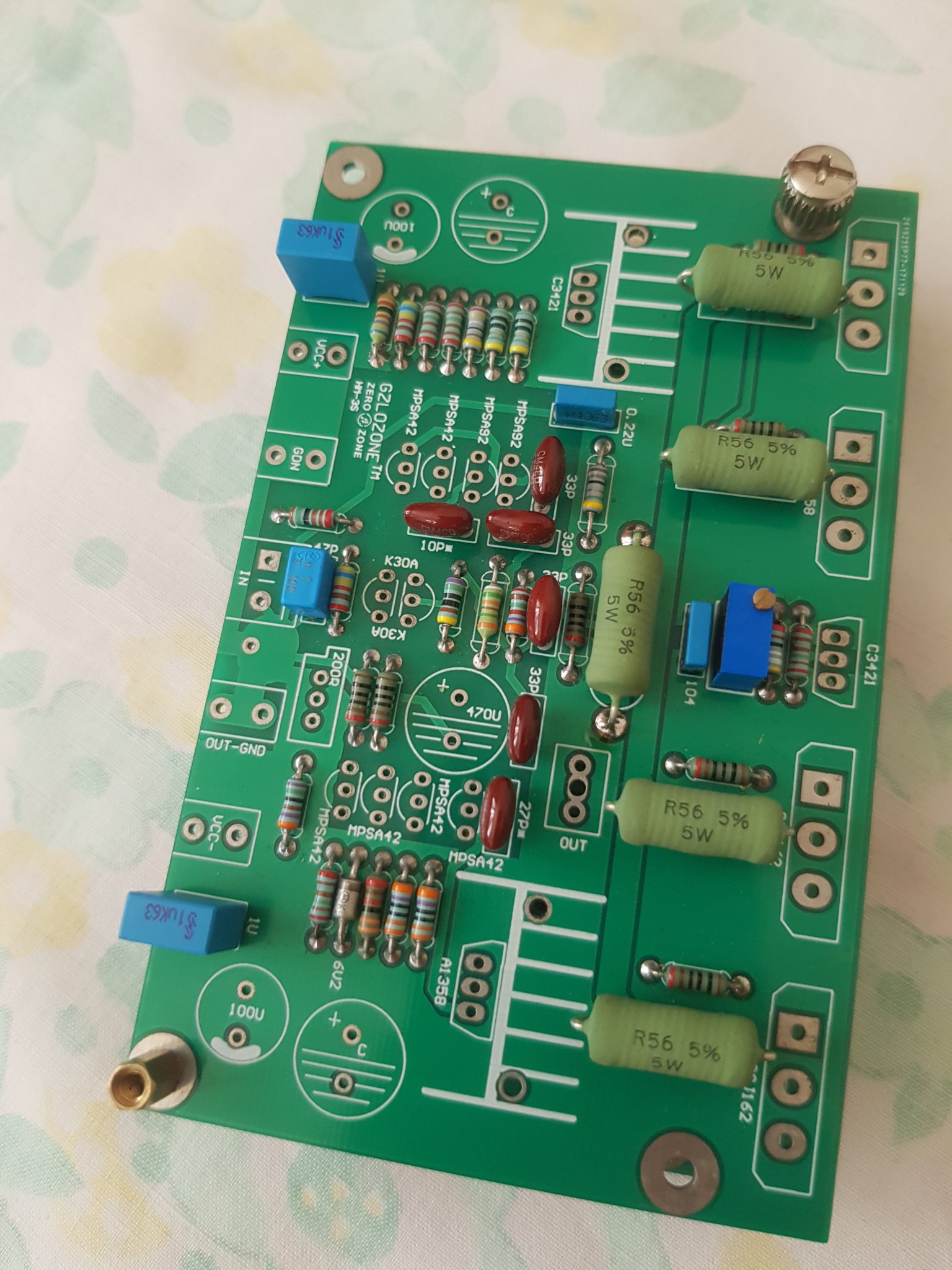

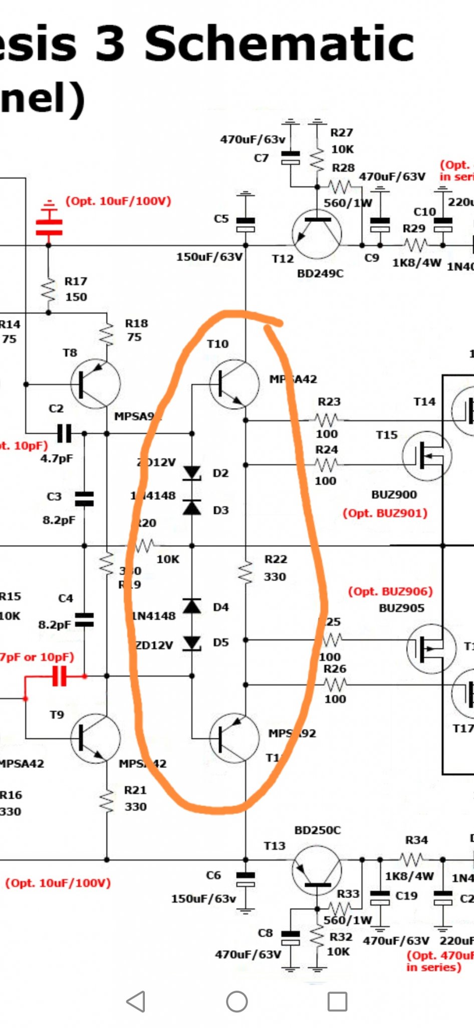

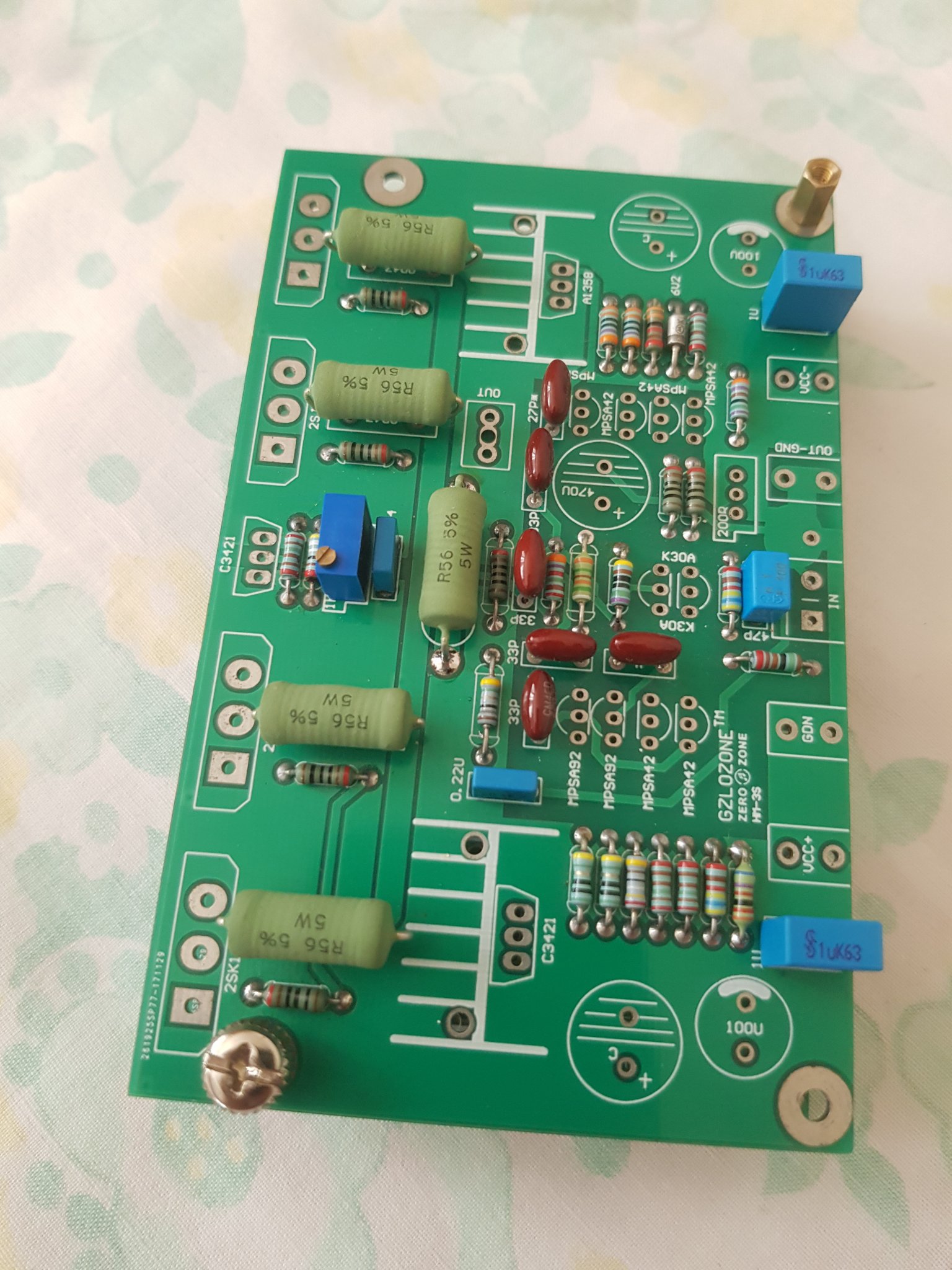

About the upside down transistor, this brought some passionate ideas interchange in that thread. Incredibly, the original Goldmund in that particular model has this transistor connected that way. I recall that some experts said at that time that this should work well no matter how weird it looks. When I assembled the PCB's I bought for this model, I inverted the transistor as I have seen it so many times in the Wilson mirrors. But here I uploaded the original schematic "as is"
This next week I will order the elements needed for the mods. The fixed amplifier will be tested a while and then returned to his owner. For the purpose of the modified schematic amp experiments, I suggest moving to a new thread just to be consistent with the title of this current thread. I will let you know when this happens.

Have to confess, though, my lack of expertise with LT Spice has (so far) confounded my study of the Exicon's stability and bias issues, and the possible magic of the flipped T5. Still pounding away, though.

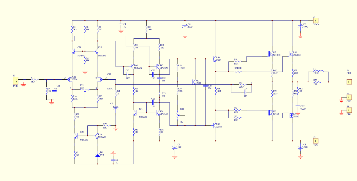

I have a goldmund clone in this schematic. what changes should i make?
R18 is way too small/low. All 4 output devices will be cutoff for a long time while the VAS transitions within ±2½V of Ground. It will also severely load the driver transistors, presumably misidentified as 'R59' and 'R85'. They'll be well over their dissipation rating by the time they stretch that 100 ohm resistor far enough to properly bias the outputs.
Way too many 33pF caps in the VAS. Looks like the designer had a lot of trouble getting it to stop bursting into oscillation.
Agreed. Looks like just another broken design to me.

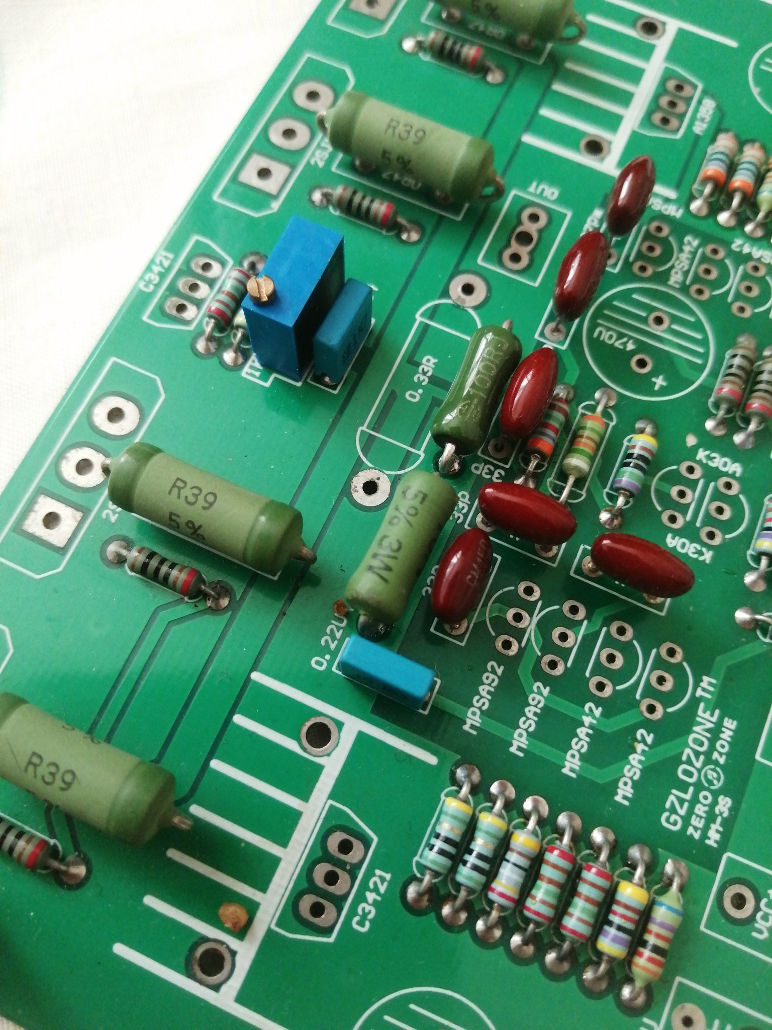

R18 vas resistor 100r 3w installed now
R18 çok küçük/düşük. VAS, ±2½V Toprak içinde geçiş yaparken, 4 çıkış cihazının tümü
VAS'ta çok fazla 33pF kapak var. Görünüşe göre tasarımcı , salınım patlamasını durdurmak için çok uğraşmış.
Instead of the 33pF caps on the VAS, I used the 22pf silver mica I had.
