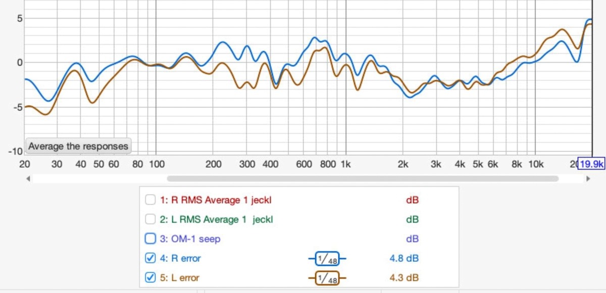

The errors per mic compared to one and the same OM-1, now compensated in post:
Quite substantial - but, one need to trust the process 🙂 or at least evaluate it - thats whats going on right now 🙂
In the extreme ends I edited the measurement files so that no compensation was made below 20Hz or above 10kHz. This due to the frequency extremes quite large deviations which made the whole process cumbersome.
The three mics involved was positioned within say +/- 3mm (x,y,z) from the reference point at time for measurement.

Uncompensated sounds much better to me and considerably more real/plausible.
I would check on the correction DSP to make sure that it isn't in part culpable. Also, maybe could be that compensation derived from PSS measurements and or from impulses is not a good fit for for some real music signals (i.e. the mics and or the calibration process is/are sufficiently non-LTI to cause calibration problems)?
Easy thing to try would be use DSP to compensate a track, then use DSP again to de-compensate the track back to its original state. How close does the DSP processing come to ideal performance? Is the processed track audibly distinguishable from the original track?

I will for sure revisit my calibration and most probable have a revised "error file" - all from the acoustic stimuli, REW arithmetics to FIR filter generation...

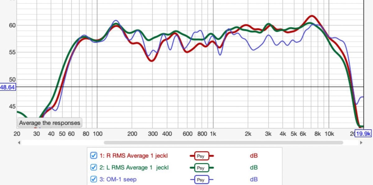

Input measuremnts (for the UGFR mics there was averages done from several measurements):

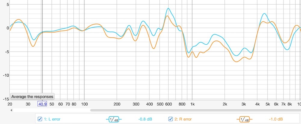

And the resulting error per UGFR mic compared to OM-1:
But not 5dB to much between 2-5k but perhaps 2. And a loss of energy above 10k. But also a little hot below 80 Hz apparently.
I will present same snippets tomorrow with new compensation.
Btw: these measurements are right out in the room at a distance form the source about 2,5m. As both types mics involved are omni, I think it's good that reflections are part of the measurements and calibration. My reference is still a bit uncertain but I think it is at least decent.
