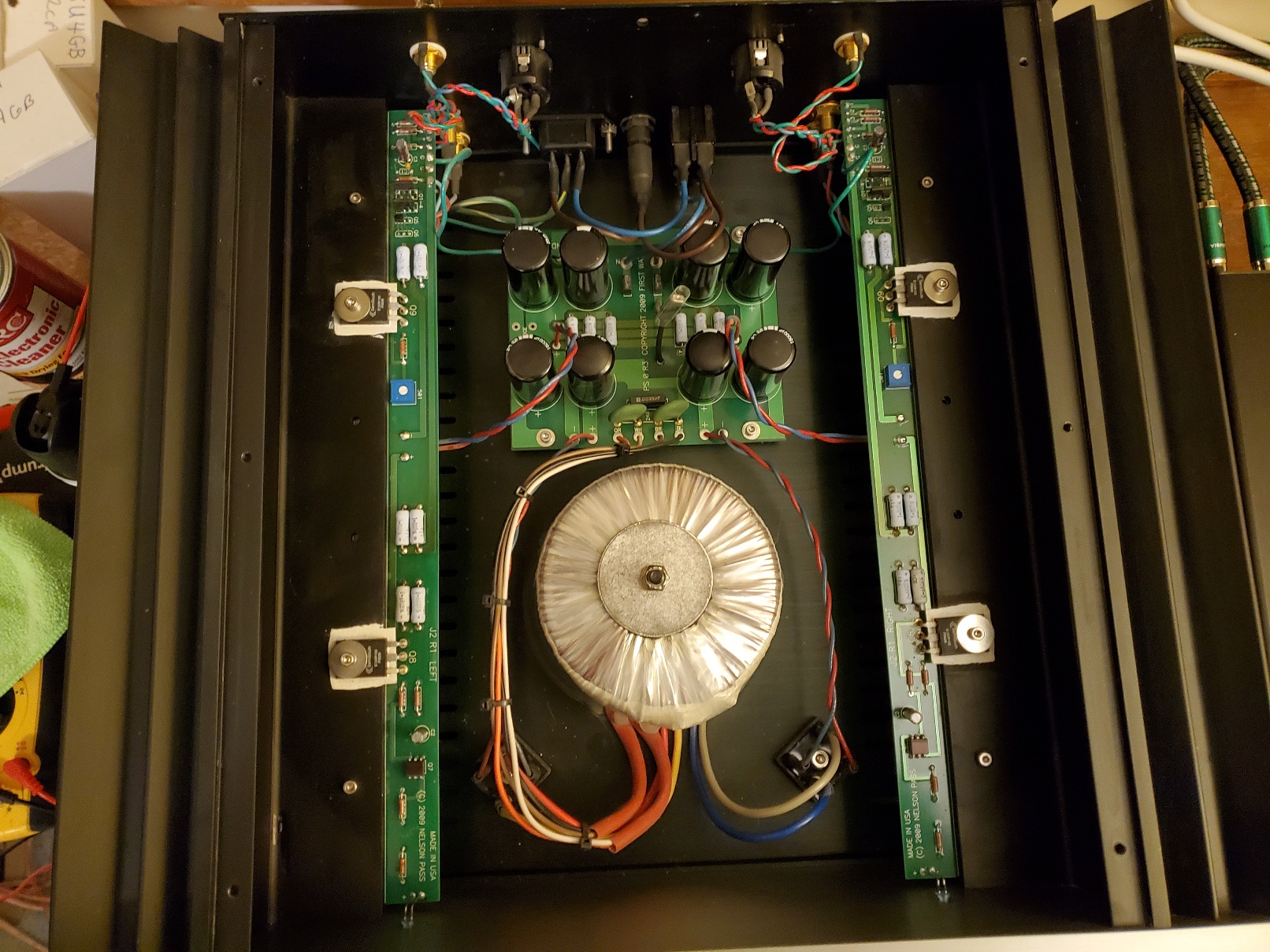

This is what good caps look like.
Work of art

I was trying to find some more j109 so that I could pursue building a pair of stereo J2 for the multiway horn system I have been wanting to try with an active crossover.
I broke down and ordered matched octets of J74 instead from a trusted seller on eBay.
They were supposed to be BL grade 7-8 mA matched within .03mA/4mV.
I got packages labeled 8.6 and 8.7...which I haven’t opened yet. Inner packaging seems also labeled 8.xx Idss on bags.
This seems kind of high on the end of the BL 7-8 mA scale.
Will I have an issue with them in the J2?

I decided to just order Panasonic 3 watt ERX instead of the pricey Ohmite TNP10...I have a couple sets of shorter PCBs I’m considering using that aren’t designed for the Ohmites. The short boards might be used because of my case situation.
If the ERX are good enough for Pa...
Only other thing I was doubtful on was choosing the 4N35 opto. So many popped up when I searched Mouser. I wasn’t sure if there were any specs they had to meet other than being through hole and made by a company I recognized.
I picked the first Vishay in the list...
4N35-X000 Vishay Semiconductors | Mouser
Any reason not to use them?
