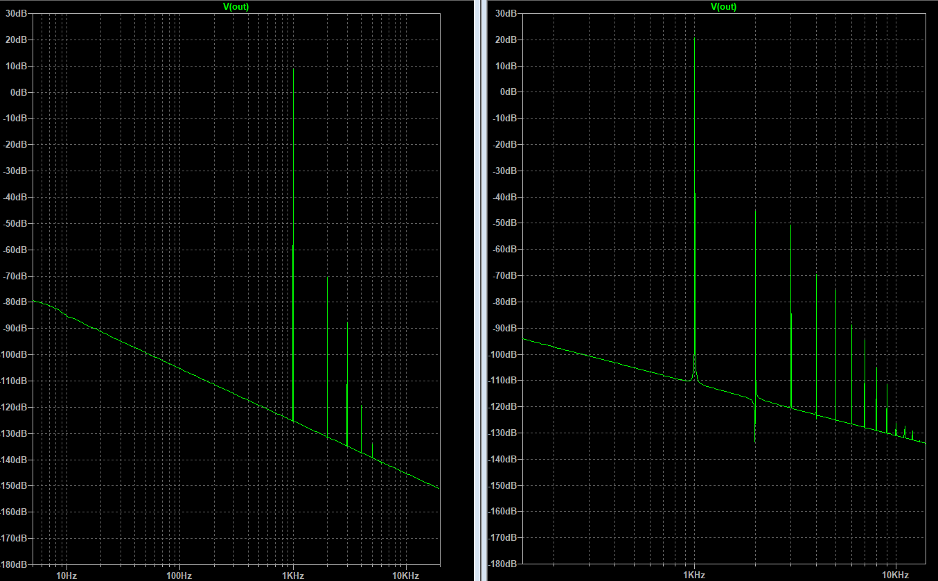

Below, I played with resistors values with total R10/R11 + R12/R13 = 0.75 Ohm
Top is R10/R11 = 0 Ohm, R12/R13 = 0.75 Ohm
Middle is R10/R11 = 0.25 Ohm, R12/R13 = 0.5 Ohm
Bottom is R10/R11 = 0.325 Ohm, R12/R13 = 0.325 Ohm
Left is 1W operation, right is 25W operation
@1W :
It is clear that top trace measures much better THD, with the least 2nd Order Harmonic.
Middle trace has more 2nd, similar 3rd but less 4th harmonic (the one which is more harmful)
Bottom trace has similar signature to middle trace, but at a slightly higher level
@25W :
The best trace is (rather clearly) middle trace which has the least 3rd and higher order harmonics (and about equal 2nd)
Again, lower trace is similar to middle trace but a bit worse.
Top trace has clearly more higher order harmonics which you won't want since they are more harmful
So once more, it seems there is a sweet spot of feedback amount, and in my case, it's with about 1/3 resistance on "top" and 2/3 resistance below.

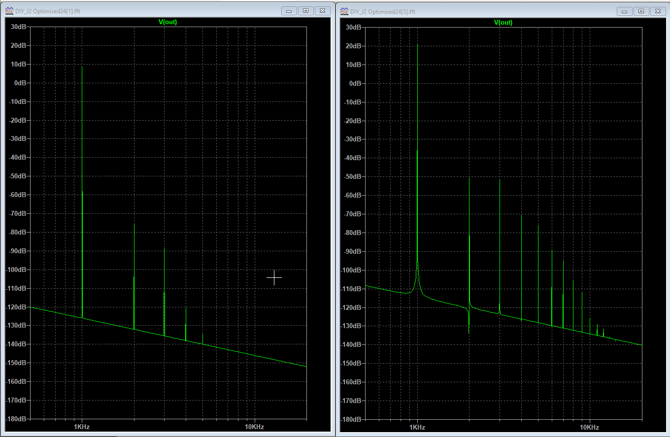

Below are 2 simulations @25W with various resistor values below CCS.
Which on would be considered better ?
Left : Measures slightly better THD 0.061%, has less H2 and about equal H3 and higher Harmonics
Right: Measures slightly worse (0.08%) but has less feedback
In other words: Should I trust figures, or is it preferrable to have a bit of H2 harmonics considering that it's achieved with a bit less feedback ?

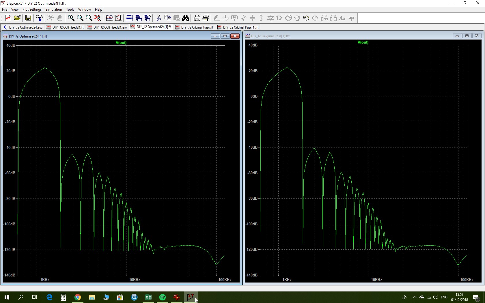

When running FFTs you need to change the max time-step from 10u to 1u, and the total time from 0.002sec to something like 0.2sec. I'm not sure it will change the numbers, but it will at least make the data look more trustworthy. ;)
I think the factory J2 has something like 15dB between H2 and H3. That's what I'd be shooting for, but some people like more or less H3.
H4 and above, though, I think are uniformly disliked. I'd try to minimise them rather than the THD.
Jeff.
Fred,
Thanks! I didn't know.
It sure looks a lot better ! more like a pure Dirac , but the values are essentially unchanged
The one on the left certainly has the higher order harmonics in better control.
When I say Left/Right, I mean left and right picture.
In both picture: Left diagram is @1W, Right one @15W
There is not too much difference between the two in 3rd and higher order harmonics @15W. The only significant difference is 2nd Order harmonic.
I was basically wondering whether having H2 > H3 (as in right picture) was actually desirable for the sound, or if one would want to seek the lowest possible THD (as in left picture)
