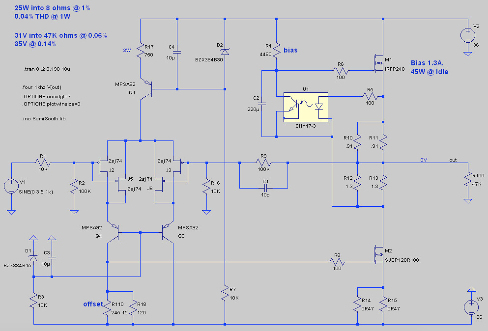

While playing around with ZenMod's feedback current source, it occurred to me that I don't need all the "extra" parts. As he himself alluded to, if I beef up (and heatsink) the primary PNP then I can drop the resistor between the CCS and the LTP. And without the zener to contend with, the bypass cap is probably not necessary.
Which leads me to:
attachment.php
It definitely runs, and produces some impressive THD numbers. (It'll take me a while to get my head around it though; I'm a novice on the analog side of things.)

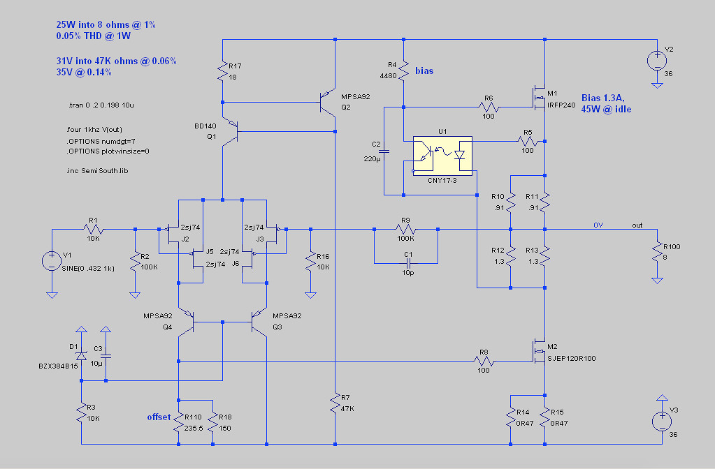

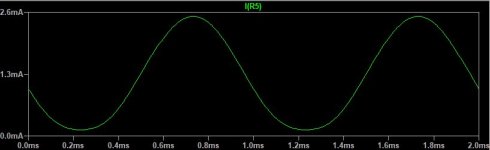

So I've been experimenting with the J2-esque Spice model from Jeff (Thanks a lot by the way for doing all the hard work!)

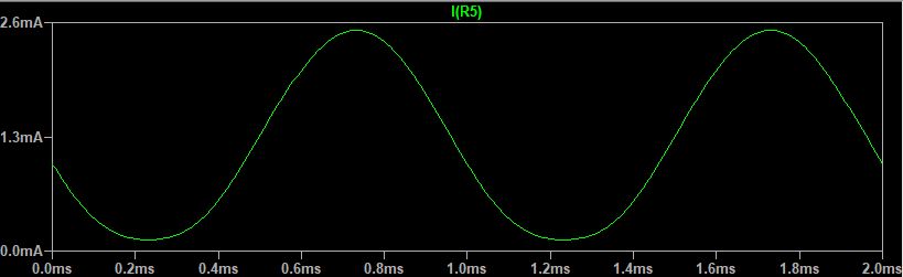

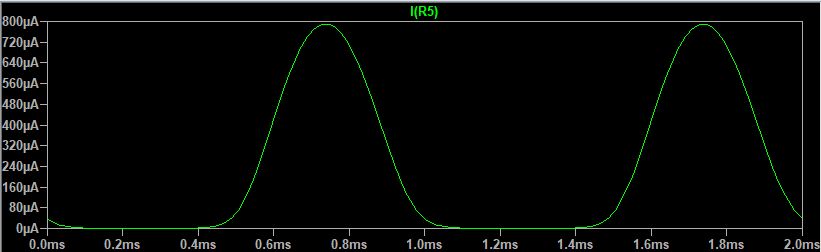

Some might say that I'm stating the obvious, but I noticed that depending on the CCS resistor values (R10/11 and R12/13) , there are 2 ways you operate the optocoupler:
- either in the "linear" region
- or at the diode's conduction threshold, where it might stop conducting on the lower part of the sine.
Interestingly , it works very well in both cases, but using the optocouple in the "linear" part of the diode's forward current (obviously?) gives a slightly better THD, so that's where you want to use it I guess

The next thing I noticed (and really I might be totally wrong, not being a pro with Spice, and admitedly not fully understanding the circuit operation....) is that THD seems to be significantly better if you keep R10/R11 at 0 and put all of the resistance in R12/R13.
Also, clipping is symetrical in this case, which seems to give a higher power before signal starts to get really dirty
Which leads me to a beginner's question..: why did everyone put the output somewhere in the middle of a voltage divider ?? (except the fact that Nelson did it according to J2 pictures lol)
I get much better figures by just ignoring R10/R11
Interesting results, Fred. I hadn't been paying enough attention to the optocoupler and was indeed running it out of bias near clipping.
The unbalanced source/drain degeneration is also interesting. I'm not sure about running the CS's degeneration all the way to 0, but further unbalancing seems warranted (and also runs the unobtainium SemiSouth a bit cooler).

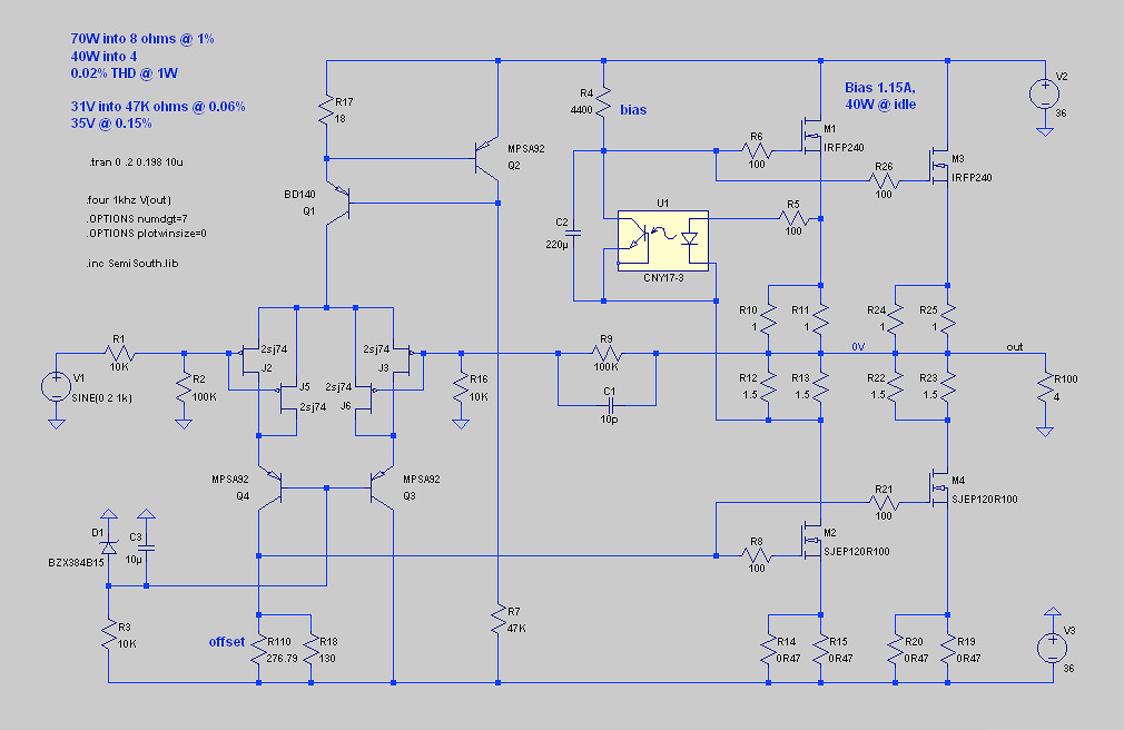

So here's an interesting beast. I adjusted things so that it's voltage limited at 50W into 8 ohms and current limited at 50W into 4 ohms. It also makes use of both of Fred's discoveries:
attachment.php
I also attached some .asc's. J2_dbl.asc is the above, while J2_FCCS.asc is the undoubled output version with higher rails (and as yet without Fred's optimisations).

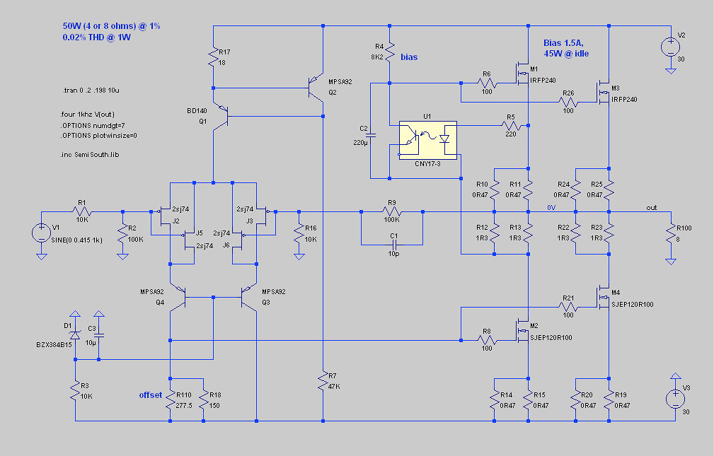

Setting R10/R11 to lower values increases the open loop gain of the
circuit, so you will enjoy more feedback and thus lower distortion -
at lower levels.
The problem then is that the current source is doing more of the work
which is fine when the waveform is positive, not so much when it is
negative, where the current source goes into cutoff at a figure
approaching 1/2 output current as compared to more symmetric operation.
The result resembles a large crossover notch. For a given load, you
can increase the bias current until that goes away, but now you are
approaching twice the dissipation for a given output rating.
