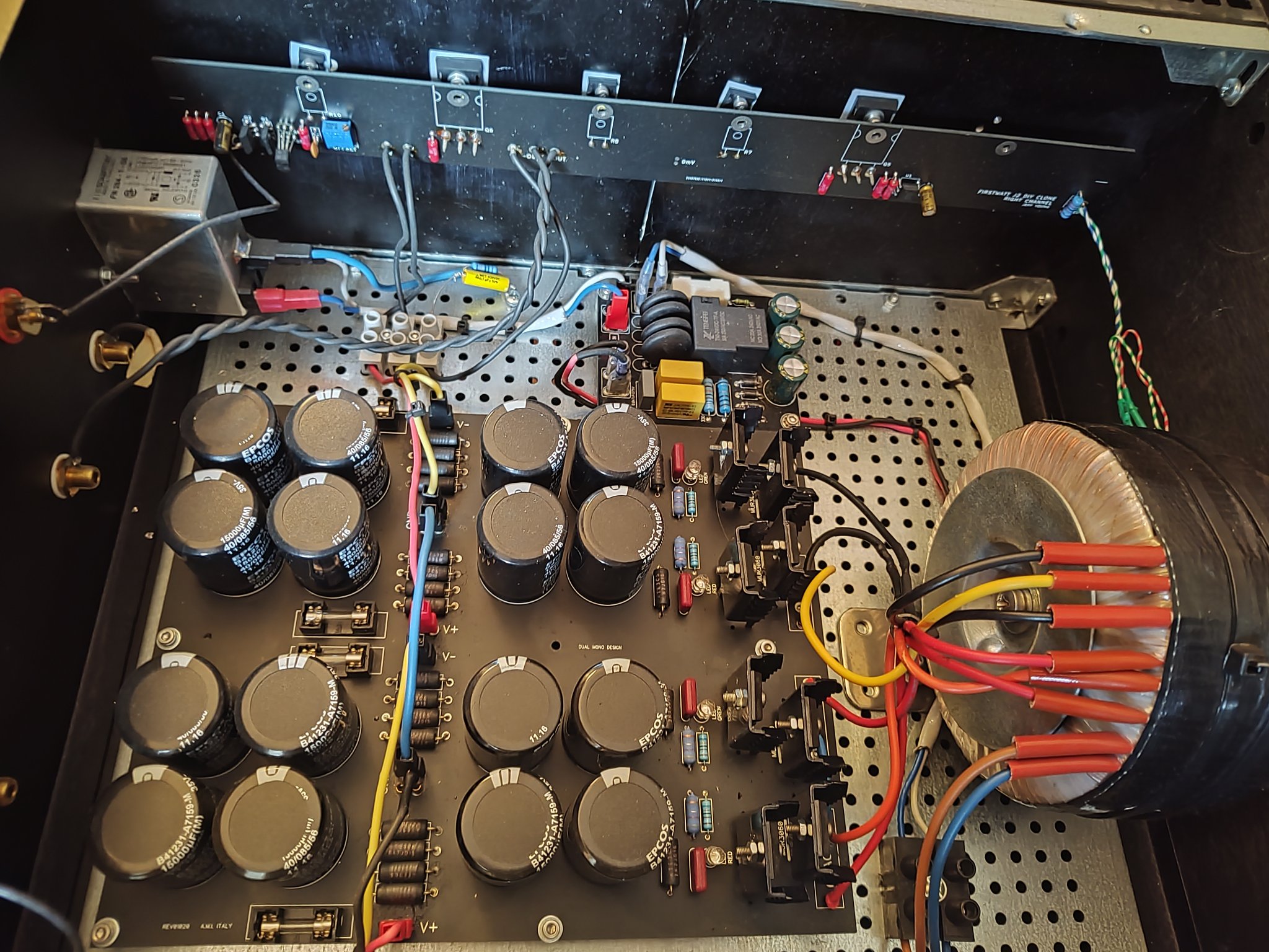

and, for later, when you succeed with making amp functional: I see you have cap-multipliers ........ and no big caps after
you must have at least 10000uF per rail after cap multiplier, to ensure dynamic reserve ......

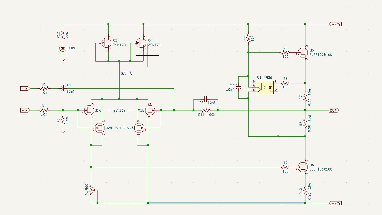

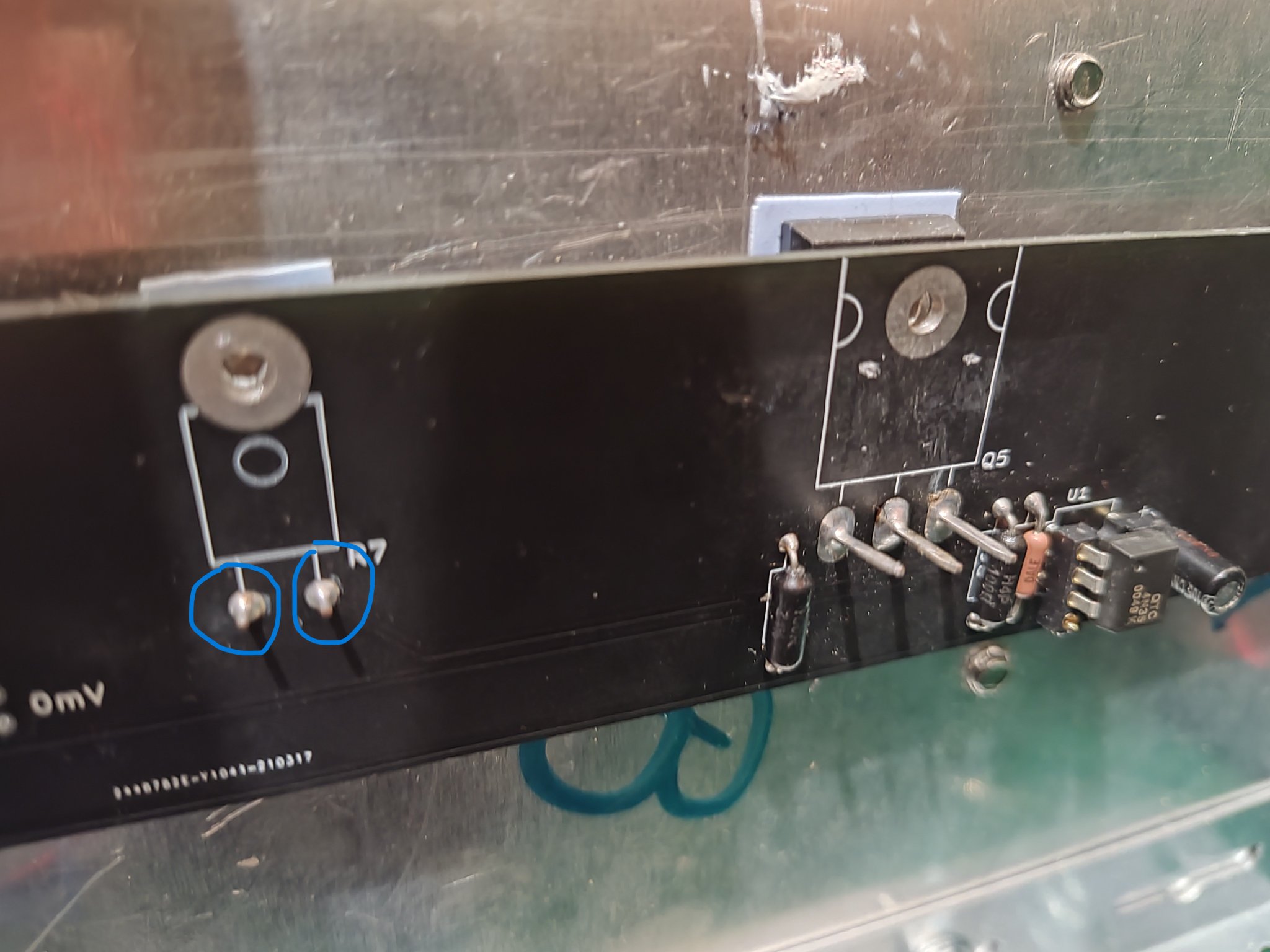

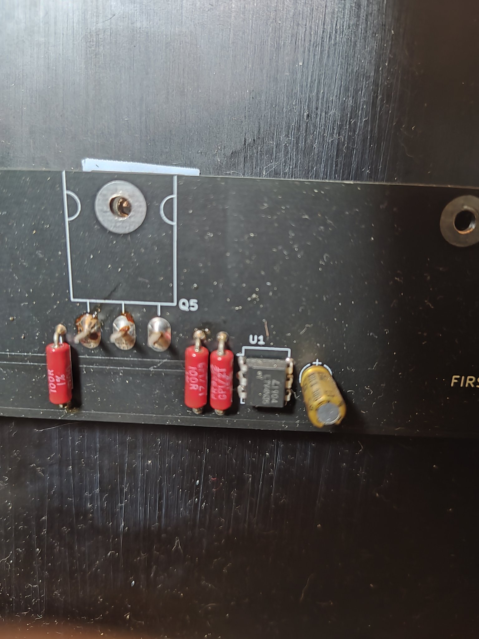

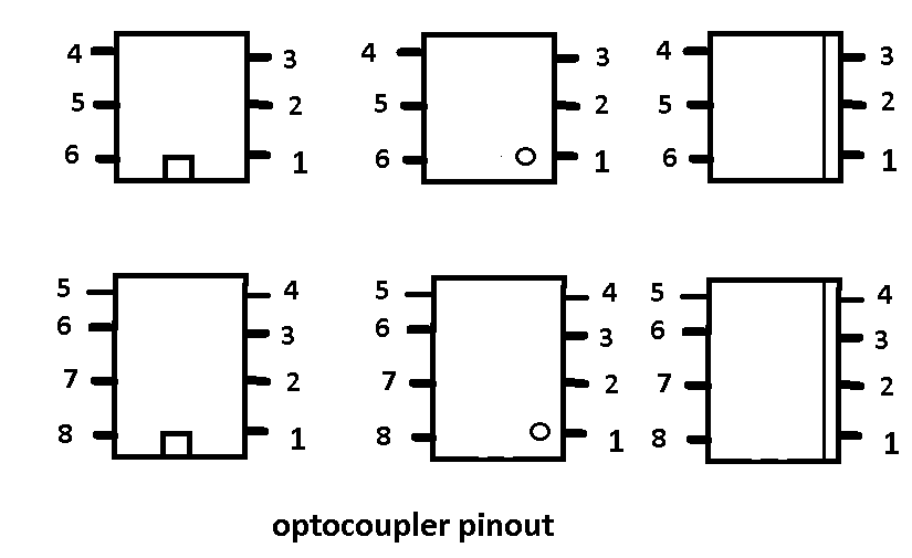

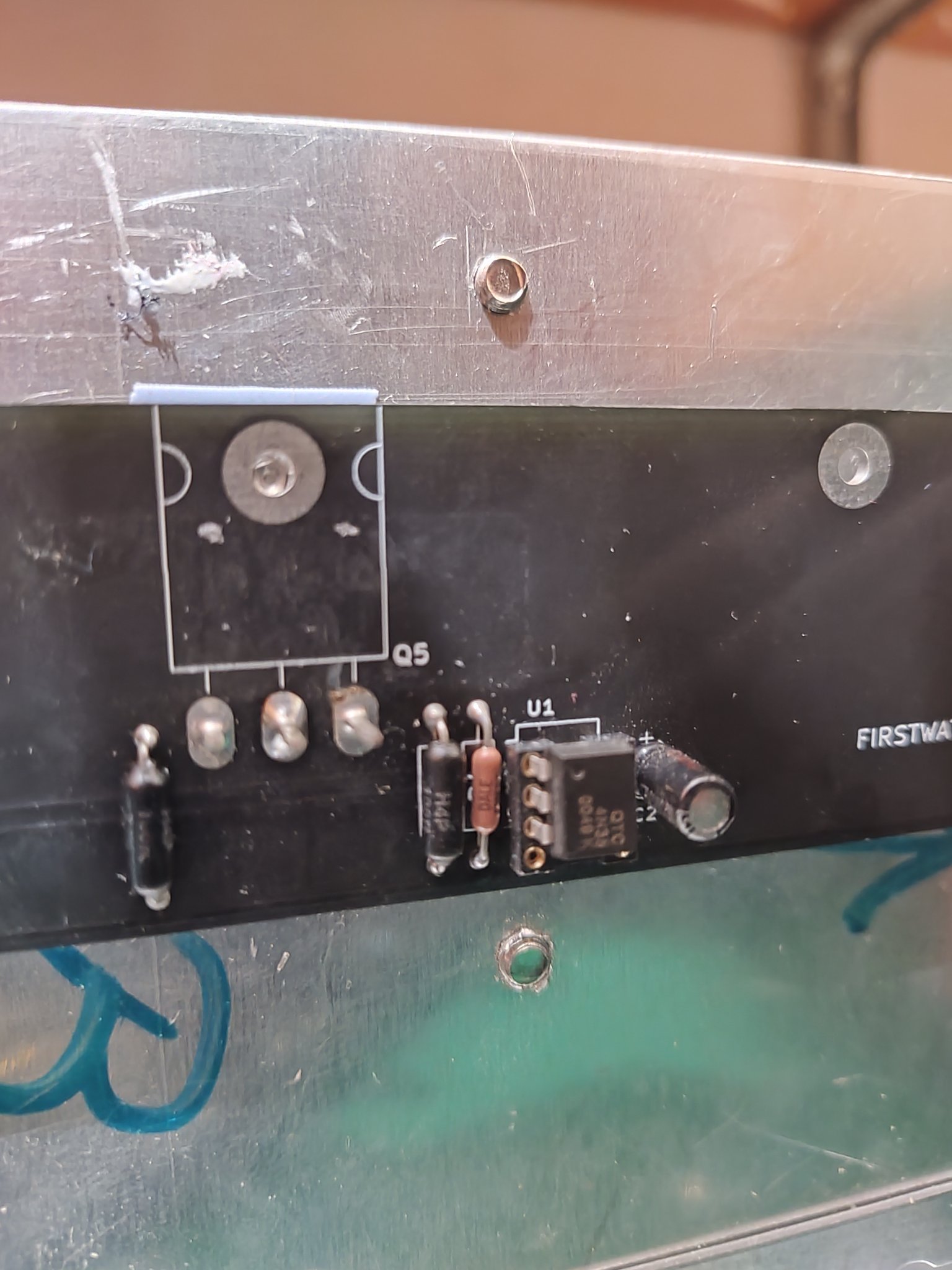

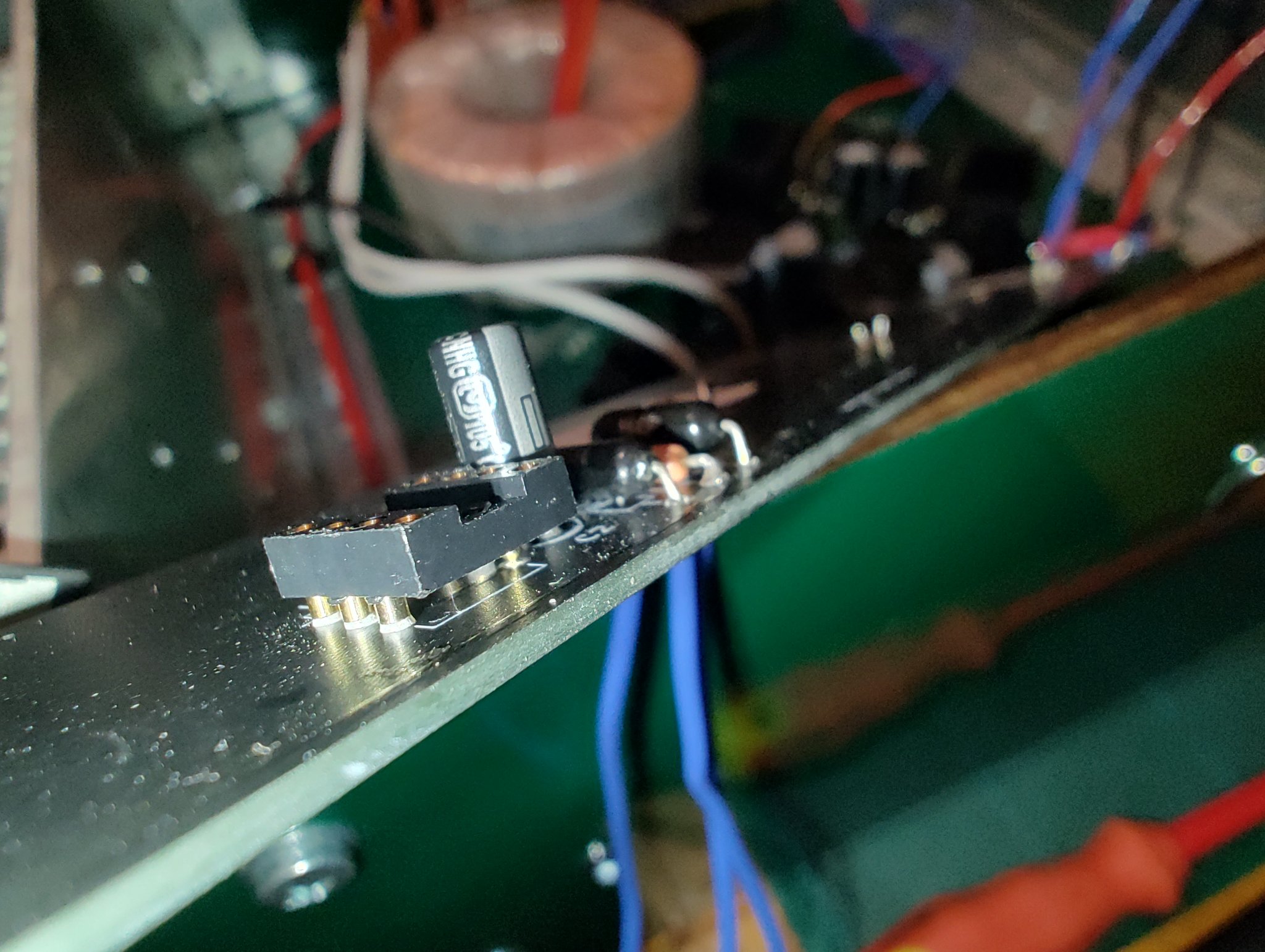

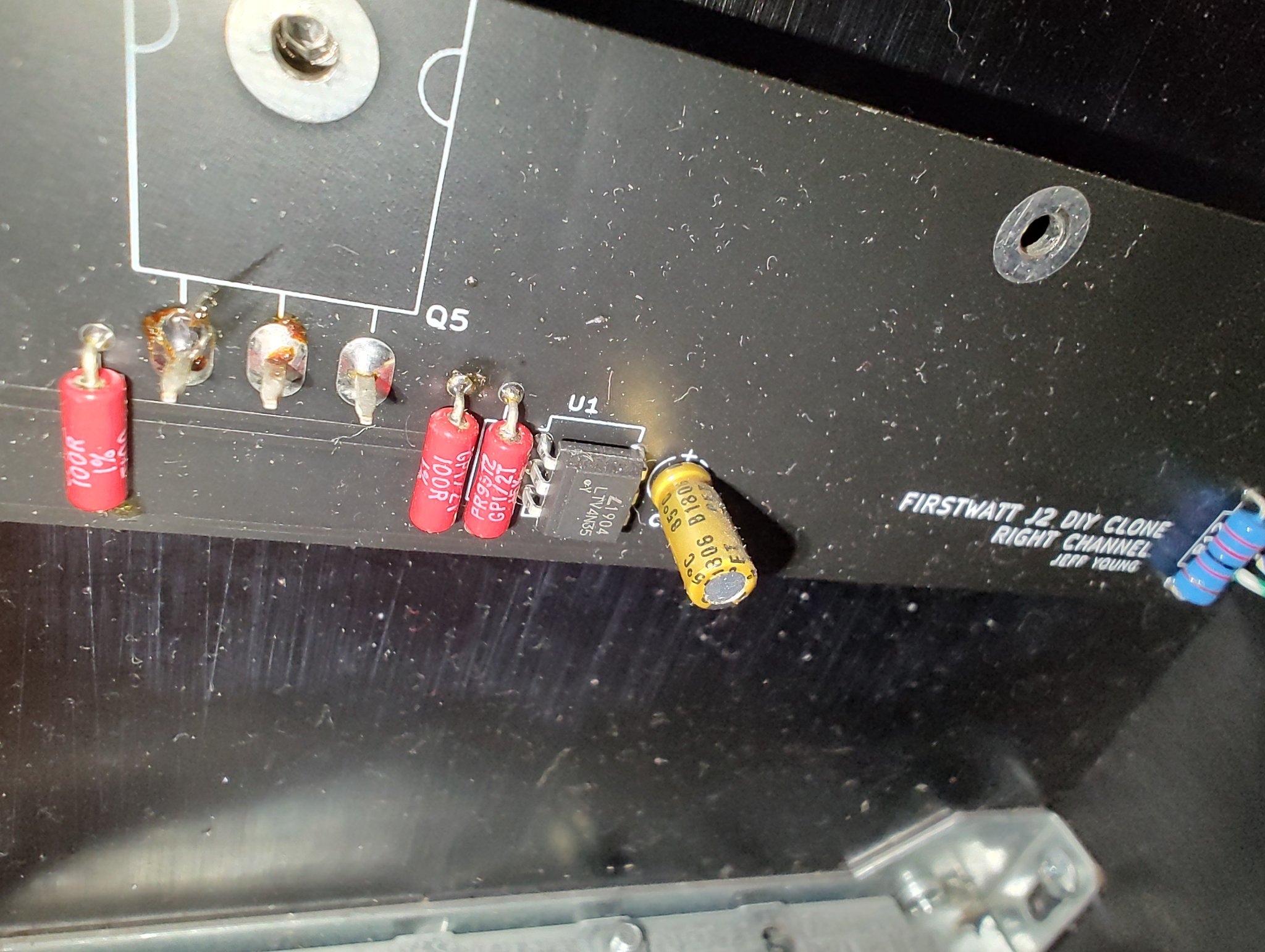

U1 is most likely stuffed backwards

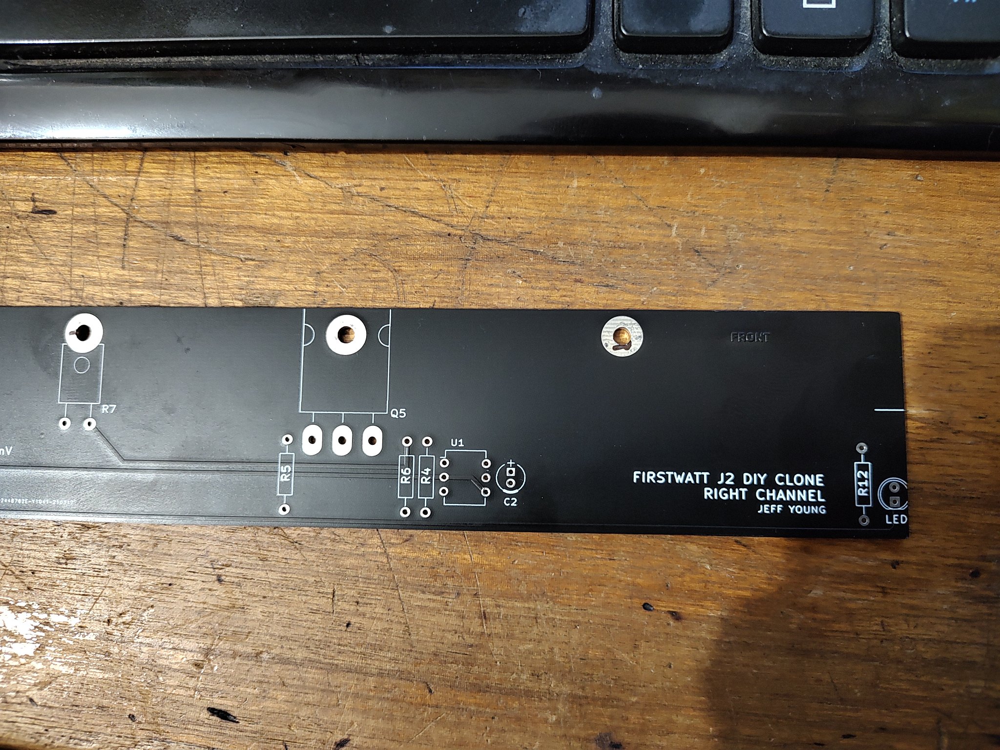

Quindi proverò a rispondere allegando alcune immagini, il 4n35 è su uno zoccolo da cui sono stati rimossi due pin e ho controllato di nuovo ed è inserito e posizionato come quello nel mio J2 funzionante (ma senza zoccolo), le schede sono di Jeff Young (gerber) e l'alimentatore sarà come quello nel J2 funzionante.

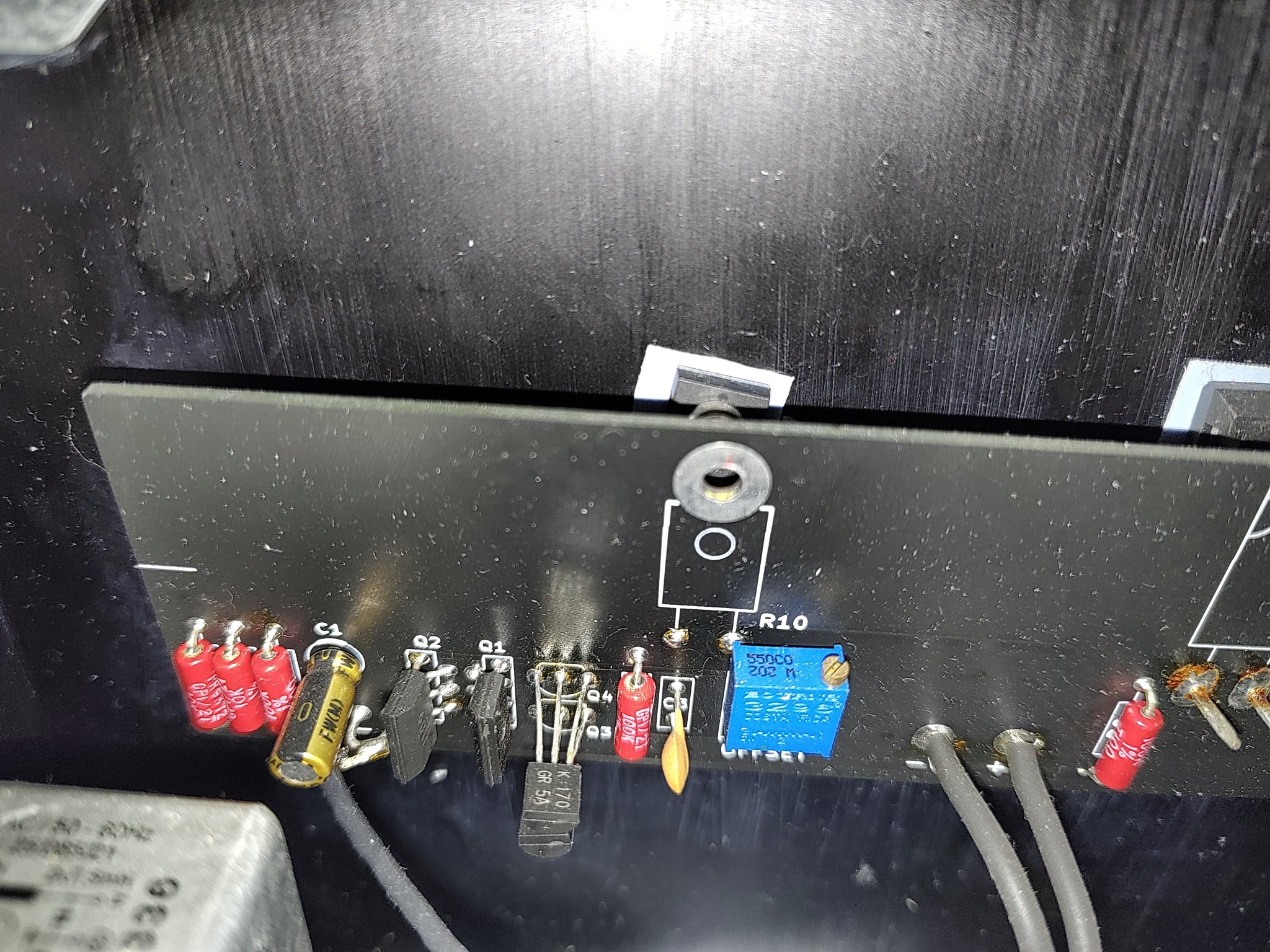

So I'll try to answer by attaching some images, the 4n35 is on a socket from which two pins have been removed and I checked again and it is inserted and positioned like the one in my working J2 (but without a socket), the boards are from Jeff Young (gerber) and the power supply will be like the one in the working J2.
Nature of things, I believe it's completely normal to take all these questions to thread where that project is presented
anyhow, what you need to measure and present is:
- confirmation that there is no short between outputs and heatsink
- confirmation of rail voltages
- voltages across fat resistors in output stage (R7, R8, R10)
- voltage across P1 and note of its setting ( maxed or not)
- DC Offset voltage
while measuring everything, work at one channel at time (second disconnected from PSU), inputs shorted to GND, no load at output
