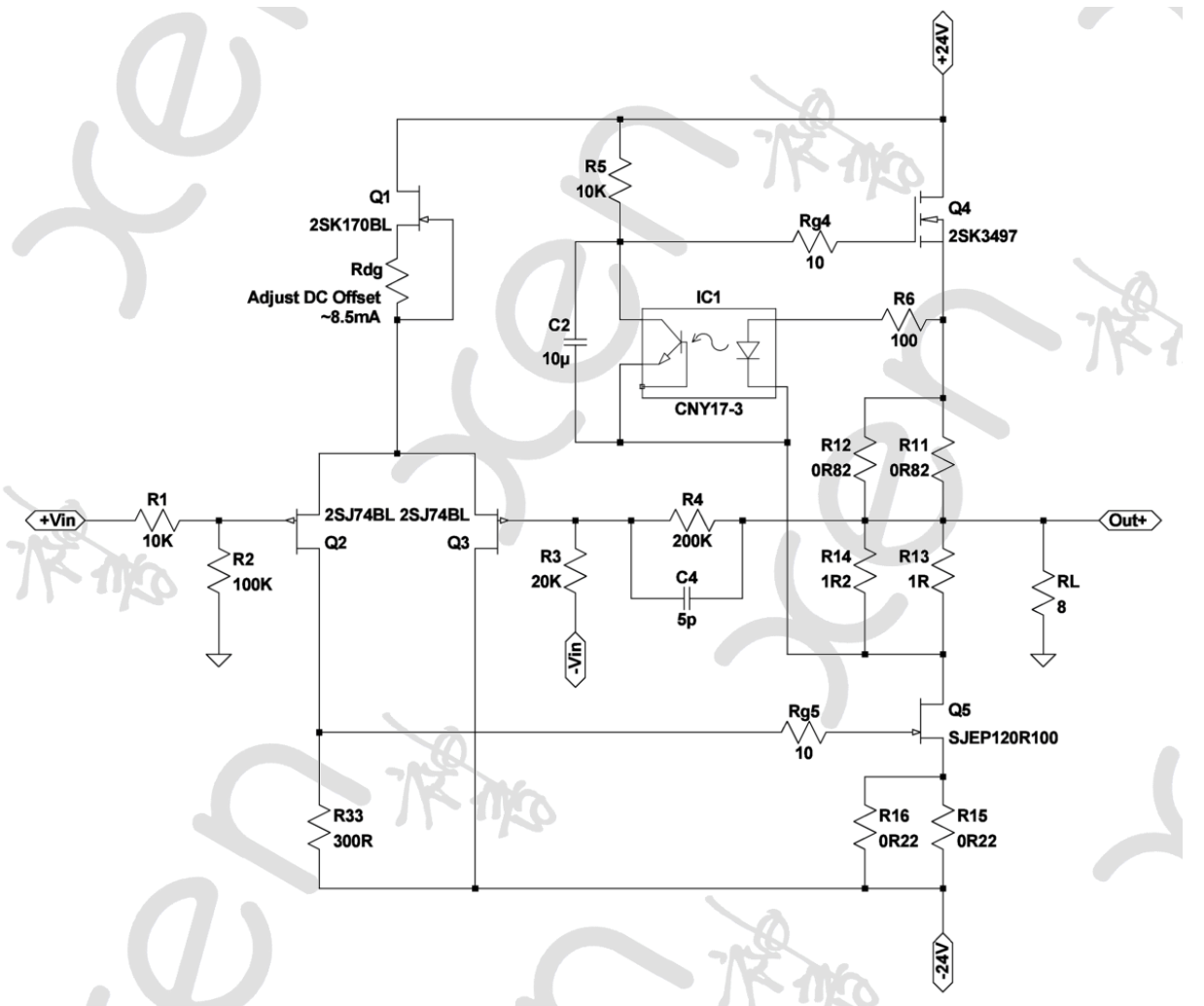

For the FE CCS (Q1 in EUVL schematics in #1393) I have 2 pairs of 2SK170-BL to choose from with idss of 8.51 and 8.52 mA, and 8.97 and 9.25 mA.
Which pair is the best for the job and is the answer related somehow to the what is said below?

For a jfet ccs lots of degeneration is a good thing.
I have an offset problem (I think).
By turning all the way counterclockwise Rdg (50R trimpot) in the schematics below I can get the DC offset at the output to 80 mV with inputs floating, and 800 mV with inputs shorted.
Both channels behave the same. PSU is +/- 22.5V under load and bias current for Q5 is 1.4A.
I did use IRFP240 for Q4 and 2SJ109-BL for Q2-Q3. I do not have the BOM on the laptop to check other values at the moment.
What should I look into to reduce the offset?
If the offset is negative, then the current source has too much current, and you need to increase Rdg.
If the offset is positive, then the current source has not enough current.
You can try to increase the 300R resistor to 330R or 360R.
I always short the input while adjusting DC.

Thanks. Currently I am using the pair with higher idss (one per channel since EUVL PCB has the FE halved, see #2,184).
Furthermore, with R33 = 330R the offset is reduced but not enough. So I have to play a bit more there.

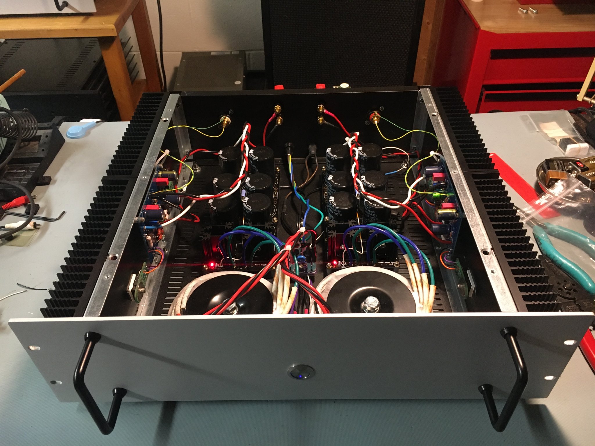

I'm finally finishing my J2 clone. I have` been sitting on these SemiSouth JFETs for a long time. Thanks to @Nelson Pass, @Zen Mod, @EUVL, @rhthatcher, @xrk971. Especially to Nelson.
