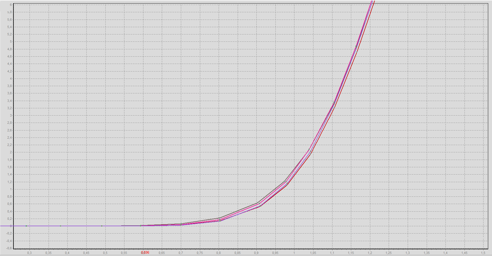

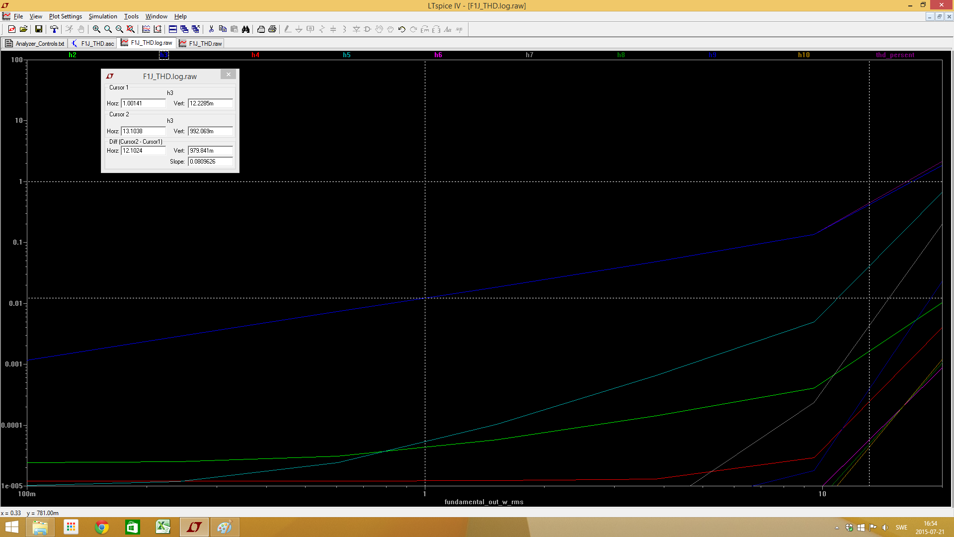

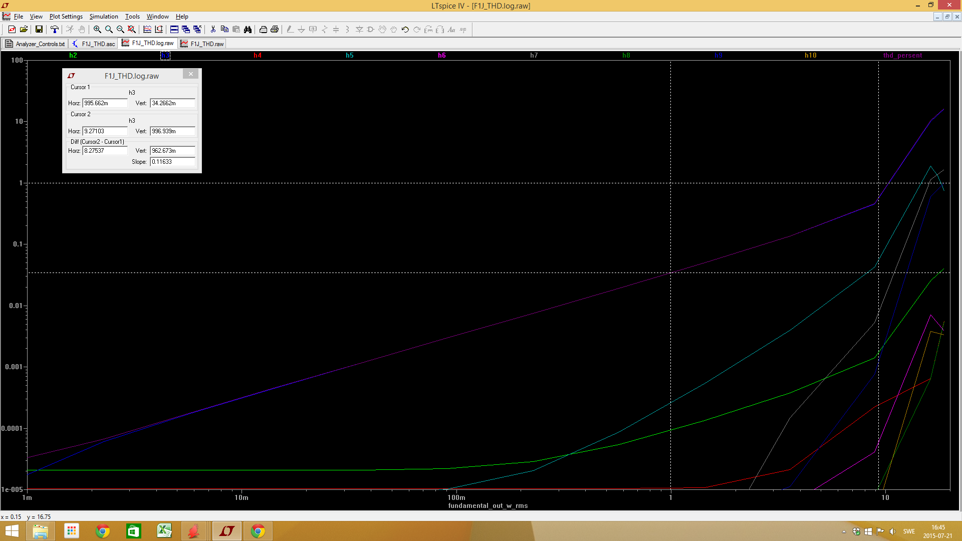

I'm going to use Toshiba fets for the current sources simply because I have them. Playing around with ltspice suggest This amp would really like higher bias currents alot.
4A => 0.035% THD @ 1W, 1kHz
6A => 0.012% THD @ 1W, 1kHz
I figure the sinks Im going to use are good enough for 150W/ch even tough The fets will be mounted somewhat non ideal towards the back of the enclosure.
I'll have the current sources on one side and the differential pair on the other (separate sinks) If i lower the common mode voltage (im only ever going to use it with balanced drive) I should be able to have 50/50 division of the heat.
