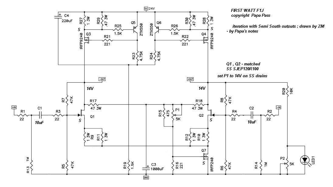

Thanks. That looks better than my hand-drawn schematic.maybe this will be useful to someone
just found it in my FW folder
But it still leaves some questions. The original F1 schematic shows adjustment voltages of 7 V on the gates of the main power FETs, and 3 V on the gate of the Aleph current source. Your F1J schematic has nothing there.
It makes sense that the JFET gates might have a completely different voltage. The F1 has a 60% resistor voltage divider, and the revised F1J has a 50% resistor voltage divider. I assume the drains of the F1 FETs were around 12 V if there was 7 V on the gates (just roughly calculating from the voltage dividers only). If we read Papa correctly that the drains are bumped up to 14 V, as your schematic shows, then the 50% dividers would leave the gates at the original 7 V.
Would you think that the Aleph current source gate bias voltage should remain at 3 V?
these values are by Papa's words somewhere around ;
I didn't checked
whatever - circuit is mostly self adjusting - all you need is to fiddle with P1 ( to set where Da Man sez it need to be ) and to read basics more
tip - his papers at FW will tell you more than I can , in a life-time .

Just 1 thing. Is that an Aleph CS?
nope - plain Papatype mosfet CCS(es)
there is no modulation of them
Are you asking about the common current source at the bottom, or the dual current sources at the top?Just 1 thing. Is that an Aleph CS?
I thought the current source on the bottom might be an Aleph. Note how the output voltage is fed to the gate of the current source FET. This is a form of feedback to maintain the voltage on the high side. But every Aleph schematic I've seen involves a bipolar transistor as well as the primary conducting FET. The Aleph patent doesn't seem to show the exact same circuit. Regardless of what it's called, you'll find Nelson Pass discussing this common current source in Zen Variations 7.
The dual current sources at the top are most certainly Aleph current sources.
I guess I should explain a bit more. The Output CS's are "Typical" and do not include the summing of an output current signal with the CS sense signal as does Aleph. There would need to be a method of sensing the output current and sending that signal to the CS. That portion is absent. A "typical" current source.
Oh! You're absolutely right! I had a bunch of hand-drawn circuits on the same page, and only some of them were Aleph current sources. I did not look closely enough at the F1 schematic to see that it was different from the Aleph. You're correct that the upper current source pairs in the F1 and F1J have no control inputs at all.I guess I should explain a bit more. The Output CS's are "Typical" and do not include the summing of an output current signal with the CS sense signal as does Aleph. There would need to be a method of sensing the output current and sending that signal to the CS. That portion is absent. A "typical" current source.
So I retract my earlier statements.
The upper pair of current sources are plain, unmodulated current sources - the epitome of a constant current source. The common current source at the bottom is modulated by feedback, so it is not a constant current source, but it also is not a patented Aleph current source.
