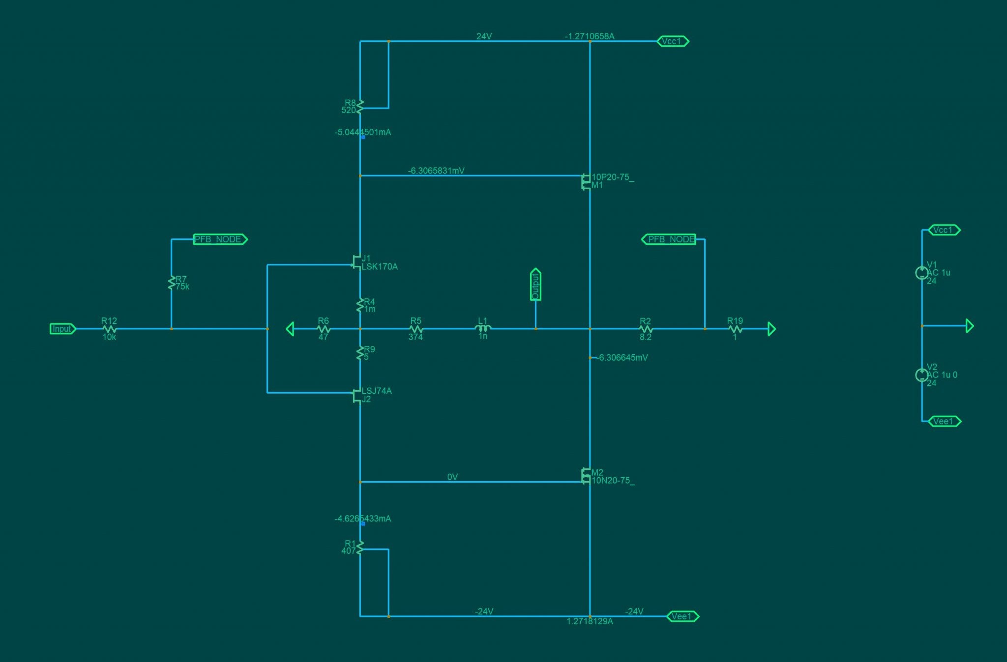

I think your load model is wonky. It's only defined up to 20kHz. If you extend thel load data out into the MHz region, things look a lot different, but still have issues. I think a varisttor may not be the best way to approach modelling a loudspeaker load.OK. Here is my F7 sim. In the attachement you can find the complete sim as zip.
Have fun.🙂

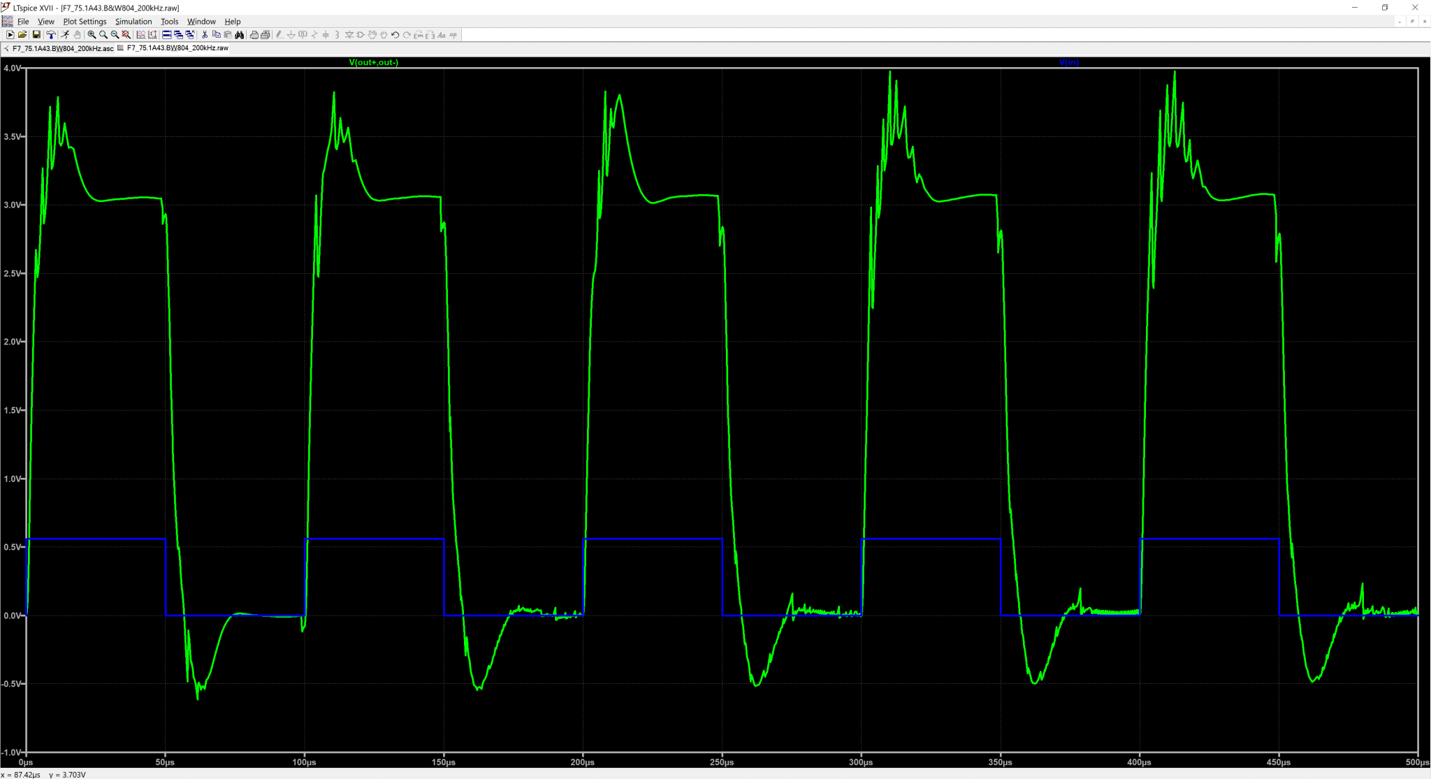

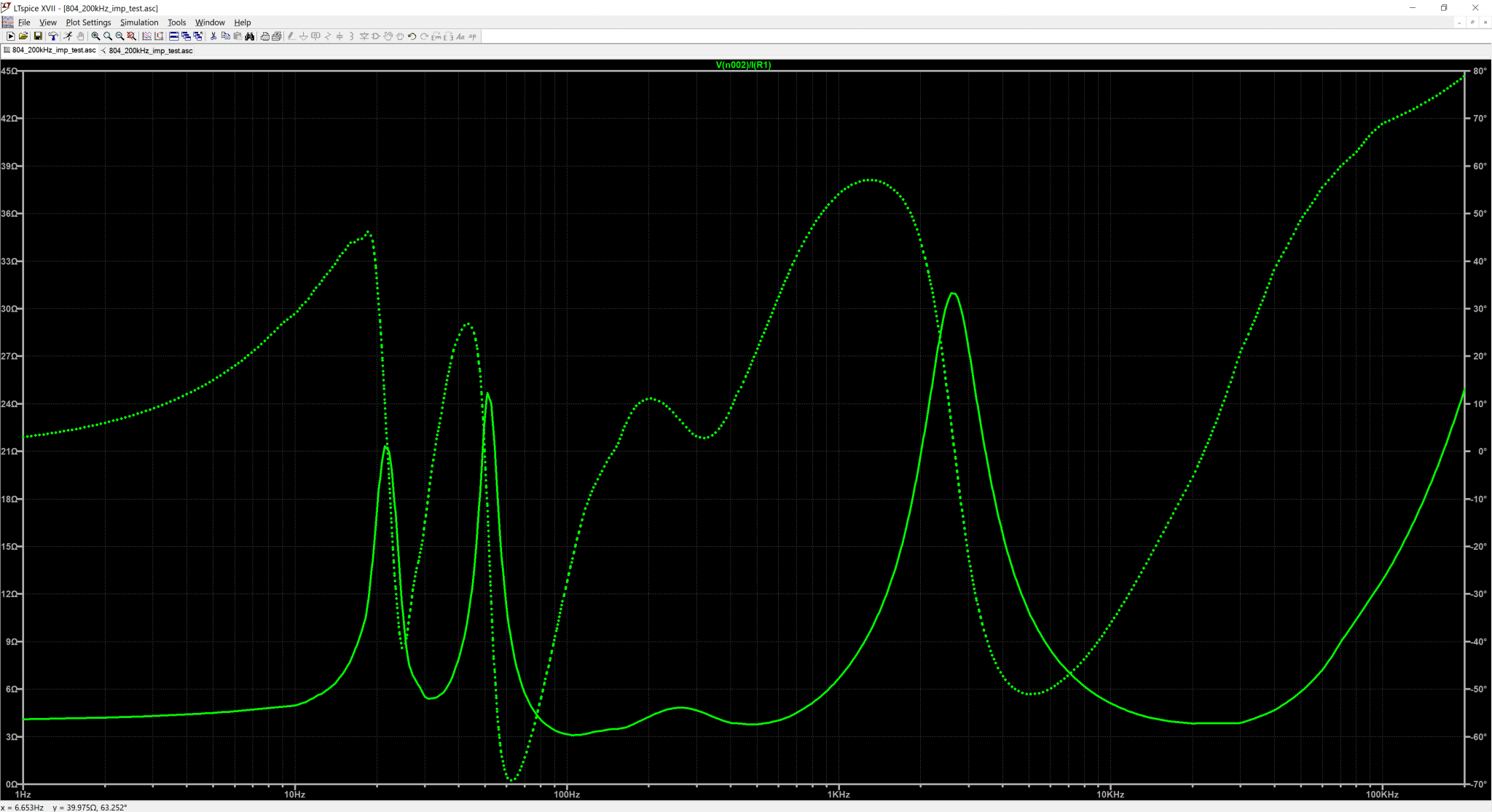

Why should not a varistor be suitable for simulating an impedance?I think your load model is wonky. It's only defined up to 20kHz. If you extend thel load data out into the MHz region, things look a lot different, but still have issues. I think a varisttor may not be the best way to approach modelling a loudspeaker load.
The matrix Z(f) is clearly defined with f, R and phase.
I mapped the crossover with the chassis in LTspice and extended the SPK model to 200 kHz (pic #6).
Unfortunately LTspice runs in limbo when I extend the SPK model to 1 MHz.
The test result with my F7 sim and 10 kHz square wave looks better now (pic #7).
But I like it even less than the previous model up to 20 kHz.
Conclusion: my SPK does not match my F7 clone or my F7 clone does not match the SPK.
The sound is not what I like and I can't imagine that it can be because of the trims.😎

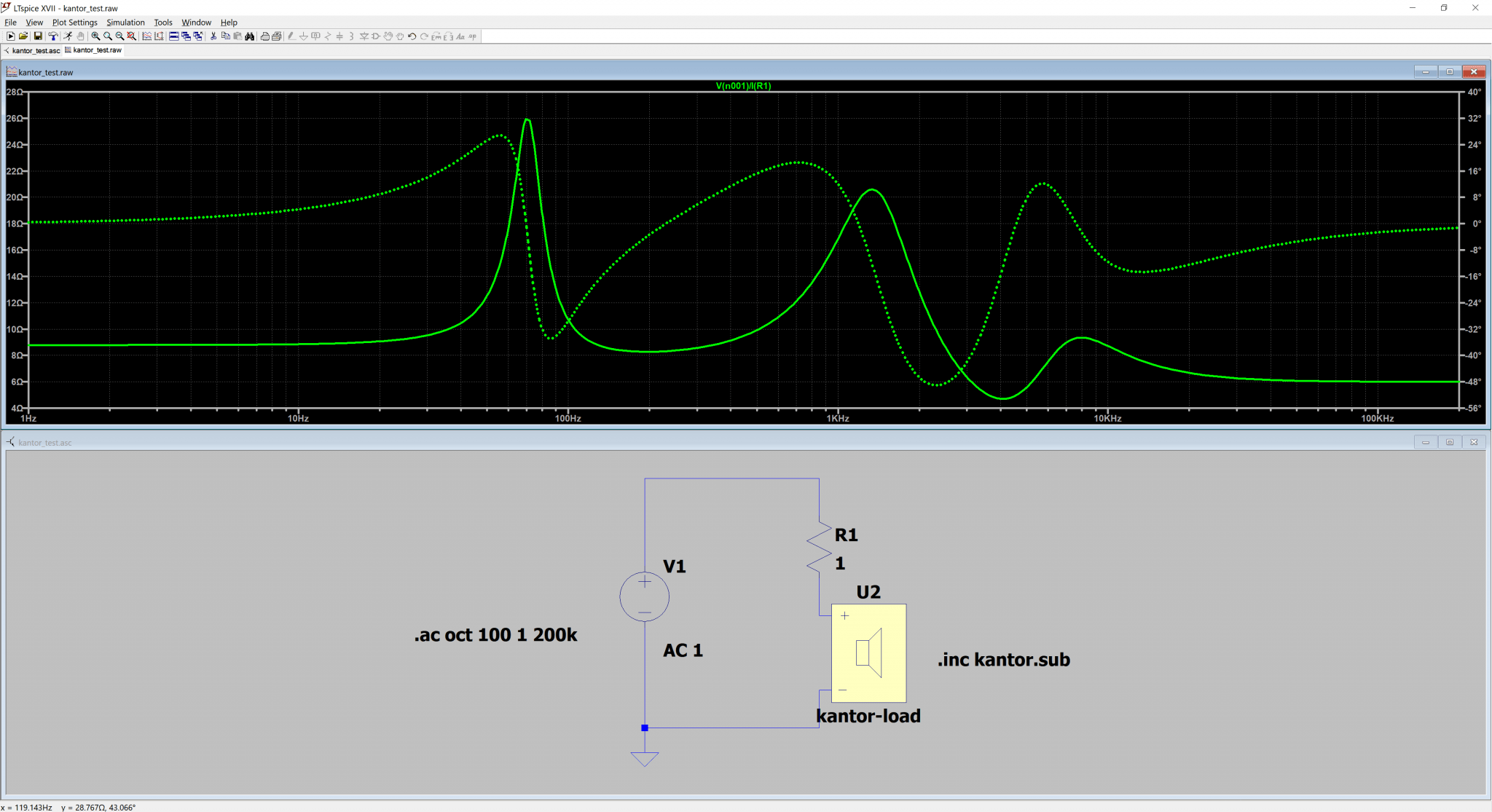

I just think you will get a more realistic result for your square waves if you use a loudspeaker model built with reactive components, like this one.Why should not a varistor be suitable for simulating an impedance?
I also doubt the trimpots are the issue.
Thank you for the model. The test results are attached.
Impedance curve for kantor (pic #8)
F7 sim response with kantor (pic #9). It looks a lot nicer.
My model captures all reactive parts of a real speaker B&W 804 with bass reflex principle
and agrees with results already published here:
https://www.stereophile.com/content/bowers-amp-wilkins-804-diamond-loudspeaker-measurements
The model is structured as follows:
.subckt B&W804_200kHz 1 2
B1 1 2 V=I(B1) MAG FREQ=

Each row contains a triplet: frequency, resistance and phase angle
This data depict a measured impedance curve in reality and is one possible electrical
mapping of a speaker with its crossover and chassis' and contains all reactances.
The two models describe the same principle. The only difference is the notation used.
Sure, in my model the frequency ends at 200 kHz (LTspice crashes with data over 200 kHz).
But should it make a such big difference when testing at 10 kHz?
