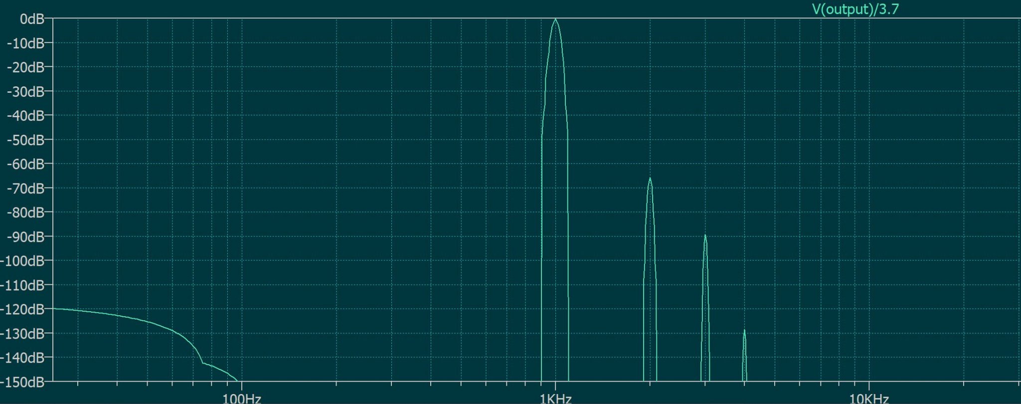

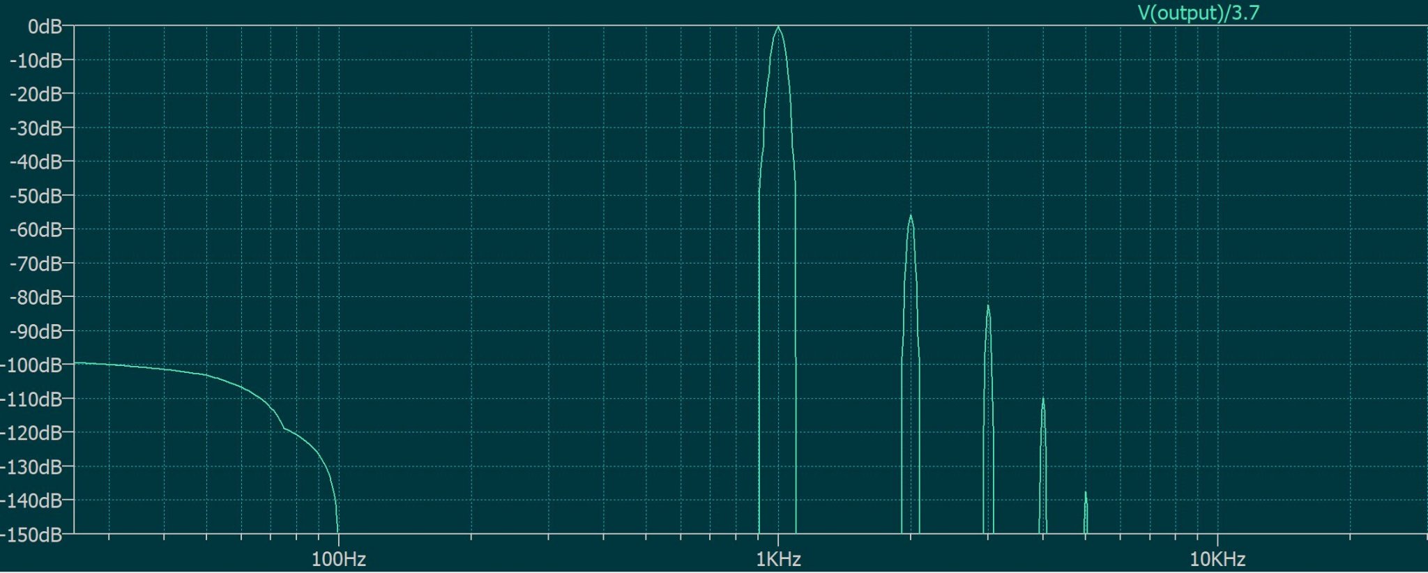

I'm planning a build of an F7 type amplifier and I'd be interested to hear if anyone has done a successful build using these high power Exicon Lateral Mosfets.
https://www.profusionplc.com/parts/ecw20n20-s
Spice predicts ( 🤔 ) that this higher power type gives less significantly HD with the same FB & bias current compared with their less powerful 10N20 with only a very small phase margin trade off.
Would be interested to hear peoples thoughts on using these devices
thanks
thanks
For this circuit higher transconductance will get you more open loop gain and more feedback
I agree - but because I wanted the FB in the finished amp to be fixed at quite a low level, I wanted to see how these devices compared in the circuit with same amount of feedback. So I deliberately adjusted the circuit in spice to make this comparison
And as you can see, spice predicts that even with matched feedback the 20n20 etc gives quite a lot less HD
So I was just wondering if there might be any downside to using the 20N20s ?
Because if not, to me the results with them look pretty good

Are you sure the Spice models are that accurate? Does the distortion depends also on the speaker load?
rightly or wrongly, I tend to trust Spice for comparative tests. Especially if the results are logical. These results seem logical so lets see.Are you sure the Spice models are that accurate? Does the distortion depends also on the speaker load?
Sure the load affects HD but this was just an indicative comparison.
I trust Spice, but the models not so much, especially since there is significant variation between actual semi samples...
I think you are on the right track trying the 20N20 and 20P20. Higher transconductance and they appear to be slightly more linear. Which Spice models are you using? This thread by @IanHegglun has the most recent and accurate ones I know of. Also, you can request "binned" versions from Profusion to get a closer match between N and P.I agree - but because I wanted the FB in the finished amp to be fixed at quite a low level, I wanted to see how these devices compared in the circuit with same amount of feedback. So I deliberately adjusted the circuit in spice to make this comparison
