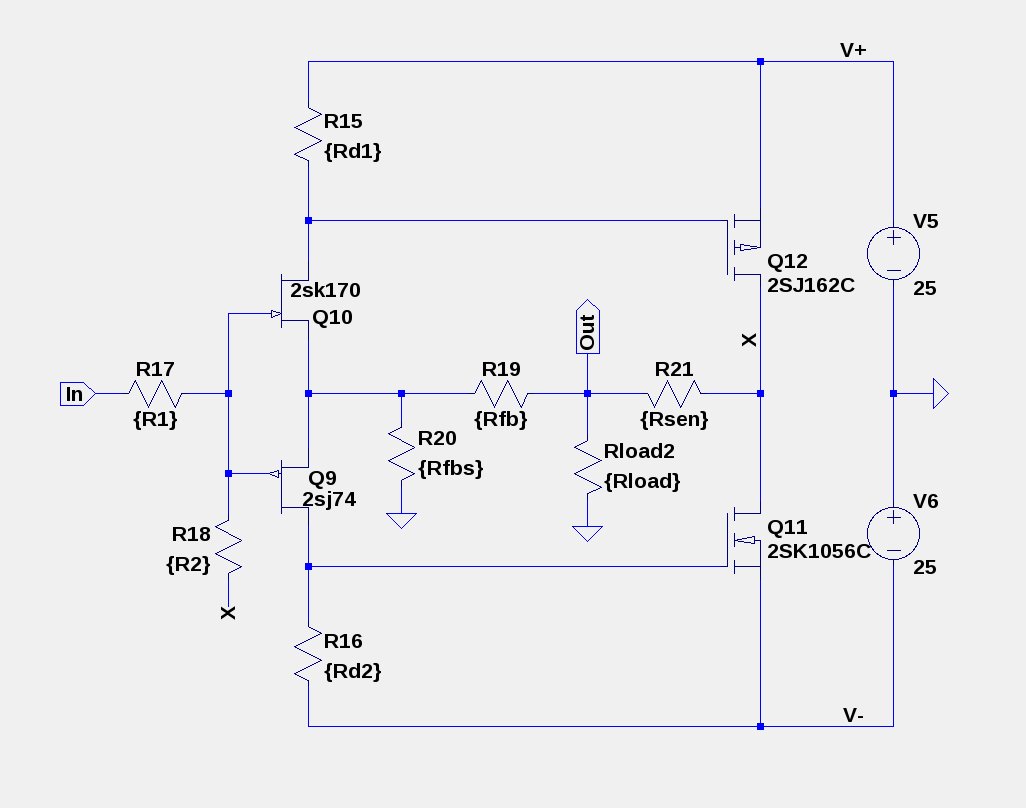

Here is schematic which appears to do the job. I have left the resistor values unspecified here to stimulate the DIYer to play around to find them. I have figured out a set of parameters that appear to meet most of the specifications that I will post at a later date. The primary spec that I haven't met is that my H2 is about 10dB too high which will require selecting jfets or lateral fets with different transconductances.

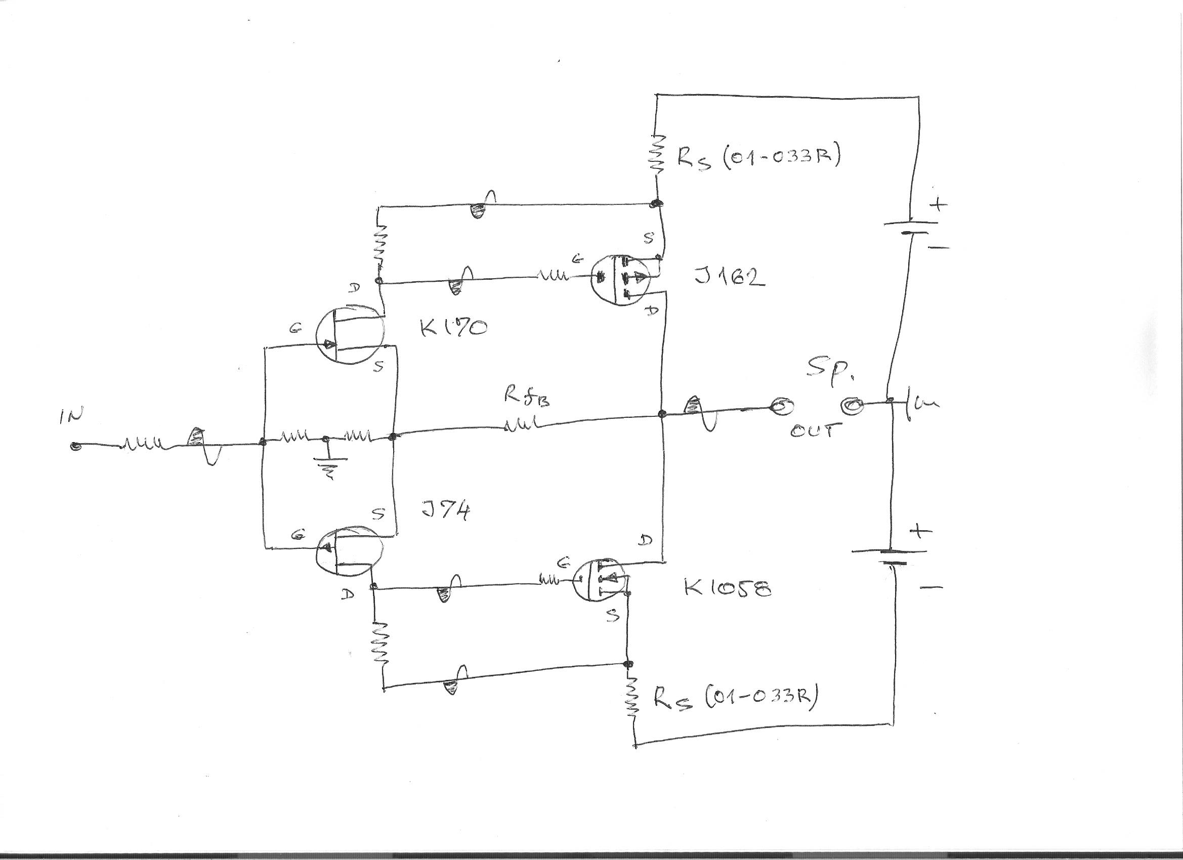

It is nothing new ,but is another way to get both negative & certain level of positive FB (bootstrap) for this simple A class symmetric PP amp.
Regards !

I'd be very impressed/surprised if you could get stable operation of those lateral mosfets without any gate resistance.
You could be right about that. Are there any other output devices that could be used without gate stoppers and without source degeneration? I do not know how literally to takes Nelson's resistor count of 4+1. I had to add two more resistors of the JFET gates bringing the total to 4+1+2=7 resistors. If Nelson added gate stoppers to the laterals, that brings the total to 9 resistors?
mosfet gate resistors are conditio sine qua non , inherent thing ..... so , no need to count them
if there is any need to count anything

Have you tried to simulate that circuit? Positive feedback is needed to obtain a decent damping factor, but where is the positive feedback? The resistors between the output FET source pins and the power supply do not appear to do anything other than limit the output current.

No I did not simulate that circuit ,
but positive feedback(bootstrap) appears across both drain resistors of input JFets pair ,dynamically raising effective resistors values , and in that way raising OLG slightly ,
yes LatFet source resistors can lower DF , but for high-eff. LS with nominal 8-ohm or even better 16-ohm is not so big limitation .

It looks to me like those resistors just make to power supply more resistive without any other effect.
