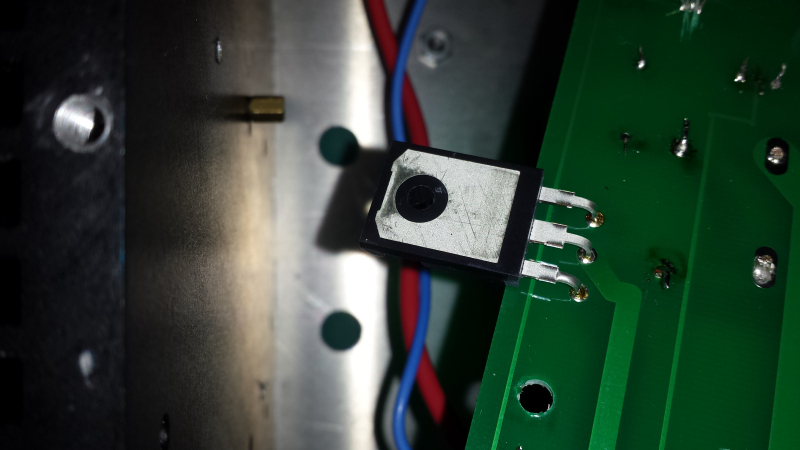

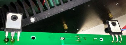

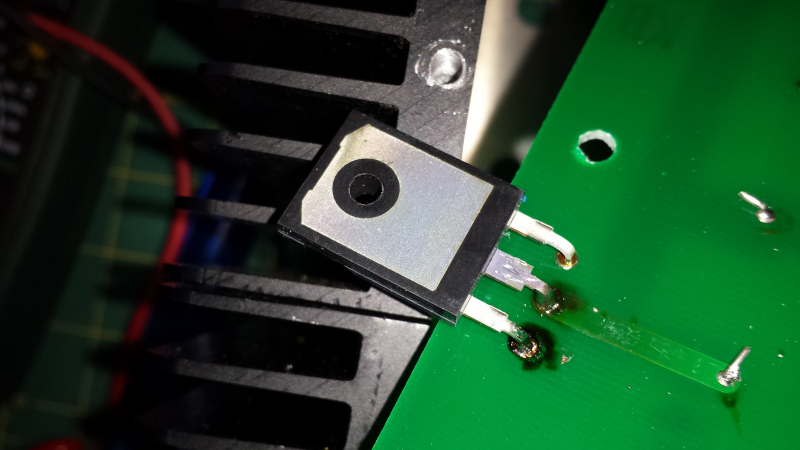

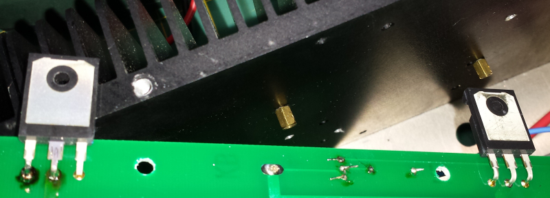

Resoldering the resistor didn't help, so took off pcb board. Found discolored mosfet back and source lead. Damage from overheating or possible bad solder job on source lead. What do you think?
