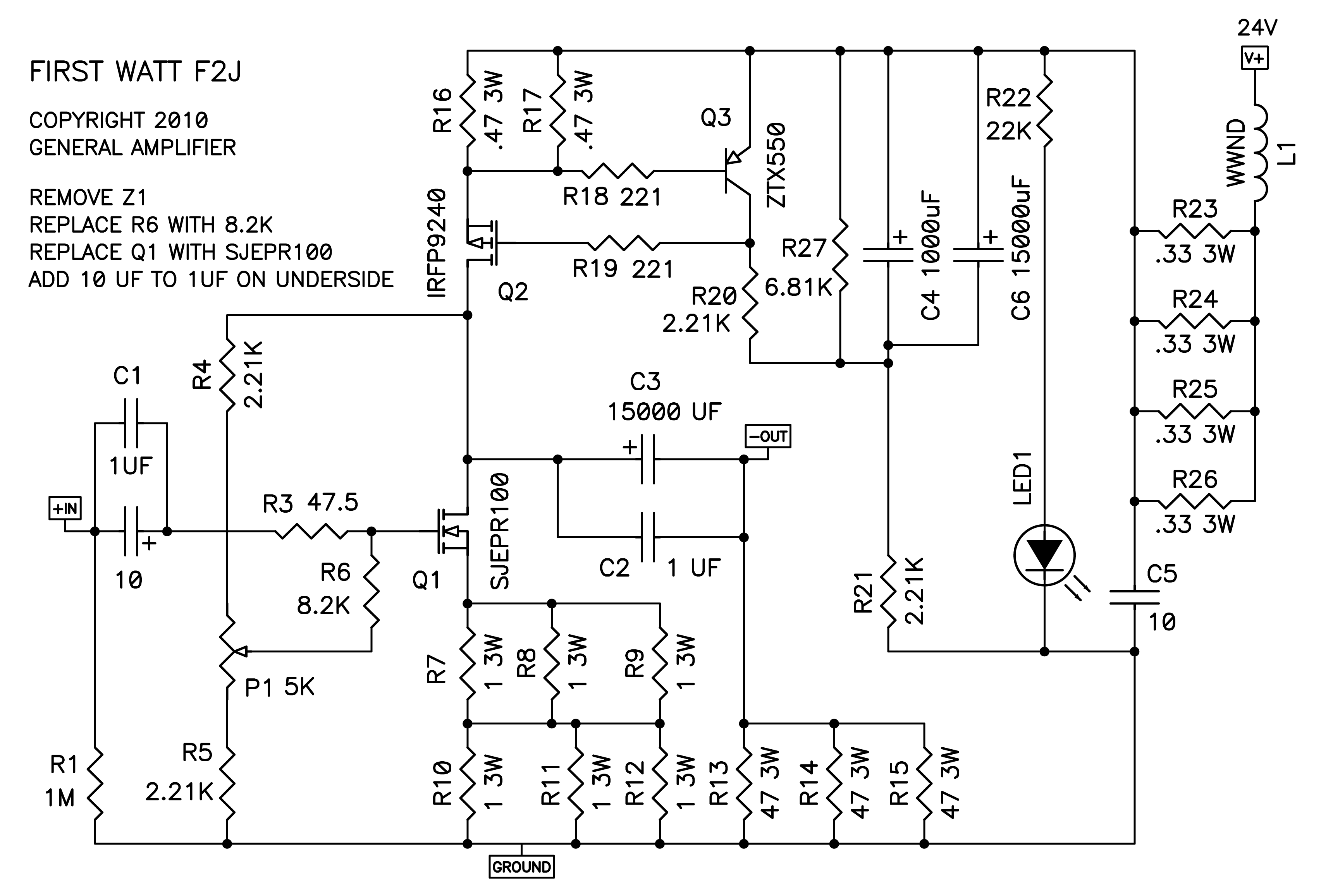

Will changing the second MOSFET IRFP9240 with a newer sicFet recommended?
Aside from the lowish Pd, the Wolfspeed C2M0280120D looks like a nice part.
Approximately a 4:1 safety margin in the F2.
I seem to recall trying these in an AMP CAMP a year or so ago and the distortion was roughly cut in half. I could be mis-remembering

Mike, thanks for the reminder on the Cree part. Will add to mouser order for next time.

Michael are you suggesting no need to desperately try for SJEP as the quality of audio( distortions) may be the same with Cree mosfets?
For an amplifier like this, the absolute distortion measurement is not the
only criterion. Each of these parts will have a slightly different sound, and
part of the entertainment is experiencing these differences.

upper mosfet is "just" decent CCS
For using C2M0280120D I need to change R3 /R6 or both for biasing correctly I guess?
Thanks Papa. Decided first trial with Cree !
I think you could start with the F2J values. You might want to put the zener back in. You could probably take R6 up a bit if all goes well and you want to try that.
PSU being 24Vdc nominal (more likely 22V5 , originating from 18Vac secondary) , all caps min. 25Vdc
C5 best if solid cap
Thanks Zen mod. More questions as I am collecting parts. What should be the Value of L1?
What should be the power supply rated minimum?
How can I calculate heat sink requirement for passively cooled design?
L1: http://www.diyaudio.com/forums/pass-labs/91168-diy-f2-clone-2.html#post1068548
PS: Standard first watt: 300VA 2x18VAC transformer.
Heatsink: F2 manual states total dissipation as 150W. You can use FW standard
chassis or store chassis
https://diyaudiostore.com/collections/chassis/products/deluxe-ultimate-amplifier-chassis
as guides.

Papa is routinely using 300VA xformer for stereo amp
just take al ook at any one-polar FW PSU
L1 is drawn as separate but somewhere in text is explained as internal inductivity of locally connected series wirewound resistor
