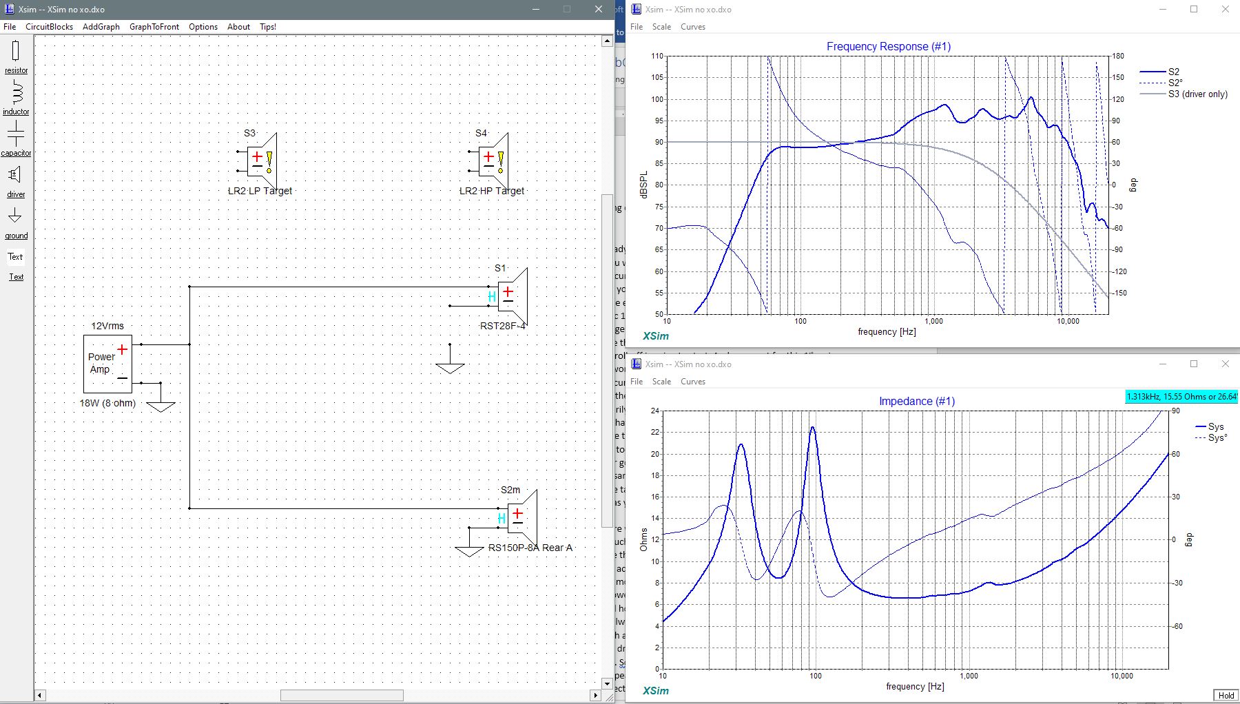

Also, is there something in XSim where I can just apply a filter to the drivers instead of changing component values every time? Just to start off to see the responses being filtered.

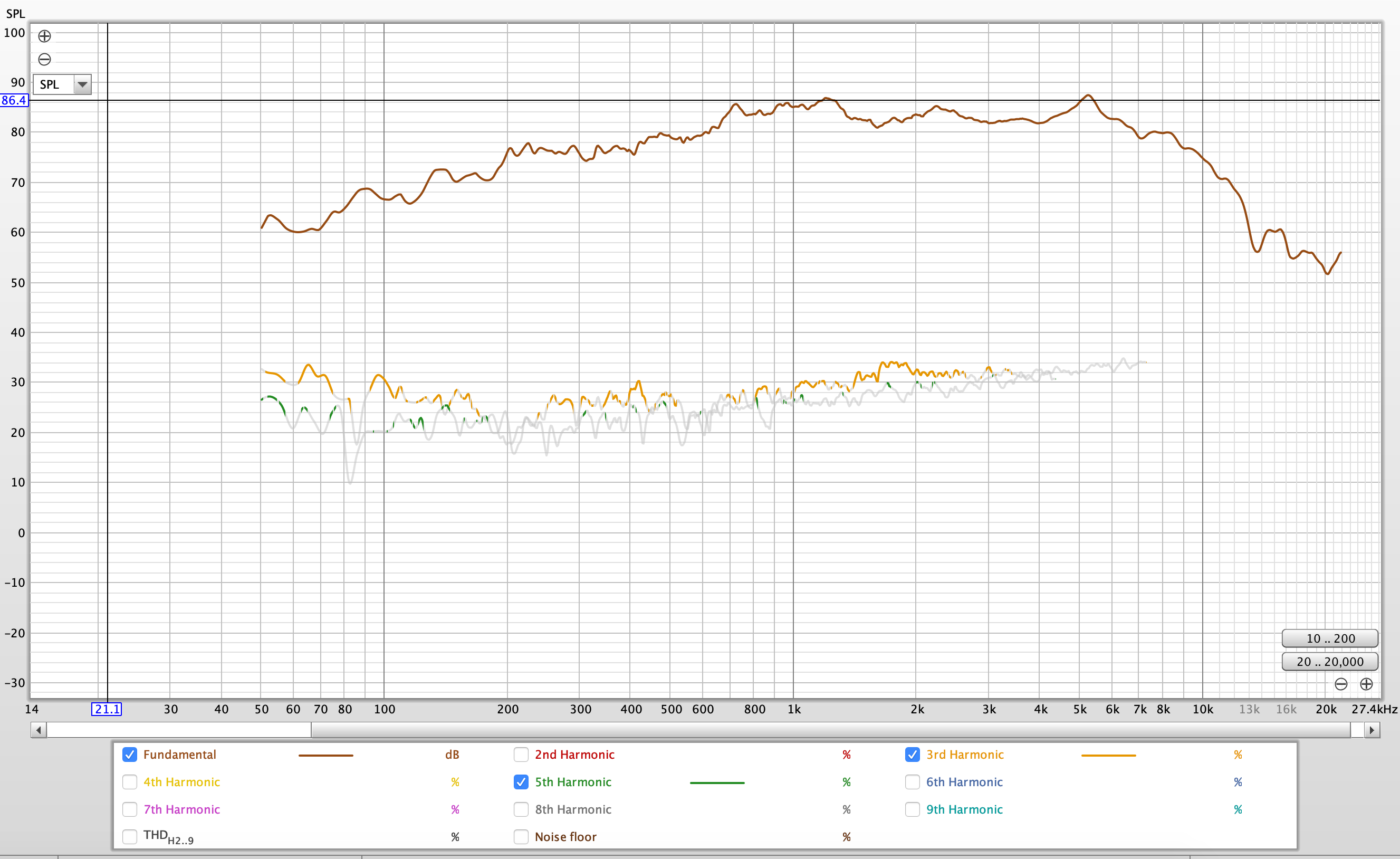

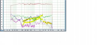

So I'll post this now since I already looked at it.

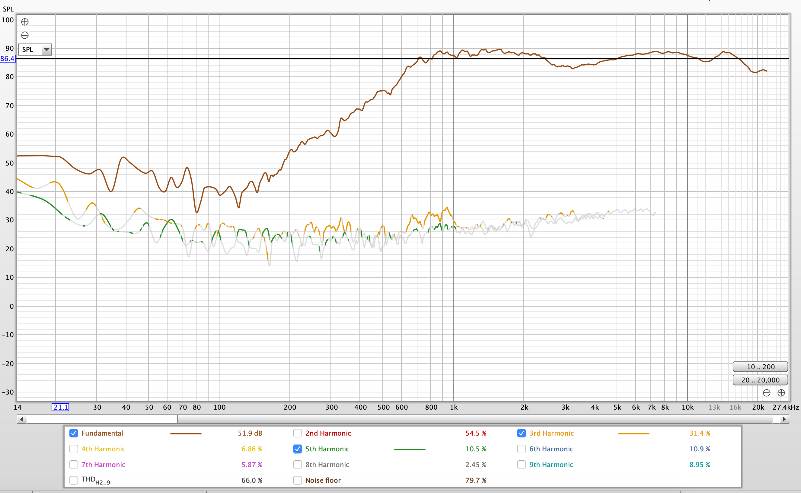

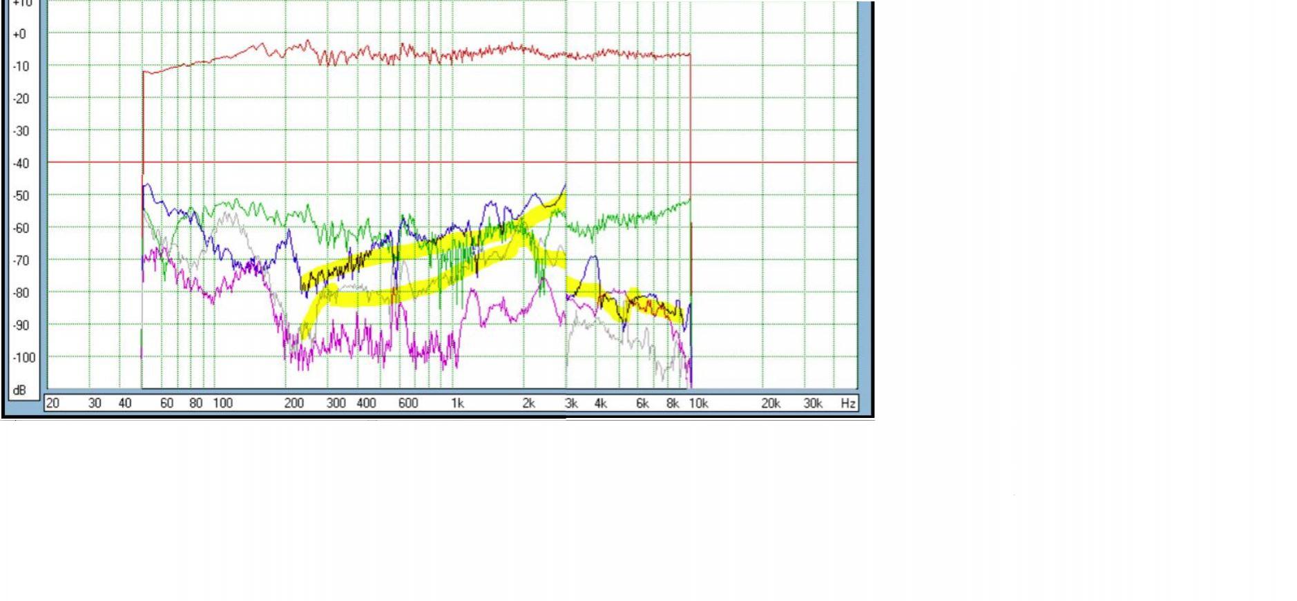

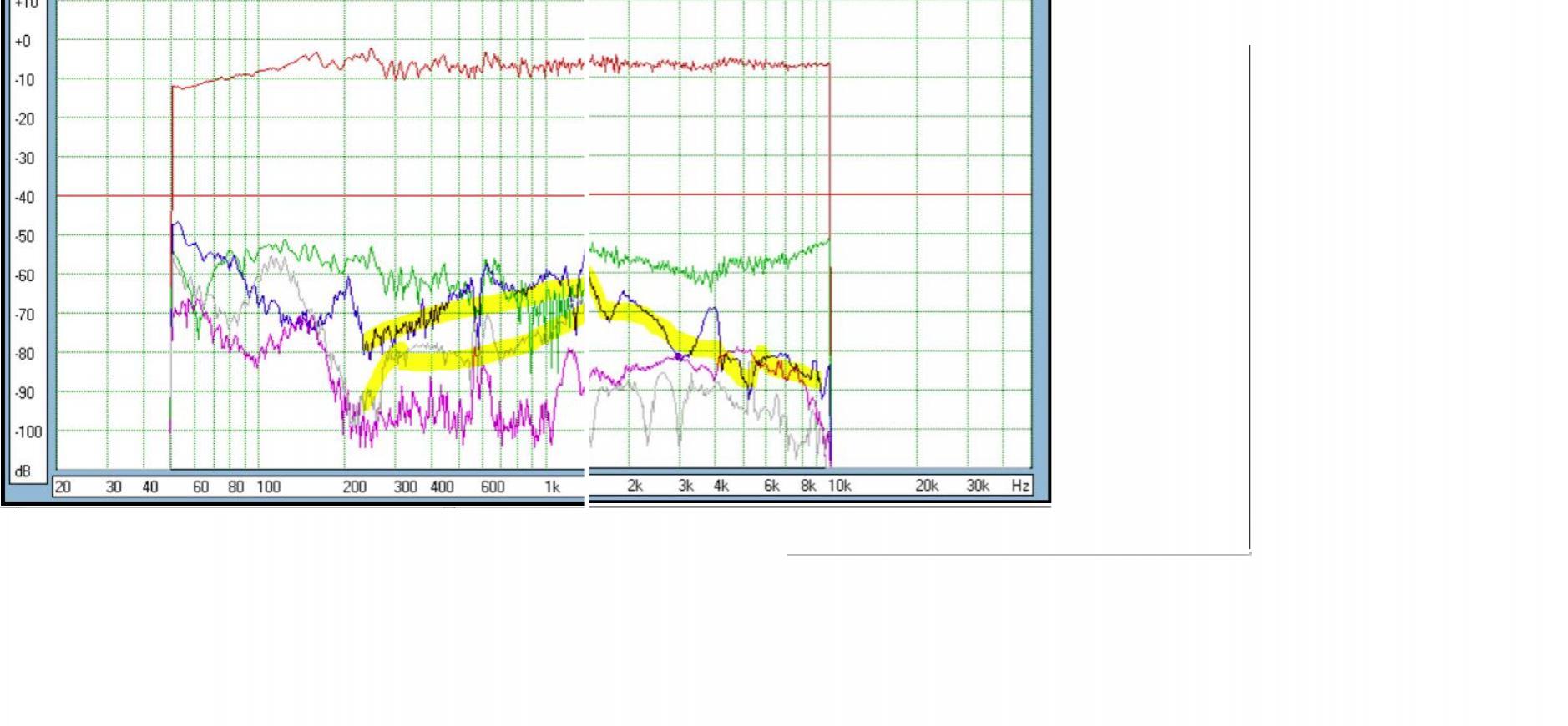

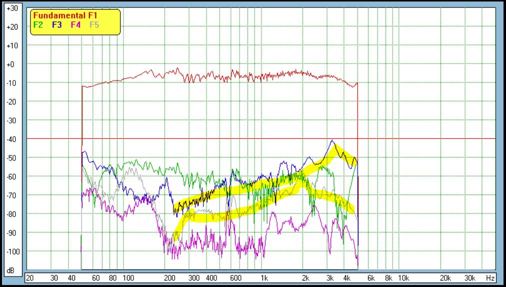

Fyi, distortion graphs for both Rear A and B where practically identical, so I'm just including Rear A.
So, while looking at the harmonic distortion of the rears they both have a relatively flat response which I remember you saying earlier that they might. Also, they both juggle around 30dB, so both close to each other. My only thought is that your example had F3 down near -60dB while these are around 30dB, dont know if that is something worth stressing about or not.
But to me, as far as the harmonic distortion goes, it would be adequate to crossover anywhere after 1kHz.

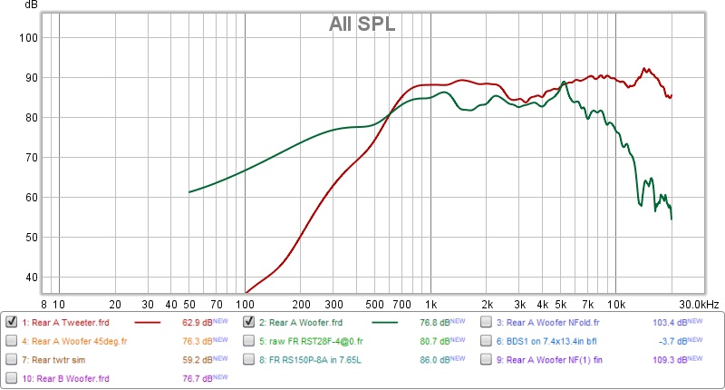

Screenshot 1: The tweeter
Screenshot 2: The woofer

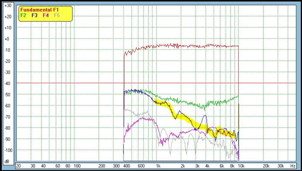

The fundamentals are up close to 90dB. The harmonic distortion levels are down around 30dB. The difference equals about -60dB. So that checks out.
And this is why we measure - quite a difference from the earlier versions of those drivers I used in my example. So I agree with your conclusion - harmonic distortion isn't going to make much of a difference for the xo point for these 2 drivers. Both of them are operating in a pretty similar clean range in the frequencies we are looking at. Maybe they'll be more intermodulation distortion in the woofer because of its greater cone excursion at higher output levels but I'm not inclined to sweat that one here.

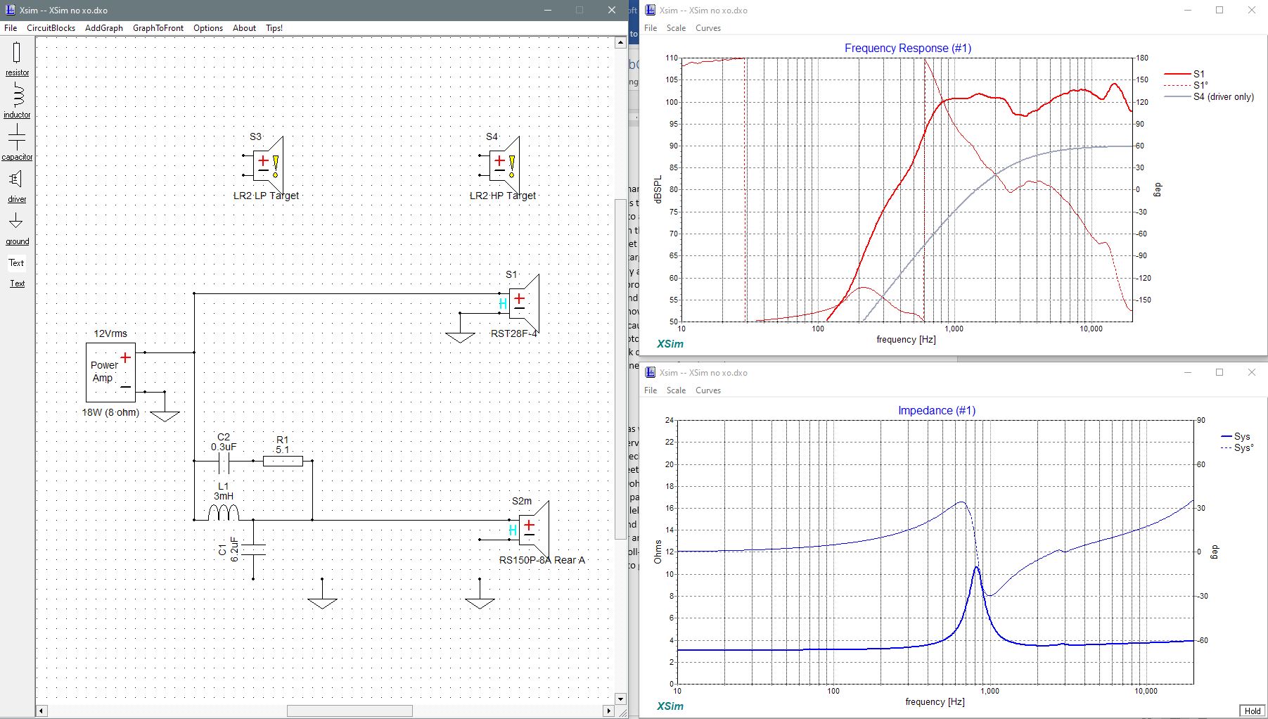

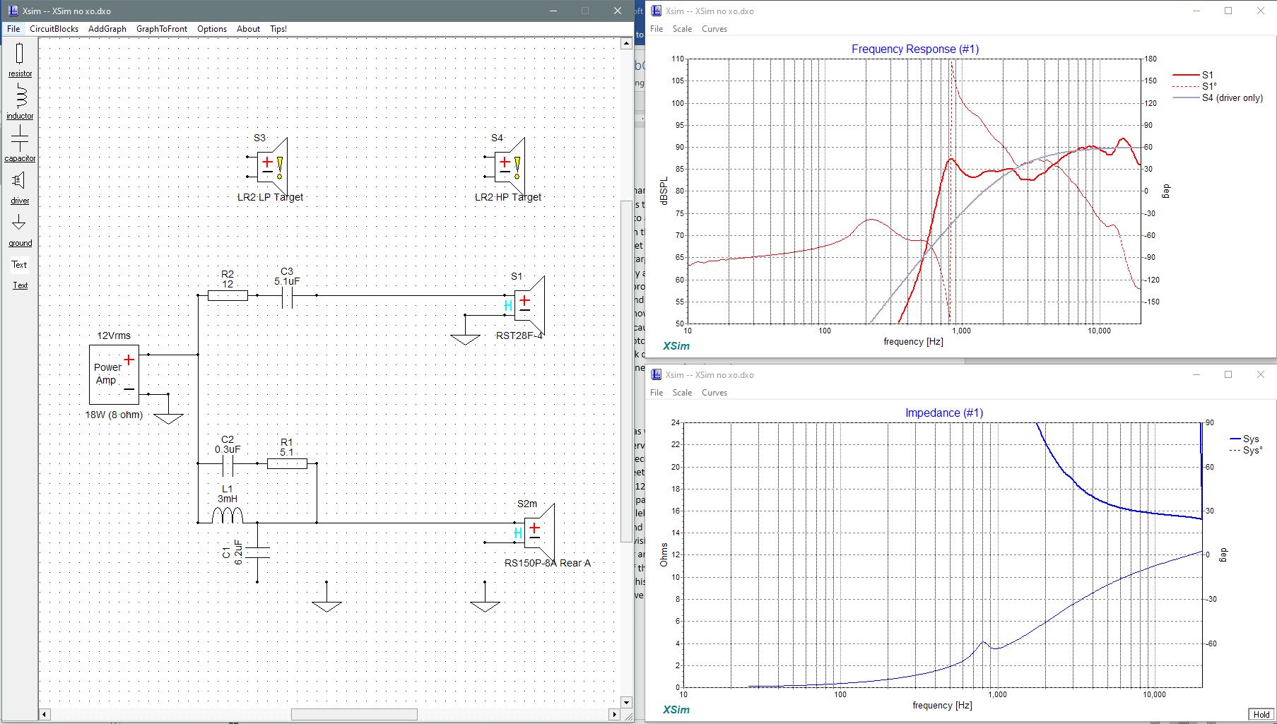

Wow that is actually a really good point that I would have never thought of haha. I've always stuck to the calculations!

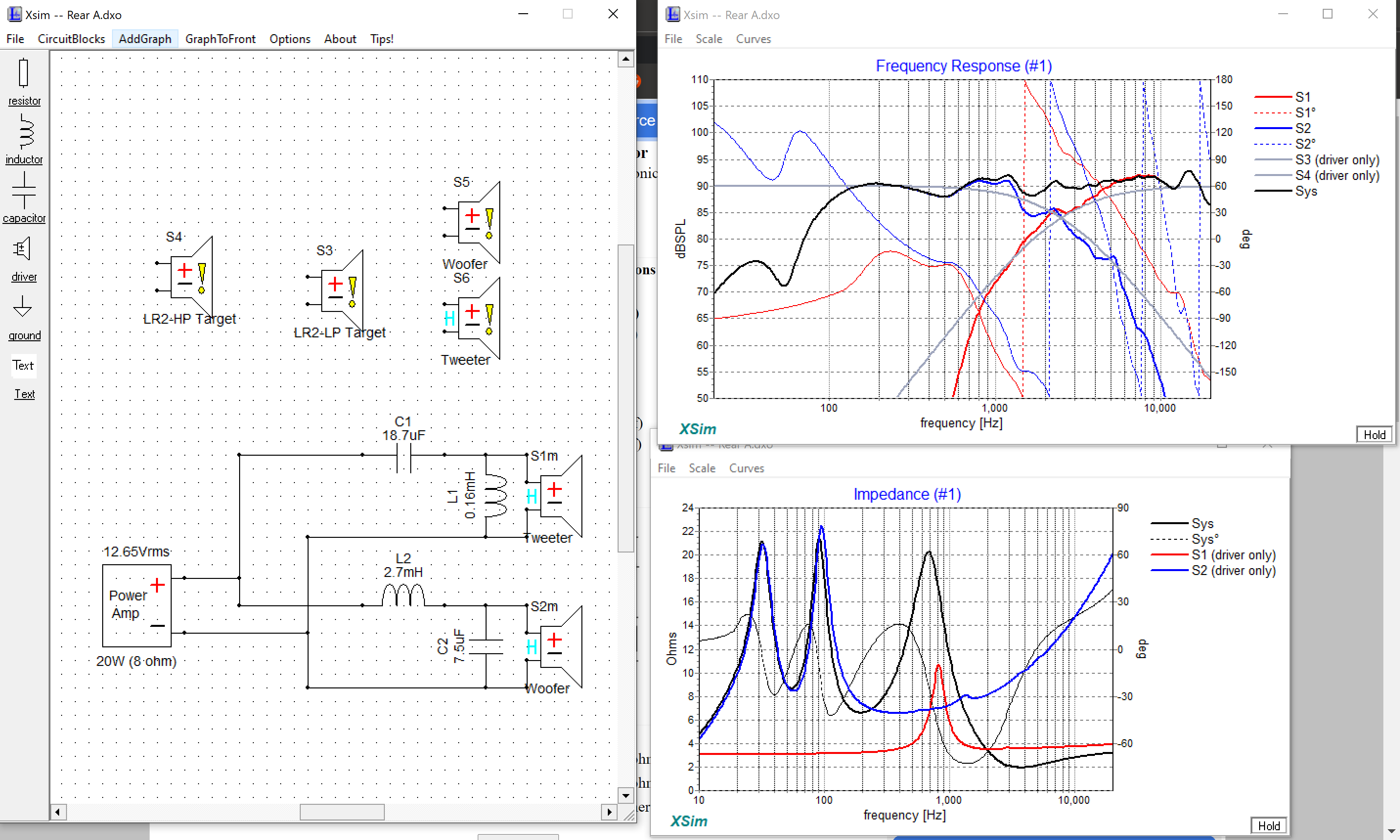

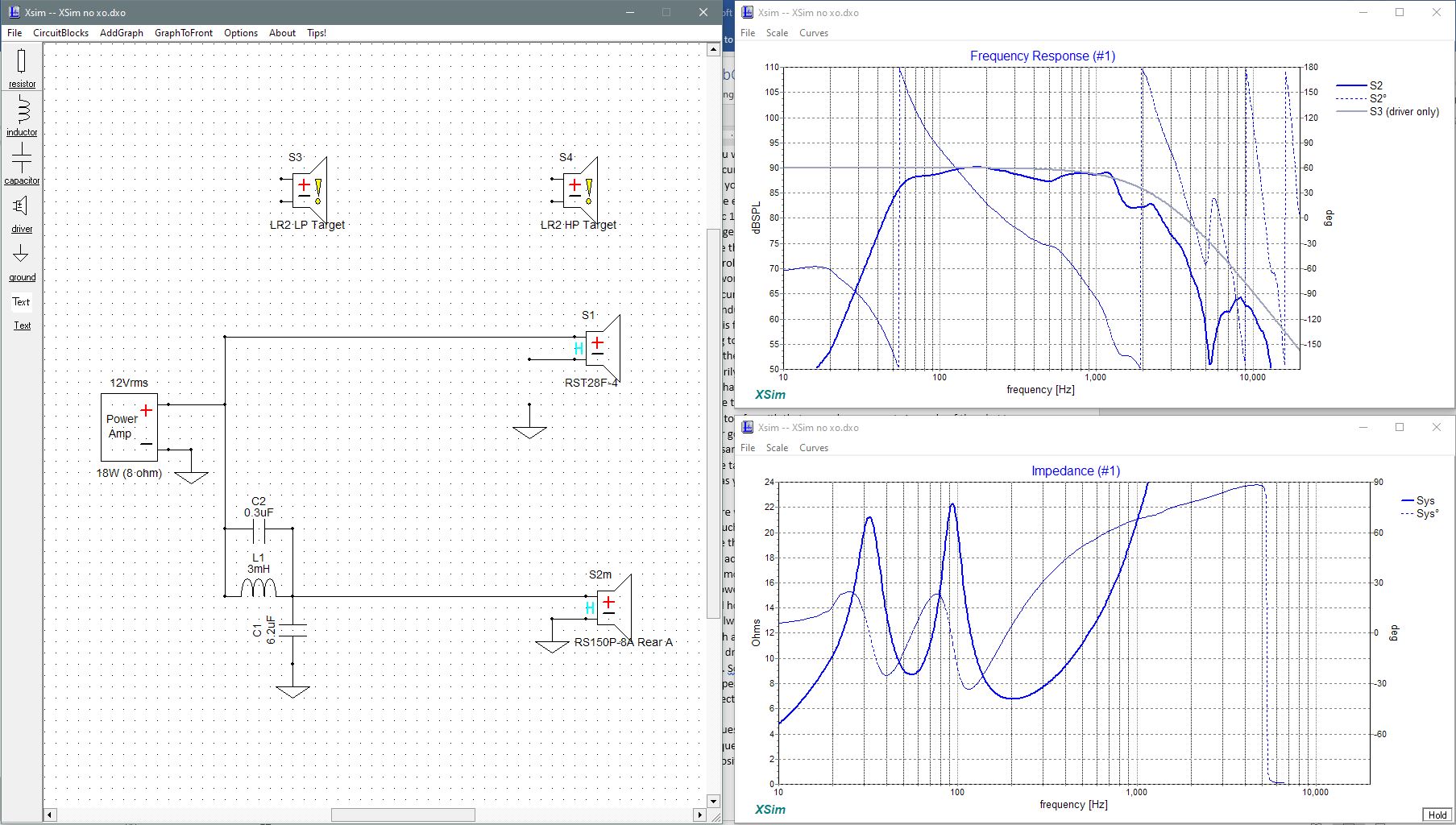

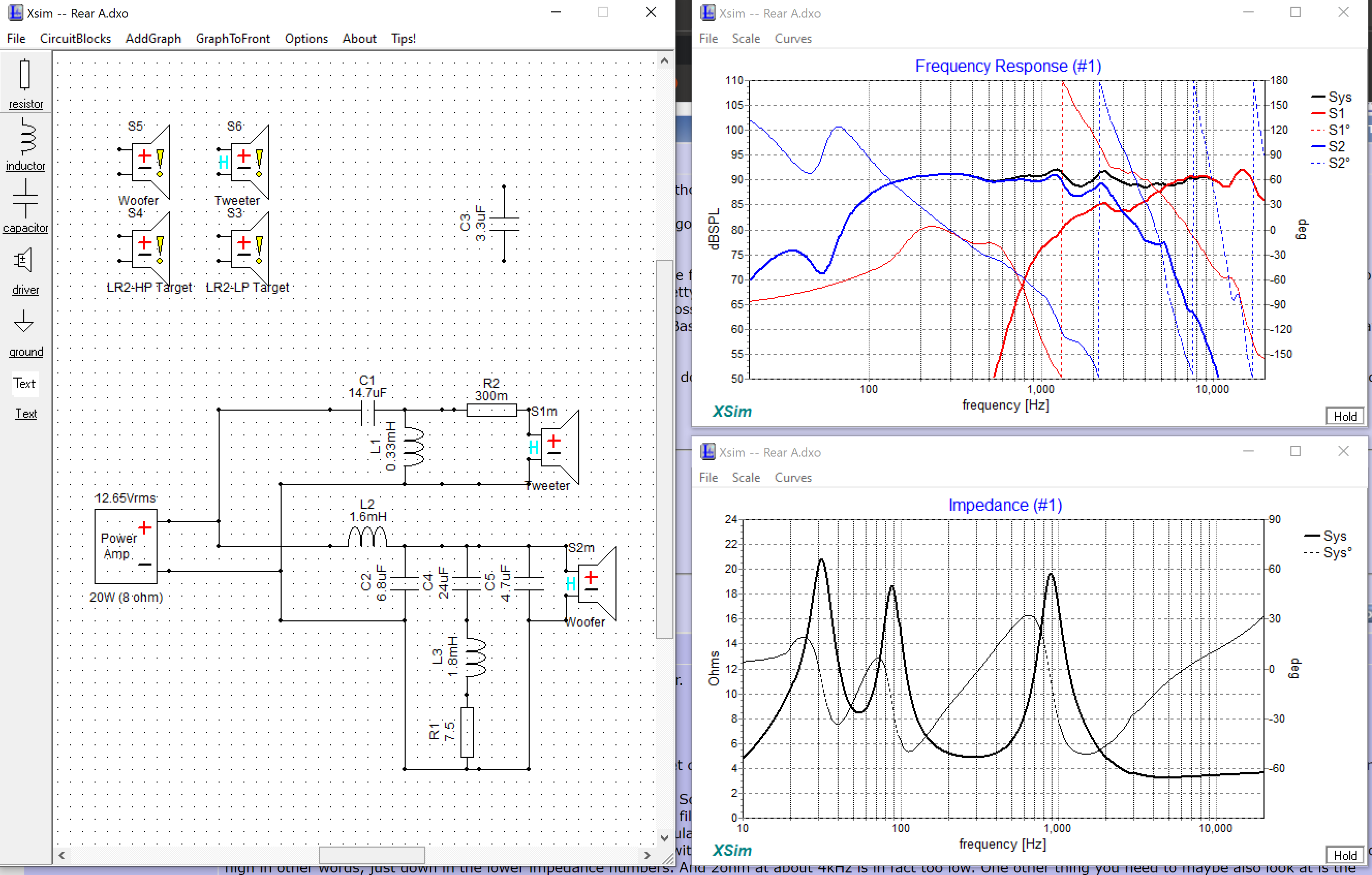

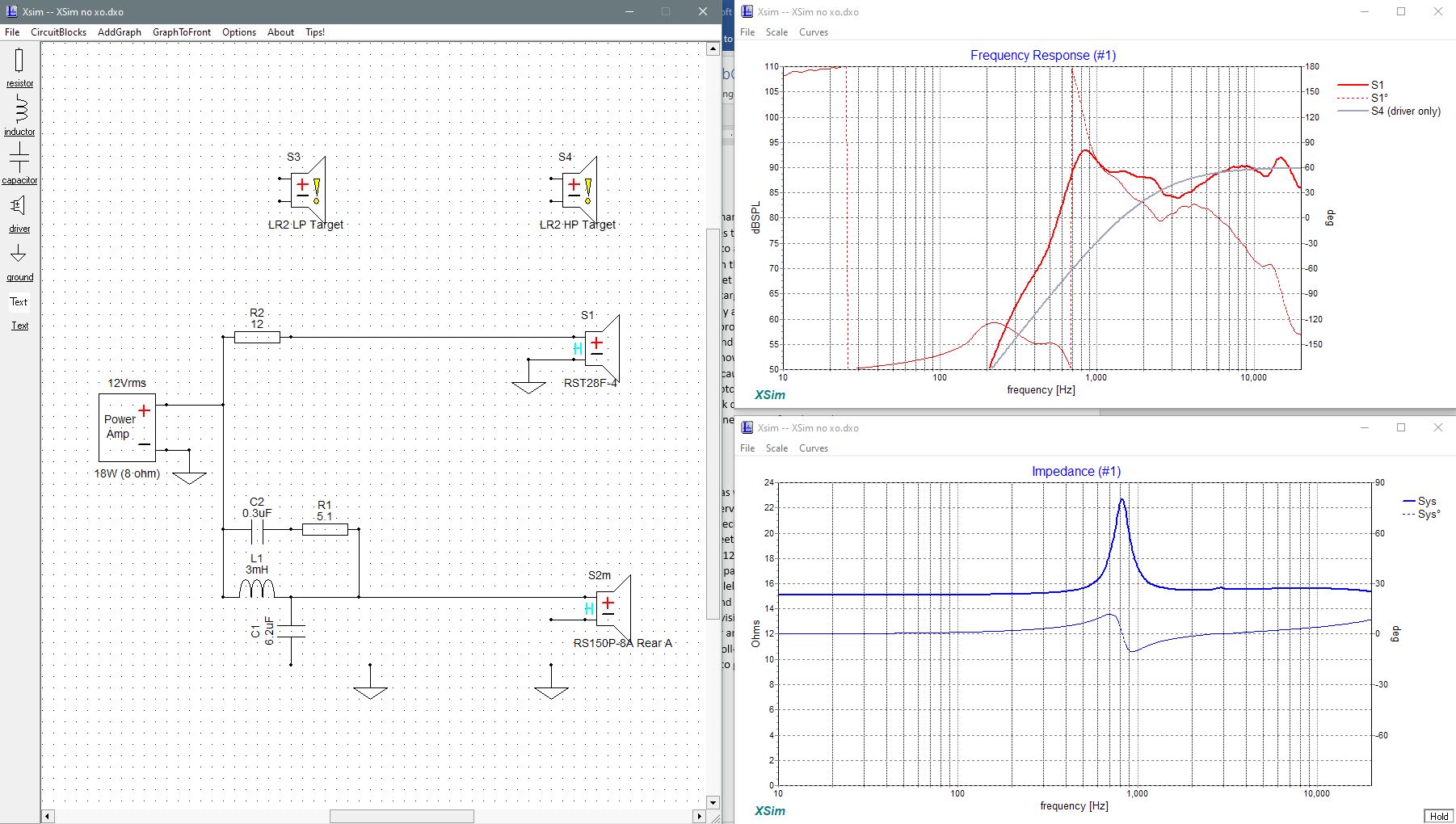

So I did what you said, just played around with it and the best I got was the screenshot attached.
A few things.
- I could not line up the phase and get the System response to be flat. The tweeters phase just did not want to move close to the target. I could lower the woofers phase down to where the tweeter is, but then the system FR looked pretty bad.
- The tweeters Fs is at about 65dB. So not even close to 30dB. Possibly might have to do a third or fourth order.
- I do not know how to take into account the impedance graph. Basically right now I tried to make that system peak in the middle not crazy high. But other than that I dont know what I'm looking for there.
Just a clarification, this is not by any means "the best work I can do". I spent 5 minutes on this just to get a feel for it like you said and wanted to shoot it to you because I have to go help the fam now.

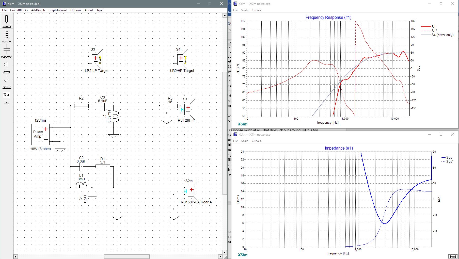

OK so here's a quick response before I write up something longer.
That's actually not half bad.
Re your questions:
- With 2 x 2nd order electrical, you've pretty much hit your target curves but you can't get your phase to line up. So add a 2nd series cap (3rd order) on the tweeter and adjust it mostly for the purposes of phase alignment.
- So 2nd order at 2500Hz means that tweeter Fs is still too high. So either you move the xo point lower, increase the slope or target the Fs with an impedance compensation filter, which is just another name for an LCR notch filter. Try a series filter placed in parallel. But I'll admit, figuring notch filter values on your own is a little difficult. That may need a separate tutorial or go to the PCD calculator in this instance and then start with those suggested values and adjust as necessary.
- there is really just 1 main thing to be mostly concerned about with impedance and that's that it doesn't go too low for your amplifier. Don't worry about what it's doing up high in other words, just down in the lower impedance numbers. And 2ohm at about 4kHz is in fact too low. One other thing you need to maybe also look at is the impedance phase. If it's dropping down below -60 degrees that could also be trouble, especially if the impedance is low in the same range. The same holds true at +60 degrees.
Besides what I already mentioned, here's my quick critique:
- C1 is too large and L1 is too small. This is in fact the reason that your impedance around 4k is going too low. As I mentioned before, try and get the first component in the network to do most of the work. In electrical terms, C1 is letting too much of the signal through and then L1 is passing too much of the signal to ground. And of course, if too much of the signal is going to ground it's called a....... wait for it... a short. Thus your dangerously low impedance in that frequency range.
- I'd also say your tweeter is running a little too hot still. Add in a series resistor either before the filter or after it or both or an L-pad just before the driver. Each of those attenuates the tweeter level but does so in a slightly different way. Which one is going to be most advantageous to this particular situation is only going to be revealed through trial and error.
Also to note:
- Just going with a 2nd order on the woofer means you've got minor problems with the midrange peak and following trough. They are still within plus or minus 3dB so that's why I say minor. You may wish to try a lower value on L2 and attach the mid peak with a notch filter. It's worth it as a learning exercise although in truth, I think I'd be trying to limit my xo part count for these surround speakers.
- The only other thing that might be a problem here is the woofer's resonance peak at about 5Khz which is only down about 15dB from the fundamental. And it's such an easy thing to fix. Add a small value capacitor in parallel with L2. Adjust until it hits that peak and observe the results. I call this a tanking circuit and it's just a variation on a notch filter, this time a parallel LCR wired in series with the driver but without the R component. And here's where you start to get into some of the possible elegance of xo design because L2 is pulling double duty -> it's acting as the 1st component in the 2nd order LP filter and it's working as 1 of the components in an LC(R) notch filter both at the same time. That's lovely.
Also to note:
I've actually had a little bit of a rough day today and I've kind of run of of brain juice.
I hope you won't mind if I wait until tomorrow to write you up something in a little more detail.
In the mean time, keep playing around with XSim though if you wish, all of it is a learning exercise. Go back into Response Modeler if you need to to create new target curves. It'll be up in the 1st module of the program under the "High Pass" and "Low Pass" sections. I spent a little time one day and created a folder of Filters and just created a number of useful HP and LP filters, LR2 and LR4, plus HP and LP filters together for midranges in 3-ways so I had easy access to them for future reference purposes. You might want to do something similar as you play around with your speaker xo's. Or not. 😉 Totally up to you.

So here is the new rendition taking your points into account.
I kept the impedance around 4ohms to keep it safe and tried balancing that FR more.
In terms of phase, it seems like I still couldnt quite get it there. But you did say if I were to flip the polarity of one of the drivers and there then produces a wide and deep null near the xo point, then that also indicates good phasing. Which is what happened when I flipped the tweeters polarity!
I couldnt get that small valley around 1.8kHz to smooth out. Possibly with more components we can, but again this is just the rears. And it's only like 2dB.
The peaks and valleys are all within 2dB from the fundamental.
Also, the impedance phase I tried keeping within the +/-60dB like you said. Idk if that the only criteria I should follow with impedance phase or not.
I did forget to focus on the tweeter Fs tho to make sure its way down. Oops, that is something Ill try to tackle again.
That is true about textbook calculations. Since the driver is not a fixed impedance, it always felt wrong running the calculations and putting 8ohms into the equation. Do you think it's needed to put in an impedance compensation filter on these or no?
Anyways, I hope it's looking pretty good to you for the rears (minus the tweeters Fs). Personally it looks pretty good. A little too many components than I would have liked, but they really did balance it out much better.
FYI, I do not have crossover components lying around for testing. So, I more or less want to get these sims pretty darn good and then test by ear for any small tweaks that might need to be done. In my experience, xo components are pretty expensive and I dont have the money to buy a lot or variations and test out them all. So for me, getting the base xo built and then if tweaks need to be made, then I can do that once.
I hope that made sense^ haha
First thing to check is your tweeter file. Something doesn't look right to me. From your REW file for rear A, the tweeter level is up at about 90dB and the woofer level down at about 300Hz is at about 77dB (attached). It's not quite possible to attenuate the tweeter 13dB with a .3ohm series resistor so either your file or mine is out of whack.
Re the xo:
- in terms of FR, it looks smooth enough but I'm concerned with those 2 peaks. Not that they exist but that they are too high in SPL compared to everything else. In the plus and minus game, peaks tend to be worse on the ears than the dips so better to err on the minus side instead of the plus.
- this may be something that you only learn through experience, or perhaps the calculators would show something similar, but you still have L1 doing most of the work on your tweeter xo. That 1st series cap of almost 15uF is hardly doing anything when it should be shouldering as much of the load as it can. Down in the neighborhood of probably 4-8uF is where you should probably be playing for a 2nd order filter and a 2500Hz xo point.
- speaking of, the xo point is up around 3000Hz which I think is a little too high. I've been shooting for something between 2-2.5kHz with 1 version even exploring a xo down at about 1400Hz.
- impedance is good
- phase alignment was better I think in the 1st version. A word of caution on the reverse null -> phase can actually be fairly poorly aligned and yet cross each other right at or near the xo point which means that with polarity flipped, you will get a null, possibly even fairly deep but more than likely quite narrow. This is better than no null at all but it still may not mean that the phase is well aligned in the xo region. Better is deep and wide if you are going to use the reverse null as a phase alignment indicator but it's better to just look at the phase traces themselves and see how well they are matching.
- you can also see that the tweeter level at about 2000Hz is barely below the woofer level so the 2 responses should be combining to produce some higher output and yet they are not. Because -> phase is not well aligned there. Chances are good therefore that when you move off-axis and the phase differences shift, that sum off higher output is likely to appear in the off-axis responses. Not ideal. Especially in the critical midrange zone.
- definitely a good exercise to try a secondary approach to the woofer xo, so a lower L2 value coupled with an LCR that attacks the mid peak, but I wouldn't have tried that until I'd exhausted my attempts with the 1st method. Regardless, see if you can't work those LCR values a little more to reduce that 1st peak at about 1200Hz.
- just in case -> capacitors wired in parallel sum their values. So although you've got the LCR in between them, C2 and C5 are essentially just wired in parallel. Nothing wrong with that really, often you need to combine more than 1 cap in parallel to produce a value that you need, but it's not really necessary here in the sim. Try shorting C5 and changing C2 to 11.5uF -> should be pretty much the same result. Could be there is some tiny difference because of the LCR in between, I didn't try it and I don't have an electronics background to know for sure, but I doubt it's anything significant.
Re the xo:
- impedance is good
So here’s the step by step procedure of how I basically go about working on a 2-way xo. I encourage you to open your own copy of XSim and follow along but your going to have to figure out your tweeter file to start off with.
- Start with the woofer. You’ve already set your target curve at about the same level as the driver’s level at about 200Hz. If you want to make life maybe a little easier for yourself, just display the woofer and the target curve. If you want to have a look at what your xo components are also doing to the impedance, you’ll need to take the tweeter out of the equation. So just pull the connection to ground off the driver and that will do the trick. Pic 1
- Drop in a series inductor and change its value until you’ve got a decent match to the roll-off (or knee) of your target curve because this is what the 1st series component does – it determines where in the frequency range the roll-off is going to start. And you want for this 1st series component to do as much of the work as possible. I stopped at a value of 2.7 mH and we are actually pretty close to the target curve already. Pic 2. As I’m sure you know, you also have to be concerned with the resistance of inductors. So just note that XSim automatically sets the inductor R value at .35ohm which is fine for now. You can adjust these later as you look at the real world parts that you are going to be using.
- Now drop in your 2nd component, the parallel capacitor and note how it changes the response as you change up its value – primarily it is increasing the roll-off below the knee that you set with the inductor. Note however that as it gets larger in value, you will usually actually see an increase in the response just above the knee. Sometimes you can make use of this but usually it’s an indication that you’ve gone too far with that second component. As a rule of thumb, I try to keep the values of the capacitor going to ground as small as possible. Too large and your impedance may drop too low the same way it did with your tweeter in your 1st attempt. Here I’ve got a pretty good match to the target curve with a value of 6.2uF. Note that the roll-off actually exceeds the target curve as you go higher in frequency which can actually be a good thing. Pic 3
- Note that with that cap value, there was a tiny bit of increase up around the knee so now I go back to L1 and increase it just a touch as necessary, up to 3mH now. Pic 4.
- We can look at our result and note that we aren’t getting the smoothest of responses between about 200 and 2000Hz but it’s not actually too bad for a surround speaker. For a speaker that was going to be used in perhaps a more critical listening situation I might try to flatten it out a bit more by moving the xo point lower or by trying to tame the mid peak with a notch filter. Up to you what you want do here and how many parts you want to throw at it. One rule of thumb to note is that dips or valleys are always easier on the ears than peaks so you want to keep that in mind when you are working with a response that isn’t quite flat.
- The only other thing to note is the driver’s resonance peak at about 5kHz which is only about 13dB down from the fundamental. So let’s hit that with a tanking filter. Add a cap in parallel with L1 and adjust until it hits the peak. I used .3uF. Again note the effects. The peak is well taken care of but the roll-off is affected too - positively below the peak and negatively above it. Pic 5.
- So you might again try readjusting your LP filter values but I didn’t find here that any changes produced better results so I left them the same. Note that L1 and C1 work together to position that tanking notch so that if you change 1 you probably need to change the other one too. Depends on the size of the changes though.
- Now at this juncture, it’s possible to already see that if you just want to keep the xo as simple as possible and accept some wiggle in the FR (ie. you are not going to treat the mid peak with a notch filter), then the 2500Hz target is probably a little too high here because we can’t raise the actual FR of the woofer up to the target curve without also raising that mid peak up as well. And that’s something which is not really a very good idea. So you can either create and then import a new target curve for the tweeter probably somewhere between 2000-2200Hz or you can just eyeball it with the 2500Hz curve and aim a little to the left of it as you work with that driver.
- Ok, almost done with the woofer now but I’d be remiss if I didn’t finally note that the tanking filter as used here can potentially cause you low impedance problems so it may be a good idea to decrease the depth of the 5K notch by adding a small resistor in series with C2. A 5ohm resistor brings the level of the peak down about 30dB from the fundamental which is fine. And now the woofer is done until we fine tune it after doing the tweeter. Last pic.

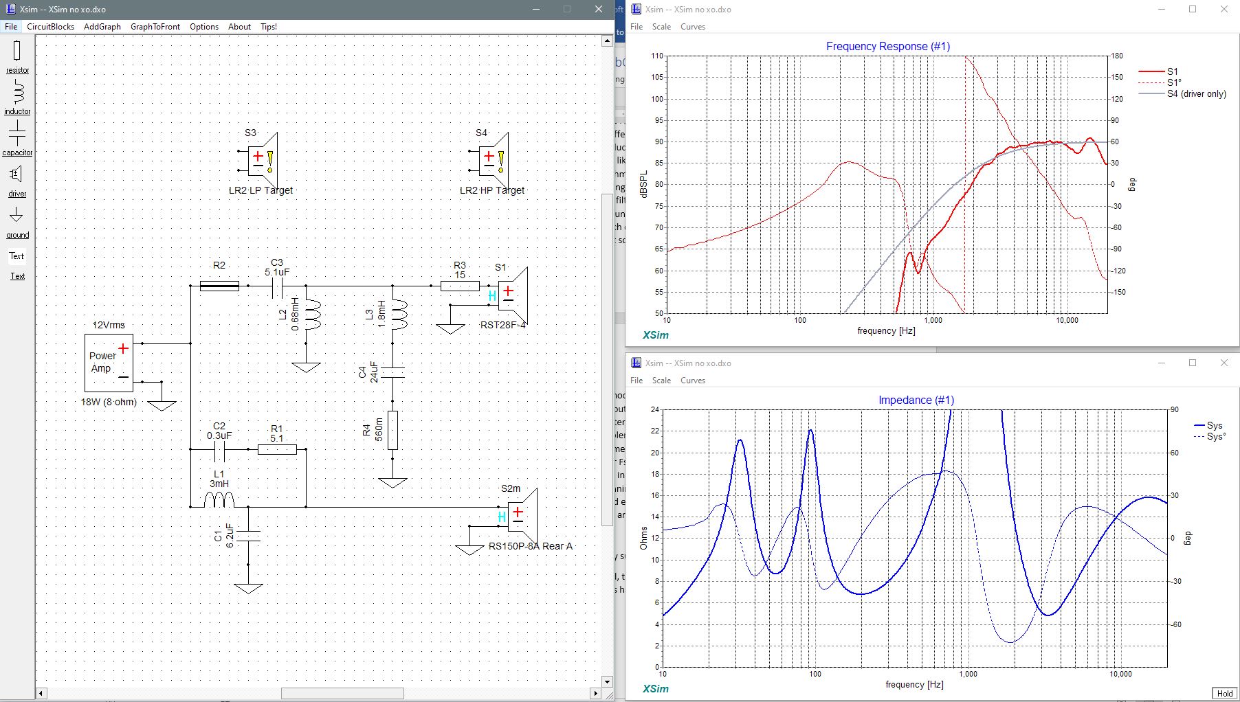

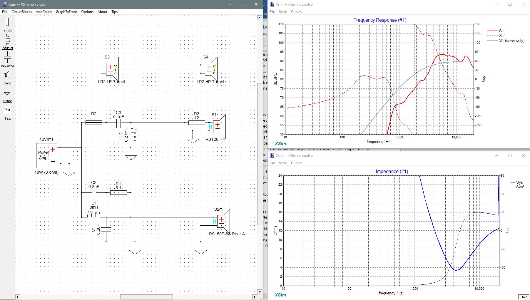

On to the tweeter.
- If you want, you can do the same as with the woofer and just display the tweeter and its target curve to start off with, and to observe impedance changes, this time disconnect both the woofer lines to ground. Note that I have decided to use a new target curve –> LR2 at 2100Hz. Pic 1.
- First thing to do is to bring the tweeter level down to your target level so just throw in a resistor in series at the start of the circuit. 12ohm looks good. Doesn’t have to be perfect here, just something to get you into the ball park. Pic 2. You could also use an L-pad here just before the driver, so both a series and a parallel resistor but the single series resistor is just simpler to start off with. Try both if you want to and note any differences in the result if there are any but I don’t think the differences are as visible without the other xo components in the circuit.
- Now add in the 1st series capacitor and start to lower its value. Now with this tweeter’s dip at about 3kHz, we can’t really roll-off the lower frequencies without also bringing that 3K dip down below the target curve as well so this is going to be a little hard to choose a starting value. Let’s go with about 5uF because again we are trying to get this component to do the majority of the work. Pic 3.
- Next add in the parallel inductor. About .27mH gets a decent match to the target curve now in the lower frequencies. Like with the woofer, the tail end of the roll-off exceeds the target curve which is fine. Pic 4
- But to be honest, I’m not liking the response much at all. That dip/suck out around 3kHz is too much. So time to try something different. As I said before, where you place the series resistor or perhaps an L-pad instead can produce different results, so let’s try a series resistor after the filter now and see what that looks like. So short R2 and then add in a new resistor just before the driver. Something around 12ohms again should in theory be about right so let’s set it there even though that’s not really looking very good either. Pic 5
- But we haven’t tried changing the filter values yet so let’s try that next. Let’s repeat the process from above, so disconnect the ground connection to L2 and see what C3 alone looks like first. Still that suck out at 3K so not much difference so let’s leave it at about 5uF. Now re-connect L2. The roll-off is exceeding our target so let’s increase the value here and how about that? By about .62mH, the response has smoothed out and we are much closer to the target curve and a larger value is always preferred here if possible. A little increase to R3 now, up to about 15ohm and now you are looking excellent on the tweeter too. Not perfect yet but much better that before. Pic 6
- So note in particular how the position of that series resistor can interact with that 2nd order inductor in parallel to create very different results. It’s quite dramatic in this example actually. Again this is a real advantage to these simulation programs because I don’t think any kind of xo calculations are going to be able to predict these kinds of results.
- Like with the woofer, the last problem with the tweeter is the level of its Fs. Still too high at only about 20dB down from the fundamental. You could go with a steeper slope or you could go with a notch filter aimed at the tweeter Fs. Let’s try the notch filter 1st which in this situation will typically be a series filter attached in parallel. These are admittedly a little more difficult to find the values for and because I’m running out of time today, I’m just going to give them to you now and follow up with a more detailed explanation later. Let’s try 1.8mH for the inductor, 24uF for the cap and .5ohm for the resistor and that now puts the 800Hz Fs down about 30dB. Pic 7. Not the best actually because frequencies right next to Fs are still up a little higher but not too bad at this point.
- Your tweeter response is following the 2nd order target curve to start with and then actually exceeding it as it rolls off further but I think the same was true for the woofer so let’s look at the summed response now before we go any further. And that kind of roll-off behavior is actually a good thing -> keeping the good stuff in the passband and pushing the poorer stuff down lower when you don’t need it any more.
