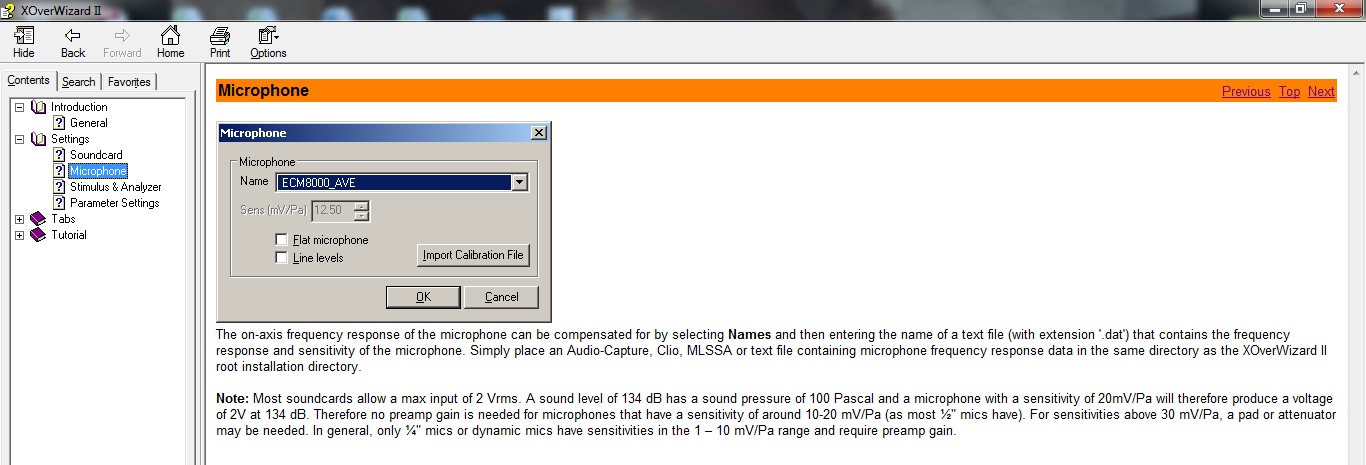

I think you must have the Dayton EMM mic? The Omnimic uses a USB interface and comes complete with matching software. There's plenty of info on the Omnimic setup and use if you search the P.E. forum or over at the AVSForums in the diy section.

Nope we are definitely talking the right mic, it has the mini usb plug. The difference between v1 and v2 is the v1 they give you a code to plug into the software, whereas v2 comes with a calibration file. Only problem is that code only works in the Dayton software…
Dayton have an offer whereby if I send it to them they will calibrate it for free and send me a calibration file. Been thinking I should pull my finger out and do this since the Ground Sound software needs the calibration file to level the mic, which I currently can’t do.
The setup issue I have been having are with the GS software as you measure in it, and it can automatically do all kind of whizz bang auto programming stuff to flatten the response.

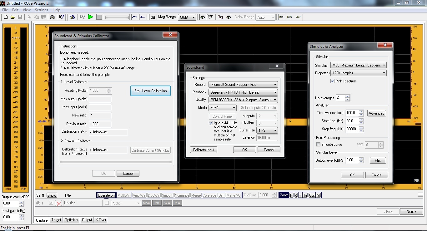

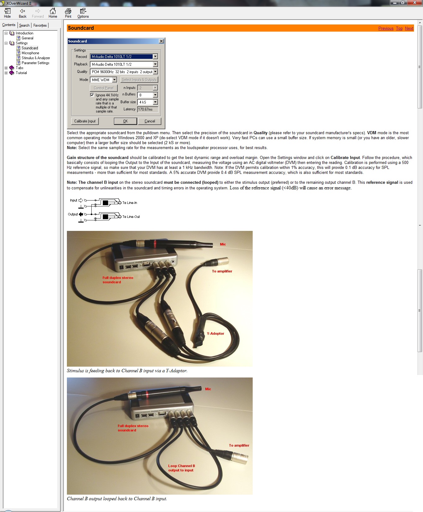

Tried to see if I could get this sound card stuff sorted out...
Reading through the help I cant see where you are supposed to hook in the multi meter.
Help please!
Help please!

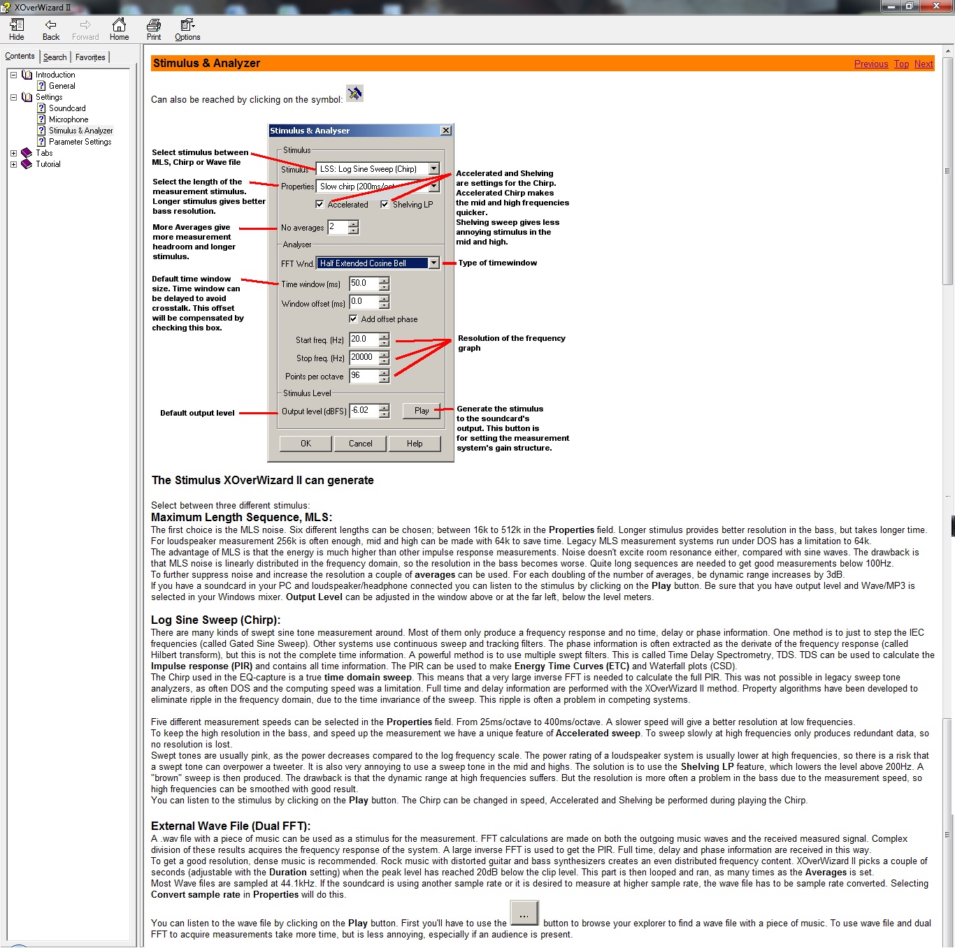

Leave the Ground Sound software for later. Use the Omnimic as intended. Let's just get some initial sweeps and EQing.
Can't you manually adjust the Ground Sound processing? In most cases, except for maybe DEQX, auto settings aren't the best and even then most people mod what the DEQX sets anyway.
Yes it does allow quite a bit of flexibility, I was planning on running the auto setting just to get a base line.
