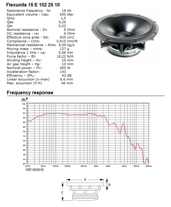

I currently have the crossover to the 10" at ~500Hz, but it is seriously lacking bass because of the low 88.5dB efficiency (compared to the 95dB Raal and 93dB mids in parallel).
I notice the 15's you have there are ~100dB mark which should give the bottom end some oomph. Should I use 1 or 2 15" per side? Do you find the single enough for bass heavy music?
Would I gain another 3dB by separate amps on the 4ohm drivers or remain at 93?

I basically have 4 channels to play with per side. I was thinking of perhaps making the OB bass swappable with separate subs for movies, but you are using them in conjunction.
So I could the RAAL tweeter, a pair of 12MUs (which ever config), something like the 15" your using, and a sealed or vented sub per side.
But if I am going with a separate sub do I really need to go 15" for the woofers?

Yeah, not many 15" I'd like to use up to 500 if I could help it, unless you want to spring for an AE Lambda TD15! Those are amazing drivers. Maybe a nice 12" would do the job. I really like the B&C because it measures well and has a small neo magnet and a nice, open aerodynamic frame. See some good measurements of larger woofer here:
https://sites.google.com/site/drivervault/driver-measurements
I would certainly use a proper sub under 50-60hz unless you want to follow Stig's lead and have massive OB subs.
Just looking for full pictures of StigErik's system now...
Well I don't really need to cross over as high as 500 merely doing that to try get some more life out of the 10".
Take a look at the 12MU graph and tell me where you would cross over from the 12MU's to the 15" please.

You need to see how the 12MU measure without a baffle. You might get away with 350hz, but hard to tell without distortion plots while EQ'd to play that low OB. I run my B&C 15" up to 300hz no problem.

You need to think about the wavelengths involved. He's looking at crossing at 2k which is a wavelength of 6.75".
The AE aren't that dear, and the do seem to be designed for OB. Unfortunately I can't find a frequency response for them. Anyone used them that can put a good word in for them?

They certainly are open on the back and ideal for dipole. Was thinking about the height of them if I was to get two for each side they would be 30-36" high just for woofer.
Would a separate tweeter / mids / mid woofers along side work?

What about going wide with the woofers. Side by side both low. You could make an H-frame and then place the mid/tweet baffle on top as a separate piece. Or just use one, live with it for a while and if you need more bass, make some nice subs.

Greg I did consider side by side but that would make each speaker 36+” wide… Plus even with them low I’m not sure I would still get all of the drivers above them.
After my tuning session last night with the RAAL crossover roughly 2.5k and the 2 x 10” crossed over at 1k, I felt the midrange was still a little thin vocally and really needs a pair of proper mid woofers to bridge the gap between the 15” or 18” woofers.
So just doing a speaker count that would be 2 x 120mm (12MUs), 1 x RAAL tweeter, 2 x 8” Drivers (unknown as yet) and the woofers. That is going to make for a high and wide speaker.
Figuring if I could stack both woofers into one H frame standing up, and run a separate frame holding the other 5 drivers, it would make it not so wide and not so tall.
Hoping I can get away without subs but would add as required. Just an idea open to suggestions…
