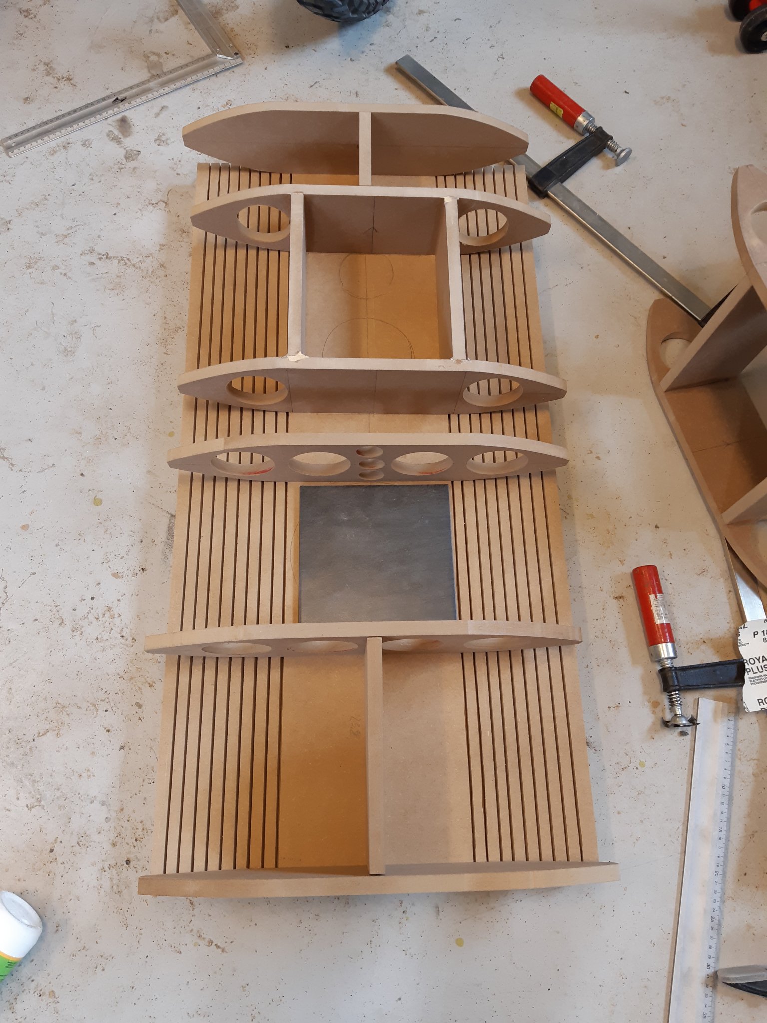

Attached is a picture from the build with the parts laid out as intended. Behind the woofer I glued a roof tile, filled the slits with some glue before I bent them to shape and glued them on the braces, then added some bitumen on the surfaces. Should have braced more at the bottom, but the 'legs' I glued on the front actually helped to stiffen that up later. As you can see, the baffle pieces are too narrow, so I ended up making separate 'fill pieces' for the sides. First time I built a complicated shape like this, a little bit over my skill level..Thanks, yours look great. I planned something simular. Dark in the middle and light on the sides, makes them look slimmer.
I had to make some compromises on the width. 40cm is the max for me.
11600/40 = 290. So baffle step start around 300Hz hence my idea to cross there.
How did you brace yours? Im thinking to use metal if possible. Dont know if it is a good idea.
Just for not losing to much volume, as Im short of it already.
Something I learned after is that a bit asymmetrical bracing can be good to 'diffuse' the resonances in the cabinet too. If the un-braced surfaces are equal, they are likely to have equal resonances.
I think it will be a lot easier if you make a flat back, you can then make the baffle with bracing first, and only put on the flat back in the end. This way you can do all the reinforcing/bracing/bitumen after the baffle has been glued to its final shape.
As you see, the mid cabinet is square, which I regret afterwards.
I had to fill with a lot of damping in the top and bottom to kill a standing wave in the speaker (looking at woofer impedance plot). It's not easy to do that once it's glued together.. Maybe you can play around with that before you permanently glue the back.
I run mine sealed, to my ears the group delay from BR does not sound good. The room helps with lifting the low end response, so it's pretty good in room without EQ. One way to deal with a too small cabinet could be a resistive port ('variovent') or possibly a large series cap on the woofer, but that adds group delay too, and loads the amp more.

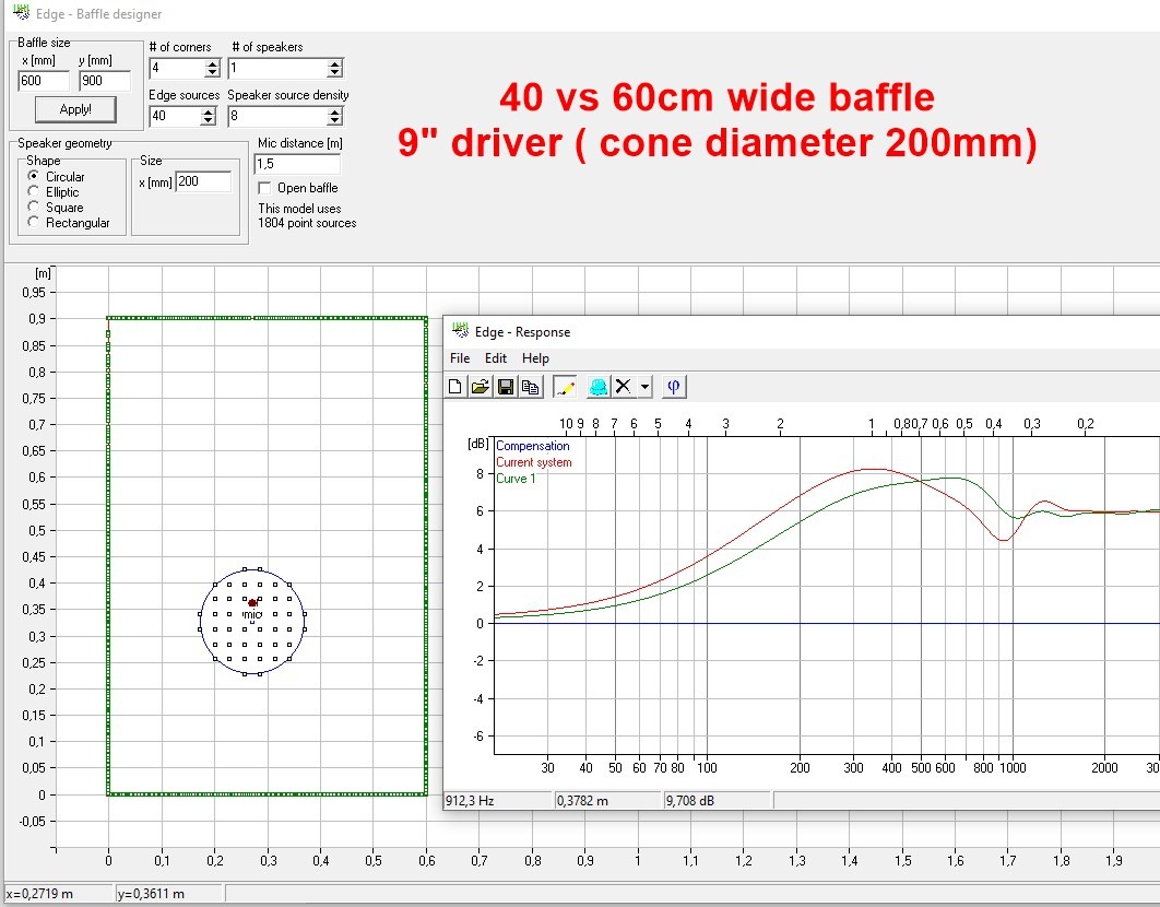

Thanks great help broaden my view an consider some options 👍Panel width 40 vs 60cm doesn't make a big difference. I suggest making the backside angled so that the box is like a triangle. It helps to tame internal reflections and suppress resonances. Many ways to install internal braces. I support closed box, room response will be better than most people can imagine, and minimal EGD give super bass quality! Consider SB29 too!

Maybe more for the mid?Panel width 40 vs 60cm doesn't make a big difference.
Edit: looking at it again, I would say the diff is there for the woofer too, abt 1dB over a wide range. That energy is radiated forward instead of back to the wall behind the speaker, which reflections are later causing interference with the direct sound.

WOW nice. You made a lot of slits to bend the sides. Troels only put 2 or 3.Attached is a picture from the build with the parts laid out as intended. Behind the woofer I glued a roof tile, filled the slits with some glue before I bent them to shape and glued them on the braces, then added some bitumen on the surfaces. Should have braced more at the bottom, but the 'legs' I glued on the front actually helped to stiffen that up later. As you can see, the baffle pieces are too narrow, so I ended up making separate 'fill pieces' for the sides. First time I built a complicated shape like this, a little bit over my skill level..

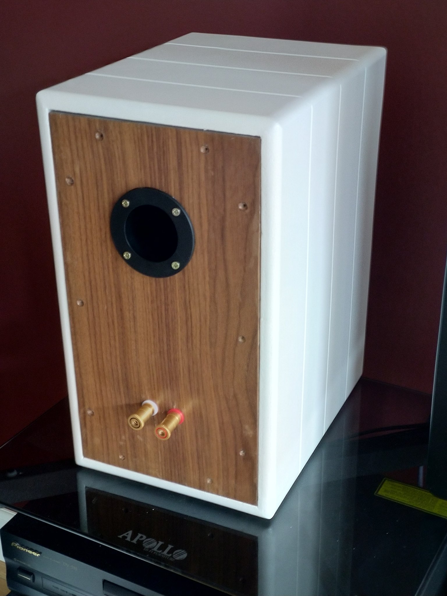

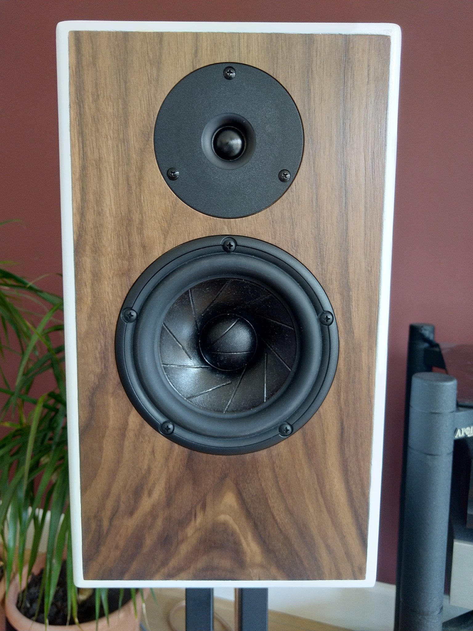

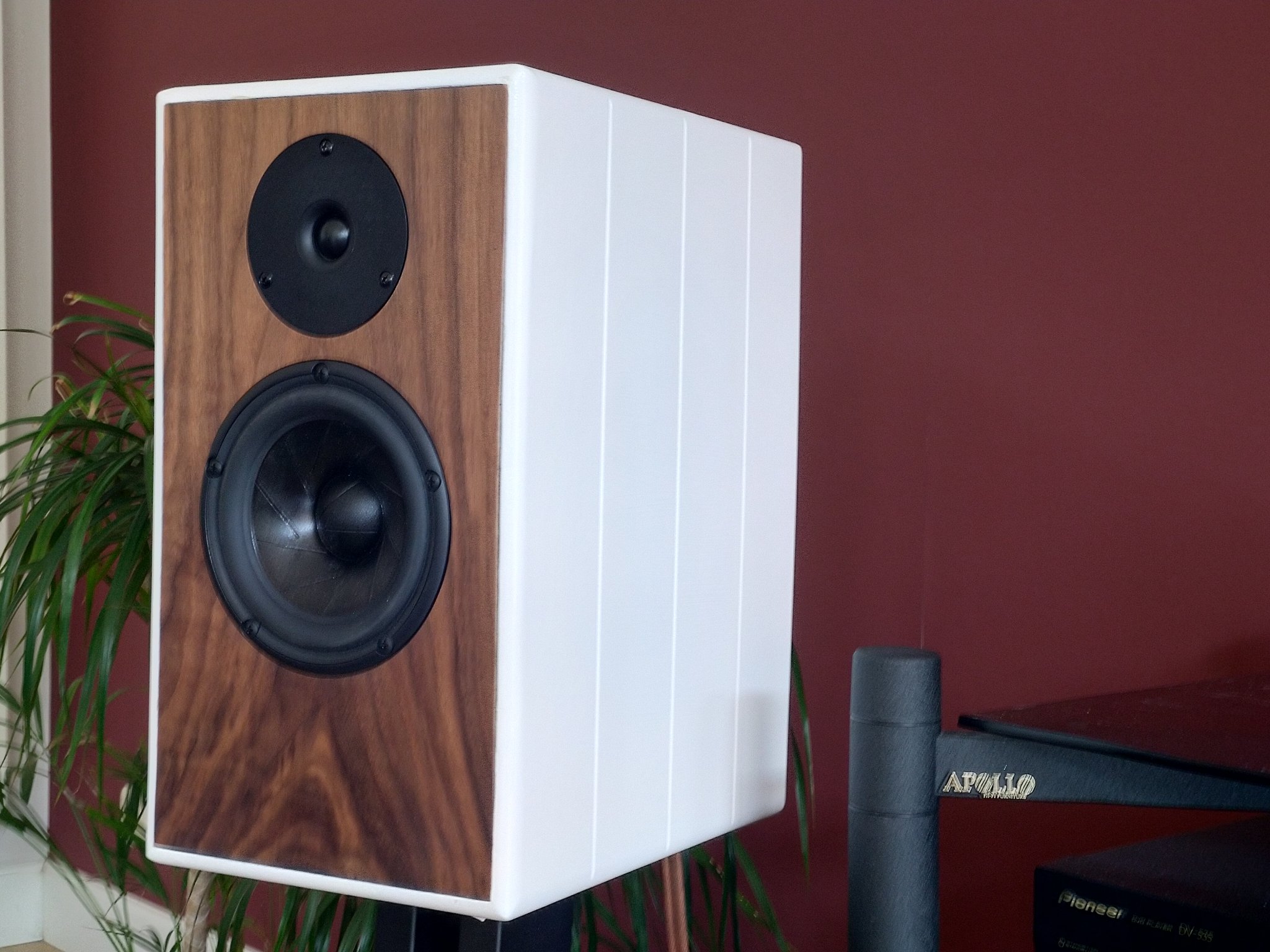

This was my first build. Never did any woodwork before. Build it in the bathroom with minimum tools. Bought a router in the end to make the driver cut outs. Detachable front and back. White sides, top and bottom is more narrow on the front then on the back. Which gave it a nicer look.
I hope that making the baffle tilted would be good for time alignment. There is a 3D printed waveguide for this tweeter. But Im not sure if it would add more complexity for me. It could make the woodwork simpler. then I can go for a straight design iso slanted one. 🤔
Looks like a nice build! I doubt you will be able to make the PMS in the bathroom though.. Pieces get fairly large.
Maybe you should leave it to a professional, or if you can engage a friend with some more space, like a garage? There will be a lot of cutting which equals a lot of dust, and it helps to get the pieces cut to exact dimensions with a good saw.
For the braces, I made one template by hand, and then used the router to cut the others from that template. I don't think it's harder to make the rear rounded as the front, it just takes more time. Trying some strange shapes for the rear could be just as complicated and time consuming. If you make some mistakes, you can use those pieces for the rear. I would actually make two mirrored pieces, front and rear, like split in half. Than you can have full access to the inside of both panels after they are glued to shape, and put the bitumen etc, and then glue the halves together when everything is perfect.
I used some 'synthetic leather' (can't remember the word in English) to cover the rear, looks nice and saved me a lot of time. Front is only covered with self adhesive plastic that looks like wood. Looks ok, as long as the surface is smooth, and it's easy to change the appearance of the speaker by replacing it. Make sure to have a painted surface though, or it will probably destroy the MDF surface when you tare it off.

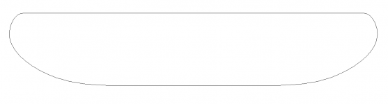

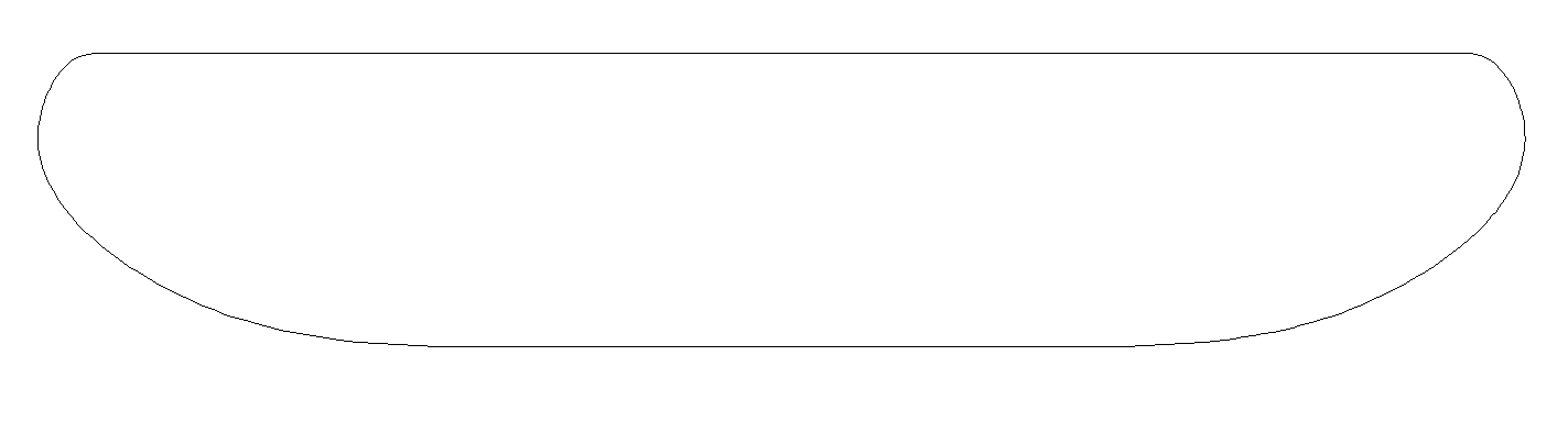

Does it have to stay round? I was thinking to put an aluminium profile on the sides.You could try to maximise the tractrix edge..
Backside shape is irrelevant considering radiation. at least vertical edges should have some rounding, but evevn that is not so critical in a wide baffle. Curved front panel looks damn good in my eyes. I have been dreaming about Stradivari copies, but I don't have big enough room for them.

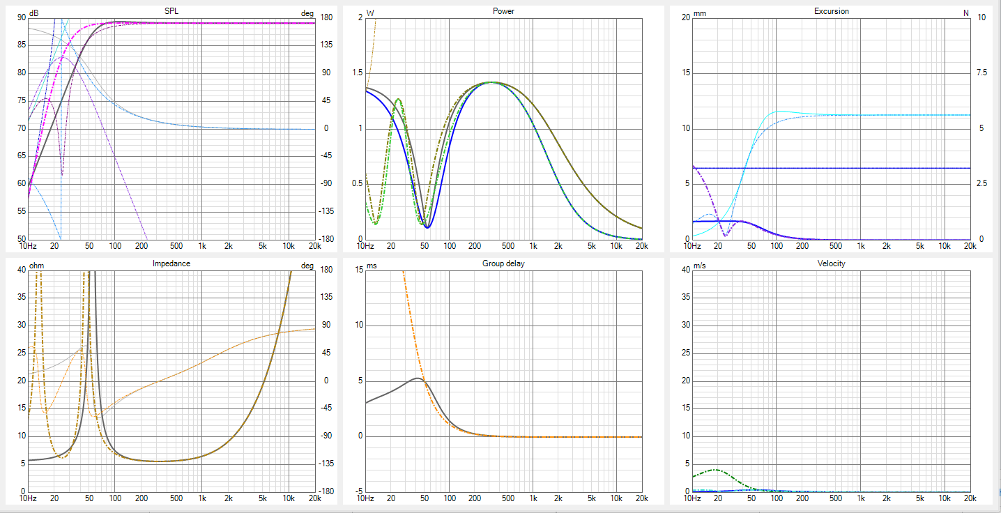

Maybe it is the scale that makes it look so different to expected, attached is an overlay of closed and vented in Vituix.There isnt so much difference between VituixCAD and WinISD.
Box 25L and tuned to 25Hz also gives a port of 67cm when diameter is 68mm.
With 47mm it will be 30cm. Air velocity is still controlled.
f3 goes from 49Hz closed to 43Hz BR. Is it worth it?

Irrelevant is not a good word, the whole shape of a speaker cabinet has an effect on the radiation pattern. It takes a considerable number of measurements or 3D simulation to show it though.Backside shape is irrelevant considering radiation. at least vertical edges should have some rounding, but evevn that is not so critical in a wide baffle.
I really like this shape. Is there an example how to make the woodwork?You could try to maximise the tractrix edge..
I was thinking to make slits in the MDF panel and then bend it. Guess needs some slits close together when approaching the ends. 🤔 some example where I can learn from would be very helpfull.

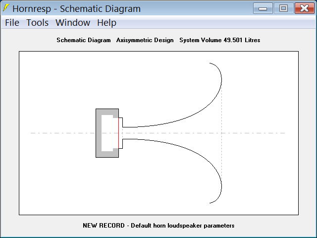

Hornresp (sticky thread in subwoofers) can make the curve and can give you data for woodworking.
The method is called kerfing..
