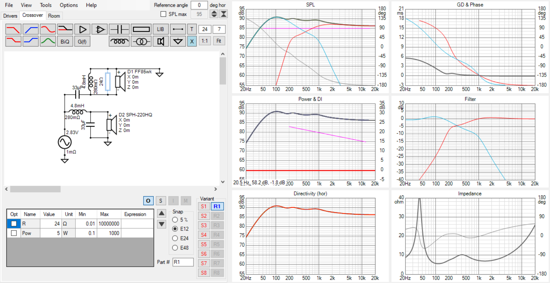

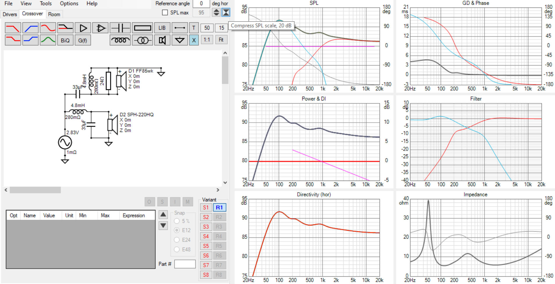

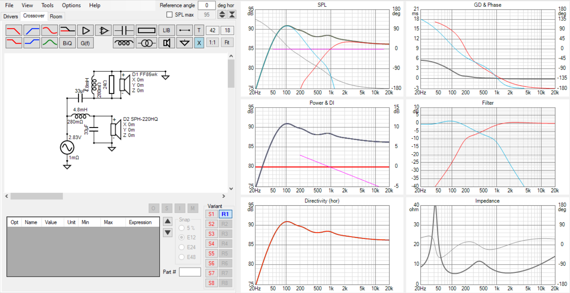

Stal, I'm not sure I properly integrated the values you gave me, because the response looked weird when I tried.
Attached are my tries at :
  1. 1st order on both drivers : I think response is good, but afraid it's not safe enough for the 85
  2. 1st order on woofer, 2nd ordrer on full range
  3. 2nd order on both : I like that phases seem to match all along, and that impedance has no more peaks
Dou you have any recommendation as to which solution would be "best", and whether it would need further tweaking ?

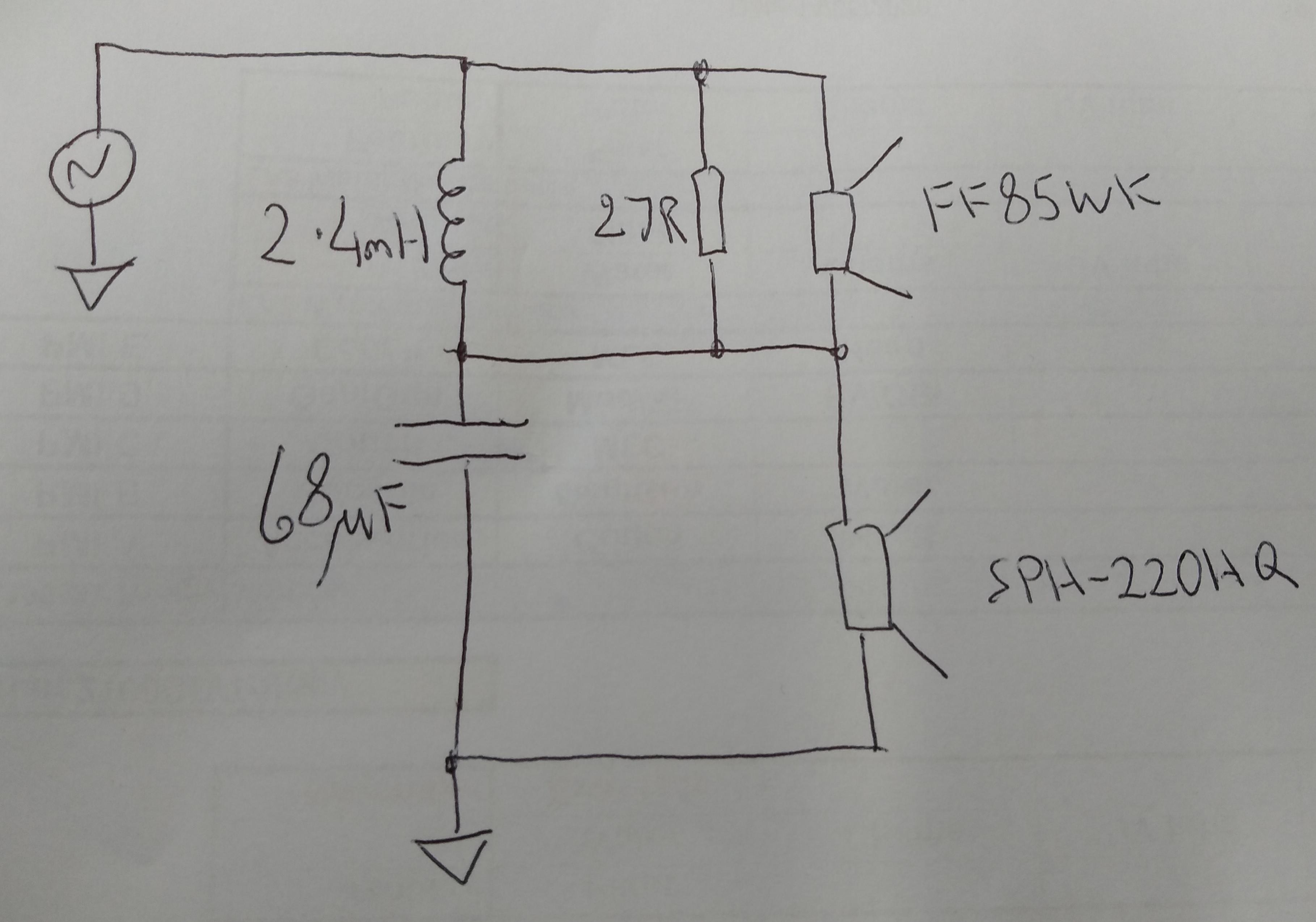

Here's one I drew earlier. The parallel 27R is just to make the FF85WK to look like 6 ohms so that both drive units are 6 ohms at the xover freq. This helps choose our filter values easier using conventional calculators.

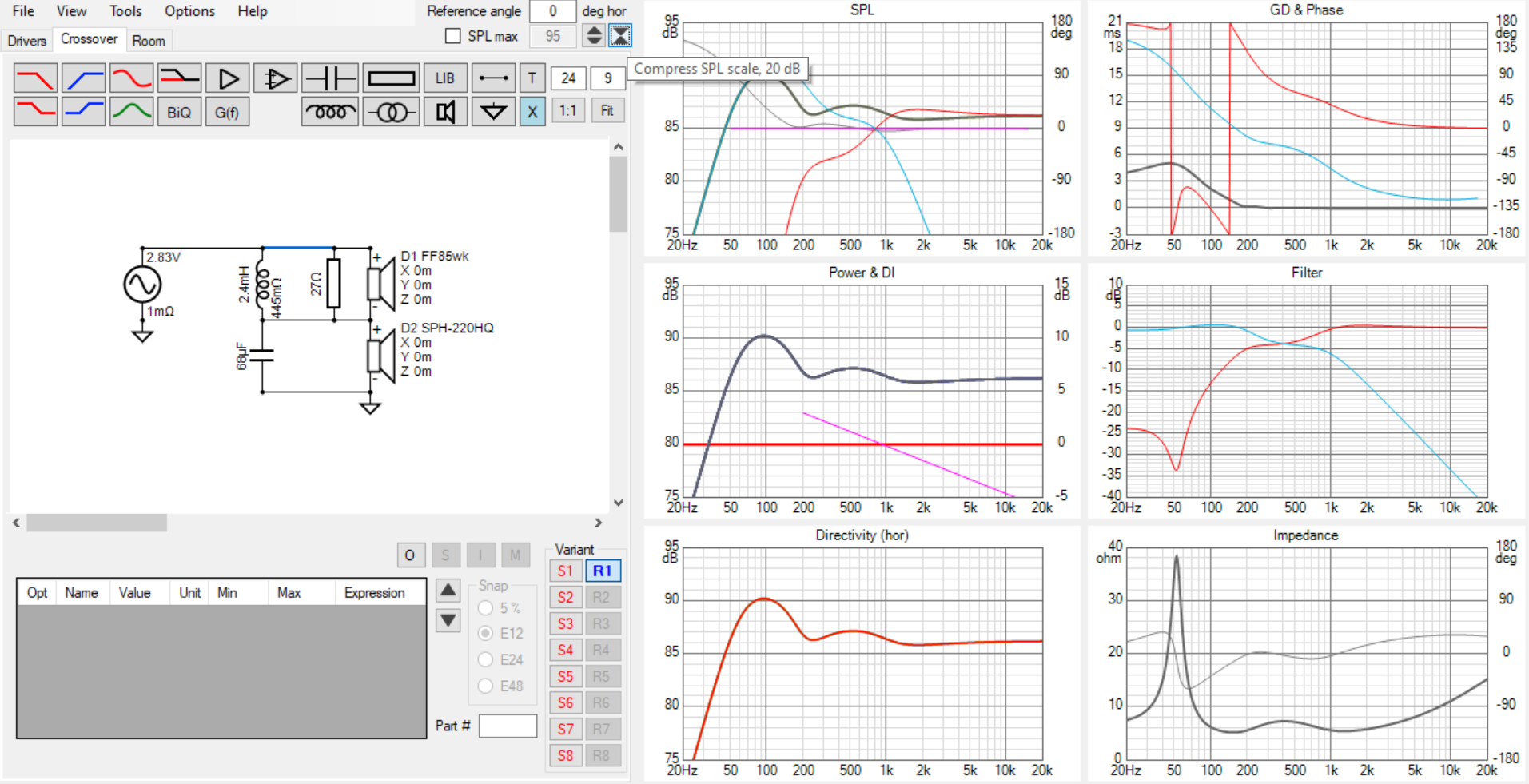

I have tried both options as recommended in pictures attached. I thought the XO freq could be anywhere between 400-600Hz ?

@Stanislav : as much as I agree with you, I don't have any components at hand, so I have to resort to sim to know what to order, and given the cost of components I'd rather adjust as much as I can beforehand. I think in the pictures I posted, first is parallel 2nd order, and second is series 1st order ?

Also I'm not convinced that the shunting of the 115Hz Fs is quite enough. At 115Hz the XL of a 2.4mH inductor for example is 1.7 ohms add the series R and you have nearly 2 ohms. You won't get the exact 6dB roll off in this region although admittedly it may not be an issue from freq response point of view but maybe from a xmax point of view.

Here is the 2nd order on both drivers, with 0.577 boxes.
I don't wish to go that way because it makes the enclosures too big, I have to keep them about (ideally) 30~32 total inner volumes, then add stuffing.
