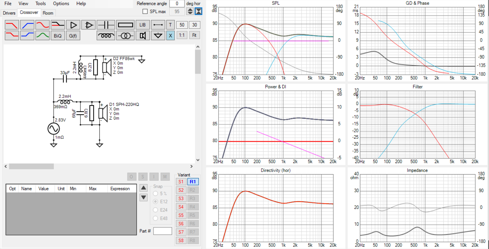

So do you think the crossover above would work OK ? I have 2 concerns :
- the impedance peak (I don't know whether it matters or not)
- 1st order on the 85 may not be steep enough to avoid excursion limitation at fs
I think that if you have set your heart on the SPH220HQ and the FF85WK then go ahead and start that project, it can surely be made to work.
The crossover can be developed and changed to suit.
I wouldn't rule out a 2nd order Xover. It would allow a fairly low Xover point without worrying about the 115Hz resonance.
It would probably also negate the need for a Zobel on the woofer.
It may end up at just 5 or 6 components. 4 for the filter and 1 or 2 resistors for attenuation of the FR.
Try 4.8 mH and 33uF for the woofer assuming 6 ohms at 400Hz xover.
Try the same for the FR but put a 24 ohm R in parallel with the FR to bring its Z down from 8 ohms to 6 ohms also.
Using the 8 ohms of the FR will give larger values for the inductor which are usually more expensive.
Don't forget to reverse the polarity connection of one of the drive units relative to the other - this is usually necessary with 12dB filters.

Stal, I'm not sure I properly integrated the values you gave me, because the response looked weird when I tried.
Attached are my tries at :
- 1st order on both drivers : I think response is good, but afraid it's not safe enough for the 85
- 1st order on woofer, 2nd ordrer on full range
- 2nd order on both : I like that phases seem to match all along, and that impedance has no more peaks
