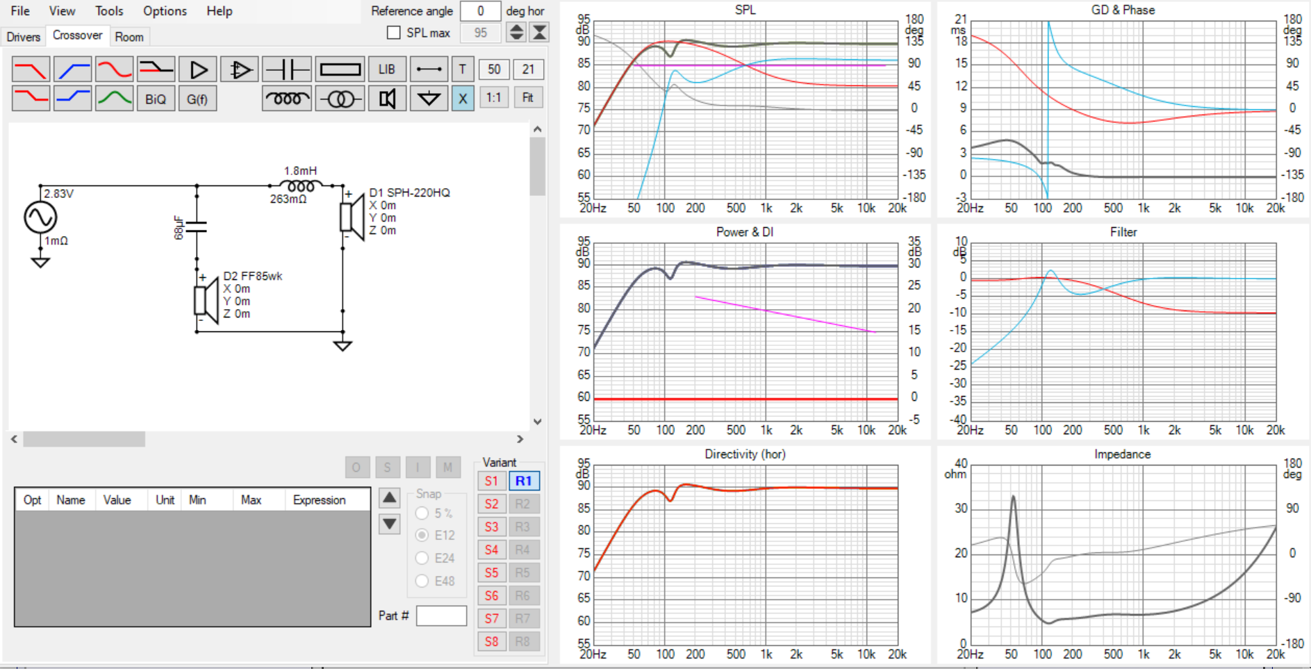

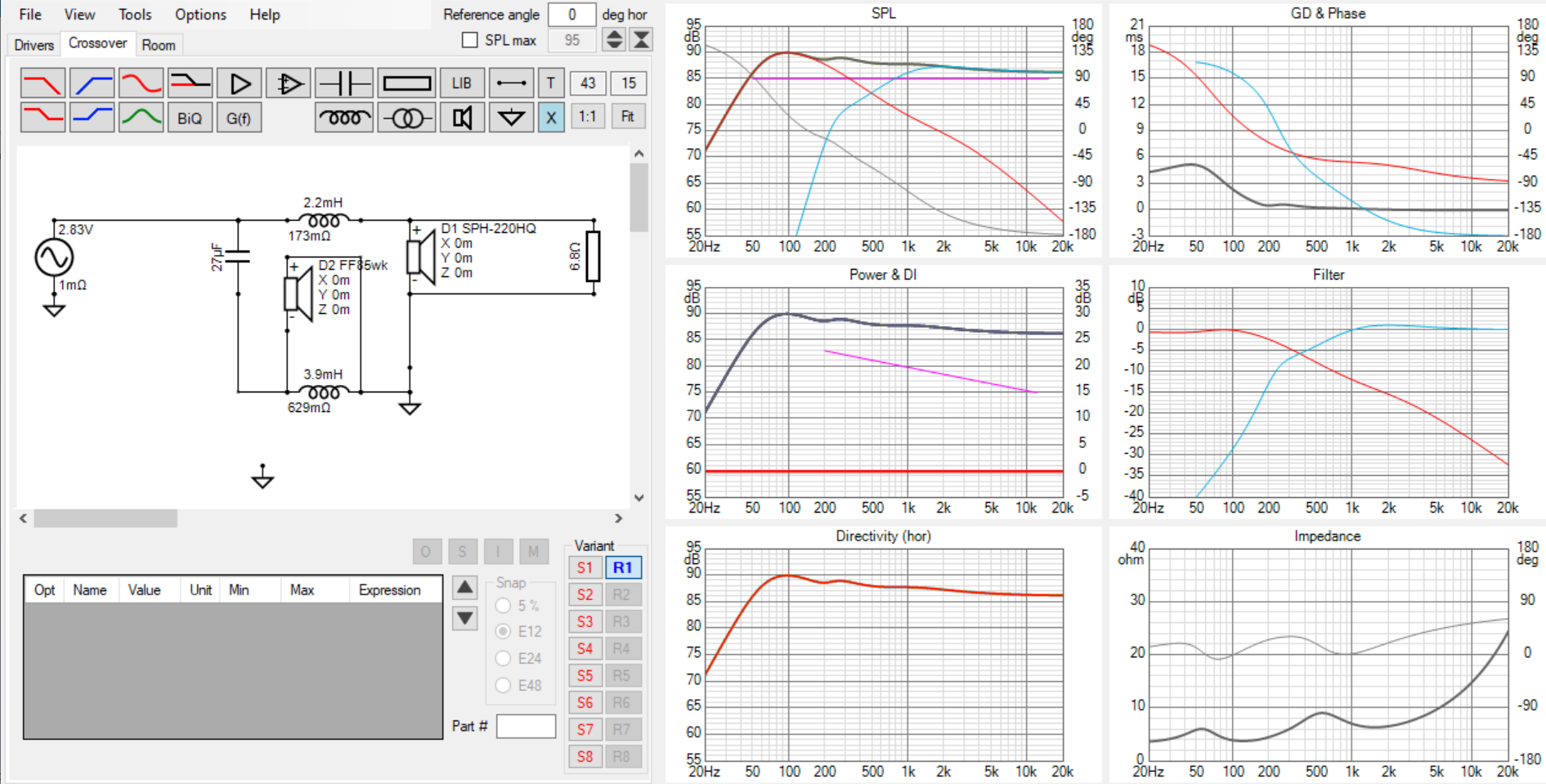

Stal, I'm not sure I properly integrated the values you gave me, because the response looked weird when I tried.
Attached are my tries at :
Dou you have any recommendation as to which solution would be "best", and whether it would need further tweaking ?
- 1st order on both drivers : I think response is good, but afraid it's not safe enough for the 85
- 1st order on woofer, 2nd ordrer on full range
- 2nd order on both : I like that phases seem to match all along, and that impedance has no more peaks

I agree a 1st order series is worth exploring, I currently have it on my set up.
I tried modelling it at home with these drive units using the same software that elmans is using but it didn't look quite right.
I think an issue with the FF85WK is its quite high Fs and an xover target of around 400Hz as you mention.
I think 2nd order will show what is possible by taking away the issue with the 115Hz Fs and a xover point of 400Hz. We could then re-explore 1st order either series or parallel.
Here's one I drew earlier. The parallel 27R is just to make the FF85WK to look like 6 ohms so that both drive units are 6 ohms at the xover freq. This helps choose our filter values easier using conventional calculators.

I have tried both options as recommended in pictures attached. I thought the XO freq could be anywhere between 400-600Hz ?

Just as a quick check, take away the parallel R and see what happens.

I mostly agree about 1st order series xovers and can clearly see the merits.
This is the first time I have been using a simulator in order to help elmans along.
elmans has not bought all his drive units yet never mind built the boxes, so we are at quite the preliminary/feasibility stage. I think it helps to see what the merits of various solutions are.
2nd order parallel also has an inductor to shunt the FR at low frequencies and a capacitor to shunt the woofer at higher frequencies.
The issue with the FF85WK is that it is a small drive unit with a low xmax and a 1st order with a low xover point may still be a bit much for it at higher volumes.
Also I'm not convinced that the shunting of the 115Hz Fs is quite enough. At 115Hz the XL of a 2.4mH inductor for example is 1.7 ohms add the series R and you have nearly 2 ohms. You won't get the exact 6dB roll off in this region although admittedly it may not be an issue from freq response point of view but maybe from a xmax point of view.
I did in the picture attached
Edit : attached the modified series 1st order
Sorry I meant on the series 1st order version.
