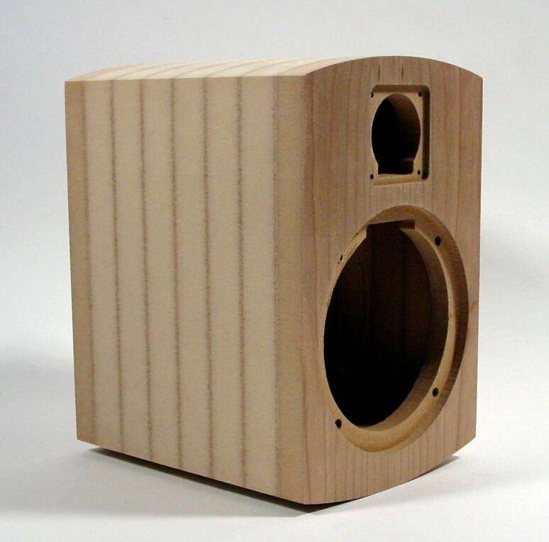

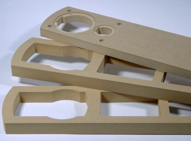

I do have a question Jeff. On the cabinets, with curved tops and bottoms, were they kerfed, or were they made from multiple sectioned cuts of MDF, then layered/glued together to form a solid curved frame? Just curious.

The mtm is made from layered MDF, while the MTM 7 is made like a traditional box from 1" MDF, then it is sanded to shape. Both processes are more costly and time consuming than traditional rectangular boxes. You can see examples of this on the products page of www.occamaudio.com where we sell the boxes unfinished.
