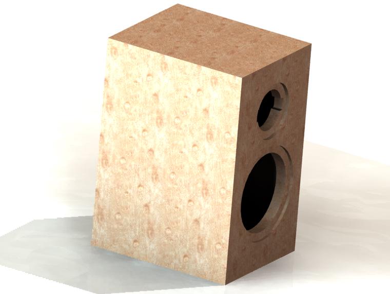

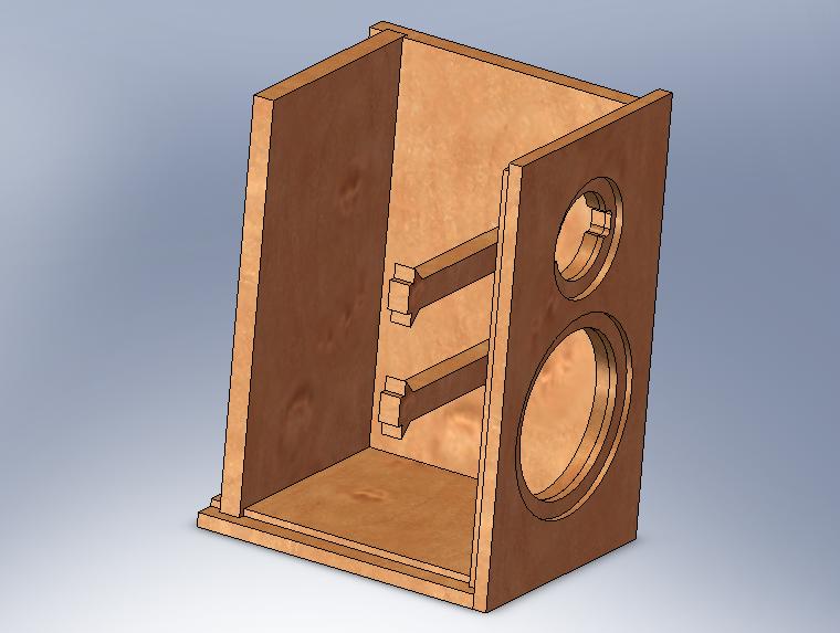

If I were you, I'd make the cabinet a little deeper for the internal volume to be 16-18 liters. By using a port tube of the same length, you can obtain at least 5 Hz deeper bass extension.
As Zaph noted in the design page, his port tuning was limited by the cabinet depth and volume because he chose to use a premade cabinet. Since you build it yourself, you can use an ideal box volume for the woofer.

I hadn't realized the cabinet was undersized. Can I get the same effect going for a taller rather than deeper cabinet?
A little taller baffle should be okay. If you want to go this route, extend the bottom edge instead of the top edge. The tweeter's diffraction pattern will be more affected by a change of top edge.

I got the SR71 kit today. Looks great. I think I'll go for the 17L cabinet as suggested. I figure I can added solid volume to the cabinet if I want to try the 14L volume as well. To get the extra volume I increased the height by 2". There is now space on the back panel to mount the crossover between the port and the terminal cup, where it is easier to work at. Hopefully I can get the boxes built this weekend and post some pics. Before I start any building I gotta rig up a better dust collection system for the router. That MDF dust is nasty. Its so light it ends up all over the basement.
