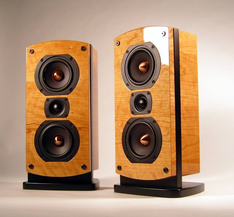

Well, I designed the cabinets in solidworks tonight. It should all go together well. The only thing I haven't found is the size of the hole I need to cut for the port and the terminal cup in the SR71 kit. Does anyone have this information handy?

Oh Boy!, I really Love this design on that page. makes me want to hurry up and finish my hexagons and do something like that too. I love Cherry BTY.
Stop it! Slaps Face and Wakes Up To Reality! I need to set priorities here.
That's a nice elegant design. Simple but interesting, less is definitely more here. I bet it sounds that way too.
Re: Hi!
Not at all.
I see three components - the baffle, the stand/leg and the rear chamber.
One way to tackle this would be:
The rear chamber could easily be made through lamination of about 5 layers of 25mm MDF. At this stage you could also apply irregular internal surfaces and bracing integrated into the lamination layers. Once done finish this up as you would normally ie. veneer or paint.
The stand and leg sits between the baffle and rear chamber. Its just two pieces of MDF joined with leg having a suitable cut out to allow the drivers on the baffle to see the rear chamber. Finish this part as you normally would.
The baffle is easier still, just do the driver cuts and add the shape to the top and bottom edges. Once again finish as normal.
With all three finished parts in hand they simply need to be combined. You could glue together or better yet hide some long screws behind the grill mounts. These screws would pass through the baffle and leg then into the rear chamber. Between all layers I'd use sealing strip and a very very small amount of glue(so as not to squeeze it out of the joint onto the finish) to ensure integrity.
Time consuming but simple and doable.

I agree, this is very doable. It is small potatos to the hexagon speaker project.
The one thing I would do differently from Shin is that instead of laminating 5 layers together, I would 'kerf' cut the material, and bend the wall around to fit the shape. I would also mix up some Bondo, and fill in the kerf cuts and when the wall is shaped, the excess could be wiped away. That way you have a very solid wall. In fact the Bondo is more dense than the plywood or MDF.
If you have a table saw, your job is much easier. However, a circular saw can make your cuts well also. You must need a straight edge to use as a fence. And a router too.
