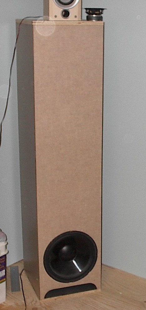

See attached pic of TL sub made from used toilet partition stock - 1" thick particle board with Arborite on both sides. 😀

Neat looking boxes. You removed the Arborite from the joint areas, or did you get them glued somehow? Why is the woofer so far away from the other drivers? I haven't designed or built anything for a number of years, so please excuse my curiosity. I'm not criticizing at all.
The last ones I built were a double tuned box design from Douglas Weems. To kill resonance modes, I located the woofer 1/3 the way down the internal box and the ports 1/3 up from the internal box bottoms. (an internal port connected the two internal box volumes) I still have the prototypes in my bedroom. A 2 way 8" set with 1" soft domes. They sound okay but the real ones were designed for Peerless drivers. Those sound pretty good.
