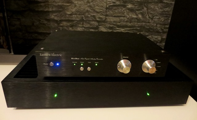

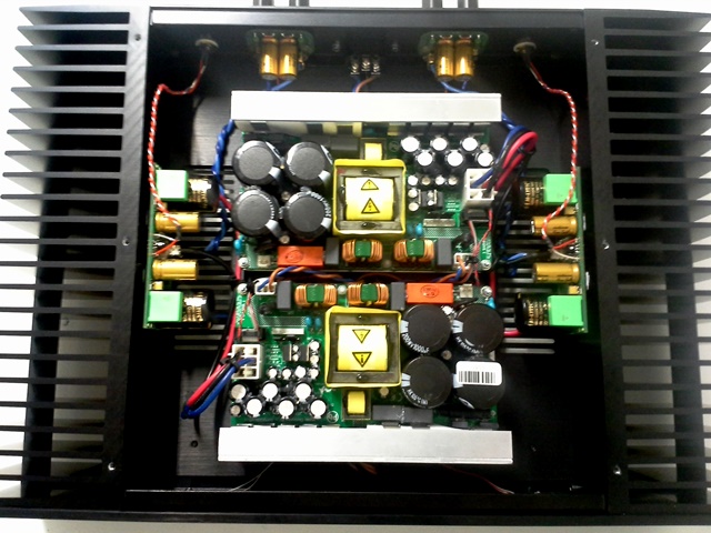

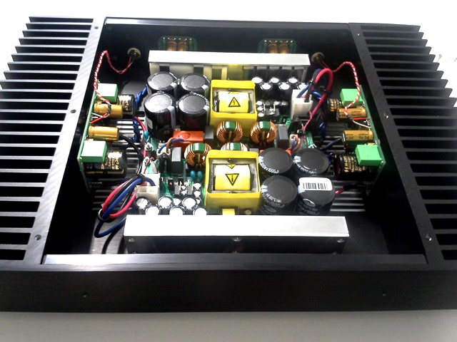

Althought i have some problems with Hypex smps i am happy that amp is working now.
Both SMPS were defect. First was semi dead after few startups...but only negative rail made problems. After connecting speakers starting to goes on and off constantly. This one was replaced by Hxpex waranty another one start to shut off after 20-30 startups. This was also shipped to Hypex and was repaired. Now both are working fine.
I am satisfied with Hypex waranty and support.
Both smps are not +/-63 V but SMPS1200A180 +/-46V.
I assembled this amp for my friend so that was his wish.
It is connected to heavy moded Minimax dac. About sound in future days, when i will have time to listen carefully.
Excuse me for bad pictures made by phone.
