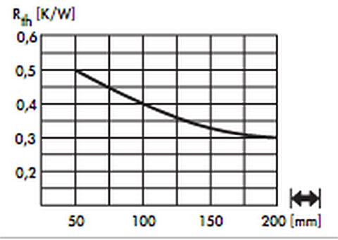

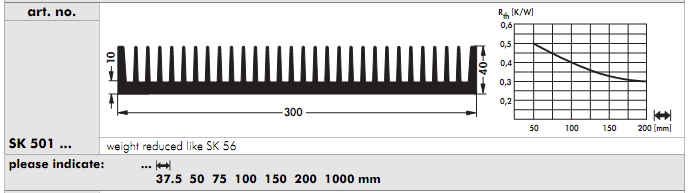

sufficient heatsink?
While shopping for case metalwork, I find a dearth of thermal specs for the heatsinks that accompany the casework. 😕
Does anyone here have a clue as to whether or not these common configurations would be sufficient for a FO module?
All are black anodized aluminum:
Radiator size: 300*70*50mm, Base plate thickness is 10mm, 28 fins
Radiator size: 300*90*50mm, Base plate thickness is 10mm, 28 fins
Radiator size: 300*115*50mm, Base plate thickness is 10mm, 28 fins

Download the catalogue from fischerelektronik: Catalogue - Fischerelektronik
Find an equivalent heatsink (or as close as possible). You will find the C/W dissipation curve as a function of heatsink size.
Heatsink guideline
Great... thanks... looks like even a 300mm L * 60mm H * 40mm D would meet spec, so any of the three should work? :Pumpkin:

Well, I don't have practical experience. I would probably just want to be on the safe side and order larger ones.
Where are you sourcing the heatsinks? I am looking at the largest size heatsink from HeatsinkUSA in 4" or 5" height. Those are shorter but the fins are longer
