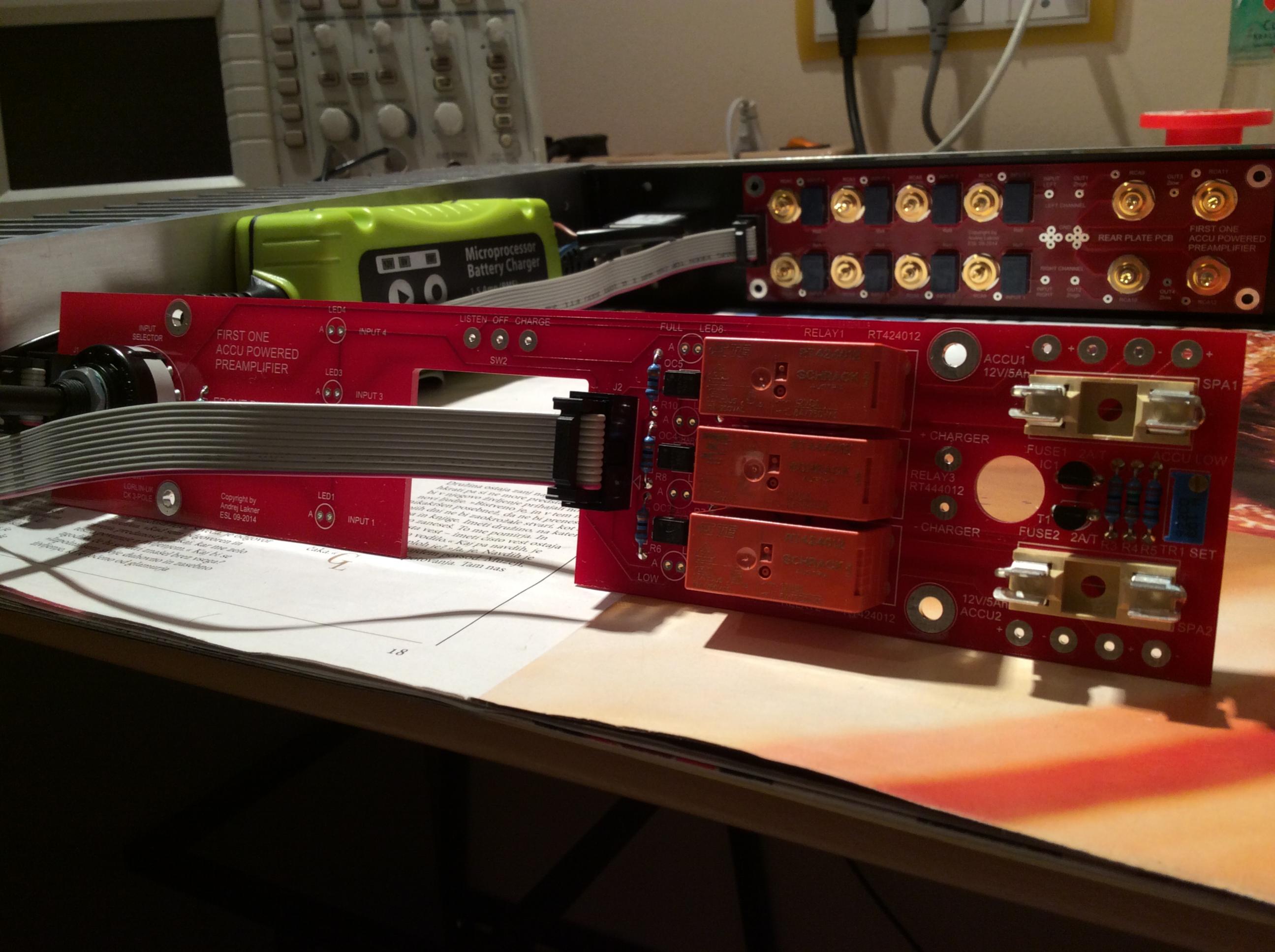

Yes, and here's the second sign of battery powered preamp.
Buffering stage with TKD ladder type attenuator still to come. Preamp Will have two outputs high Z and low Z. High Z output is passive output with of course zero gain, low Z output (few Ohms output impedance) is buffered and set to +6 dB voltage gain.
In listening position everything supplied from mains is completely disconnected, so pure battery DC to passive/buffer stage and believe me this can be heard so well.
Still more to come ... stay tuned

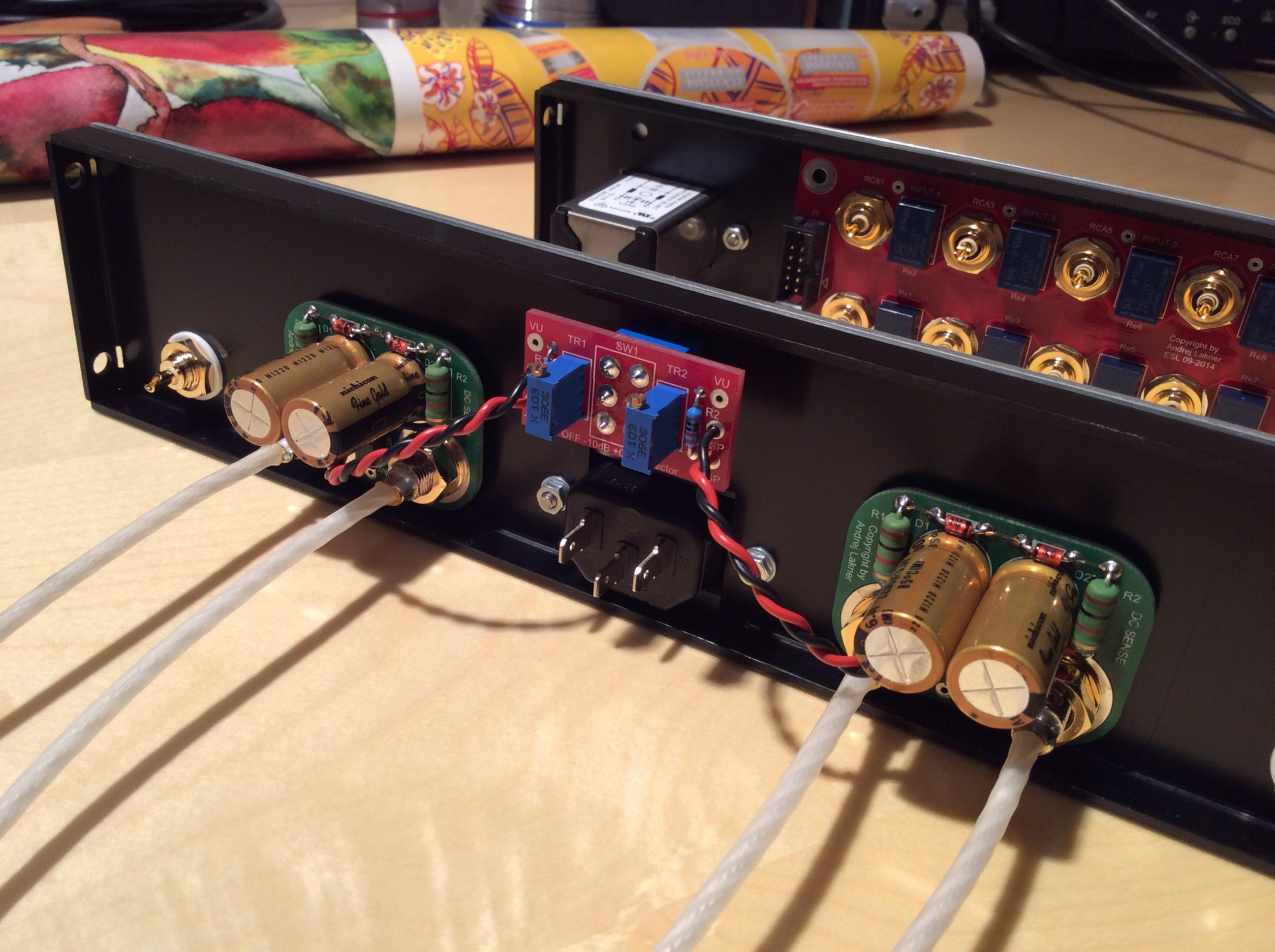

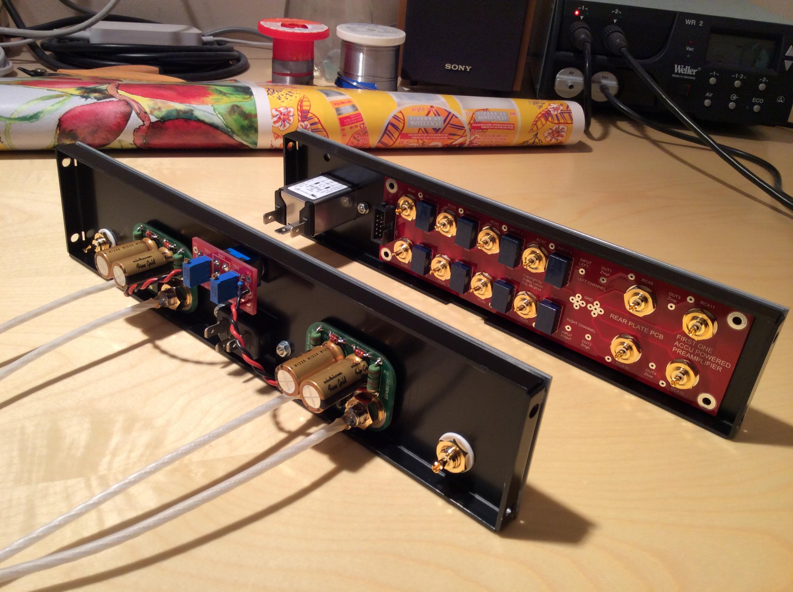

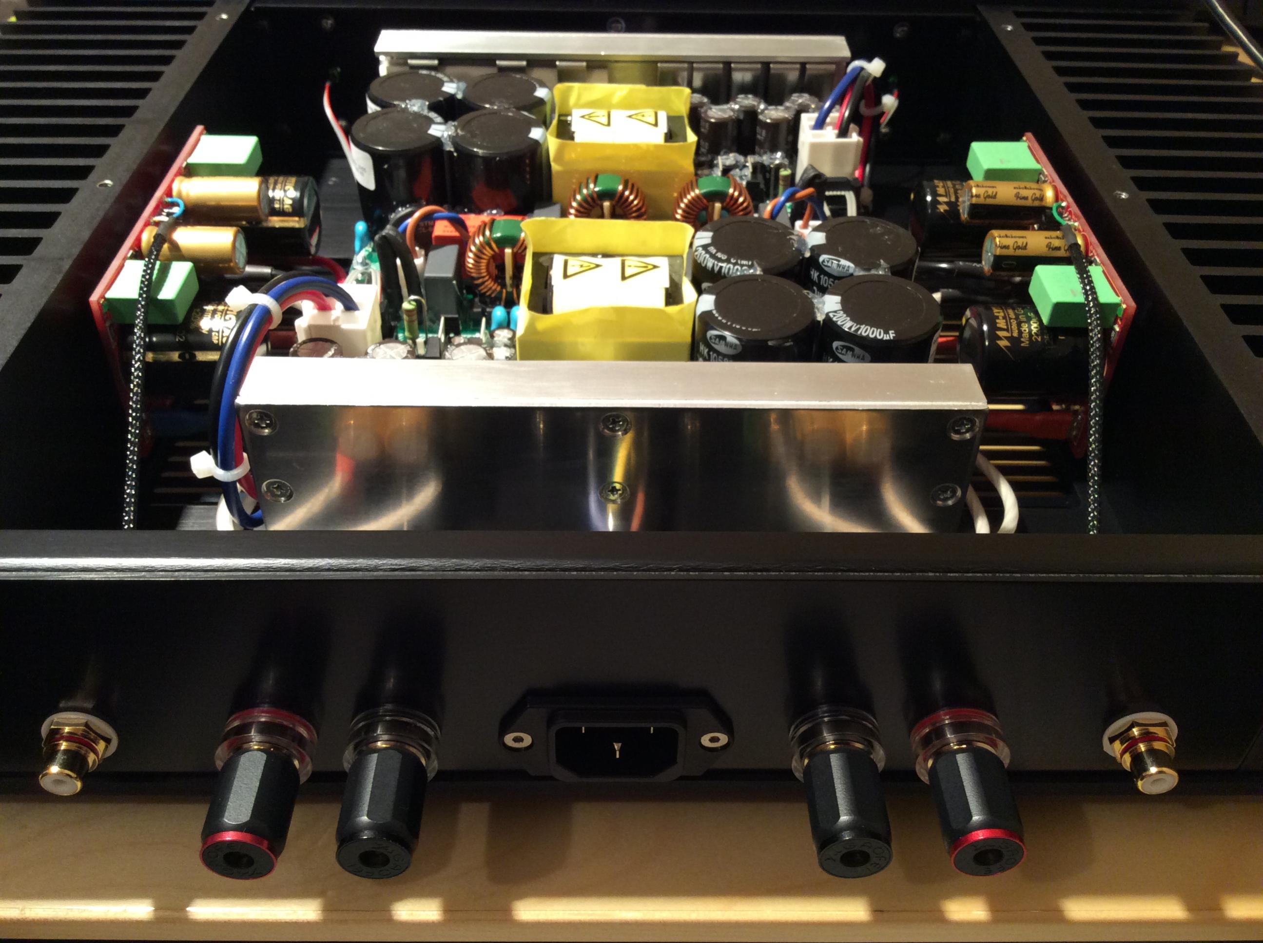

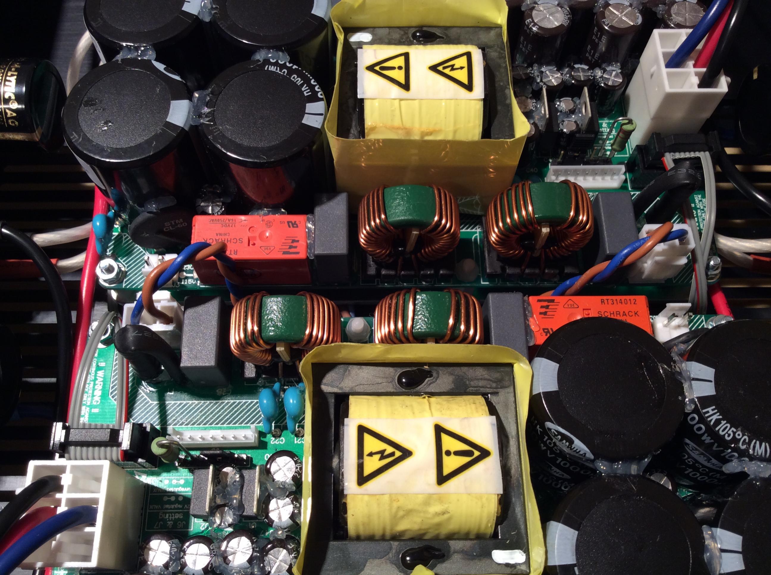

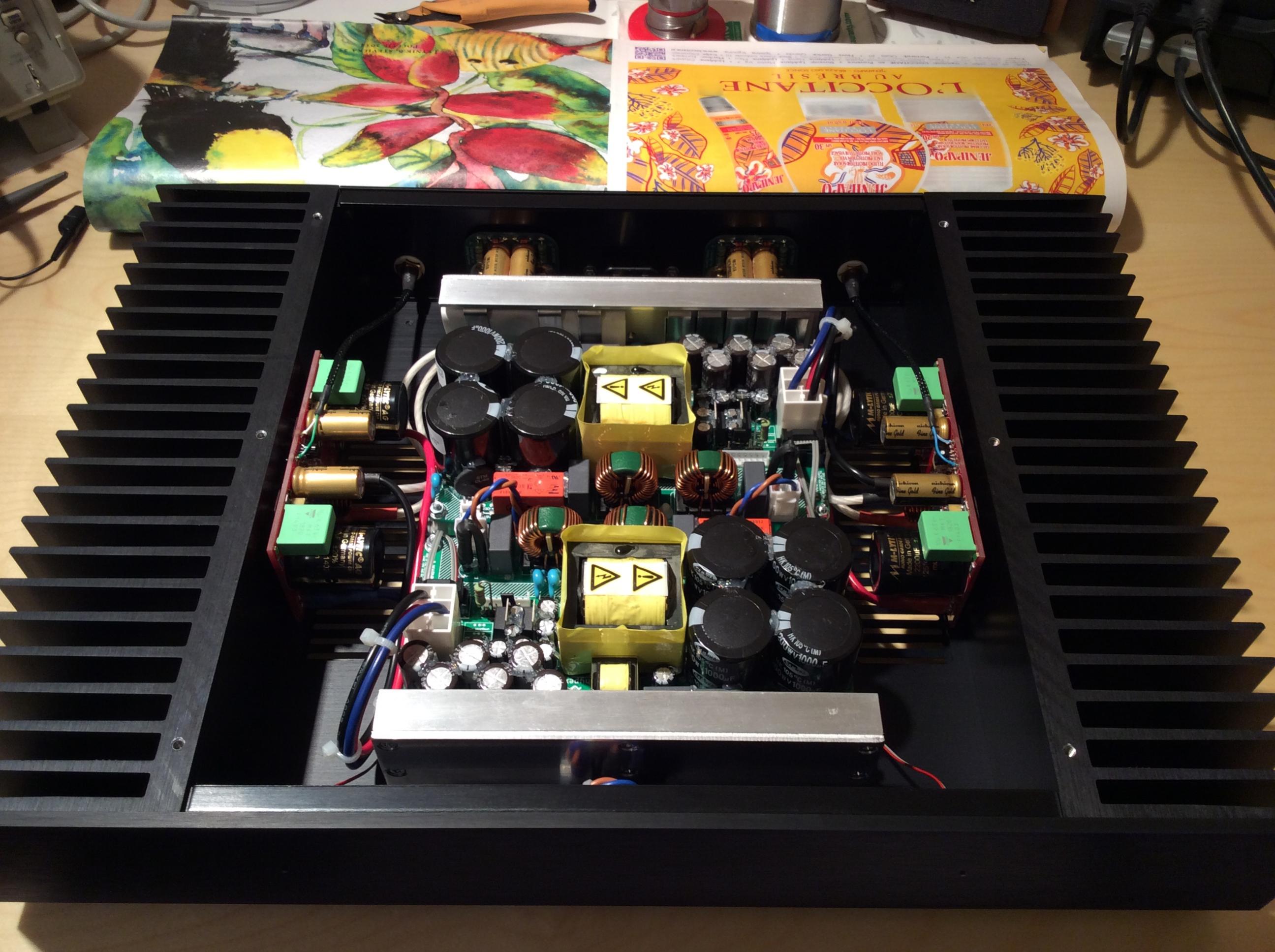

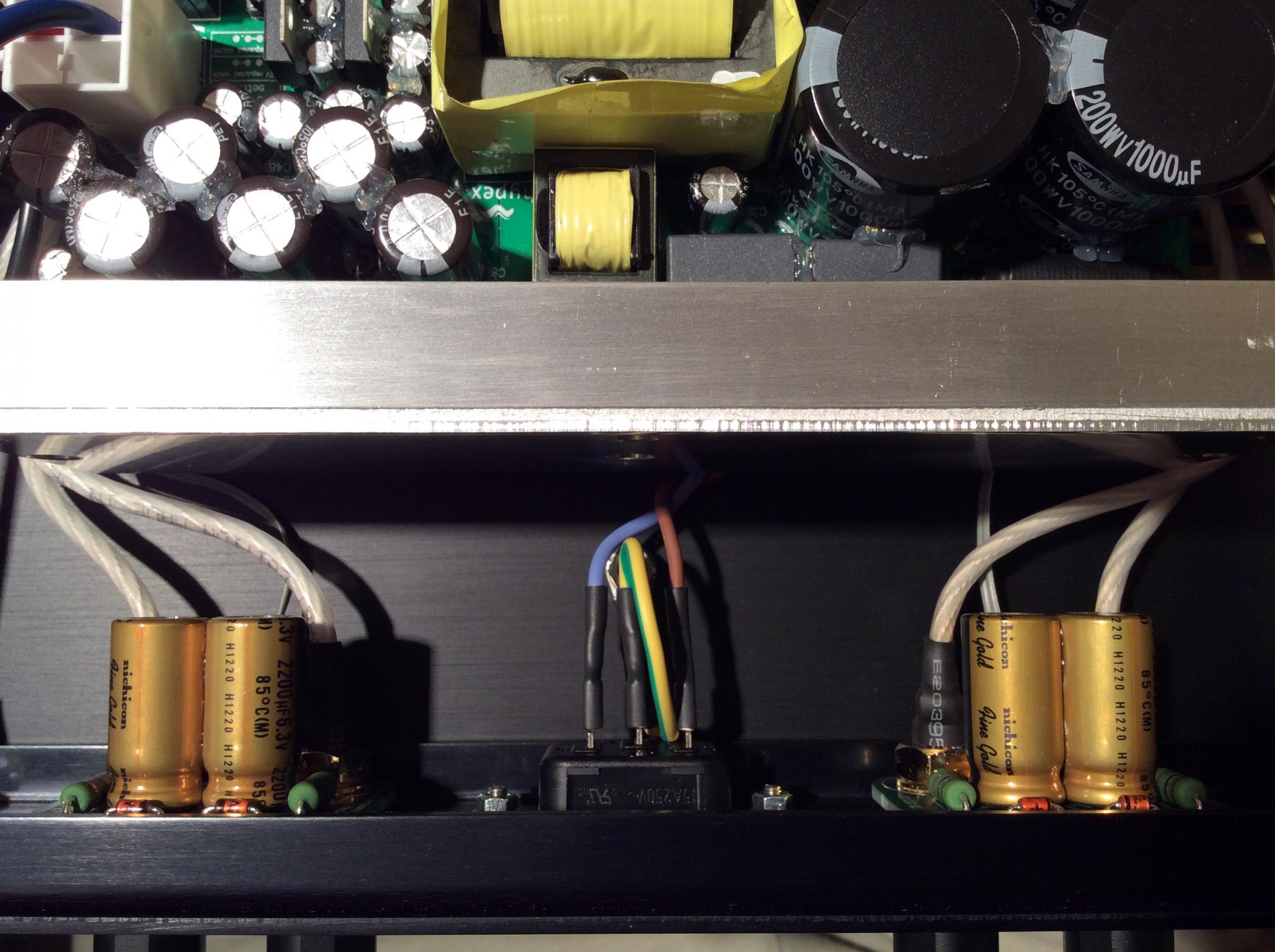

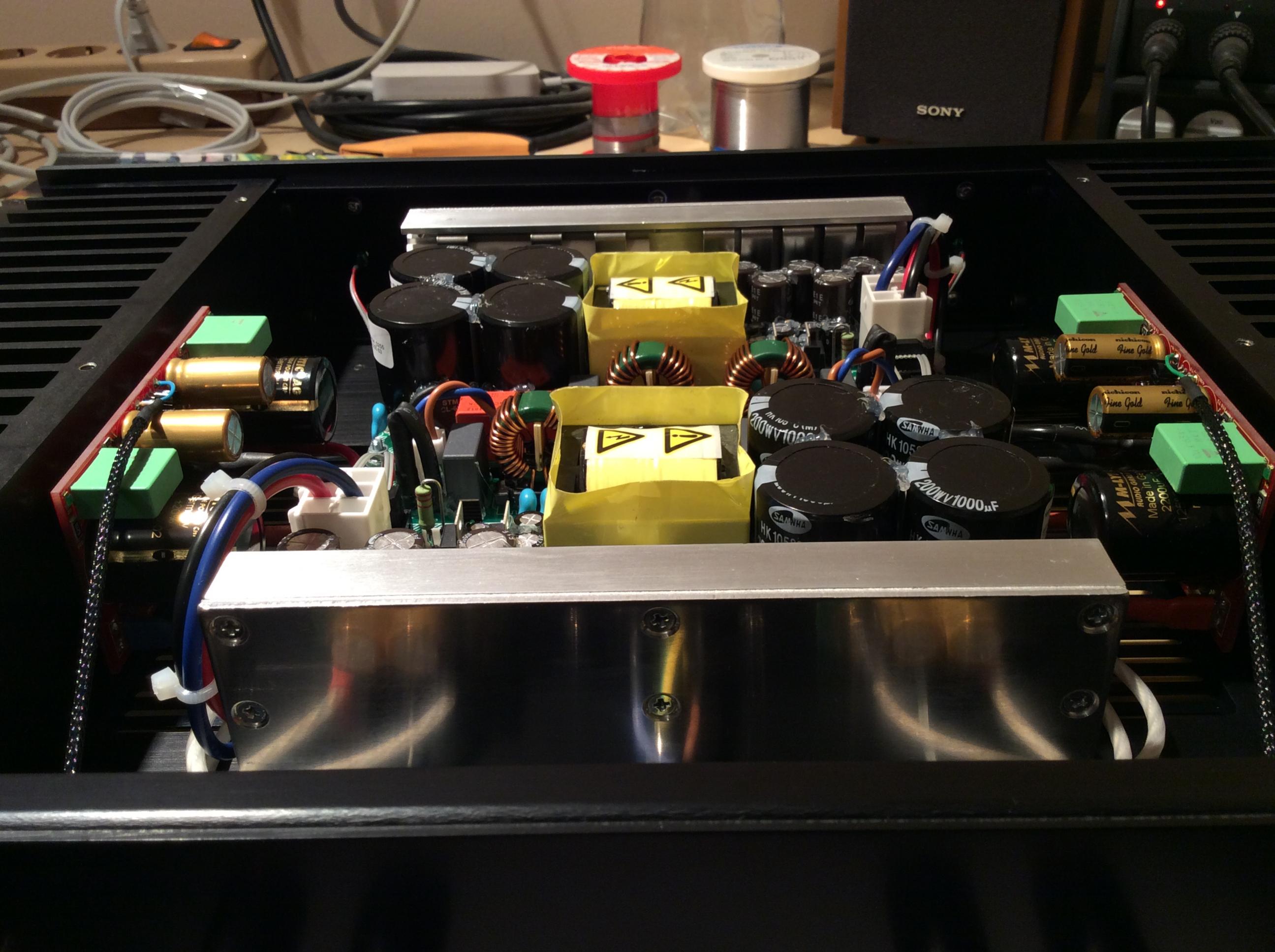

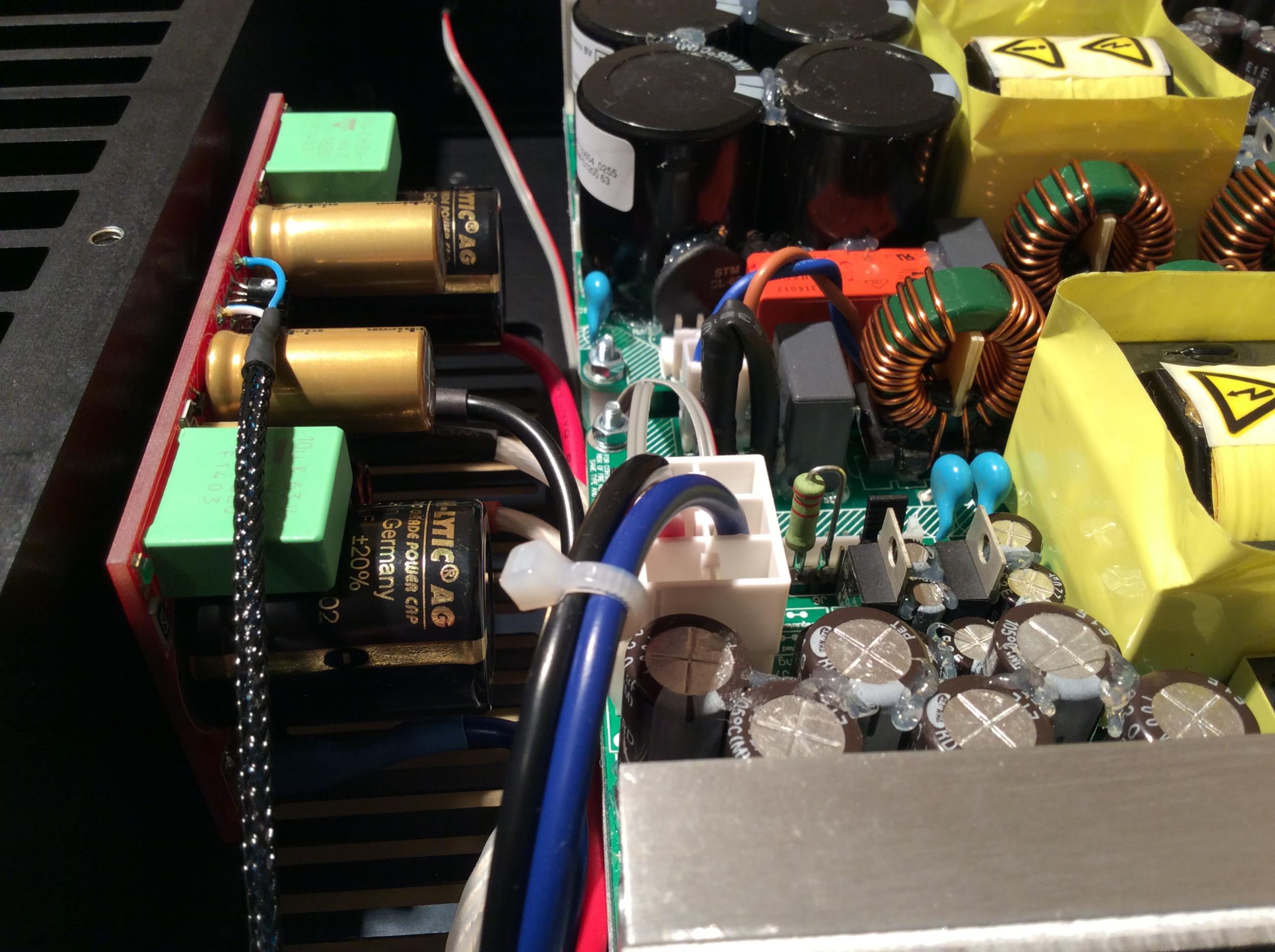

First One black chassis - Cable management
Hi all
First One v1.3 "Black Mamba" from post #1403 finished today.
In order to be very clear here's photo bulletin of proper cable management in a official First One chassis to have the least stress of EMI. Be careful of how mains cabling is routed through the chassis.
New builders can observe the detailed views and get some ideas of implementations in their own chassis assembly.
All the best, L.C.
Hi all
All the best, L.C.

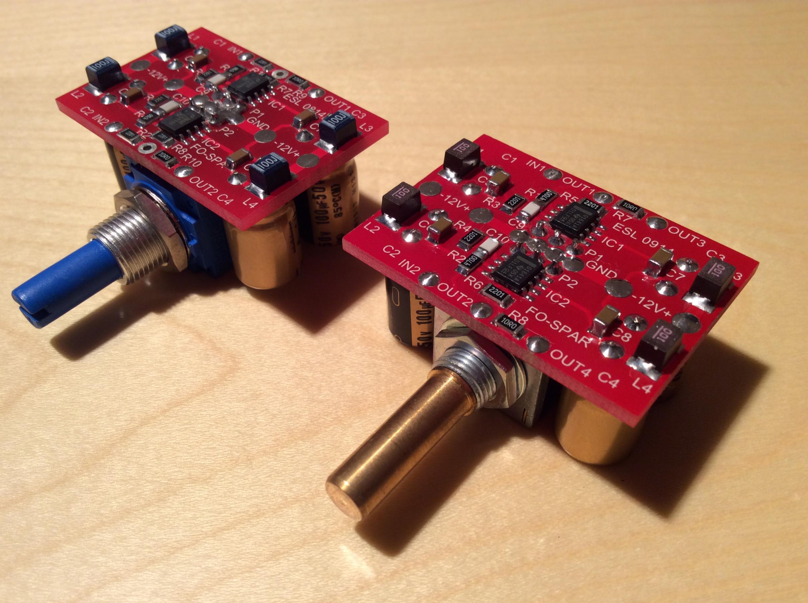

First One Buffer preamplifier & VU rms-peak meter
As promised two new modules revealed before installing into chassis.
Buffer preamplifier can be ladder attenuator or shunt attenuator type PCB.
VU rms-peak meter is linear from DC-100 kHz and shows two ranges power levels: -40 dB to -10 db and -30 dB to 0 dB
Both are suited to work with First One amplifier module, VU meter fits nicely to front plate in official C1 chassis.

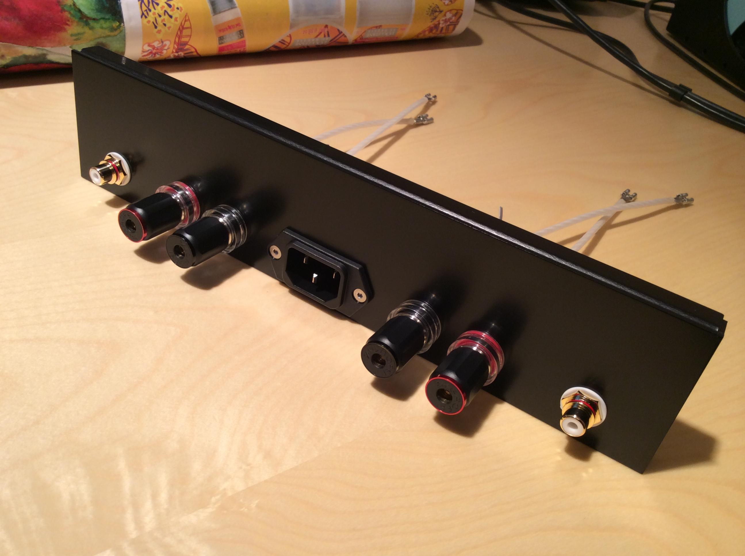

Hi LC,
I'd love to purchase those speaking terminals, the ones on the chassis. Could you tell me what brand/model they are?
Do
Do
