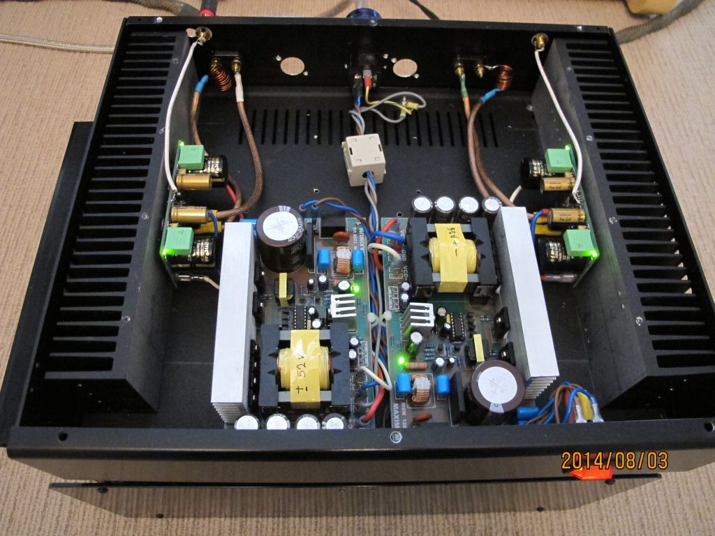

OK then, First One having 0,3 uH output inductor only, so try to put extra 0,5 uH parallel with 2,2 Ohm/2 W resistor (serial output RL filter) in series with positive output wire. Normally amps having serial output inductor ranging from 0,5 - 1,5 uH. Impedance in this case should change enough (higher with freq) to prevent any unwanted effects. 😉
Hi LC. I have soldered extra inductor of 0.6uH on positive speaker out. There is no noise when power up on its own but there is pulsating noise when connect with preamp. Do i need more inductance you think or problem elsewhere?.
Quan
Any pic of assembled amp? If you connect one channel only, is there the same issue?
Hi LC, amp power on without interconnect- no noise, with both interconnect -noise, one chanel only- no noise. Grounding issue?. Perhaps i should try ground loop breaker as you suggested.
