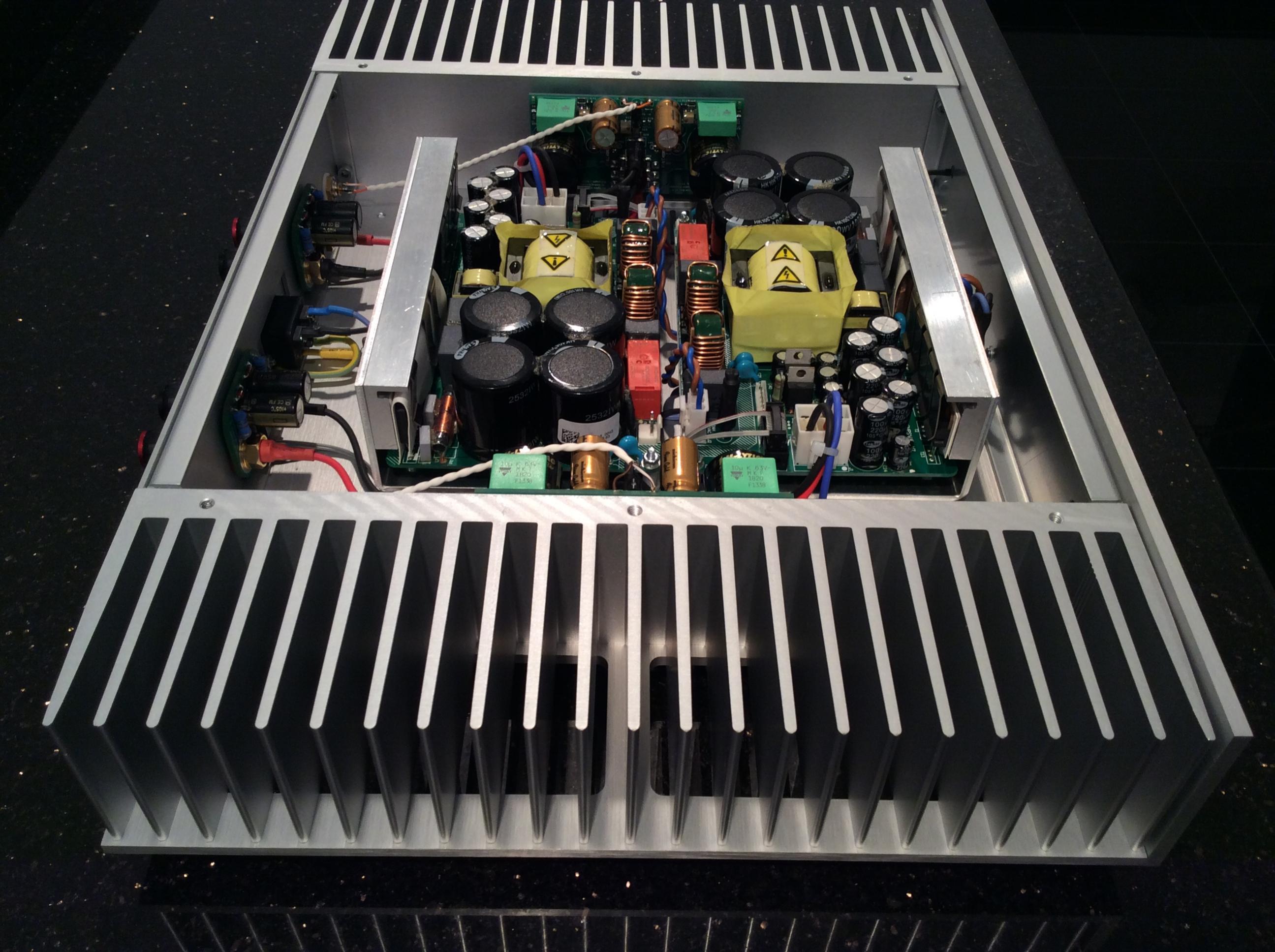

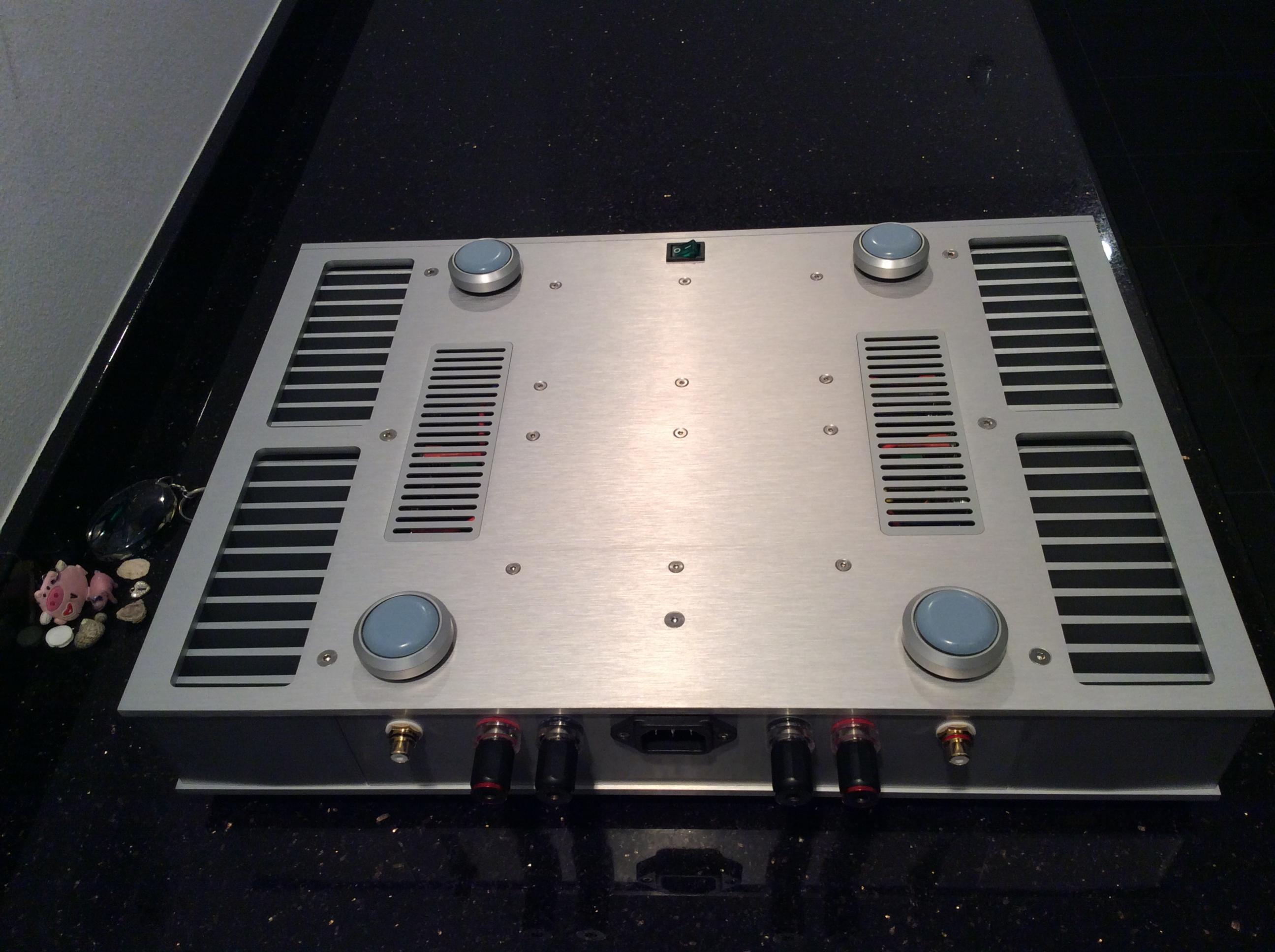

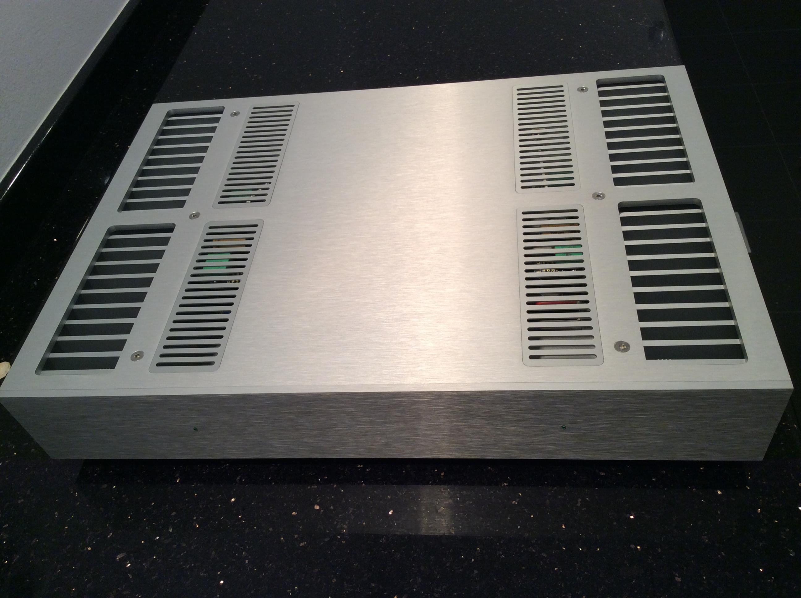

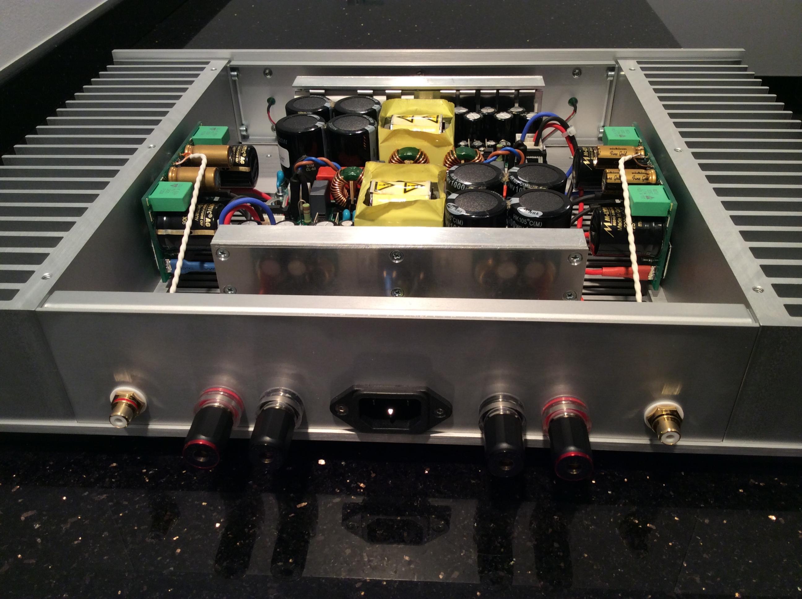

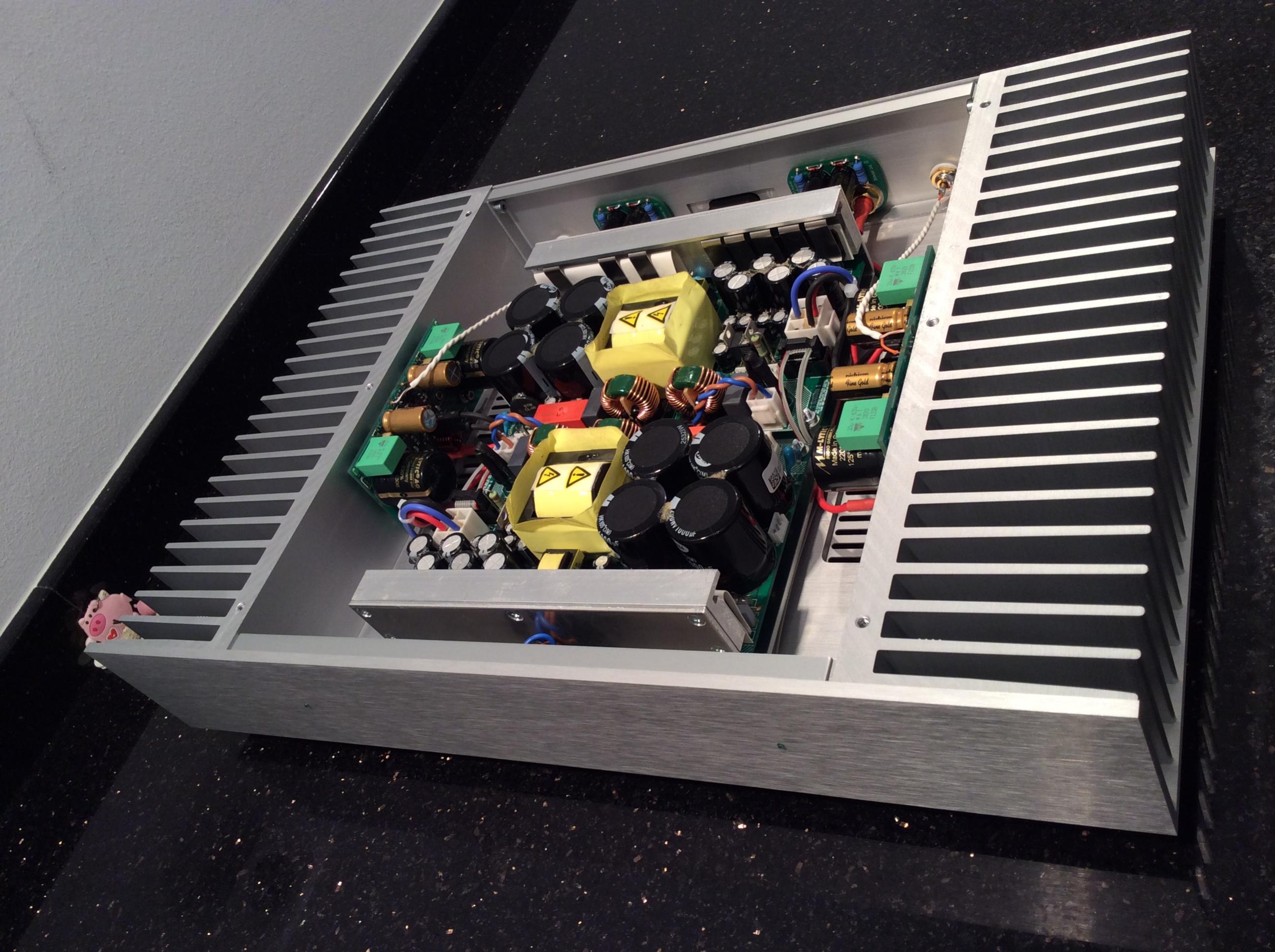

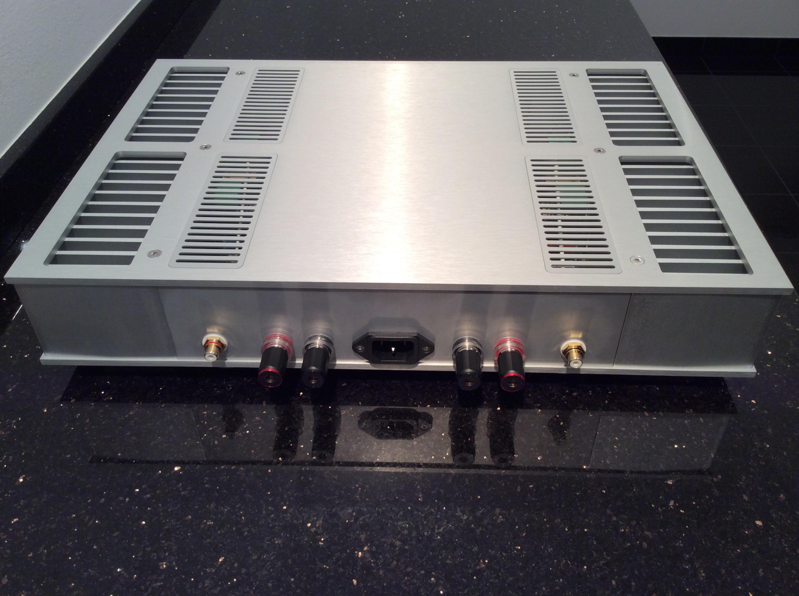

First One chassis C1 ready made amplifier
Started an assembly of a new First One amplifier for a friend. It's a generic dual mono version with two SMPS1200A400 and DC Sense protection. Pics will follow soon. :up:
As promised, First One for my friend finished, tested, already delivered. 🙂
What's inside:
- 2 First One modules
- 2 SMPS1200A400
- 2 DC sense modules
- C1 Chassis silver
- Acrolink FP-804R speaker binding posts
Regards, L.C. :cheers:
