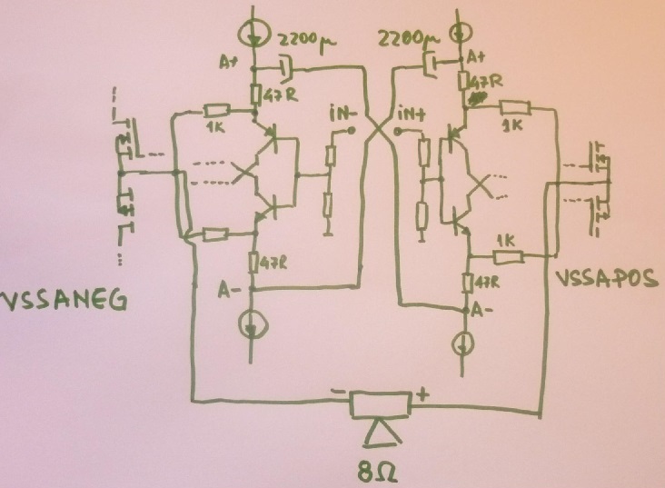

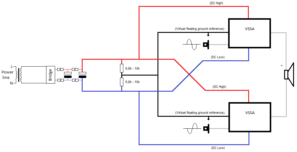

Ignore if not already knowing, following is just info and my admiration what member metallicus69 did over the VSSA thread. The bridged VSSA amp called XVSSA metallicus69 did was configured some non conventional way by PSU and grounds. He did the ESP safety earth trick. Floating PSU without center but a added virtual ground think something ala first picture but with added CM. Second picture his drawing where feedback caps are X'ed and floating such this point and feedback do not pollute virtuel ground (don't know if FO schematic is same here and be accepted). Think he reported he could safely connect only signal +/- from preamp without ground connected, whereafter LC posted that's called real H bridge if I remember correct.

Thanks for posting this - it's news to me. For all intents and purposes the FO schematic is identical, so all of the above should be valid. It is easy to have a hum-free amp using separate supplies per channel or ground isolating transformers at input. Not so easy with shared supplies. As for SMPS, the concept of adding additional RF sources to my listening environment does not greatly appeal. Purely anecdotal indeed, but i never heard a commercial amp using a SMPS that i liked.
