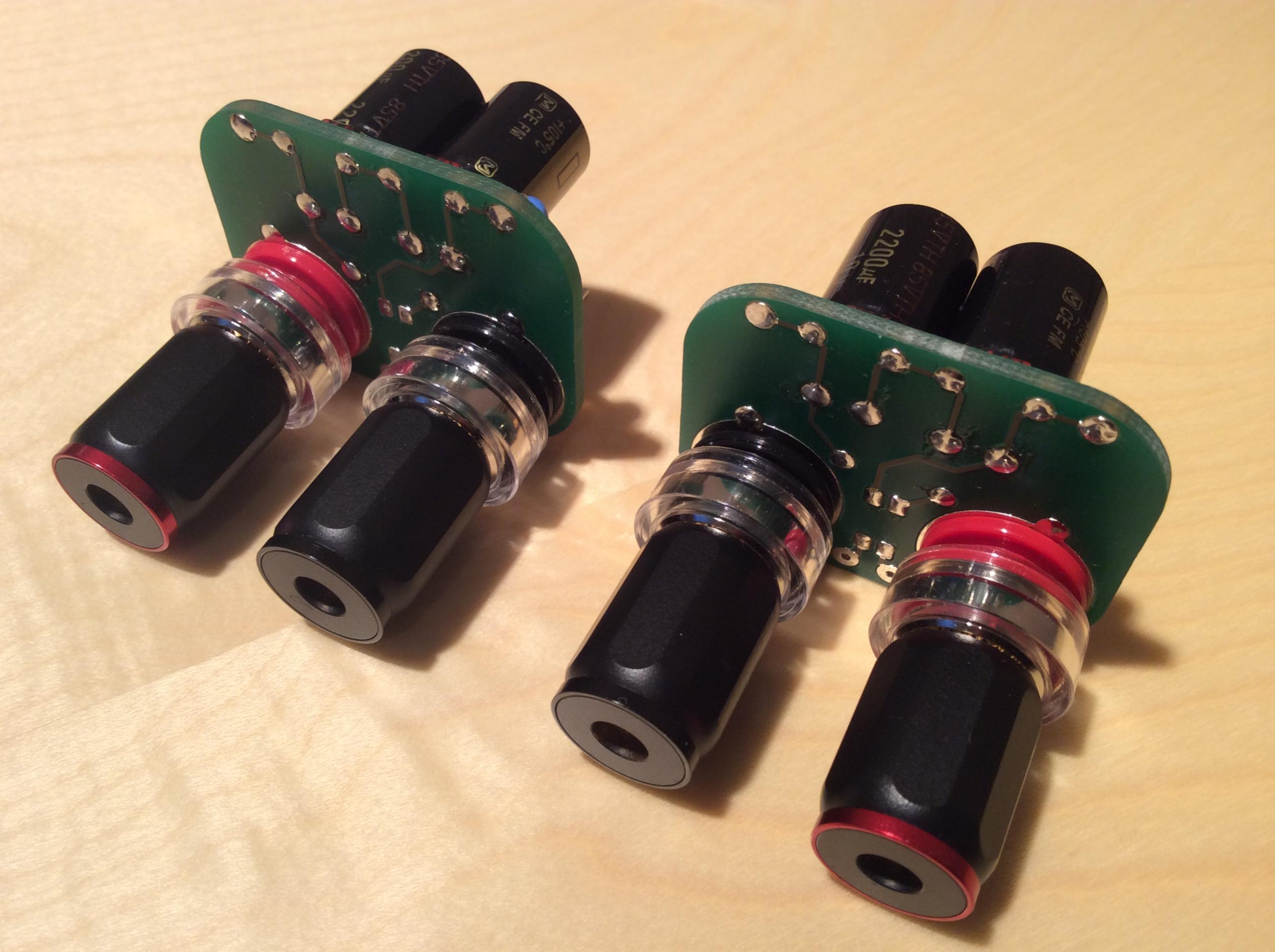

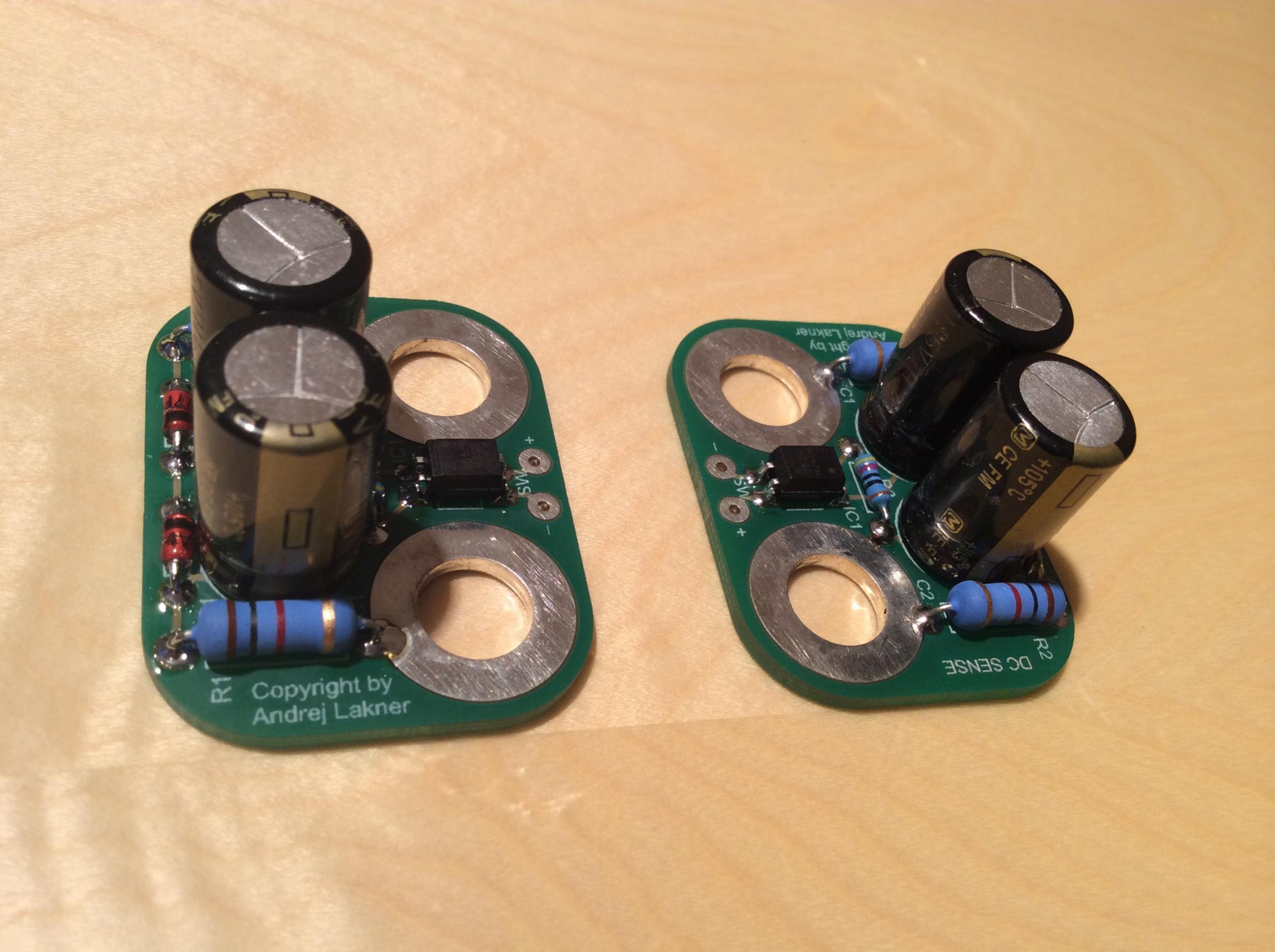

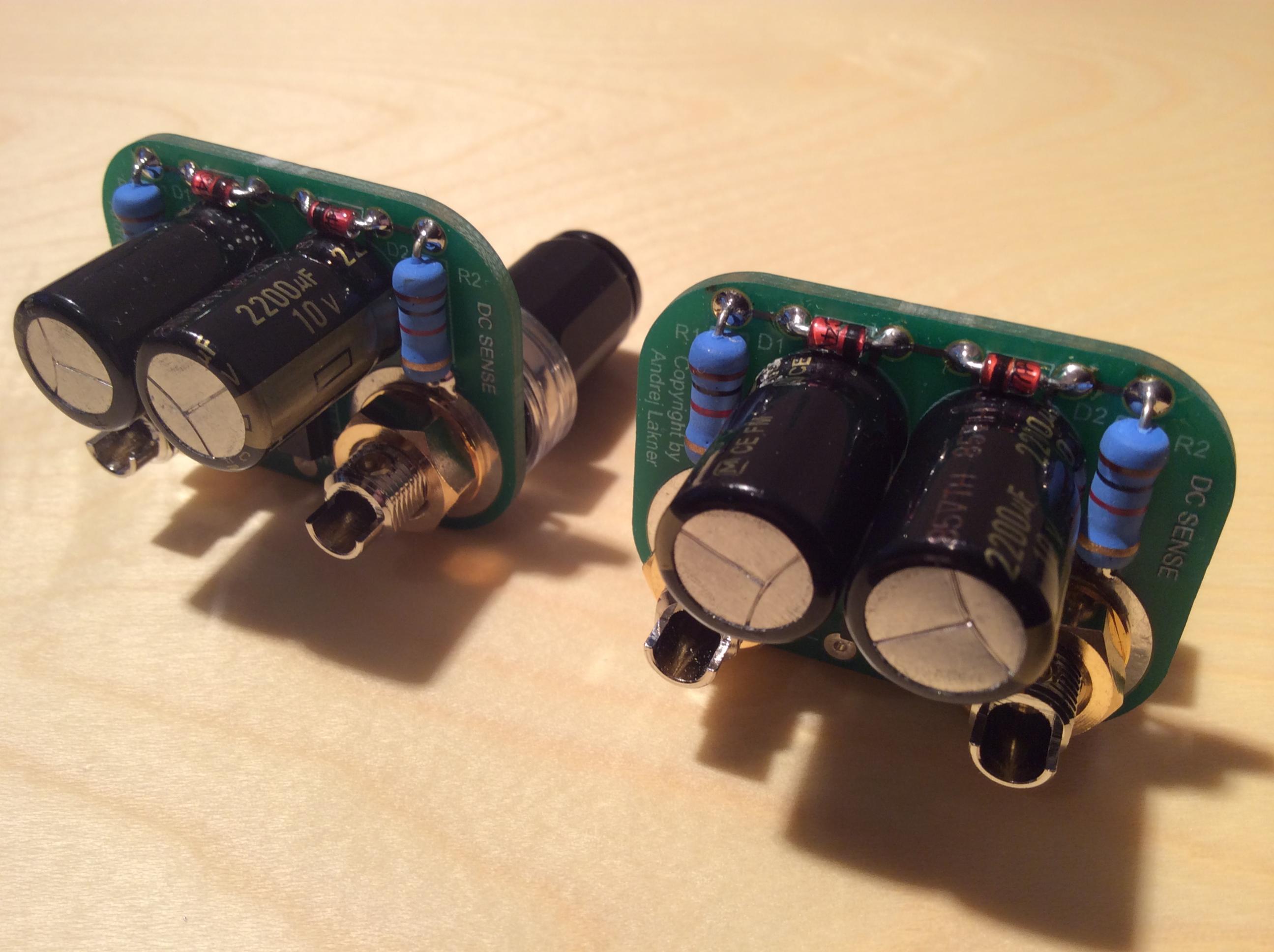

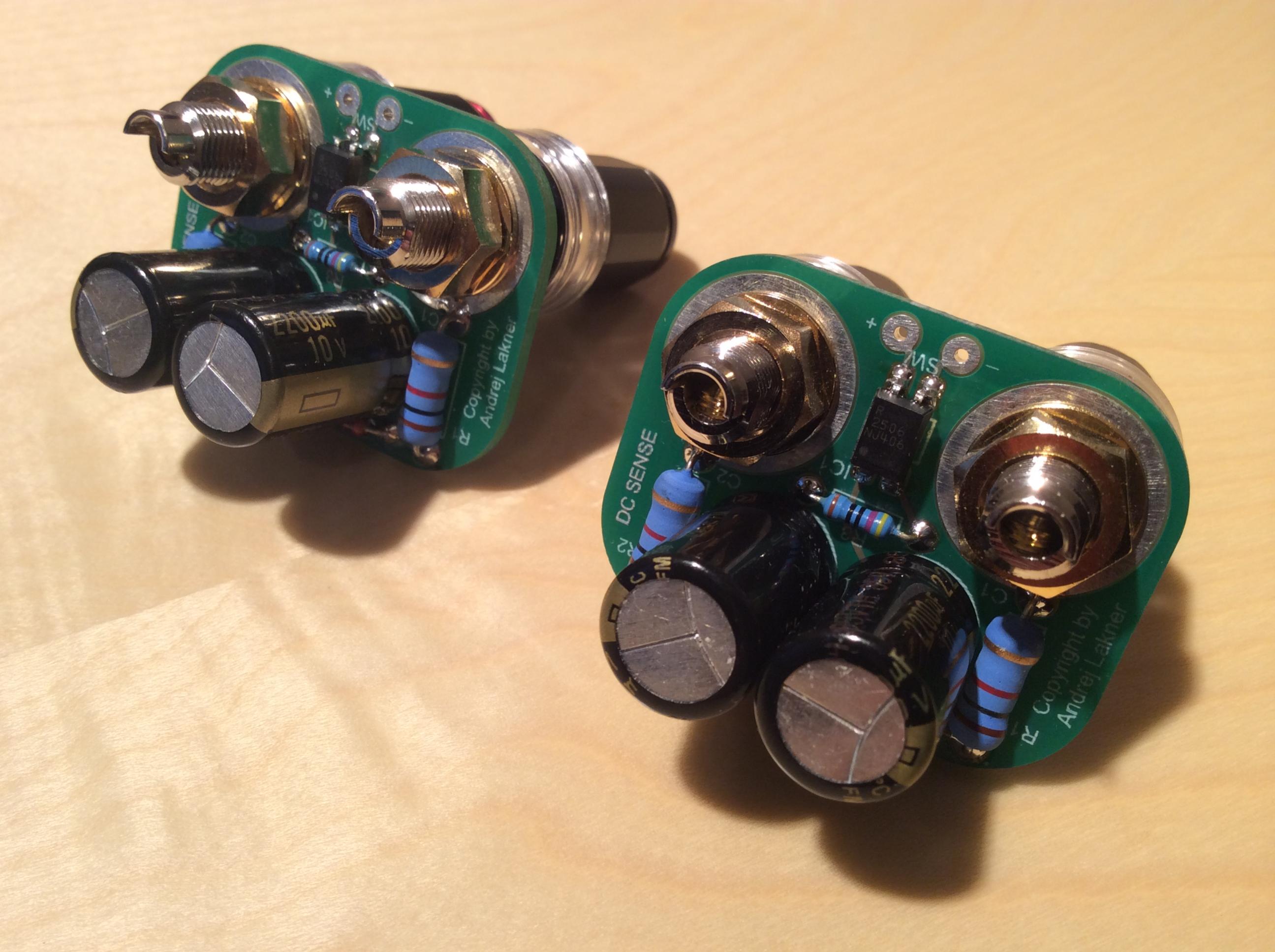

The dc sense is only for first one?
No, it's universal DC sense circuit with low pass filter -46 dB/10 Hz actuating opto darlington. The normally opened output serves to shutdown any power supply having input for this function.
For example SMPS1200A400 connector J4 pin 9, pin 10 are the ones to be connected to DC sense.
Below is how finished DC sense PCB looks like.
