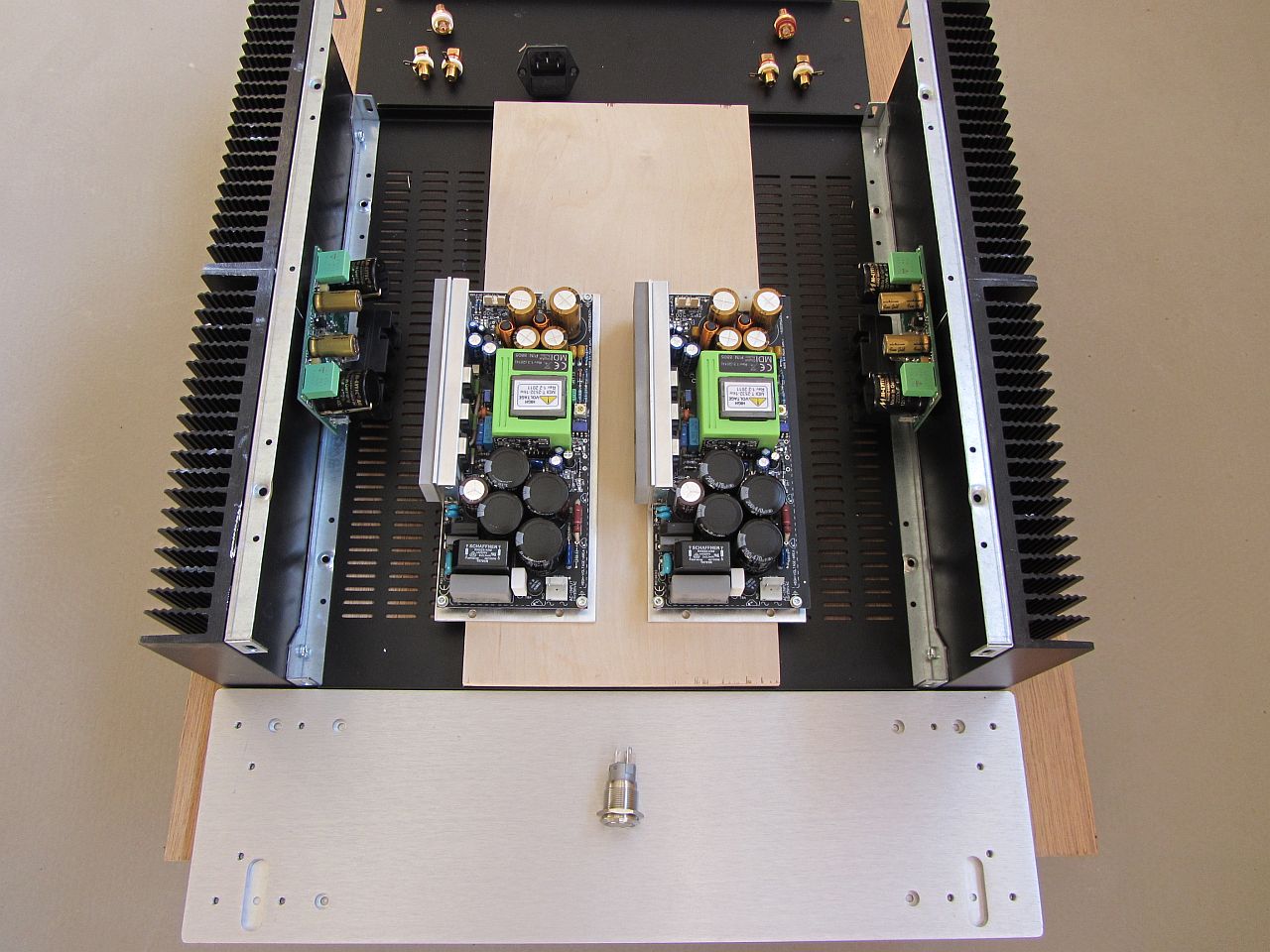

Just got the SMPS 🙂
I went for the regulated supply, because it measures very good.
Next week I'll know how it sounds in my system 🙂 if it is better than my F5 (Fairchild, CLC PS) on all areas I'll be very happy.
I'm pretty sure that bass will be better with the FO + SMPS, but the big challenge will be soundstage if it can match or surpass the F5.
Tried to find the best layout for my case, I think this one it will be, it's easy with a big case 🙂
I'll add also a soft start with temperature control, the main reason is that my nice looking switch can't handle the current so it will done by the relais of the soft start.
As speaker protection I'll add something based on the uPC123, simple and works good.
OK, time to drill some holes 🙂

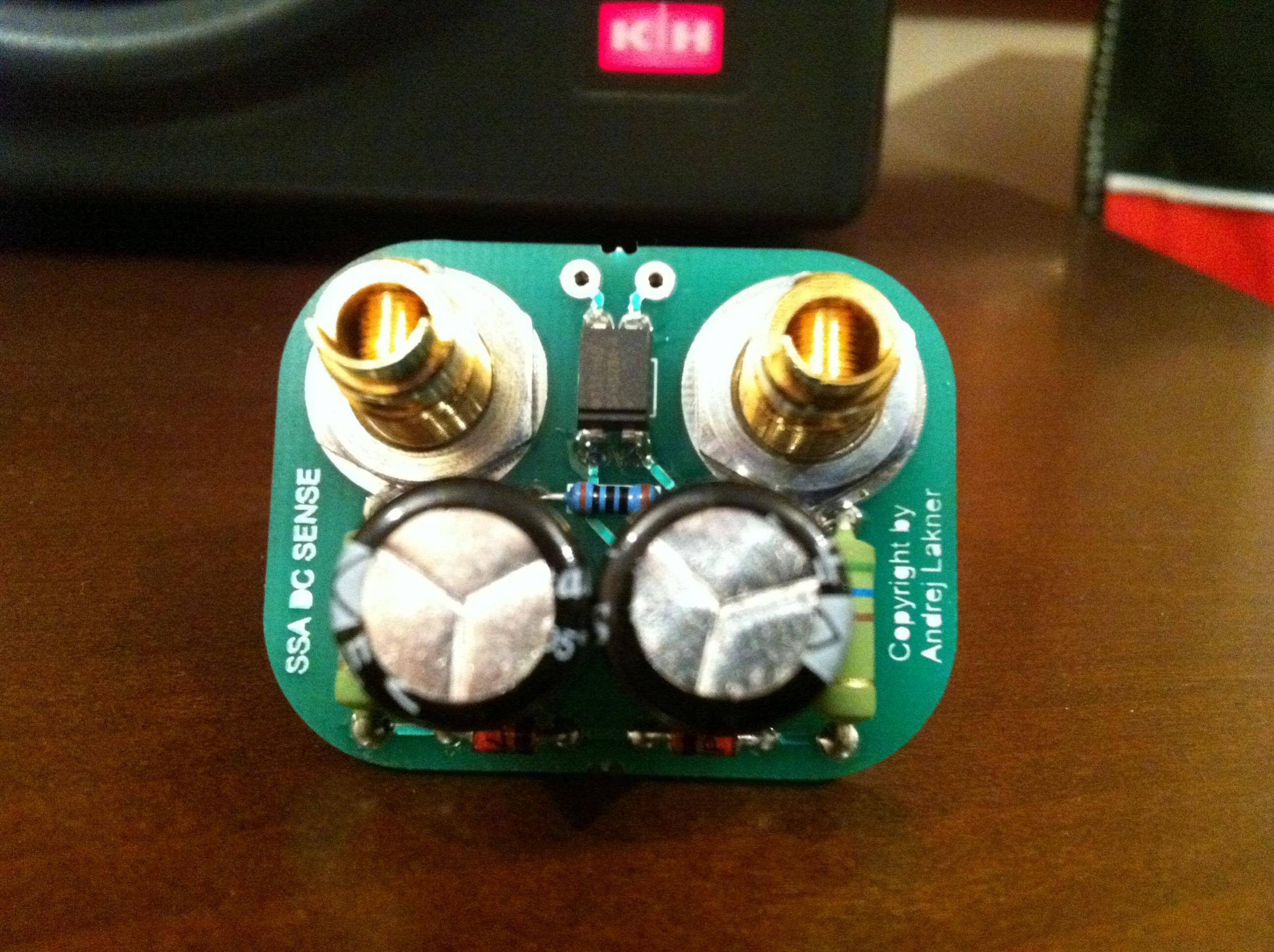

LC wrote on 9 May 2014:
"Also DC sense error circuit to shutdown SMPS1200A400 in a case of DC potential failure on the First One output will be presented.
Stay tuned "
What's the status of this DC sense error circuit?
John
Hi John
DC sense PCB-s in production, available from this week on. These will sense DC voltage on output terminals and send a signal to shutdown SMPS1200A400 or any other PSU.
Regards, L.C.
