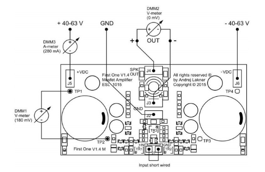

Perhaps you messed it up with 50mV emitter resistor voltage drop?
I'm not sure what you are referring to?
The ammeter was in series with the +ve Voltage Supply. With the Amplifier Module ‘idling’, Input Shorted and No Load (none is shown in the instructions) exactly as the instructions.
The Ammeter read 47mA.
Adjusting Trimmer TR3 had the effect of increasing the Current flow to a maximum of around the 50mA mark or reducing it. I only went down as far as 30mA. I saw no point in reducing it further.
Please make sure that you understand how to measure, and how to setup the DMM(s)! If you are not familiar with that you can make serious damage or worse...
I don't have a FO Large but the procedure is described exactly as it is with the Medium Modules and I have adjusted those quite a few times now successfully.
It really does take 3 multimeters to do it without a lot of frustration. I soldered wires to the test points to make it easier to attach the multimeters without having to try and hold the probes to the test points.
The values are very interactive and if someone has twiddled the trimmers it might take a while to get it back into balance. The trimmers are multiturn if they have been set to the end of their travel and you are having trouble I would set them all back to the centre and try again.
The amp really does need to be warm left idling for at least 20 minutes after switch on.
Having the ammeter or multimeter set to amps in line with the positive power supply is the correct way to measure the idle current draw.

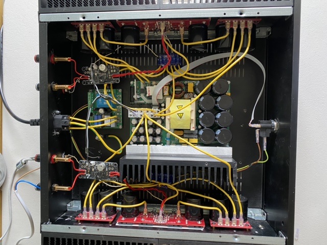

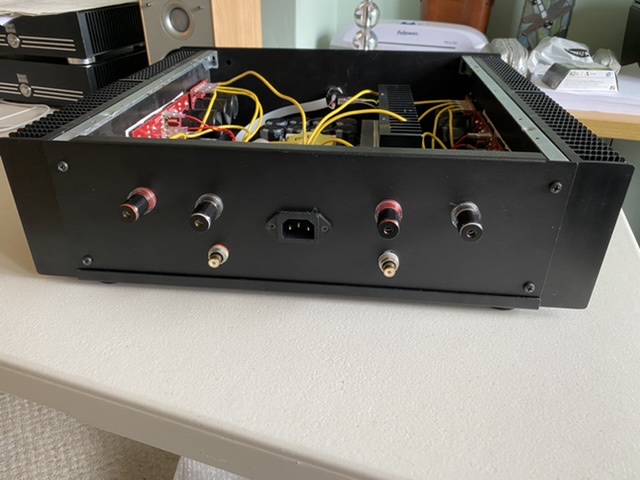

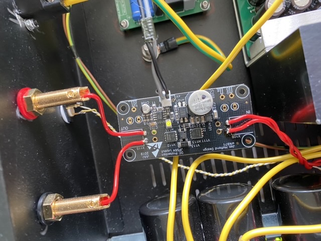

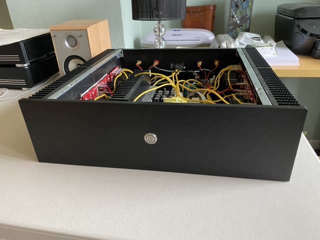

Done - many thanks everyone for your help and assistance. Perhaps for my first ever electronics project I should have picked something easier, but I’ve learnt a great deal! Now for the listening comparisons against my ncore mono blocks!
