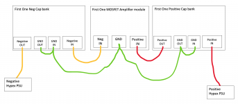

Appologies for the poor quality diagram - is this floating ground a good means of grounding the Mosfet module and it's associated cap banks? Obviously there is still a safety earth to the chassis from the IEC inlet.
I have zero experience in grounding!

I don't understand your wiring...how the current will return from the modules to the PSU?

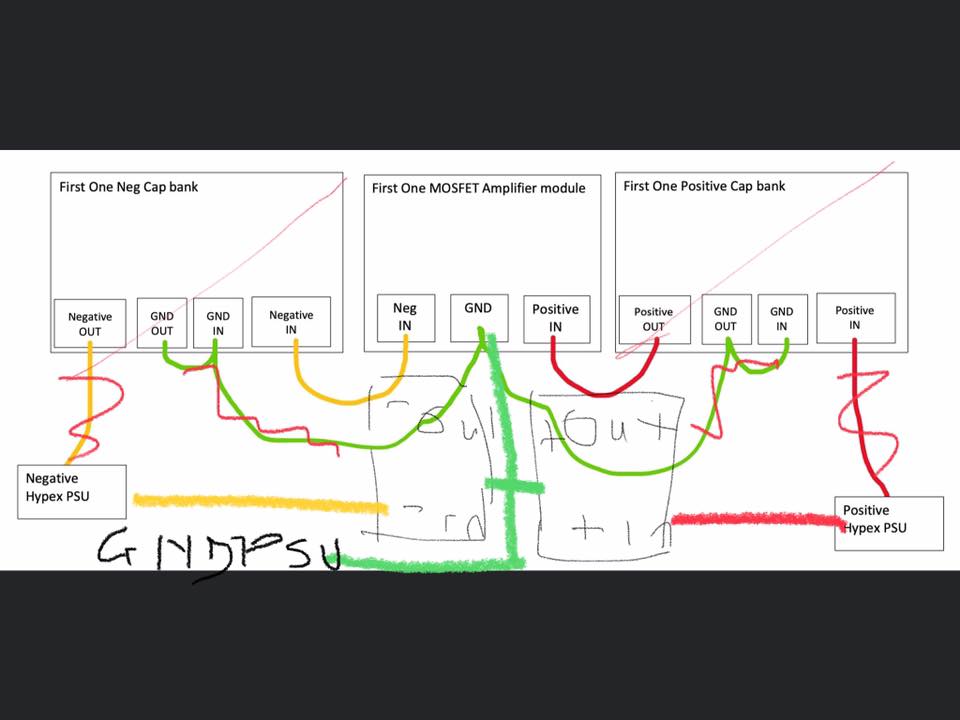

I'm not supprised this didn't make sense to people - I didn't know what I was doing, hence the question. Anyhow, I now understand a bit better. Whilst signal ground can be floating, the amplifier ground cannot because ground needs to be returned to the power supply for it to start.
Guy on Facebook gave me this better layout, which includes the ground return to the amplifier. I will also do the mandatory safetly ground to the chassis at the IEC inlet.
I apologize. I was not very extensive on the reply and was not of much help, save to increase uncertainty. The amp needs a "0V" stable reference plus the speakers return current needs a path...from my limited understanding.
Anyway, the experts want us to do our due diligence, our homework, so it is a good time for us to revisit the all-important grounding philosophy. 🙂

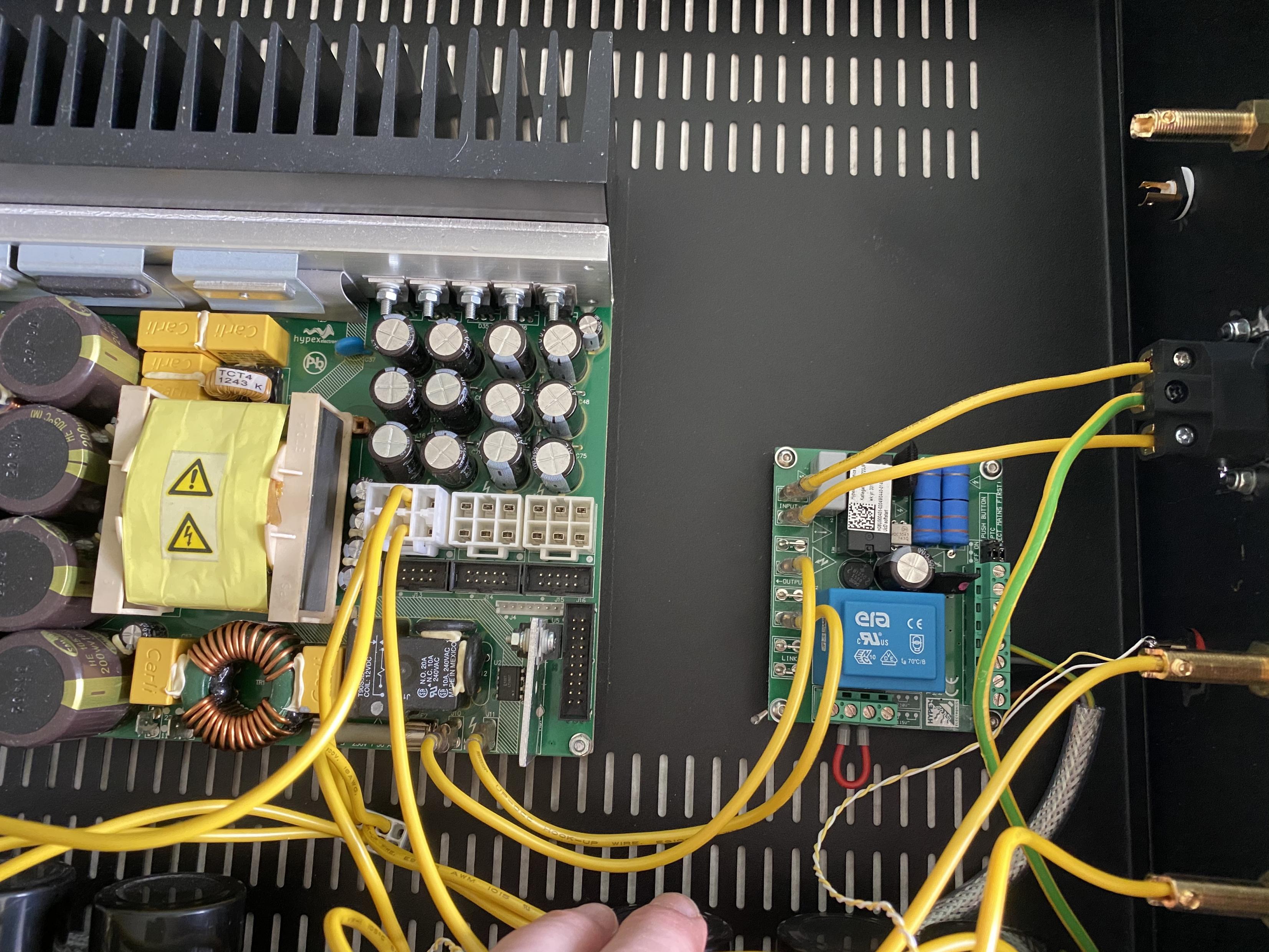

Build is progressing, one channel connected - but no sound...
Relay on the Hypex soft start clicks and powers the push button switch, but I am unsure if the Hypex SMPS is powering up. No voltage measured between First One + in and GND. I have disabled the push button switch to ensure that this wasn’t causing issue.

My power supply was faulty - exchanges for a new Hypex and we have sound!
