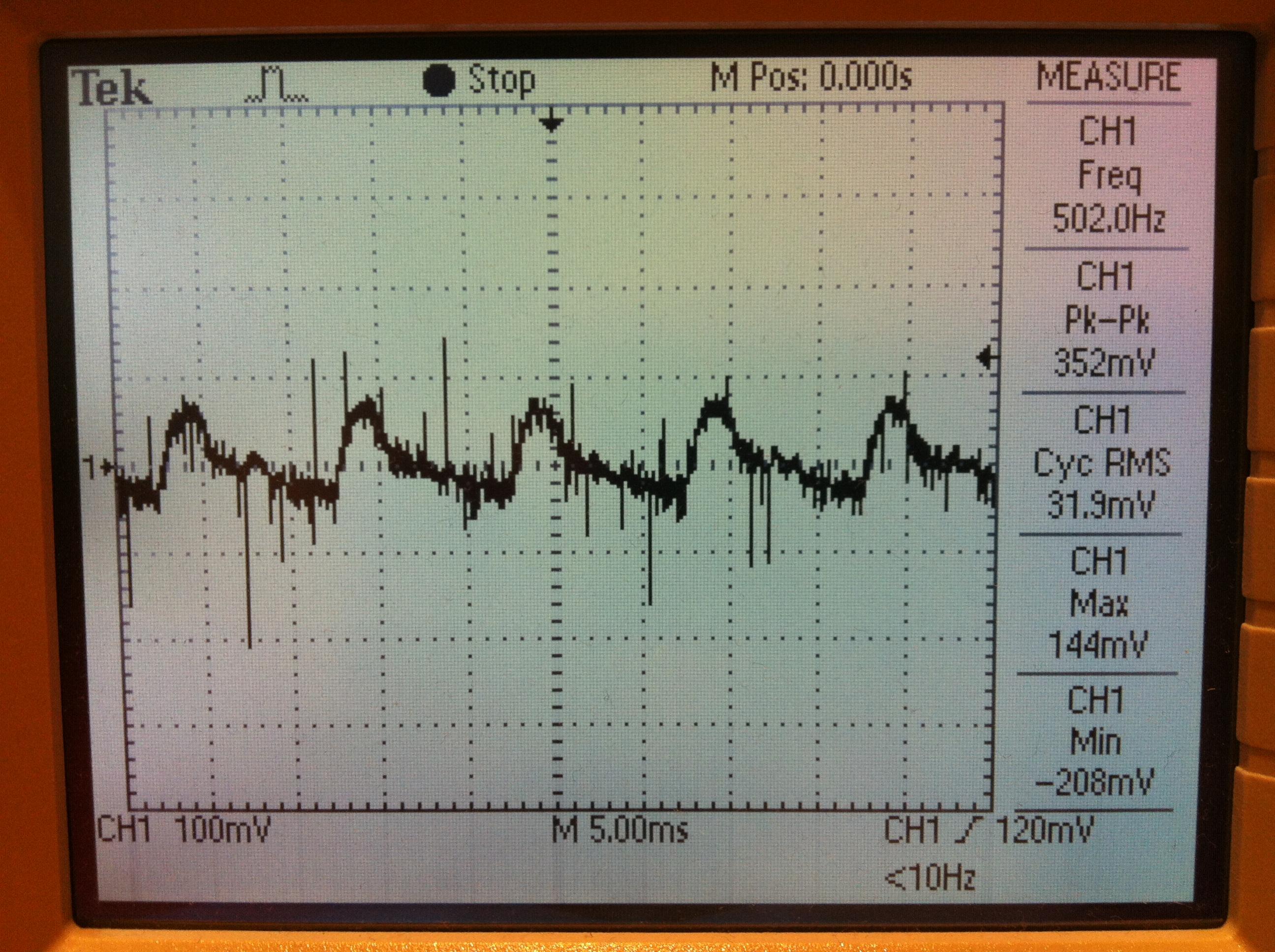

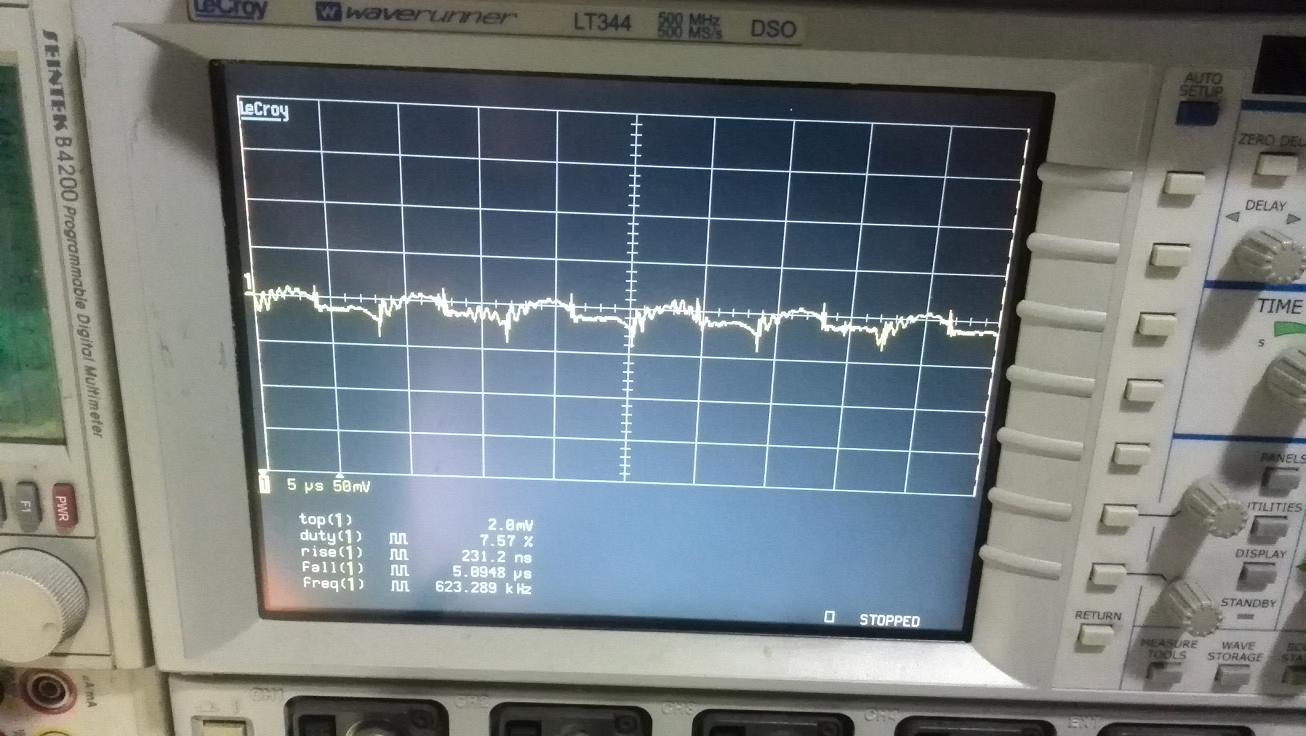

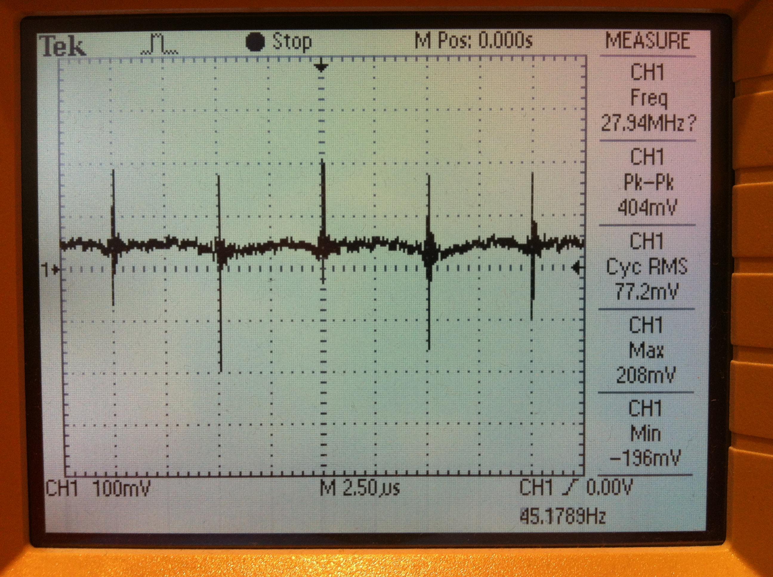

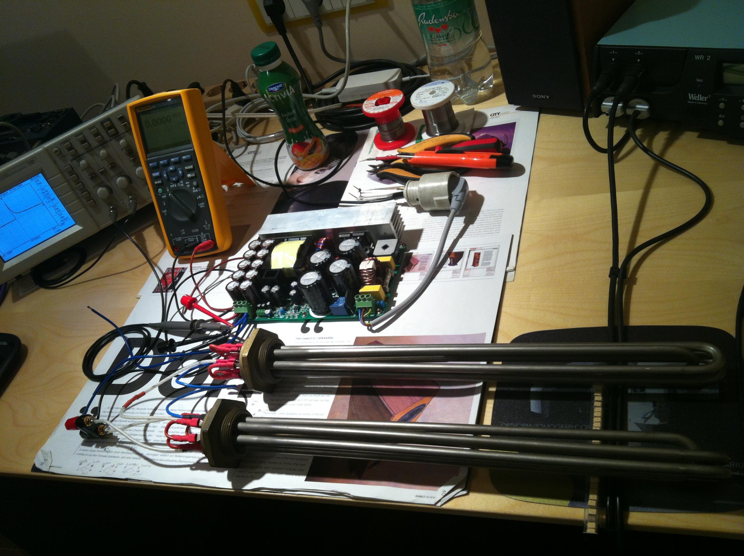

Finally found the time to test SMPS2000R from Connex electronics.
All test images performed at +/-63 V on 4 Ohm load, meaning 15 A constant output current.
There are two different versions Cristi sent to me. This test is performed with version A which has 2 x 5000 uF/100 V in secondary capacitor bank.
Images:

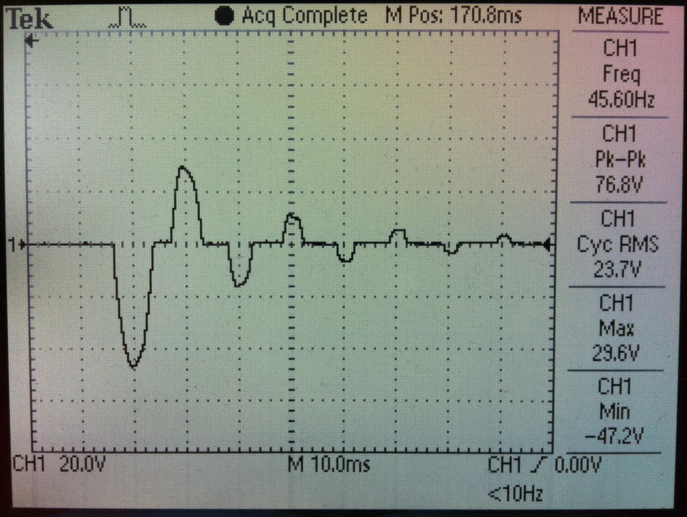

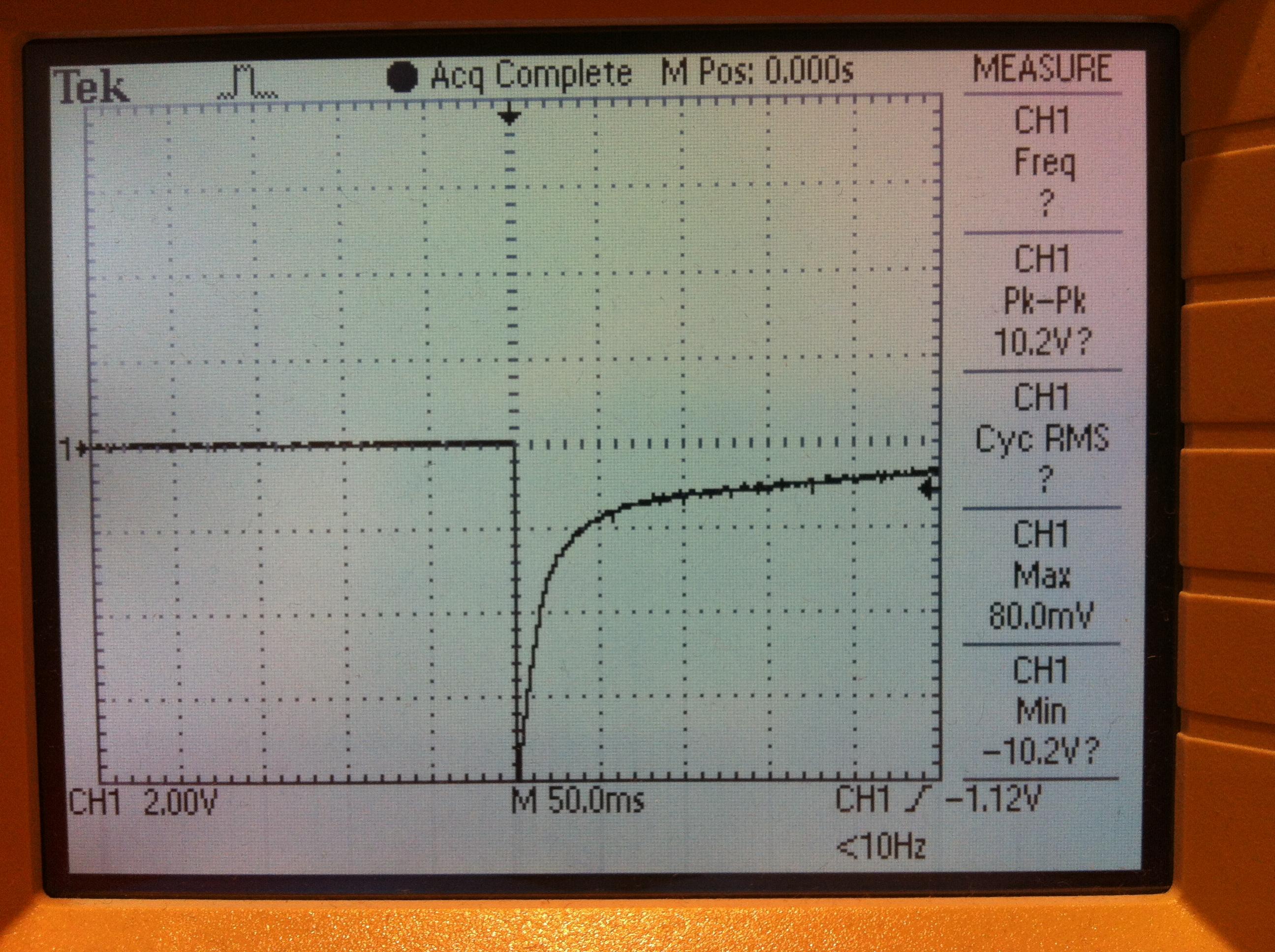

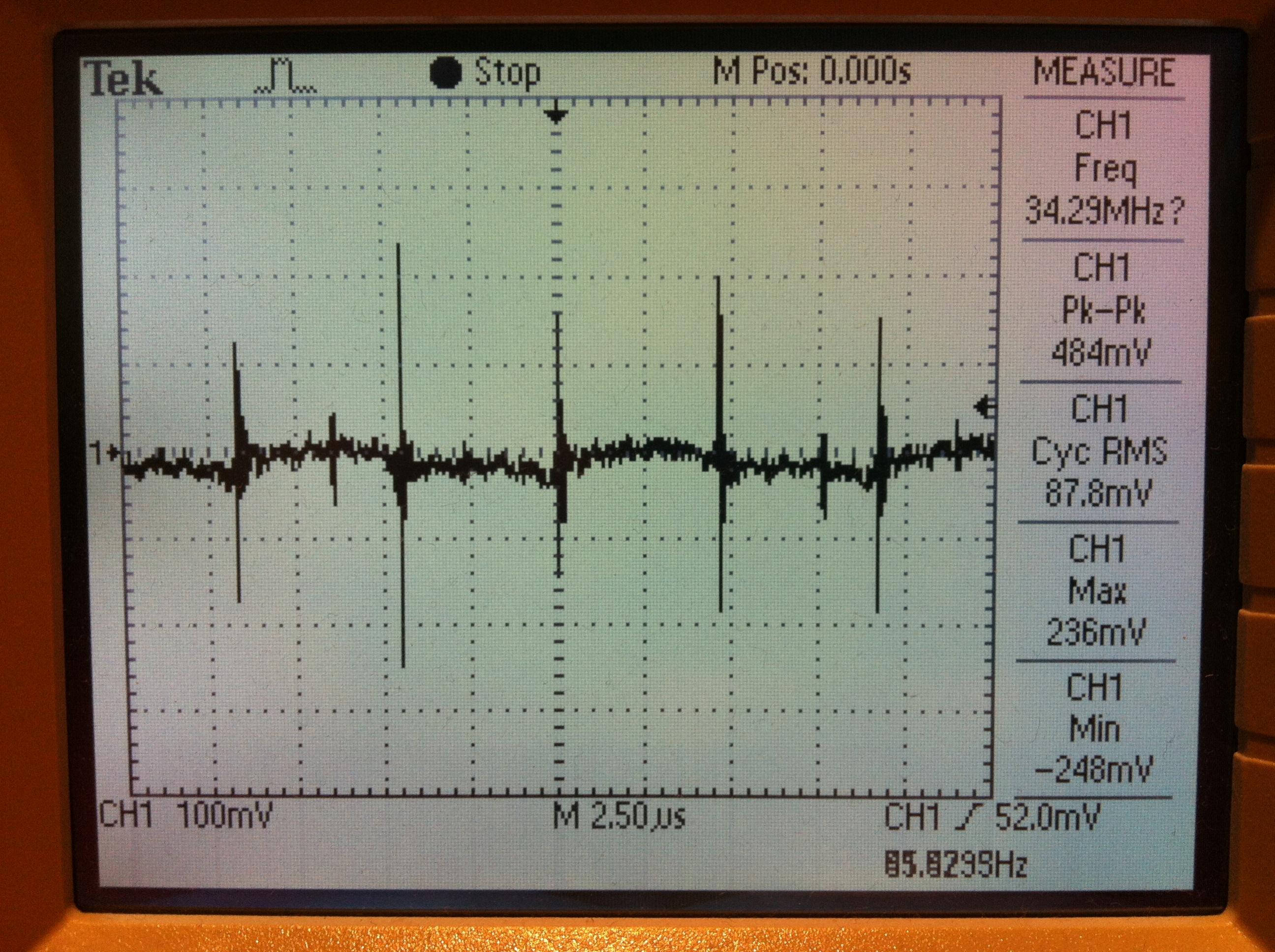

1. SMPS2000R version A test rig
2. Mains inrush current at first few half periods going in order: 47,2 Ap, 29,6 Ap, 16,4 Ap, 11,8 Ap, 7,2 Ap etc. When NTC relay kicks-in, inrush current never exceeds 5 Ap, so relay just takes care that primary capacitor bank charges without any serial resistance.

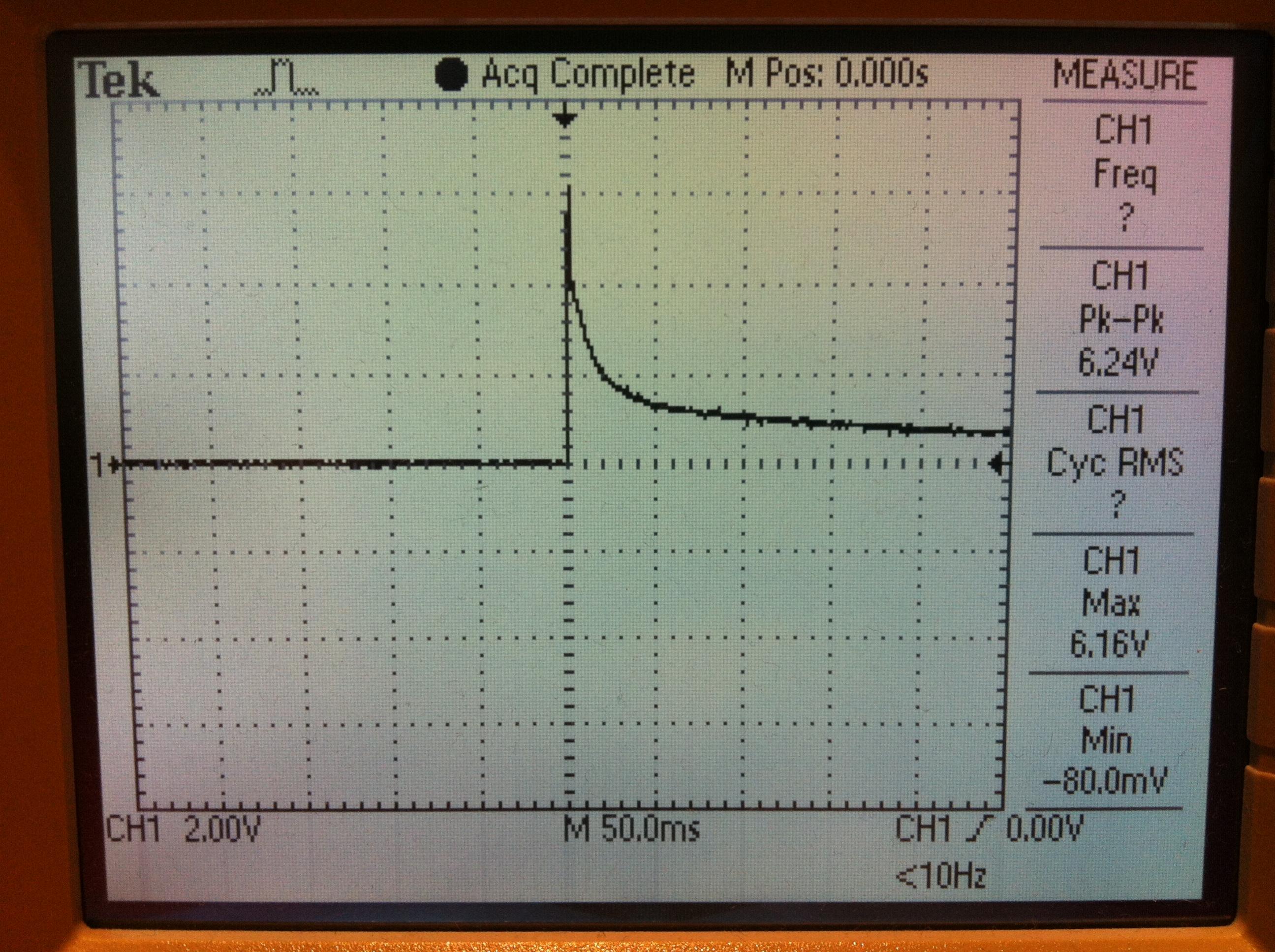

Primary capacitor bank is formed by four 470 uF/400 V Nichicon caps in both versions and stores app. 90 J of energy, so for 10 ms period it can serve with staggering 9 kW power pulse.
3. positive rail 6 V voltage drop at 15 A loading
4. positive rail low frequency ripple at 15 A loading
5. positive rail high frequency ripple at 15 A loading

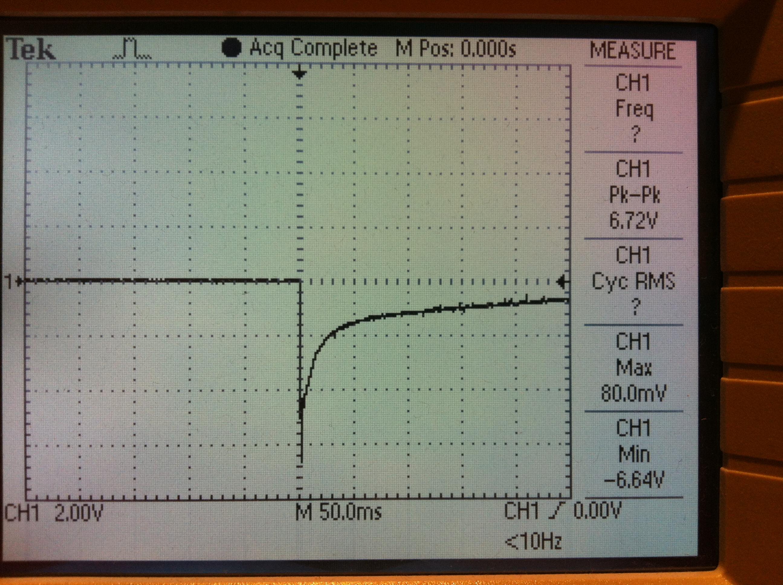

6. negative rail 6 V voltage drop at 15 A loading
7. negative rail low frequency ripple at 15 A loading
8. negative rail high frequency ripple at 15 A loading

SMPS2000R version B Test
There are two different versions Cristi sent to me. This test is performed with version A which has 2 x 2800 uF/100 V in secondary capacitor bank.
Images:
1. SMPS2000R version B test rig

3. positive rail 8 V voltage drop at 15 A loading
6. negative rail 8 V voltage drop at 15 A loading

SMPS2000R + First One
SMPS2000R is just too powerful to supply only one First One amplifier module, so it is ideal for powering stereo version. Also some members prefers one single PSU for both channels as for better stereo imaging coming from one single ground layout.
At 15 A constant loading there is only 2 V DC voltage drop on both rails, so from power reserve point of view one SMPS2000R is sufficient for supplying two channels.
