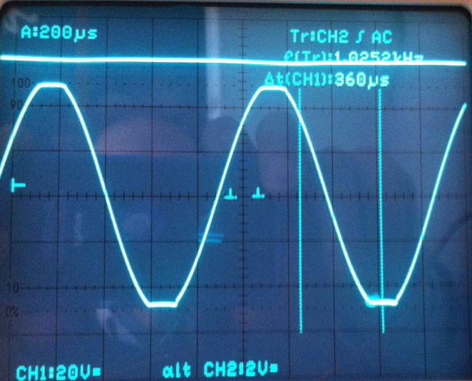

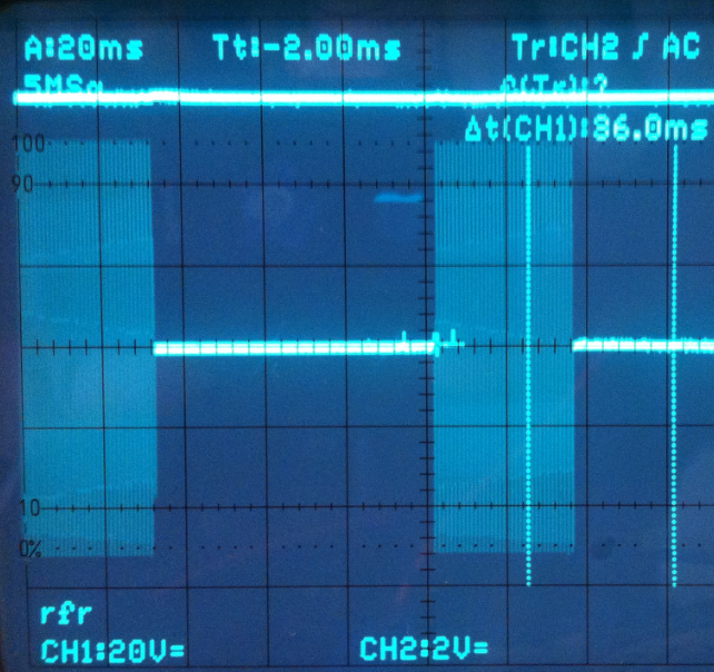

I'm done now, after 10 hours of immersion in DPS-500 candidates for first one.
I had to consider the pair of 2200uF which the First-One, has on board also.
therefore, the DPS-500 have 1x470uF on the primary side, 2200uF in the secondary side.
I tested with load at 4R continuos Resistive, via amp continuos and burst 4R, fft 4R at 50% of power. All is perfect in range.

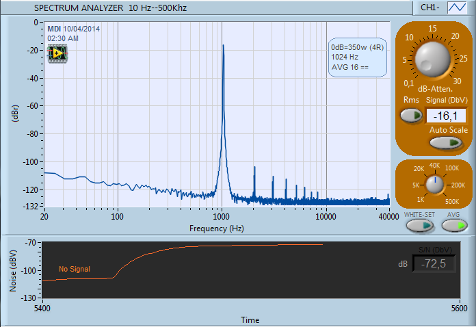

Last measures on samples for LC (after my intervent to customize well for First One)
I think not need comment, Measure very simple. 🙂
Just two word:
Drop voltage under burst/continuos from 4R--8R,with no difference.
Residual HF (F=120Khz) -82dB(300mA) at Output Connector.
Spikes due to the square wave, not present (zero), these can not be eliminated, when present as "conducted" on the output connector). they occupy the frequency range from MHz to GHz and spread everywhere.
is very long, explain the effects.
These are part of EMI / RFI, even if smps is used for electric motors or lamps, the value of these harmonics, such as "induced" via AC line, do not allow for the approval, including the CE.
You all can not even be interested in this maybe (enough that the amp sounds), but I'm not a DIY, so I have to solve,as well in Unreg DPS-400.

(amateur thoughts: aah :scratch1:..... wonder if measure were taken on package for LC reopened again again or on other samples)
See date of day on fft 10/April. measures on samples for LC just before closing the package.
One smps need a lot of measure, I did not want to bore...😀,
Just these simple that LC can confirm for sure.
