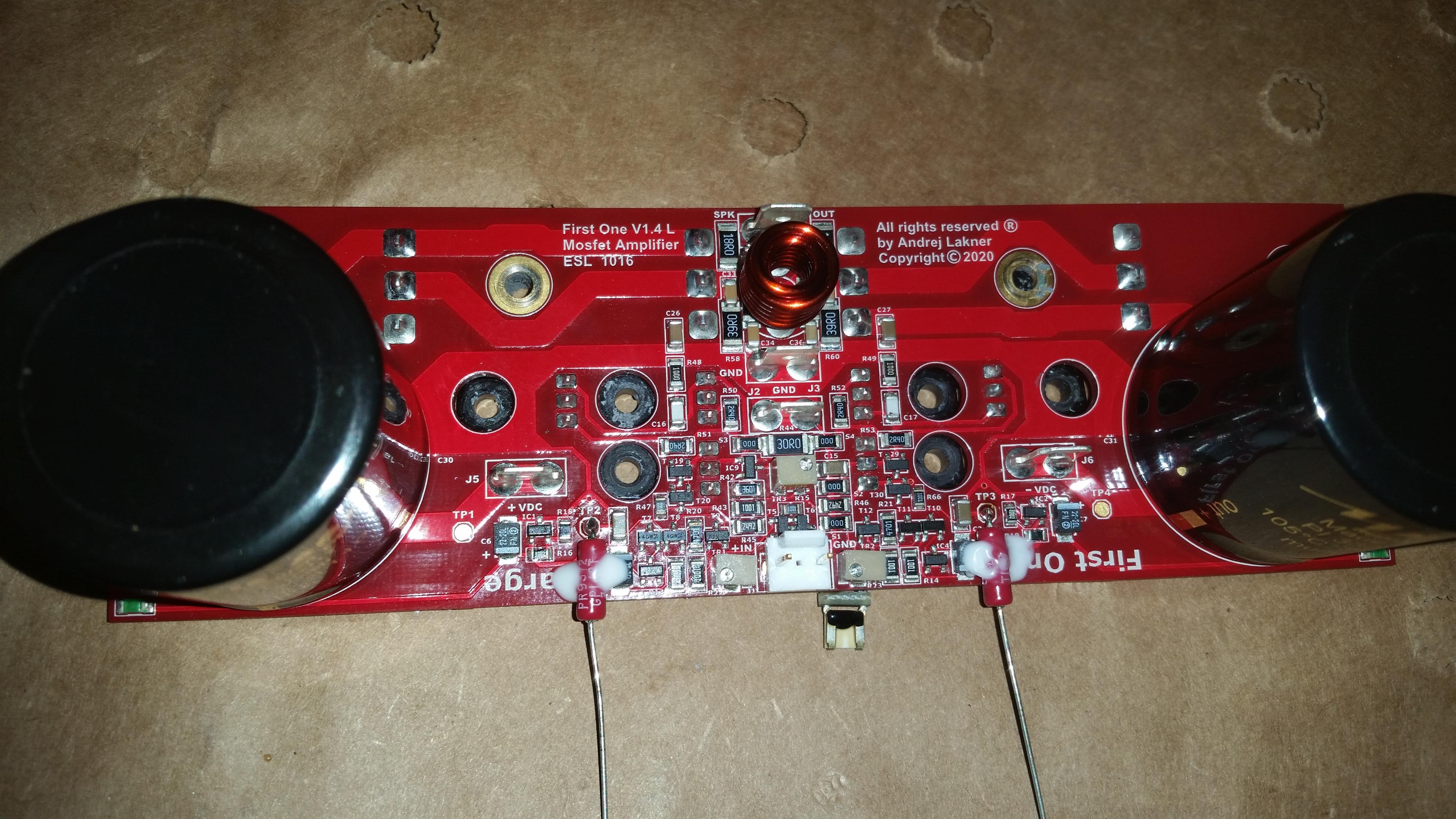

Nothing really much you can do now, there's full bunch of SMD parts on bottom of PCB. TP1-TP2 mV adjustment should be trivial, can not imagine how a spark came into equation. Was multimeter set to A instead mV?

Multimeter was set to voltage I am very sure. R 35 10 ohm and T 16 is blown. Can I buy thoose from you? Or is it better to send it back for repair?

Works perfect now 200 Mv. 2x85 Vdc Supply 1 mv dc and 36 Celsius

3,9 kohm resistors to measure at the open end for improved security. I solder the leads for the multimeter to the end. Hope Lazy Cat will forgive me.

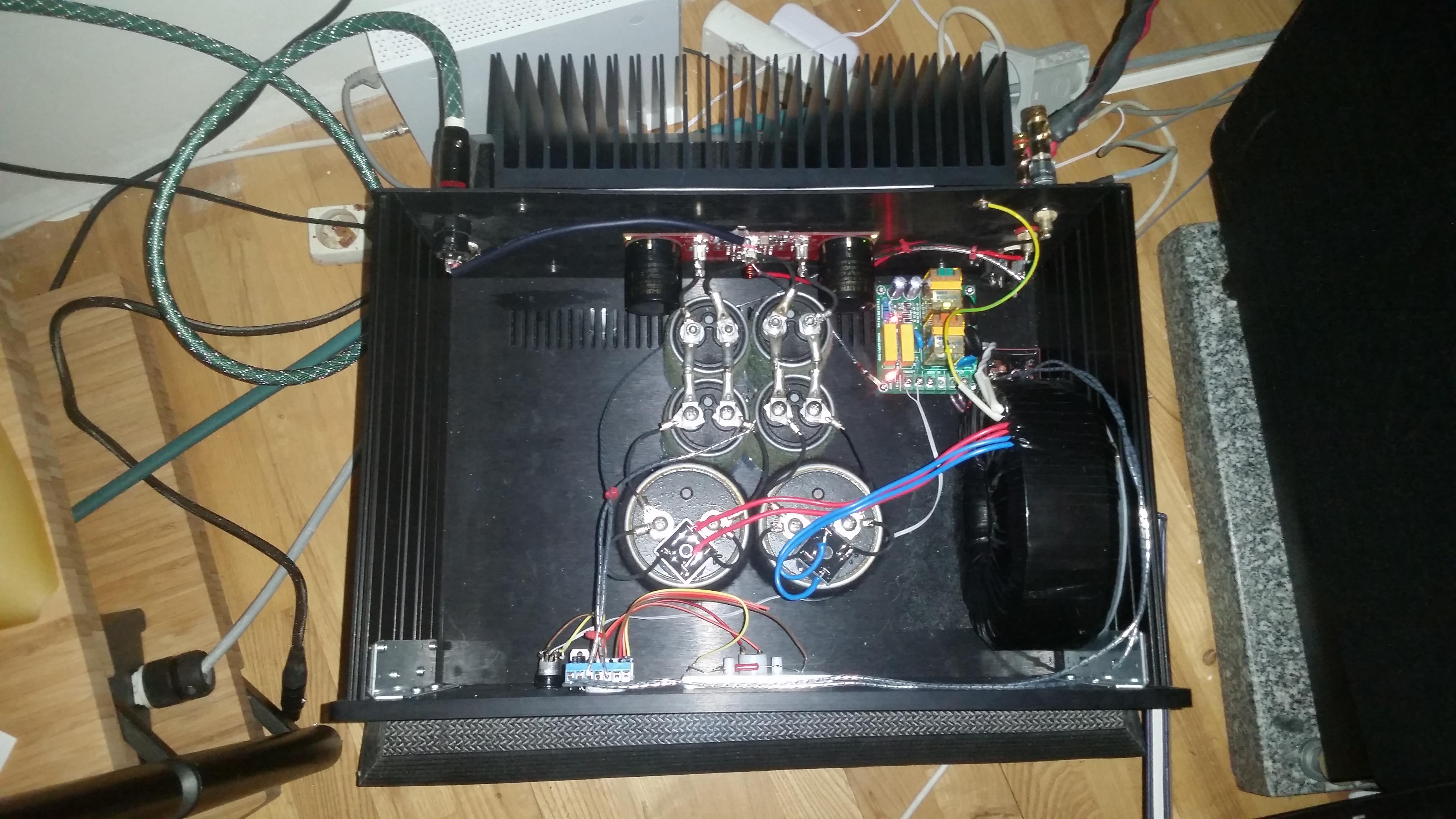

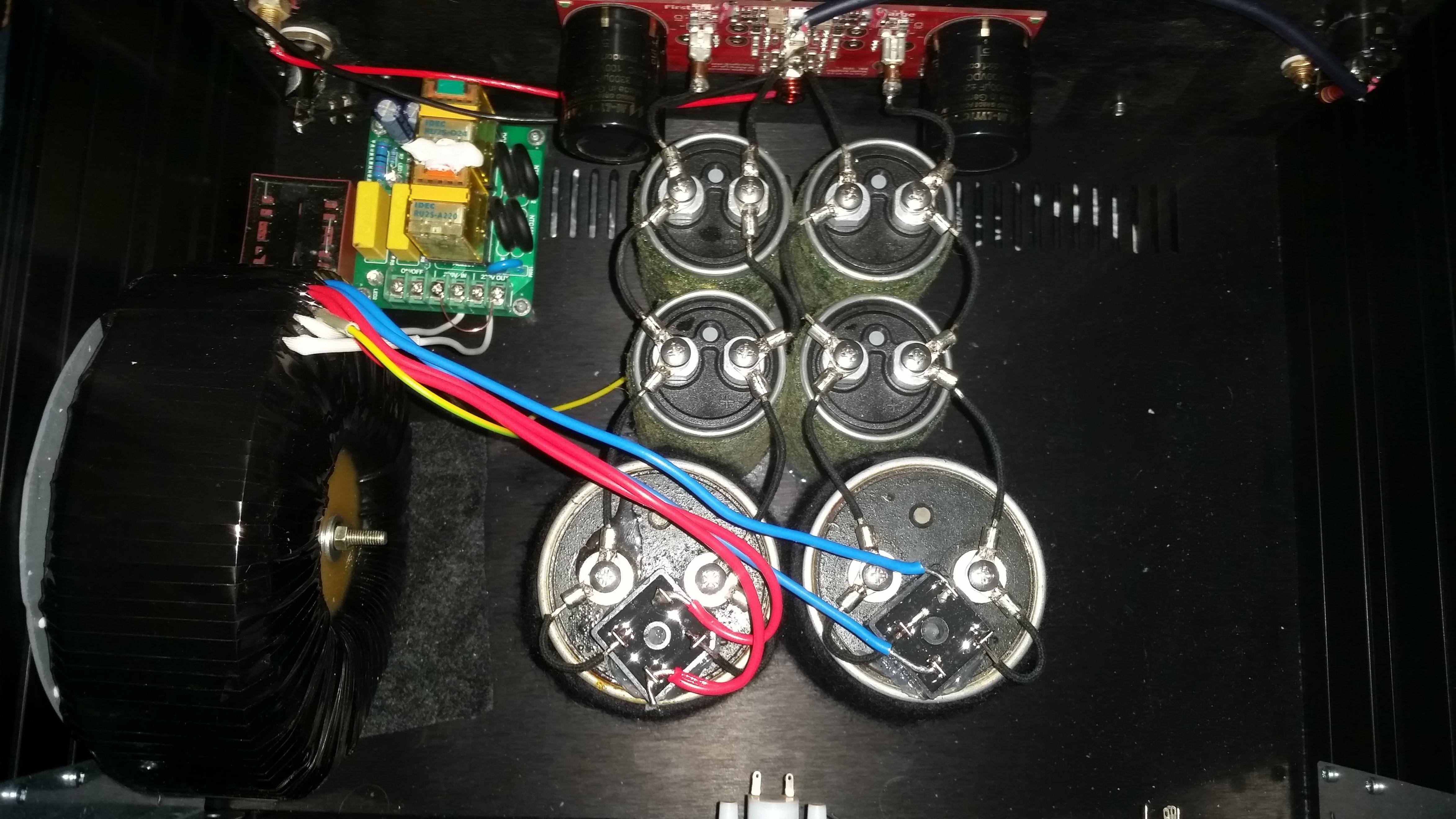

I would like to connect Power supply to enclosure. Any advice on that? In Denmark it is not Main Earth in all houses.
I can measure some hum at output.
Mr. Pass uses and recommends a NTC (CL60?) thermistor from ground to chassis.
These thermistors are very good weapons. I use them also in series with the AC to SMPS when increasing capacitance...
But if you don't have Mains protective Earth...you better instal a good one beforehand.
