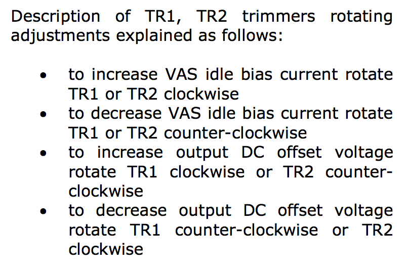

Thanks. I did read the instructions carefully before I started the process!It depends on how far off the target you are to some extent, different supply voltages can make the factory setting not that close so you might need to turn more.
If you carefully read the instructions it tells you which way to turn the trimmers to have the effect you want. There is usually only one direction on one trimmer that will have the overall effect you want.
E.g. If you want increase bias and decrease DC offset turn TR2 clockwise
It is a balancing act and can be quite frustrating unless you have three meters to watch at the same time.
I found with only two it was easier to leave one connected to measure overall current as an ammeter and then use the leads of the other to check between the vas and dc settings.
When I first started I tried to set one parameter how I wanted and then get the other but it doesn't work like that as the parameters are interactive![]()
It went much faster when I actually read the instructions more closely as I then knew which way to turn the trimmers to get what I wanted 😉
Should I be able to get the settings to hold steady at the desired values? My DC offset for example is constantly changing within a range of about 20mV. Is that normal?
No I don't think that is normal.
Have you let the heatsinks warm up to temperature properly before trying this? This could take up to half an hour.
Are your voltage rails from the power supply stable?
Have you got the meter probes firmly attached to the points you are measuring?
I hope the above doesn't sound like sucking eggs but I would be surprised if you had a faulty module as they are all tested before they are shipped.
If you have a picture of your test setup it might help to see how you are doing it otherwise it is hard to help from a distance.
