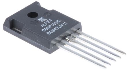

FO S is based around ALF08NP16V5 mosfet which is happen to be unobtainable, any suggestions?
Only suggestion then is the F.O. M but at a lower PS rail. What is your advice?

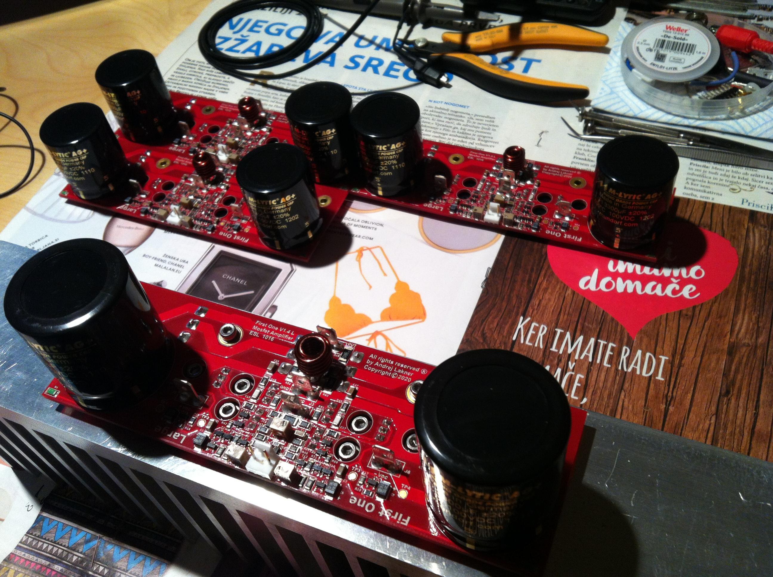

Think I killed the Large modul at once by adjustment. A spark at TP 3 and now there is 9.84 vdc between TP3 and TP4
Between TP3 and 4 no measureable connection. Between 1 og 2 10 ohm.
Spark? Where did it came from? FO L worked perfectly on my test bench.Think I killed the Large modul at once by adjustment. A spark at TP 3 and now there is 9.84 vdc between TP3 and TP4
TP1-TP2 also TP3-TP4 resistance should be 10 Ohm.
Well it was running for 20 hours before I started adjustment. There was 45 mv at TP 3- 4. Can not see any 10 ohm resistor. Anything I can do?
Nothing really much you can do now, there's full bunch of SMD parts on bottom of PCB. TP1-TP2 mV adjustment should be trivial, can not imagine how a spark came into equation. Was multimeter set to A instead mV?
I consider myself experienced in this regard but I always approach to setup adjustments with max caution.
Did you like the sound in that 20 hours session or it was just powered without the signal?
Measuring Voltage TP 3 - TP 4 the leads from multimeter is right at the base of T 16. I do not like that situation. Would be Nice with a resistor in between.
Collector?
