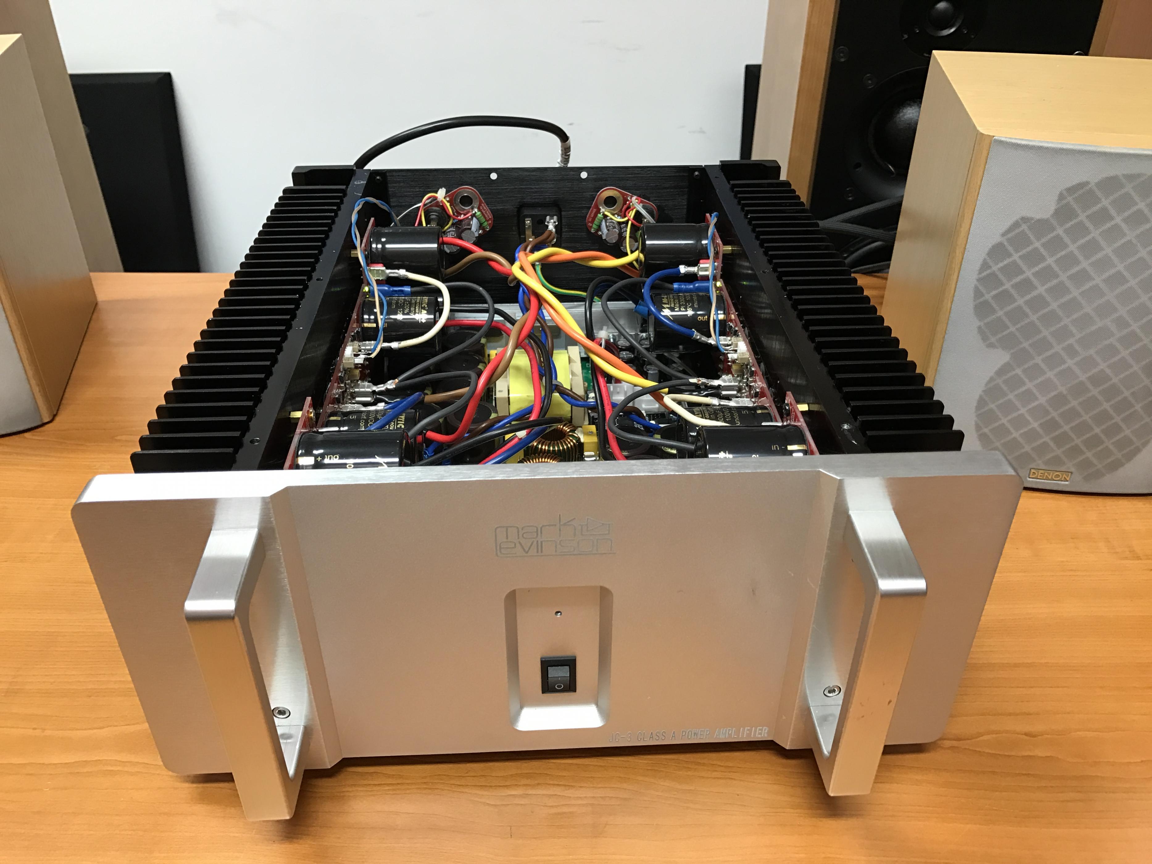

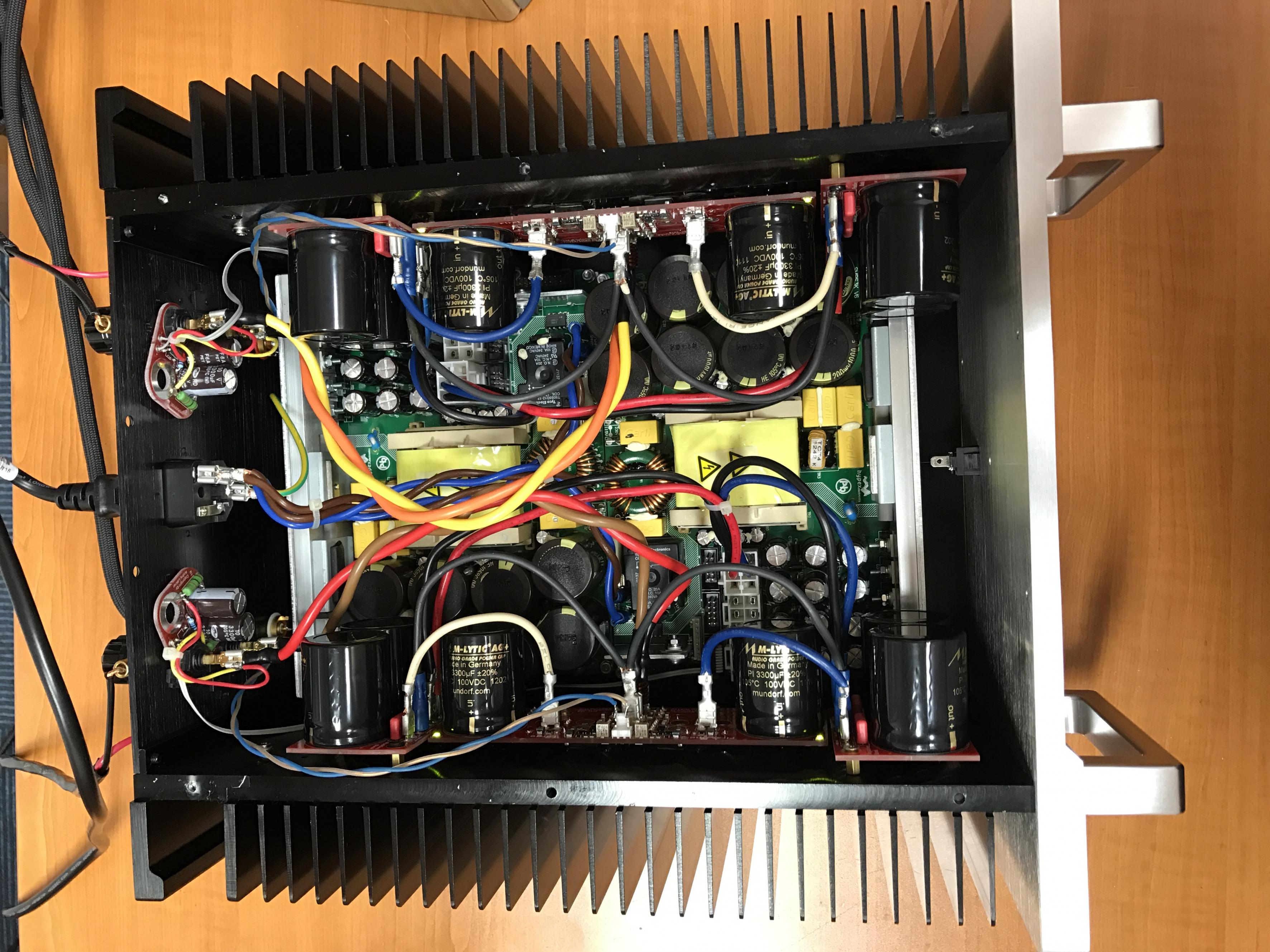

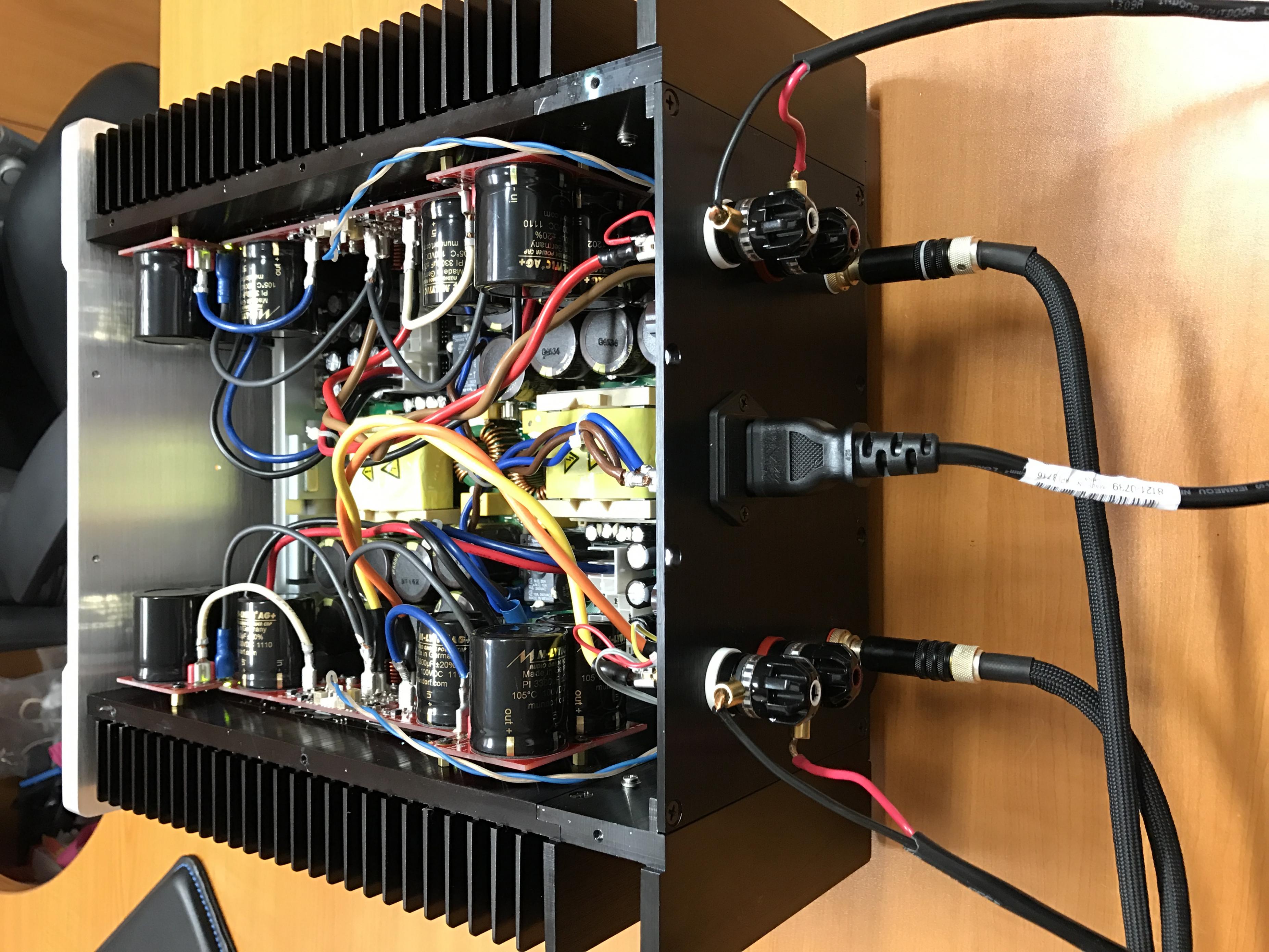

Finally managed to put these parts together and power on this beast. Just 30mins initial listening, super clean and transparent sound. Will compare with my FO-M once this beast settle down.

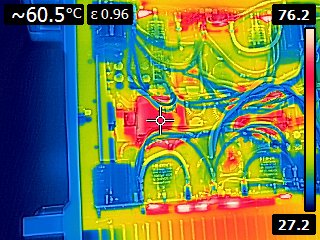

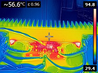

but according to my thermal camera, this Taobao sourced amp chassis's heatsink maybe too small, no technical specification on the china site for this heatsink. Only playing 30mins in my 25degree office the chassis went to almost 57 degree. I have not tune the biasing yet, just measure the speaker DC offset one side 20+ mV and the other 110+ mV and just connect a small speaker and turn it on. Maybe when I tune the biasing voltage temp maybe lower but still maybe I should find a bigger heatsink. Hope LC's FO-L mono chassis will be available soon. This beast is hot like my tube amp.

First FO L builder worldwide
Samcklee I have the honor to declare you the champion - first First One L builder wordwide, congratulations. :worship:
Very compact and packed amp chassis you have there, assembly looks nice and very professional. :up:
Bias trimmer TR3 is set to min by default, so there's probably around 250 mA bias at 170 V, meaning 42 W of power dissipation per channel. This setup assures at least 100 mA per one output pair and that in your case looks at least 10 °C over recommended heatsink temperature. We can reduce the bias current to settle your heatsink to 45 °C by decreasing R42 (now 1,8 kOhm) simply by soldering 1 kOhm same size resistor on the top of R42 (new parallel value 643 Ohm). While this will make FO L amp underbias but at least the chassis will be saved and operational. 🙂

Rod Elliot has a heatsink calculator that is pretty accurate. Surface area is what makes a heatsink work, the problem with your one is that the fins don't go the full length and it doesn't have that many fins for the size of it. Have a look at some others as there are quite a few taobao ones that have a lot of fins and they will have a much lower c/w rating for the same length.

Hi aradan, this chassis is almost 4u height. I notice the hypex transformer is running at 60+ degree so maybe it contribute to more heating inside the chssis. Surrounding is around 27 degree in my office room. I think problem with this chassis heatsink is the fin height and density.
